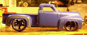

The "flat" effect you're getting could possibly be due to high humidity (blushing), or the object you're painting being colder than your paint (which causes moisture condensation on the paint surface, also resulting in blushing). Try rubbing your face with a fingertip (to get just a little skin oil on it), and then seeing if you can polish-out the "flatness" in a very small area with the same fingertip. If the shine comes up, that's a good indication you're dealing with blushing. A clear coat will alleviate the problem, but if the clear blushes, you may still have to do some light polishing. IF you're getting blushing, the best solution is to try to do your painting when the temps are between 65 and 80F, and the humidity is below 65%. And rather than sanding the areas on wheels you want to paint, I'd suggest carefully masking the area you don't want painted, and vigorously scrubbing the to-be-painted area with Comet, or another aggressive abrasive-type cleaner and a stiff brush. You'll have an easier time getting into all the small crevices that are impossible to reach with sandpaper. For wheels especially, I'd recommend a "self etching" primer as well. Duplicolor makes one, and it should give you a little better adhesion. It would be great if you can get a piece of material similar to what your wheels are made from, or a junk alloy wheel, to practice on before you shoot the real thing. Different substrates can affect how a color coat behaves. For instance, you can often paint a plastic real-car bumper at the same time, on the same day, with the same paint, over the same primer, as you paint the fender adjacent to it...and you'll get a slightly different color, because the flakes lay down a little differently. Likewise, painting an alloy wheel, your paint may behave differently than it does painting a model-car body.

It pretty much HAS to be shot wet to get a nice gloss with minimal o'peel...but if it's "wrinkling", the only things that should cause that are 1) incompatibility with your primer (most likely cause), or 2) extreme crazing of the increasingly soft plastics in today's kits. I love Duplicolor because for me, it's almost always a guaranteed good finish...but you HAVE to shoot it over a solvent-resistant primer, like the companion Duplicolor products. This is Duplicolor rattlecan shot wet over Duplicolor's primer. No sanding or buffing yet in this shot...
