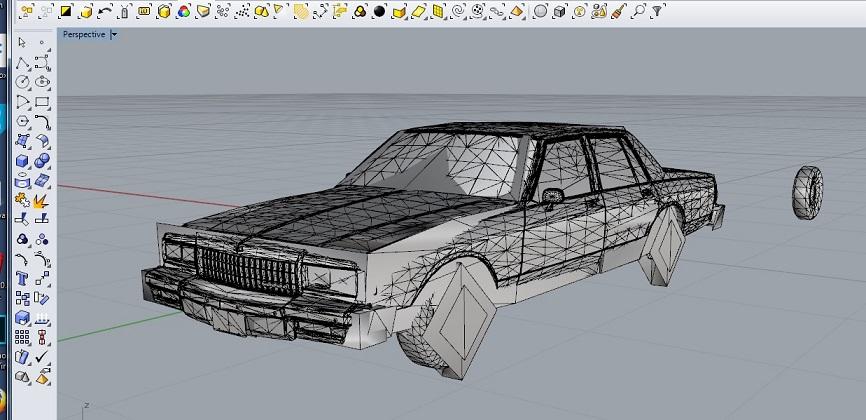

This looks good so far, Robert.
How are you planning to address/fix/clean up the zig-zag edges of the header panel above the headlights and in other areas?
Are you planning to have this produced straight from the files, or are you planning to finish all of the pieces so they are smooth (well, at least the body panels) before moving on to final production? Maybe you are leaving that work up to the end user?
the tooling is machined straight from the files, so that won't show up on the finished part
Ah, that's good.
I hope this pans out and sales are good, because I really like this idea and production method.
What are your opinions about the turn signals molded to the grille?

I wouldn't have a problem if all the lights were molded to the grill unit. They are all flush and a bit of Sharpie work over chrome would look nice.  Note that this is my old 1989 so the grill is a bit different. I just did a search and found both style grills,  but the majority of the cars I saw had the Ford emblem in the grill center.

thank you Tom. The grille is correct in this case since I'm making both versions available in the same kit.
The grille with the offset Ford oval is the '83-87 style.  The '88-91 style like Tom posted has a different bumper, different rounded corner caps, turn signal housings, grille, etc..
That's correct. Different hood and trunk too. Same dash for the first 2 years, then a new dashboard for the last two.
I prefer all the clear lenses (headlights/turn signals, etc.) to be separate clear pieces, but I guess for a low-volume production run molded-with-the-grill would be acceptable.
How much experience do you have producing injection-molded styrene kits?  While I don't have experience myself I have seen knowledgeable people describe the process.  There are things like shrinkage of the plastic to consider (so the parts still fit after molding) and things like draft angles.  it is part science and part art/experience.  Or are all those things will be addressed by the mold-maker?
No experience with injection molding. I do have experience in manufacturing, industrial silicone and acrylic molding, casting, etc.
Yes, all of these are addressed by the mold maker. They run program simulators on the parts to look for negative drafts or areas where sink or shrink marks might happen. Then they tell me where it is and I ask my CADrafter to correct them. Once I know the shrinkage rates if any, I can account for them by increasing the 3D model
The undercuts are one reason for the multi part body. The other is to switch between other versions of the car like the '88 or coupe. I've simplified the tool by eliminating all undercuts. This also lowers the cost.
