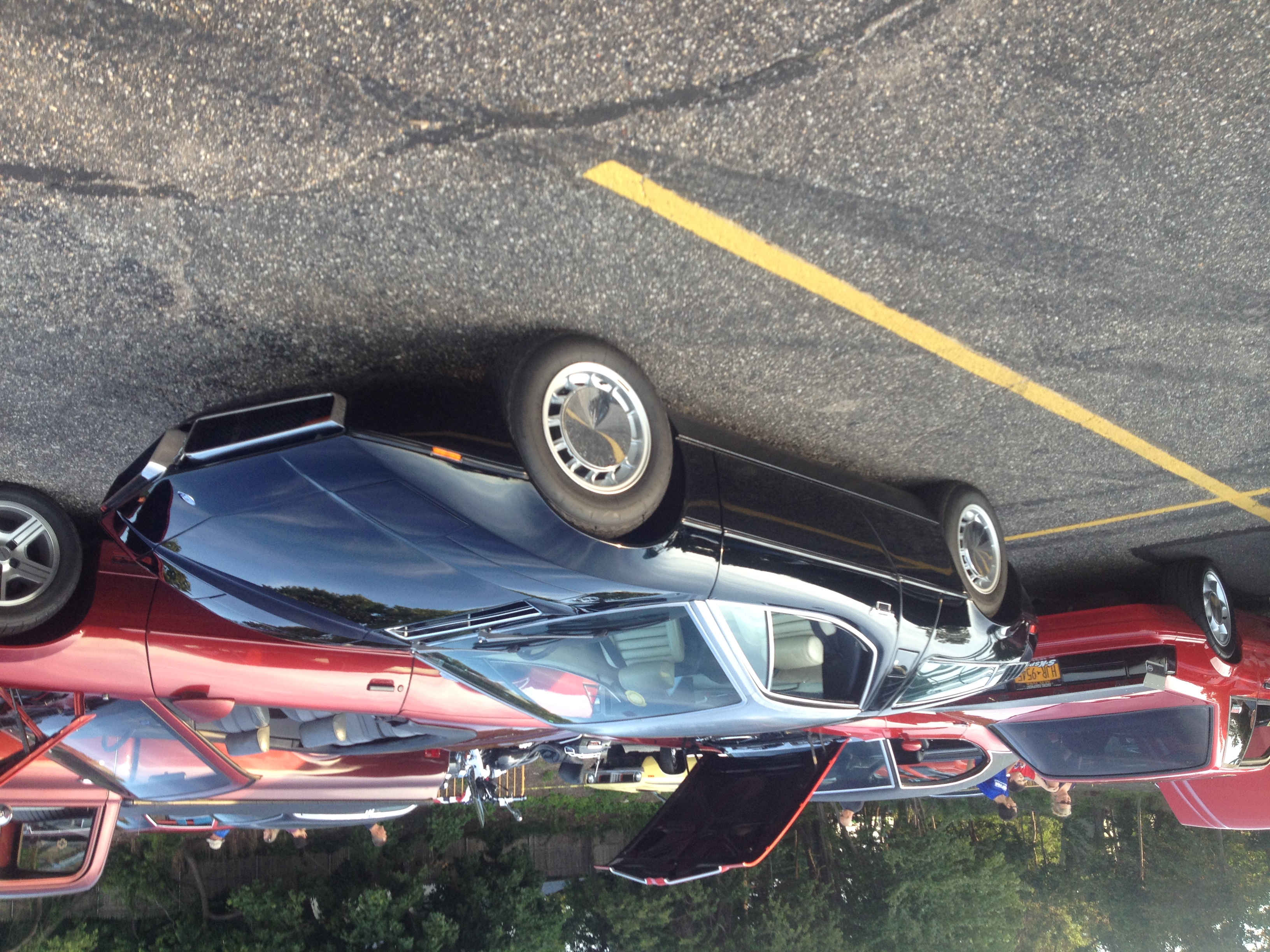

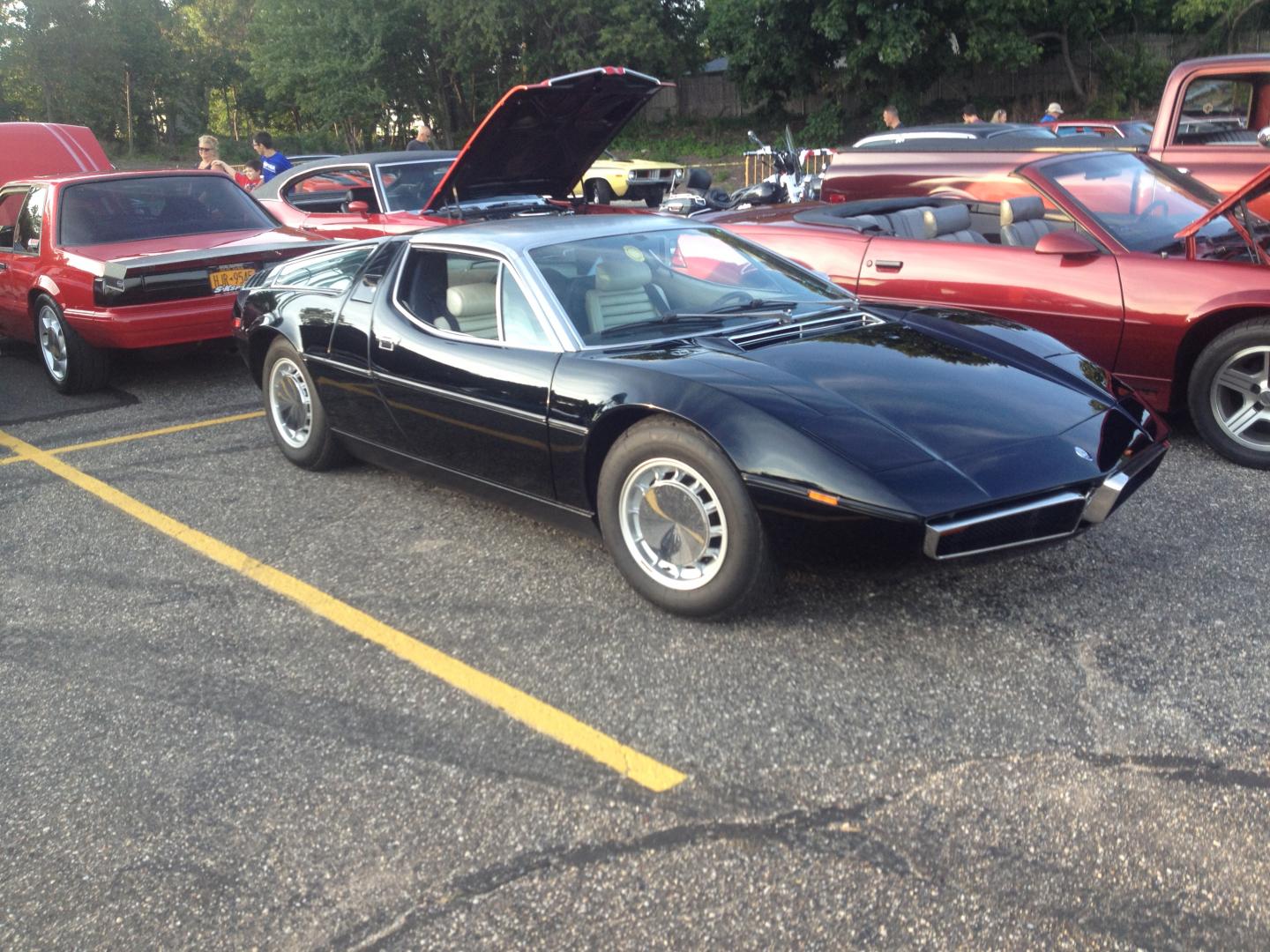

NYLIBUD Posted June 29, 2017 Posted June 29, 2017 Hey that's weird,I just saw a black Bora tonight,at a car show,for the first time...Wow,What a sexy car,,damm.And,I love the stainless steel roof.One hell of a Hot car,indeed.It was absolutely immaculate.And that front grill was so nasty & mean looking.Does anyone know what one of these might sell for?Just curious..I heard some people standing around the car throwing out numbers for around $150-$200K.Well whatever it is,it was cool to just see one in person.
Matt Bacon Posted June 29, 2017 Author Posted June 29, 2017 Very nice... Thanks for the photo.I think they're definitely due a revival. Sleek, refined, powerful... and practical (there's a good sized trunk under the hood...).Black's timeless, but I'm not sure it does justice to the 70s cool factor, although the cream seats definitely add to that vibe. This side of the water you're talking £150-200K to buy one, so I guess the people throwing numbers around were on the money. Mind you, supercool as it is, if you have that kind of money you can buy a brand new McLaren 720s, which I'm afraid is where my money would go...Looks like I don't need to be overly concerned about getting the shut lines around the doors precise and even, mind you...best,M.
