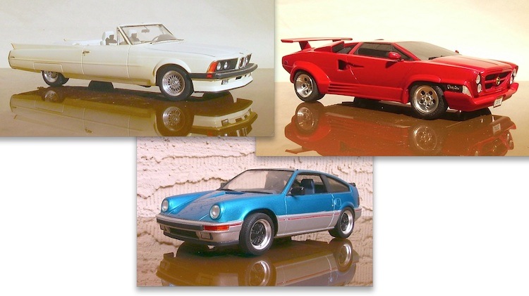

Can you? Sure! You can do anything you can think of. Anything customizers do to 1:1 cars can be done to models.  But (just like it does with the 1:1 customizers) it takes knowledge and practice to get good at it.

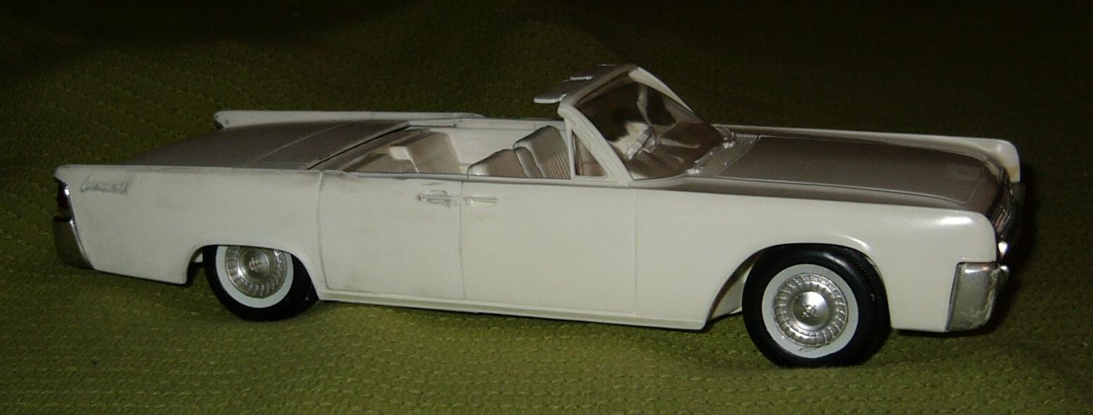

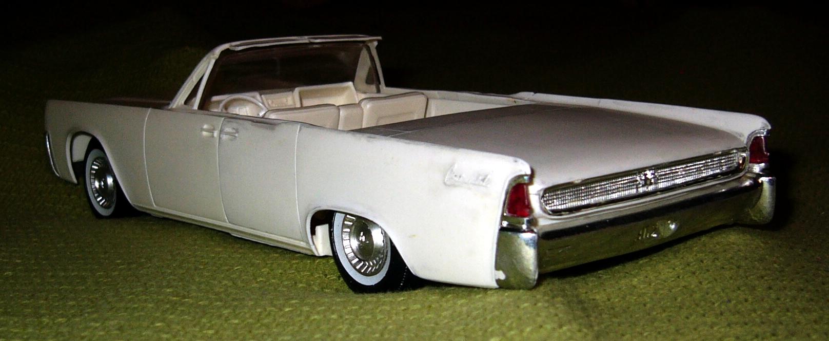

I saved this '61 Continental, whose quarter panels had been hacked down, by splitting it between the doors and at the rockers and adding a '62 rear half. Oddly the backside of the plastic varied in thickness but the outside matched:
P1110441.thumb.JPG.a78fa3f4428108f02057e
P1110438.thumb.JPG.2138084354a94f2da36f4
By going slowly with the trimming and test-fitting about a hundred times, it went together with no filler needed.
