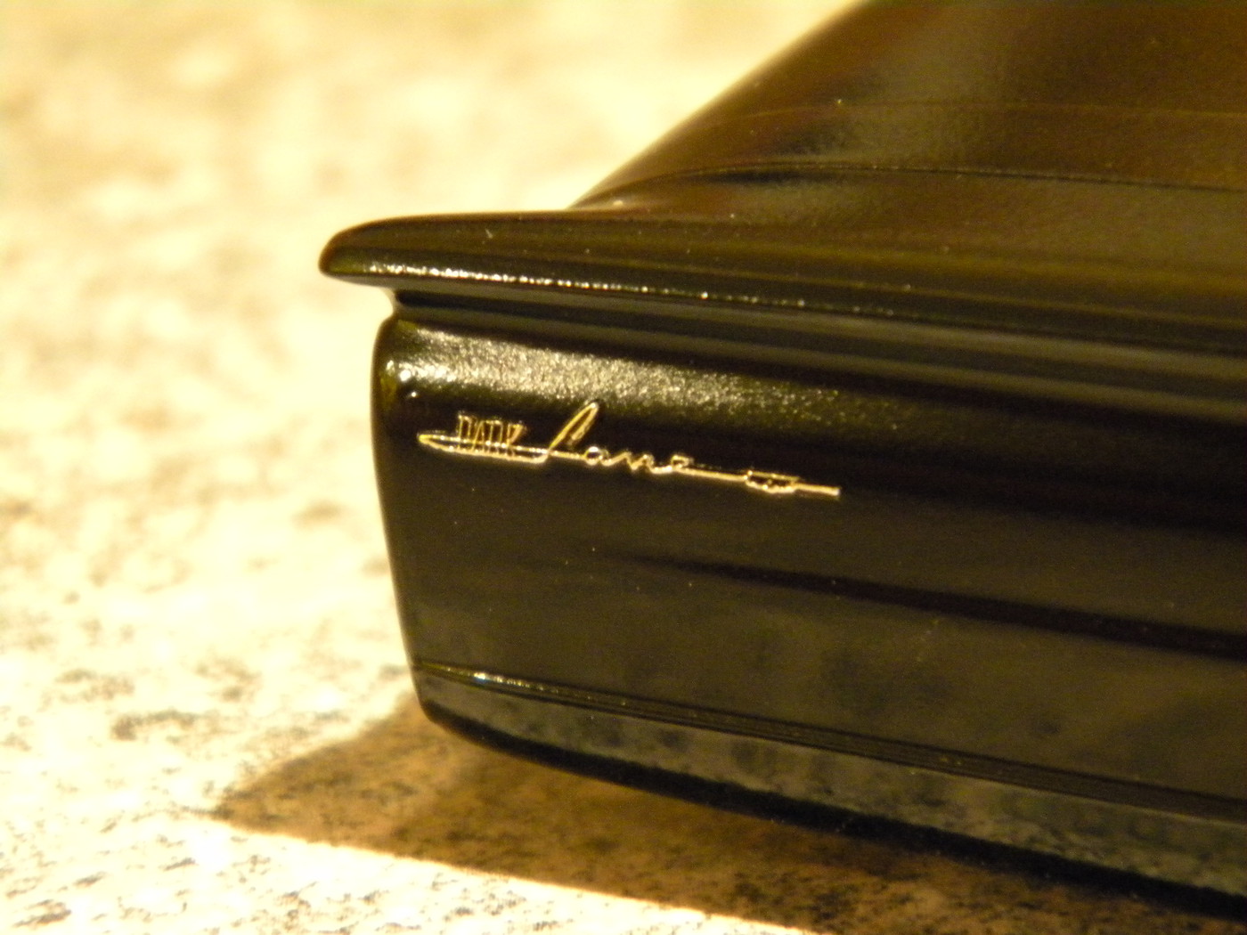

THarrison351 Posted October 12, 2018 Posted October 12, 2018 (edited) A Mustang emblem Wheel Edited October 12, 2018 by THarrison351

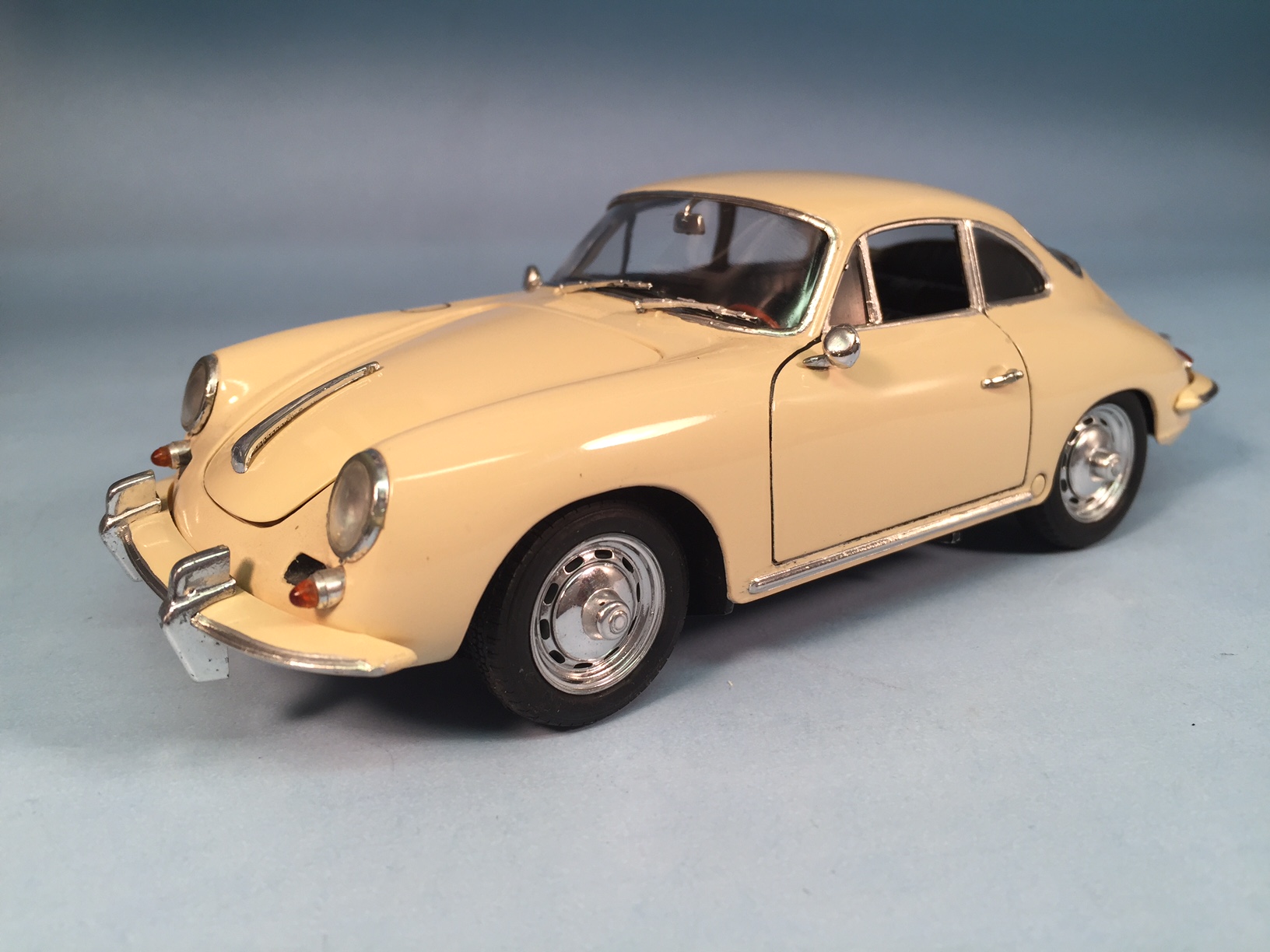

MrObsessive Posted October 12, 2018 Posted October 12, 2018 A Porsche I restored (my own from the '80's) and the wheels and mirrors redone with the pens.................. To echo what Tom said, if you want to do the side trim you'll still need to mask off and trim the tape, then use the pen. To me that seems like extra work............better to get proficient with the BMF. As the old saying goes..............."Practice makes Perfect"!

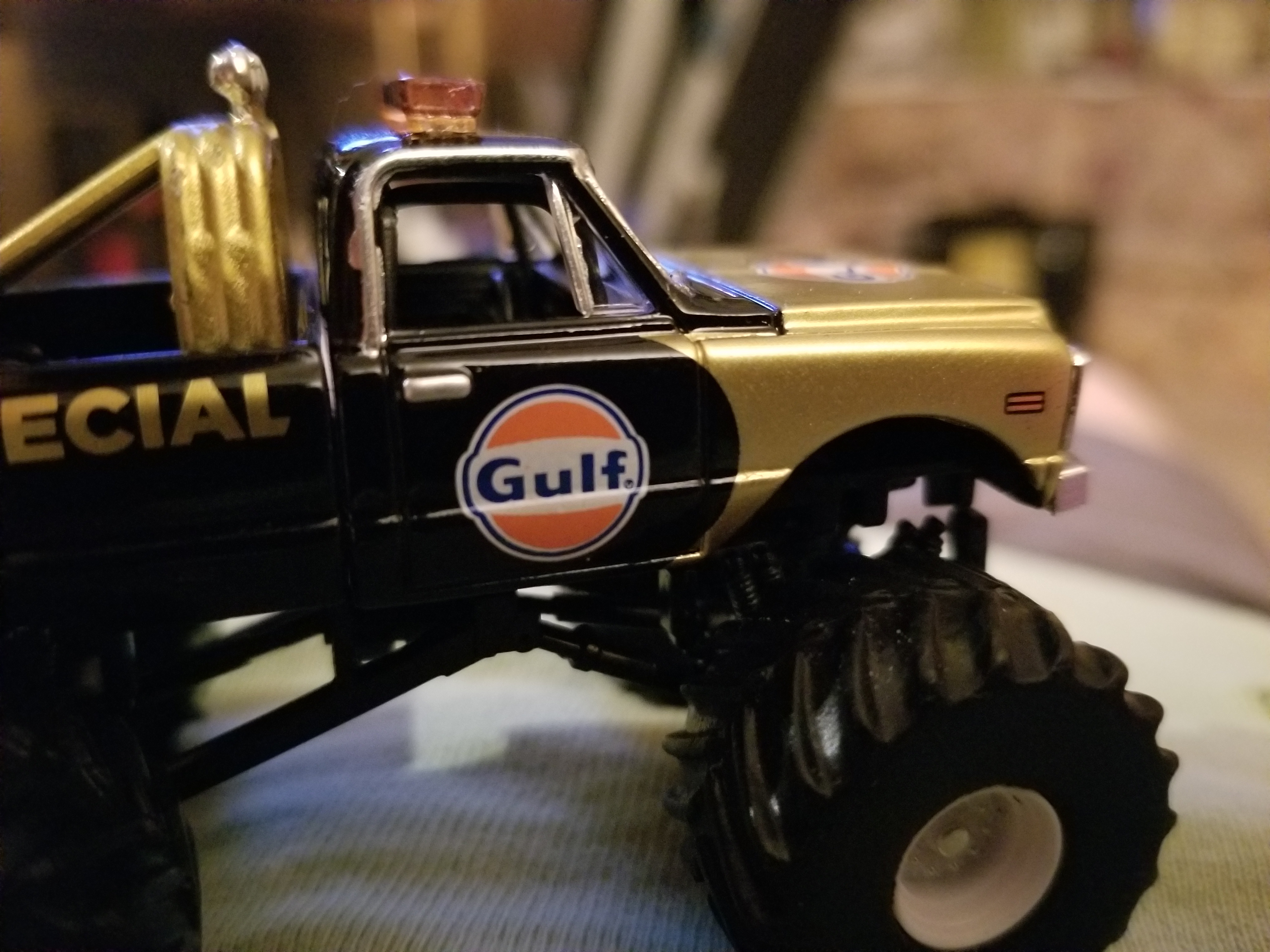

Fat Brian Posted October 12, 2018 Posted October 12, 2018 I agree with what everyone else has said, the Molotow pens are great for some jobs but doing a raised trim line is next to impossible. The paint is so liquid that it's a bit hard to control. It does blend well with plated parts so touching up attachment points and seams is much easier. I find the silver Sharpies work better for window but they aren't as shiny chrome as the Molotow pens. Below is a 1/64 truck I'm doing the trim on with a Molotow pen, you can see how the paint wants to run.

espo Posted October 12, 2018 Posted October 12, 2018 Looking at the picture of Fat Brian's Monster Truck reminded me of the days when all we had was some Testers Chrome Silver in a bottle. First off nothing bad to say about the Monster Truck because it looks very nice. What I was shown by others to do when painting the chrome trim like drip rails and side moldings and such was to lightly score either side of the edge of the object you are trying to paint. This is only a very light line, only enough to stop the flow of the paint from running out onto the body surface. This worked well all those years ago and I still do this sometimes when painting fine details such as interiors and chassis. I haven't tried it with the Pen, but it would seem to work the same way.
