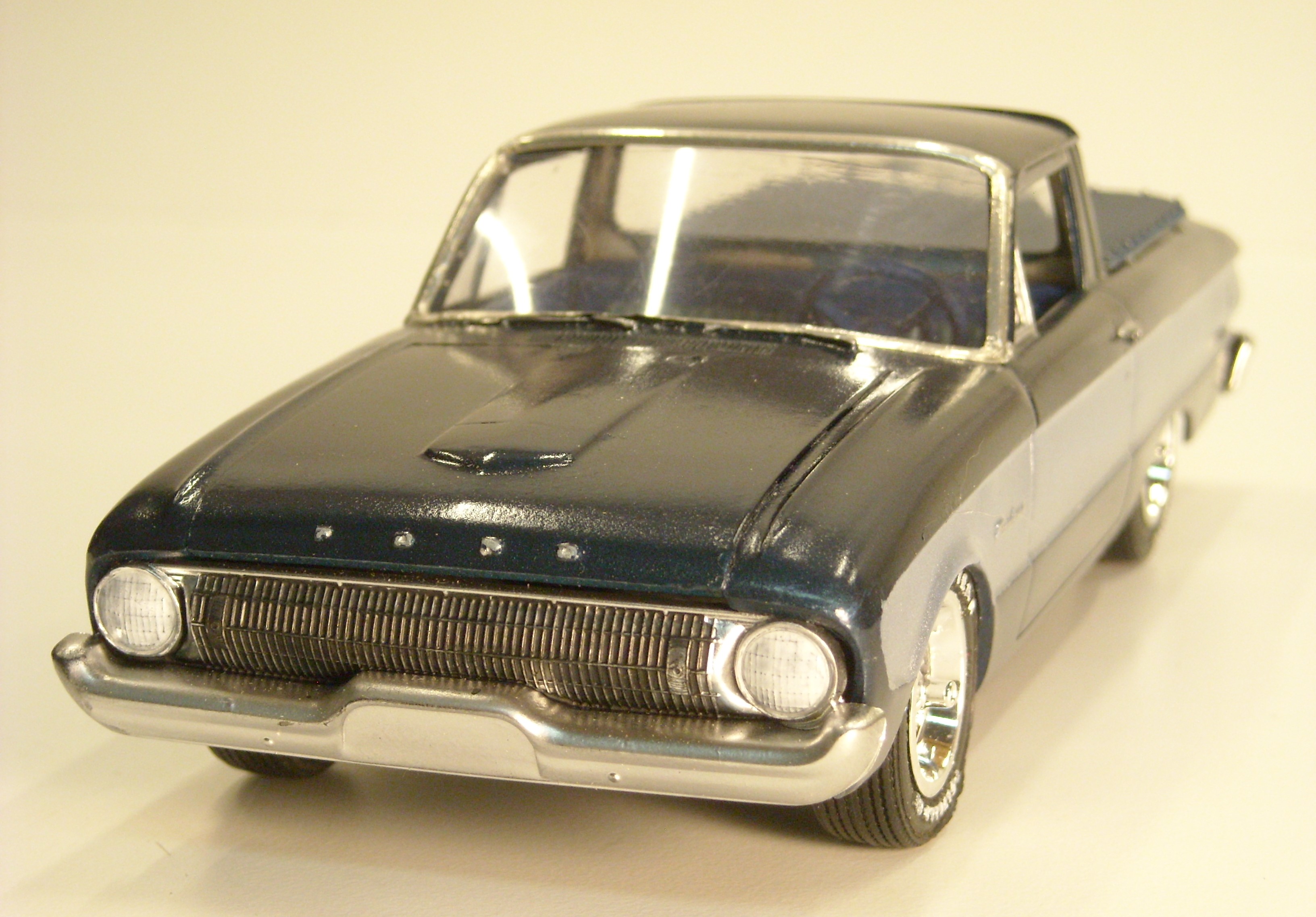

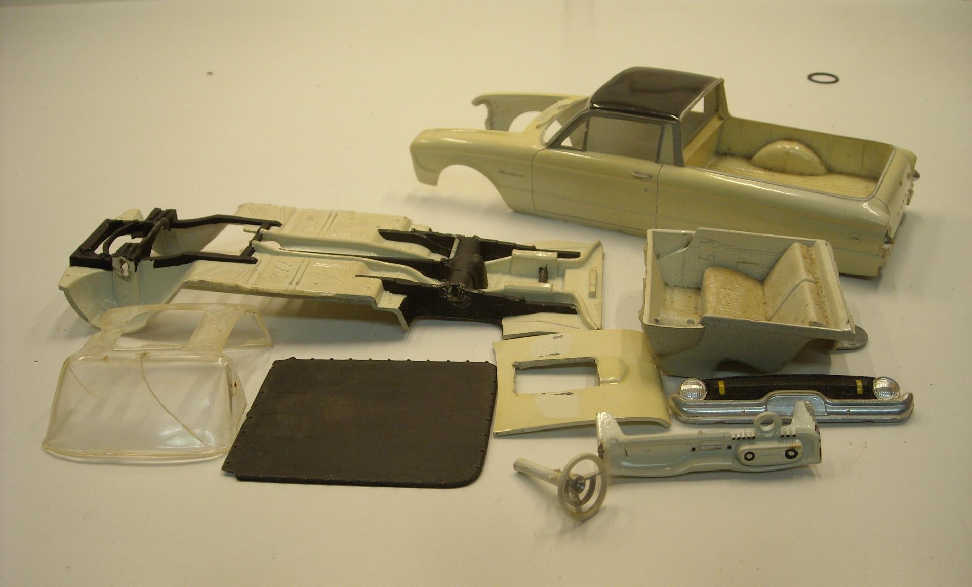

I used this to test out some new (to me) materials and techniques. It started out as this poor old thing:
It stripped pretty well with Easy Off. My experiments were:

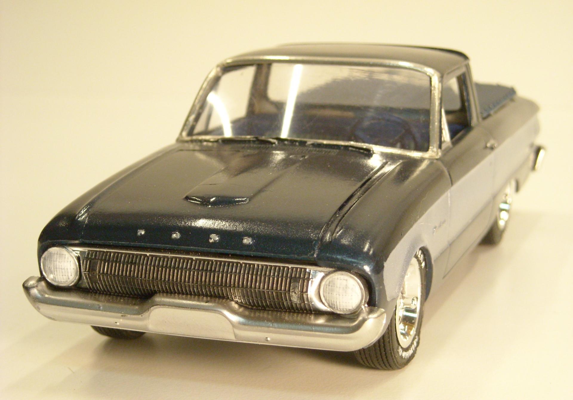

First time painting with Auto Air. I had to strip my first attempt, and it's still not the greatest paint job, but I learned a lot and hopefully my next attempt will be better. Duplicolor Perfect Match Clear.
Grille chromed with Spaz Stix chrome over Spaz Stix black backer. It looked a lot better before I put on a second coat.
I used a modified "Mr. Obsessive" method to put in an acetate windshield.

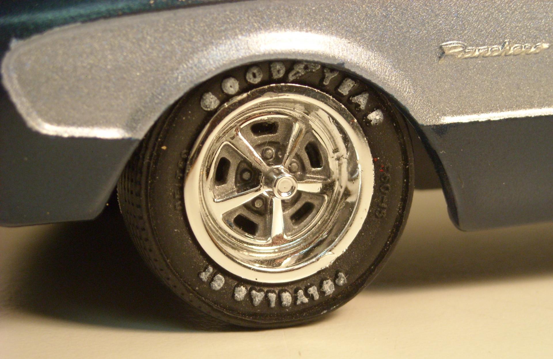

Lettered tires by putting Tamiya white paint on a wood dowel and rolling over the letters. Not perfect, but better than I have been able to do before.

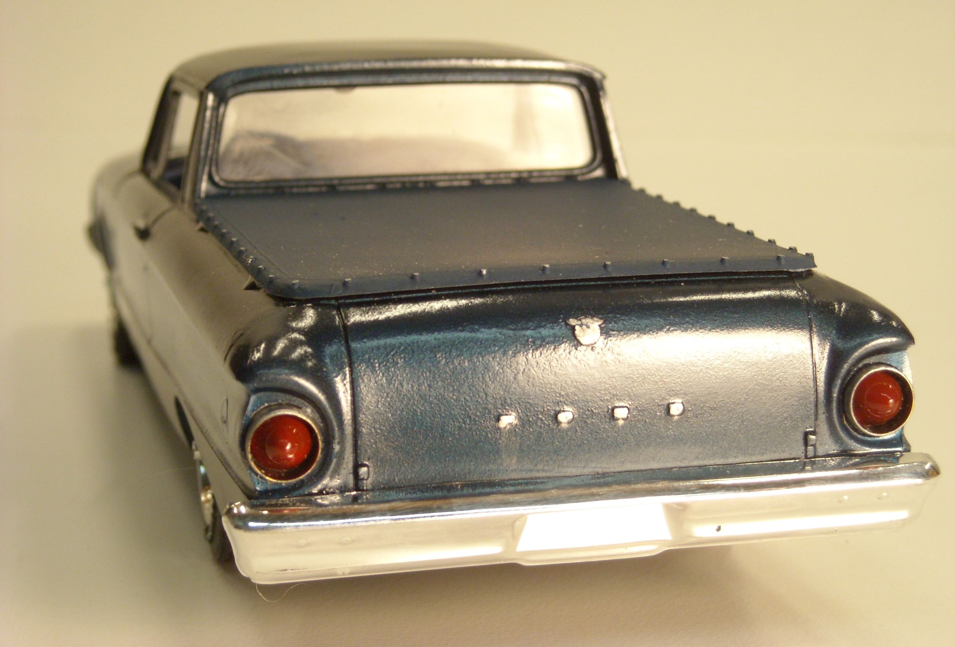

Made tail light bezels from brass tubing.
Molotow chrome on the wing windows, handles, and scripts. The scripts are not as good as "paint over BMF", IMO.
Rear bumper from the parts box. I have no idea what it really goes to.

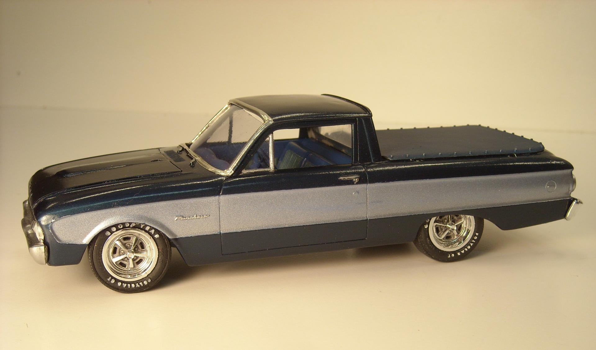

So here's where I ended up:

That doesn't look too bad at all. Great stance, too! Model on! B)
Thanks, Snake!  I made it a little lower than stock, but I might have a bit of a tire rub when cornering.
Thanks, guys. I didn't expect much doing so many things for the first time. The Auto Air paint has been a real challenge, but I have a ton of the stuff. If I ever get the hang of it, I think it has amazing potential.

Thanks, Jacob! I guess you would call this a "Ute". You guys are lucky to have a lot of this type vehicle that we don't get in America.

Hugh, it looks good from where I sit! Glad my tip helped you out! B)
Thanks Bill!  I didn't do a "full Geary" on it, but your method made it possible to get it done.

Cool Ranchero, overall nice save.  Like those colors.  Is it curbside or did you install an engine?
Thanks, Ricky!  It's curbside.  I have a bunch of gluebomb engines, and I thought I found a Cobra 289, which would have been cool. On closer inspection, it turned out to be some unknown engine with Cobra valve covers, so I just said the heck with it.
