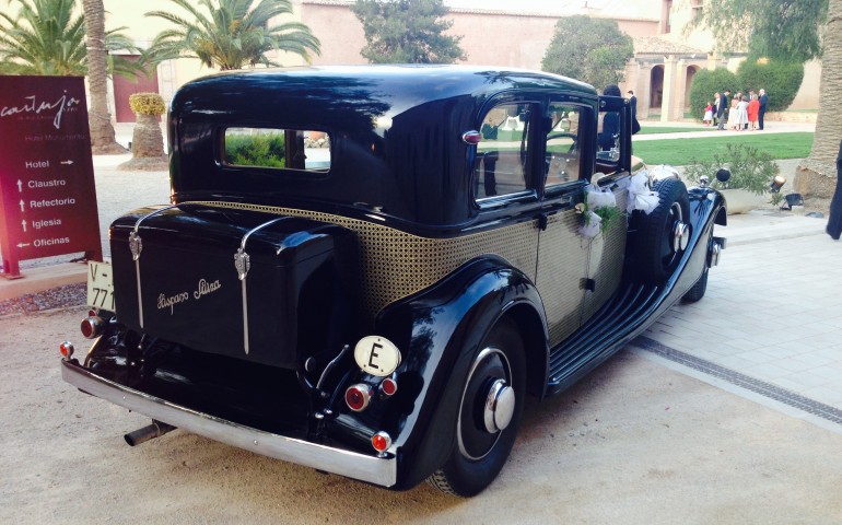

My questions is how to replicate the cane work design on the sides of the body. ( there no decals in my kit )  Did the kit originally have decals? if so anyone have them to spare
if not Im looking for suggestions on just how to proceed.
Ive seen the 1/1 in person and REALLY want this car in my case
Try another picture just for good measure
The cane work finish wraps all the way around the back of the car and duplicates on the other side

I've seen some guys create an effect remarkably like that by spraying through window or filter screen.
Or lace.
The "spraying through a screen" method might be acceptable but it would not be able to represent the canework at a 45 degree angle to the squared pattern. Your best bet might be to find an original kit decal sheet or have someone scan and print a canework  pattern onto clear decal sheet.

I had that kit, as I remember it did have decals, but not great ones.  Depending on your skill level with printing your own decals, you could probably do better.
Thanks all.
I pulled my kit out. And it does in fact have decals, but like Mark mentioned I doubt there usuable.
We were at Hobby Lobby this afternoon and I took a stroll thru the fabric area and I may have found something that might work. But I think for that method to have a chance  will require an airbrush ,,which I no longer have.
Making decals in house I think are likely beyond my computer skills .

So I want to try my hand at the lace mask and paint method. Soon, very very soon.

No, the body is smooth
If that is the Heller kit, I have it too, and I'm planning on making custom canework decals. But knowing me and how many projects I have in the "oven", it might take me 10 years to get to that one.  So, don't count on me.
