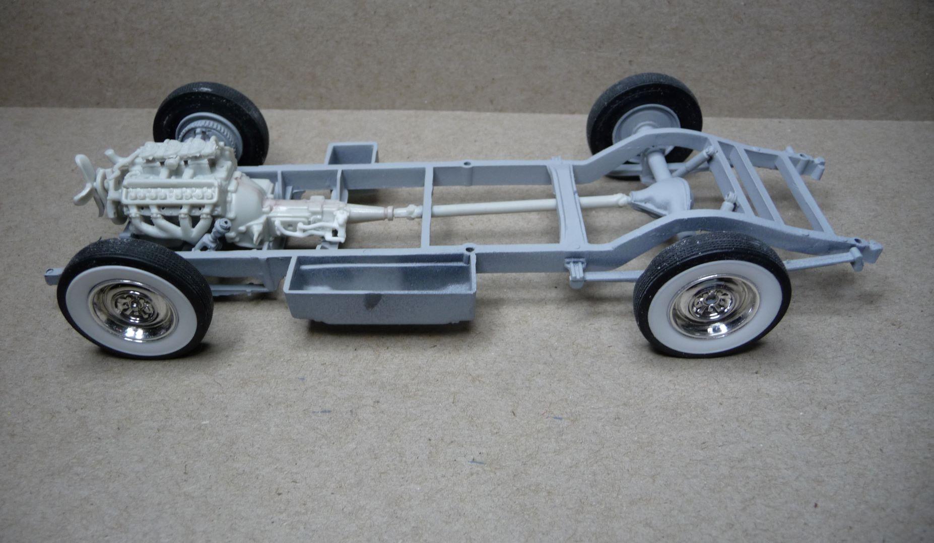

dino246gt Posted August 31, 2019 Posted August 31, 2019 I love that front fender wheel location modification! Wish I'd have done that to mine! Also love the smoothed stock grille, and I think I WILL do that to mine! Since yours is a curbside, I hope you don't mind me showing what I did to my frame to get it lower: 1
