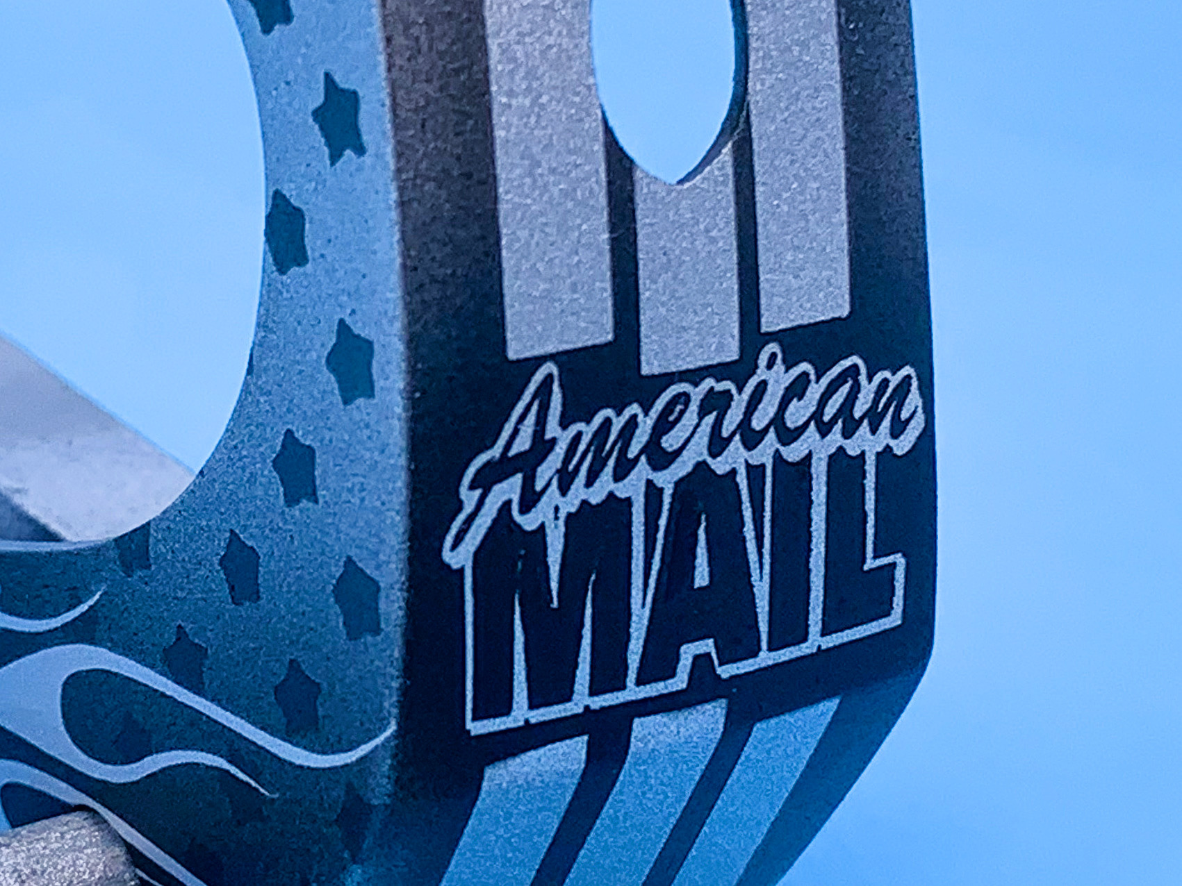

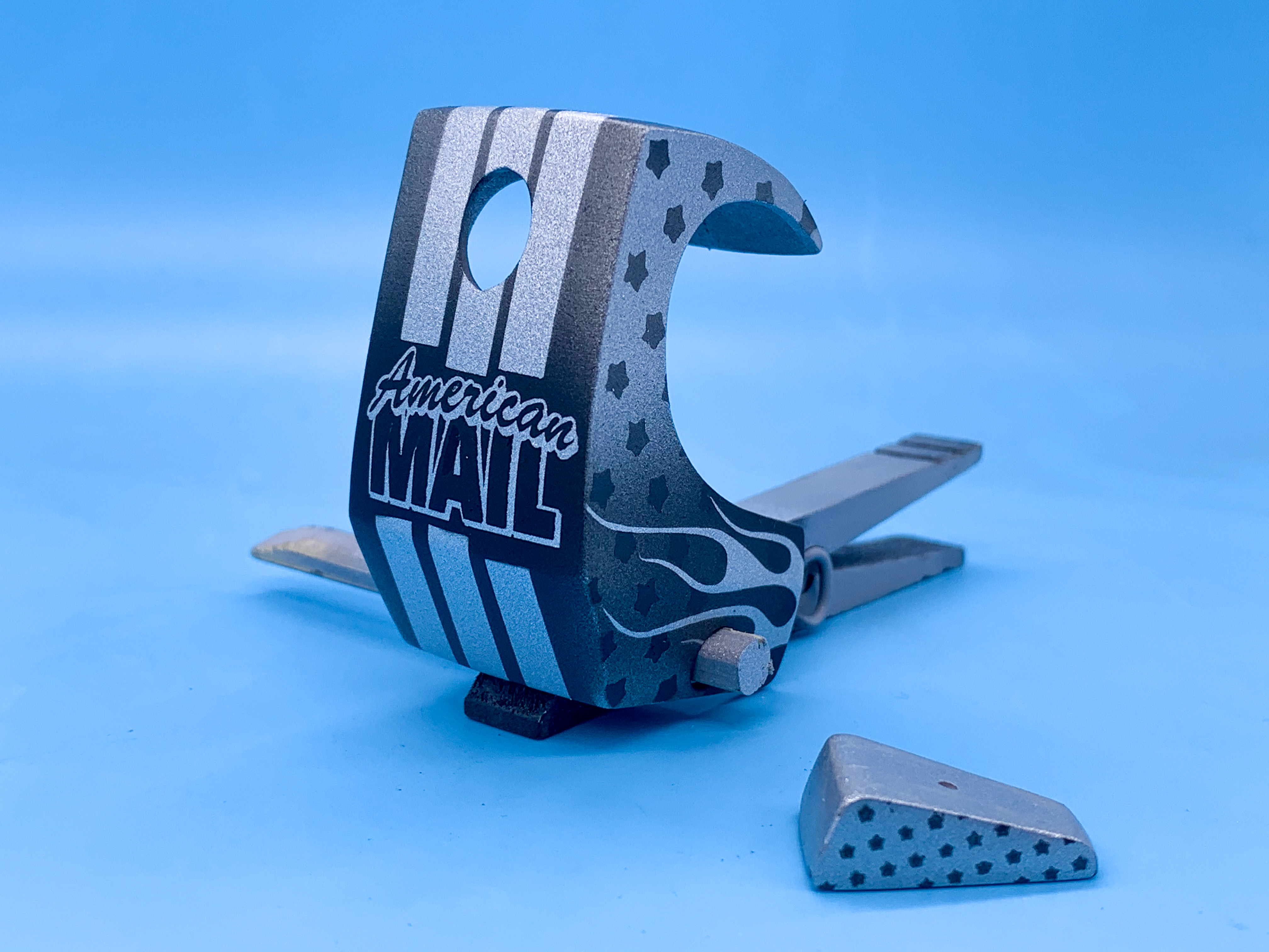

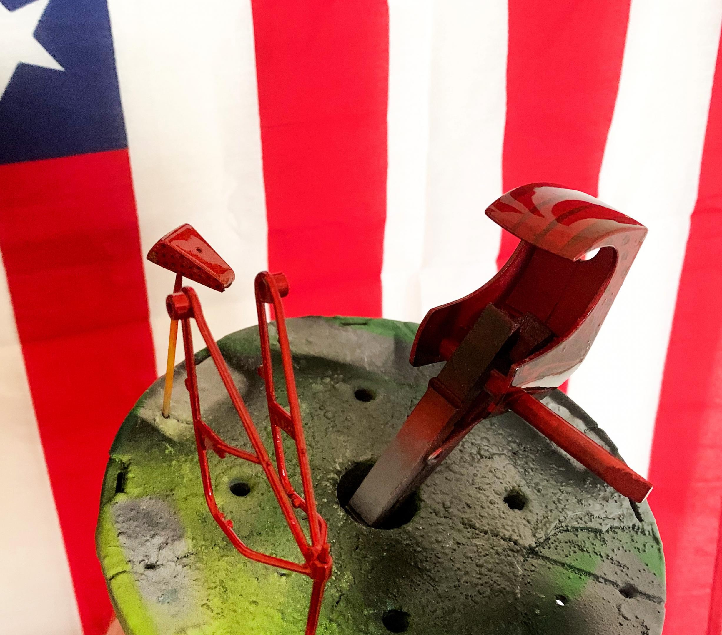

OldNYJim Posted April 27, 2021 Posted April 27, 2021 Shot some graphics on my MPC Mail Box trike body and tank today. I’ll be shooting candy over the top of them to mostly hide them, but I wanted a cool little ‘something’ for people to spot if they looked a little closer...

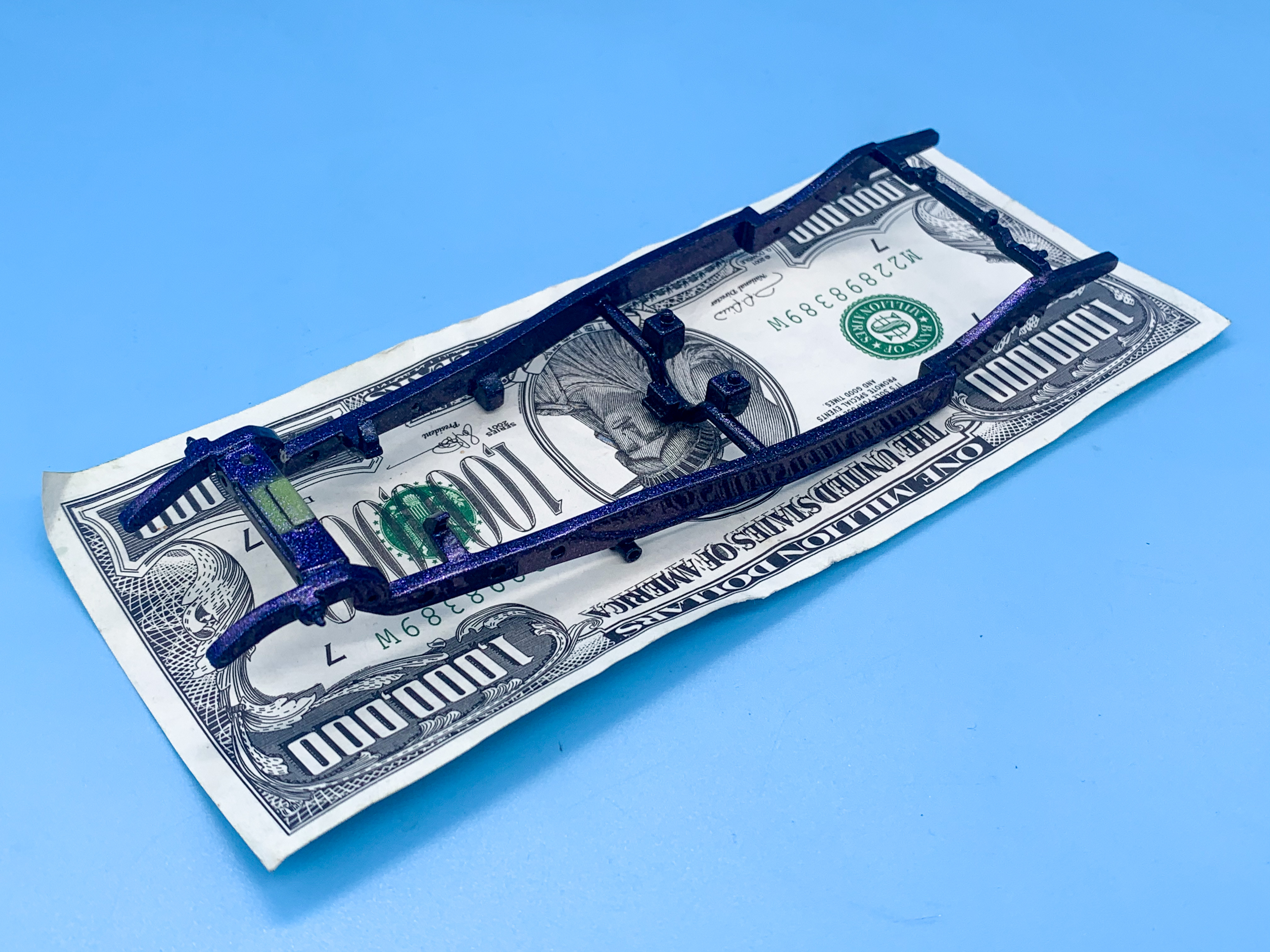

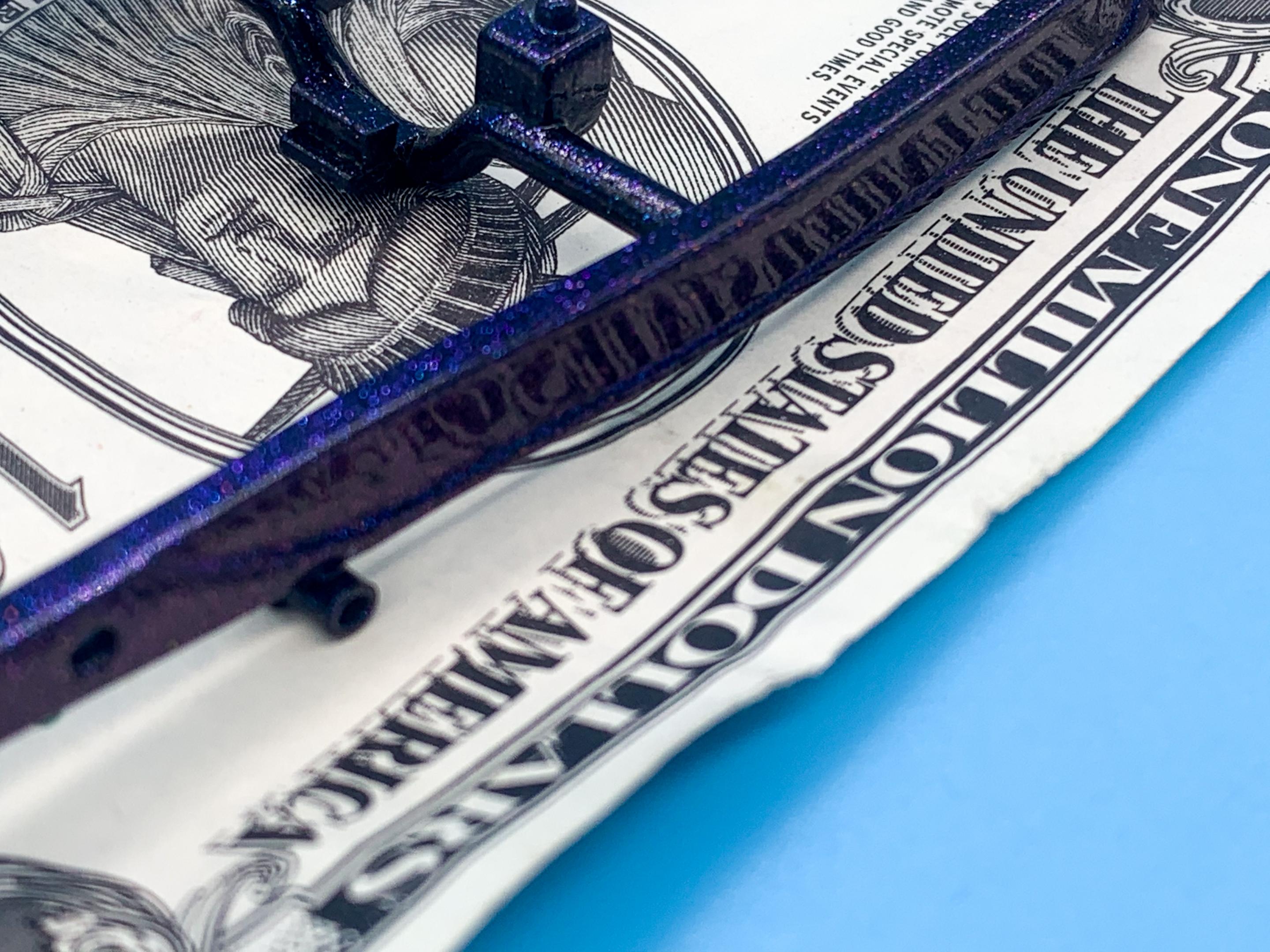

OldNYJim Posted April 28, 2021 Posted April 28, 2021 I don’t usually polish my frames when I’m doing hot rod builds - Testors enamel clear is glossy enough that I shoot that nice and wet, avoid getting dust in it and call it good. In the interests of pushing myself on this one though, I decided to go through my usual polishing process (only VERY carefully so I didn’t end up breaking it or snapping any of the doodads off). Came out ok (although my hard work would’ve shown up better if I hadn’t gone with a flake-y base color and just gone straight black instead ?) Still not quite done, but I like polishing in the daylight and I ran out of it. I’ll give it a second round with fresh eyes tomorrow...
Zippi Posted April 28, 2021 Posted April 28, 2021 That "flake-y base" looks good to me. I'm getting to the point where I don't like the Testors paint anymore. It never seems to dry. For me anyway.
Straightliner59 Posted April 28, 2021 Posted April 28, 2021 51 minutes ago, Zippi said: That "flake-y base" looks good to me. I'm getting to the point where I don't like the Testors paint anymore. It never seems to dry. For me anyway. Gee, I have the same problem with Rustoleum. Do you suppose there's a correlation? ?
Snake45 Posted April 28, 2021 Author Posted April 28, 2021 51 minutes ago, Straightliner59 said: Gee, I have the same problem with Rustoleum. Do you suppose there's a correlation? ? I sprayed some Krylon last week that's STILL stinking.
OldNYJim Posted April 28, 2021 Posted April 28, 2021 4 hours ago, Zippi said: That "flake-y base" looks good to me. I'm getting to the point where I don't like the Testors paint anymore. It never seems to dry. For me anyway. I bake mine for 24 hours in my little dehydrator, but prior to having that option I gave any parts painted with Testors enamel (always cut 1/3rd with lacquer thinner) 3 weeks to fully cure and gas out before polishing them. I experimented with different techniques and different waiting times and that seemed to be the sweet spot - the paint is plenty hard enough by then that you can polish it out to a perfect gloss finish. We used to have really high humidity some days when we lived by the ocean in NY, so I'd wait for days when the humidity was 40% or lower - that seemed to help a bunch too. If you don't mind the wait times you can get a really nice glossy finish with a relatively shallow learning curve with their enamels, I've found.

PatW Posted May 1, 2021 Posted May 1, 2021 On 4/27/2021 at 3:42 AM, CabDriver said: Shot some graphics on my MPC Mail Box trike body and tank today. I’ll be shooting candy over the top of them to mostly hide them, but I wanted a cool little ‘something’ for people to spot if they looked a little closer... Just superb! I wish we could get more of this type of kit in the UK.

PatW Posted May 1, 2021 Posted May 1, 2021 On 4/28/2021 at 4:08 AM, CabDriver said: I don’t usually polish my frames when I’m doing hot rod builds - Testors enamel clear is glossy enough that I shoot that nice and wet, avoid getting dust in it and call it good. In the interests of pushing myself on this one though, I decided to go through my usual polishing process (only VERY carefully so I didn’t end up breaking it or snapping any of the doodads off). Came out ok (although my hard work would’ve shown up better if I hadn’t gone with a flake-y base color and just gone straight black instead ?) Still not quite done, but I like polishing in the daylight and I ran out of it. I’ll give it a second round with fresh eyes tomorrow... But black would be boring! Keep at it, it looks great!

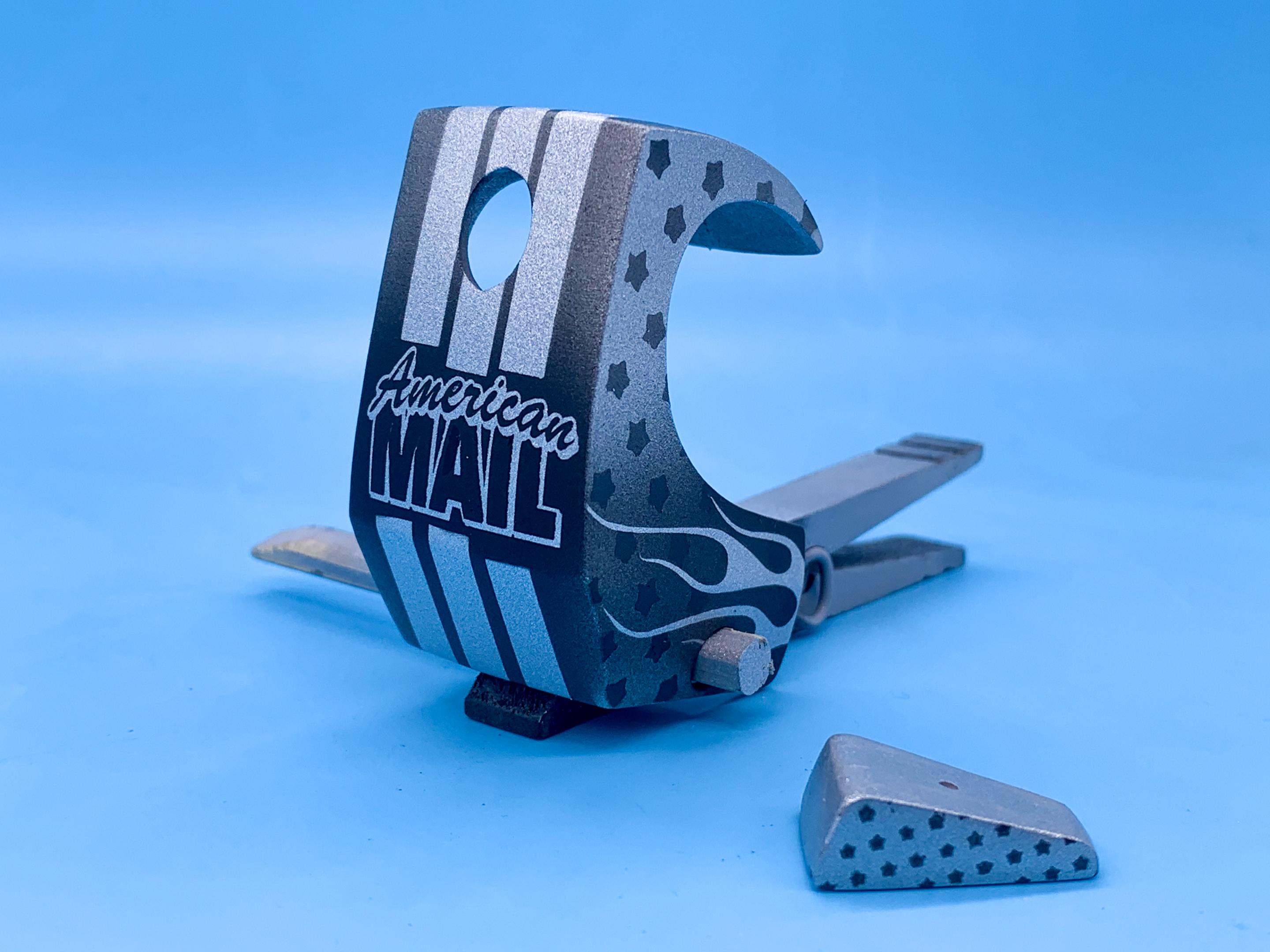

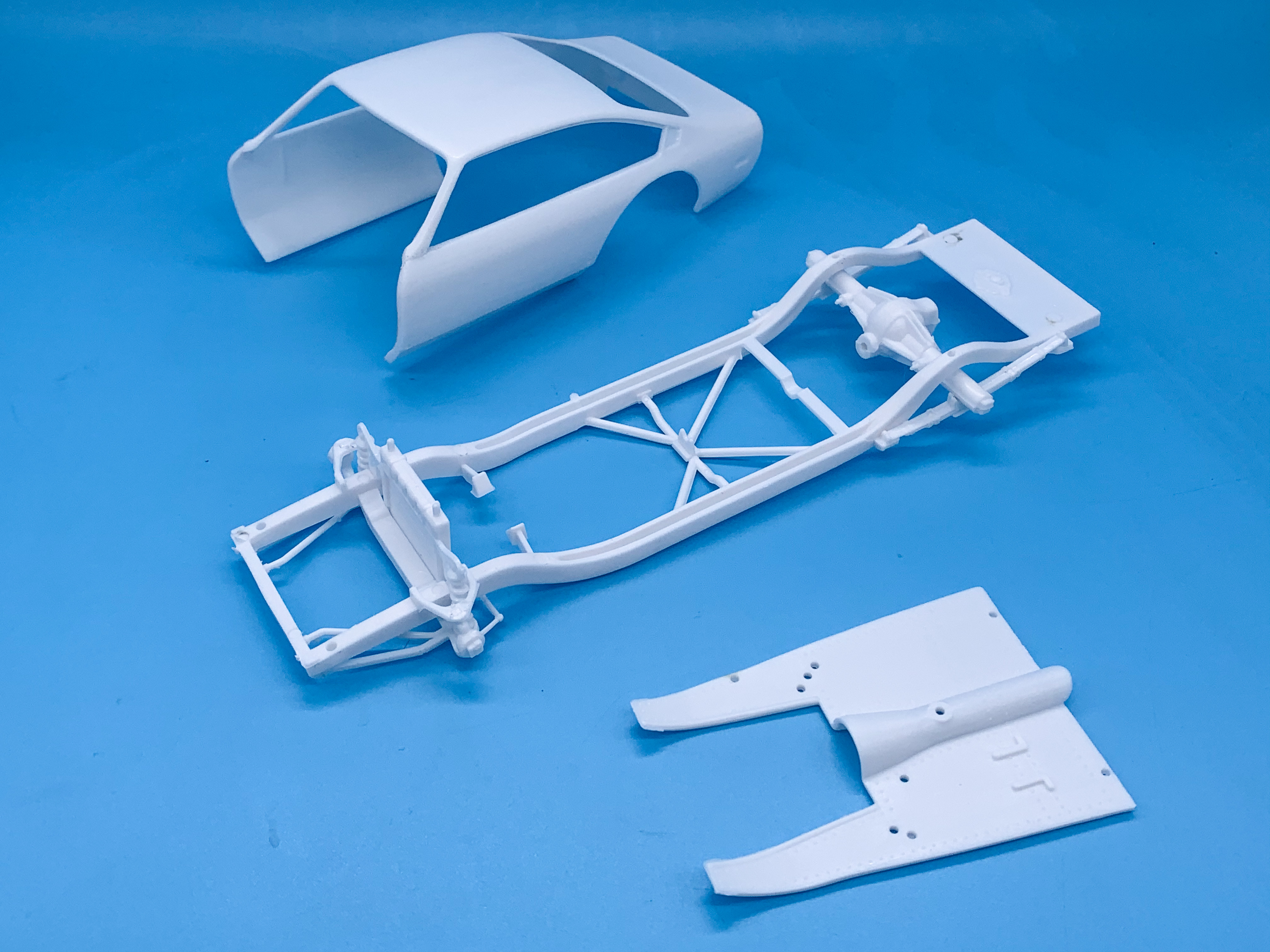

OldNYJim Posted May 3, 2021 Posted May 3, 2021 Got some clear laid down - had a relatively low-humidity day today so got 4 coats on my trike build: And I’ve really been wanting to build an oval car so I pulled an MPC Rat Trap off the rack and started puzting with that: As usual, I was thinking “meh, I’ll build it stock and see how it goes” and then mocked it up and found 10 things I want to replace right off the bat ?
Snake45 Posted May 3, 2021 Author Posted May 3, 2021 9 hours ago, CabDriver said: As usual, I was thinking “meh, I’ll build it stock and see how it goes” and then mocked it up and found 10 things I want to replace right off the bat ? I hate when that happens.
NOBLNG Posted May 3, 2021 Posted May 3, 2021 (edited) On 4/28/2021 at 7:25 AM, Zippi said: That "flake-y base" looks good to me. I'm getting to the point where I don't like the Testors paint anymore. It never seems to dry. For me anyway. Get yourself a cheap food dehydrator (one with adjustable temp control) to use as a drying booth. It is also good for keeping your paint cans warm in colder weather. There is a sticky in the Q&A section on them. Edited May 3, 2021 by NOBLNG
