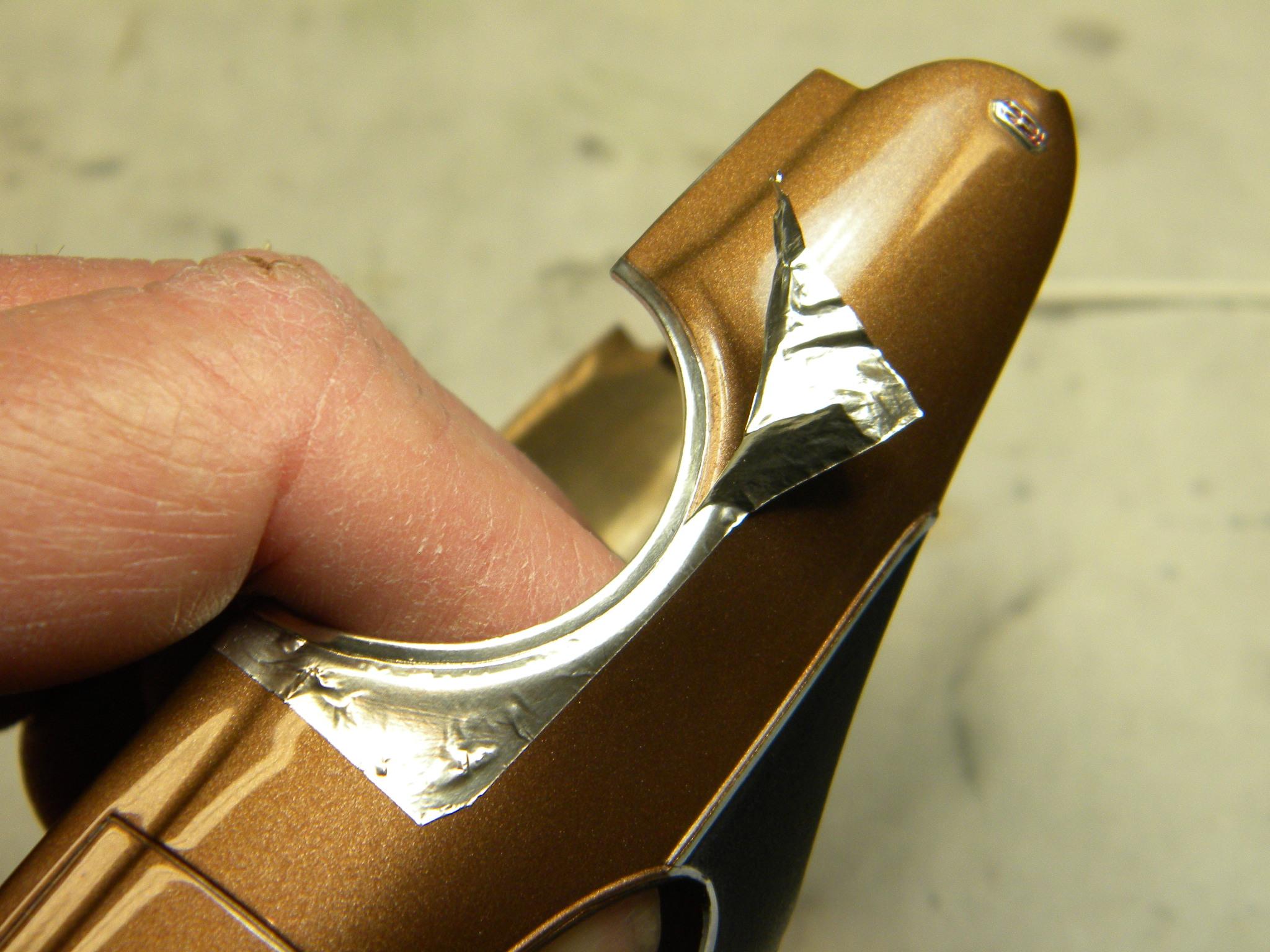

I occasionally get asked about some of my foiling techniques, and as wheel arch moldings sometimes give me the most problems, I thought some of you might find this technique useful if you have not tried it.
Of course, the first step is to cut and apply a large enough piece of foil to cover the wheel opening.
As you would with any section of foil, press it down tight into the edges with a small conical swab, sharpened tooth pick, or whatever your tool of choice is, and lightly burnish the surface with a soft cloth.
Then using a sharp #11 blade, cut the overhang of the foil within about a 1/8 to 1/4" around the inside of the wheel well for folding over into the inside of the body.
Next, carefully burnish the foil over the edge of the fender lip with a swab all of the way into the inside of the fender until secure.
(This does not have to be done perfectly as the majority of the over hang will be removed later.)

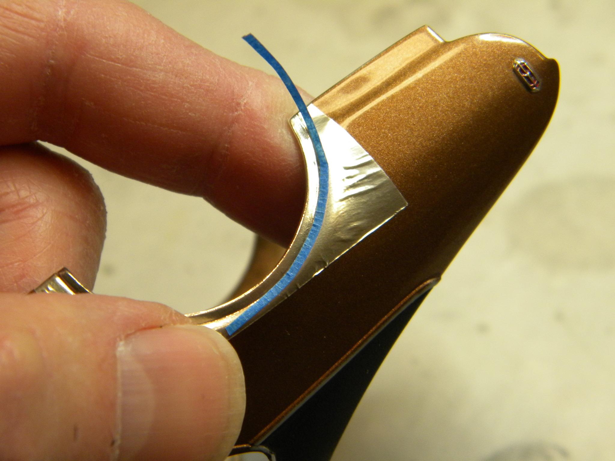

Using a straight edge, cut very thin strips of blue painters tape to be used as a cutting guide.
I generally cut these strips approximately 1mm wide.
The thinner the strip, the easier it will be to "bend" around the radius of the wheel well.
In this case, because the radius is so round, I found it easier to use 2 strips and bend each half way around the opening.
I like blue painters tape for this operation for a couple of reasons.
One, It has sufficient thickness to allow the blade to ride along it's edge as a cutting guide, and two, the blue color is a helpful contrast to the foil and the blade to aid in being able to see what you are doing as you cut.
The taping operation can take some time under magnification with a fine tweezers to insure it is applied properly, but I feel that it's worth the time in the end.
Once the tape is applied, using a sharp #11 blade, begin the cut on one end, working your way slowly and carefully around the opening, watching to be sure that your blade tip is riding up against the edge of the tape as you go.
Being right handed, I find that this is the easiest if you start on the end with the blue tape on the left side of the tip of your blade.
Once the cut has been finished, you can remove the tape, and then very slowly and carefully begin pulling up the excess foil.
I take my time because on occasion, the blade can run up onto the tape for a very short distance and may not cut through the foil.
In this circumstance, the foil can tear if you remove it too quickly, ruining the piece.
If you come to a section that has not been cut through, (in most cases these are extremely short sections) you can stop and cut through the foil in that area as you go.
Occasionally, starting and stopping your cut can cause this problem as well as lifting and resetting the blade may not result in the cut being perfectly continuous.

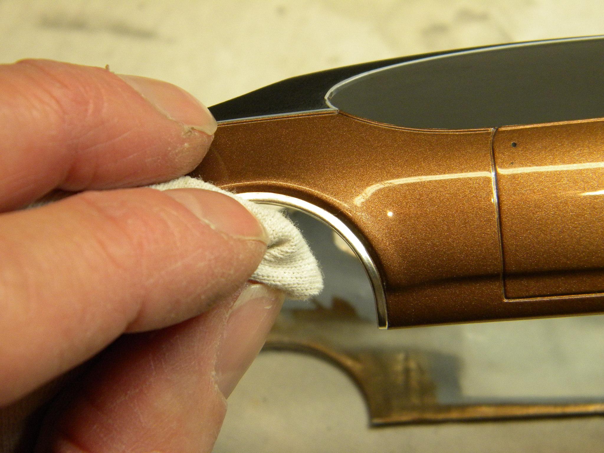

Once the excess foil has been removed, you can begin the burnishing process.

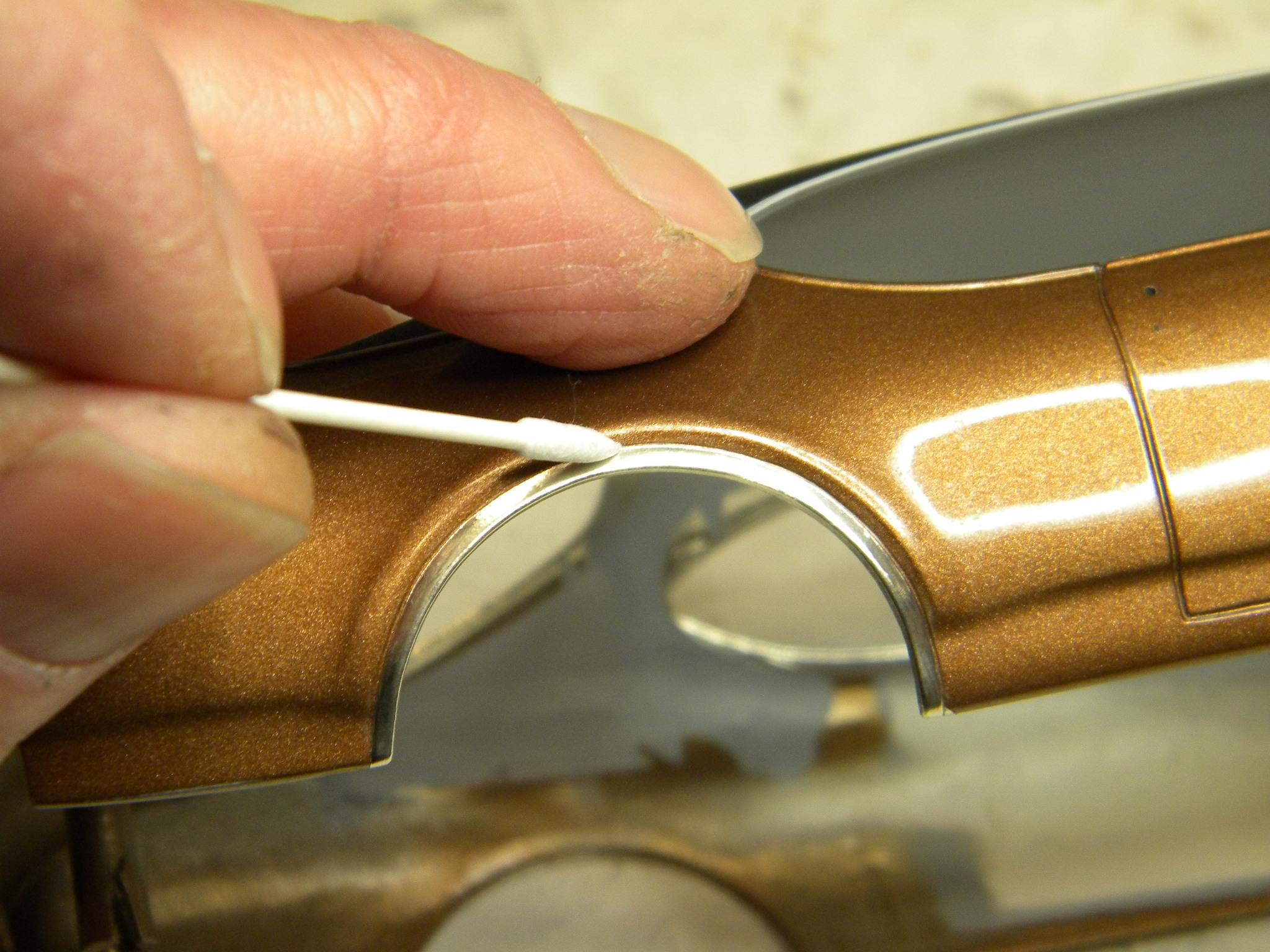

I start by using the tip of a conical swab and a sharpened tooth pick to be certain that the edge of the foil is set securely into the corners where the trim meets the body.
Then, using a soft cotton rag, burnish the piece to a high luster.
