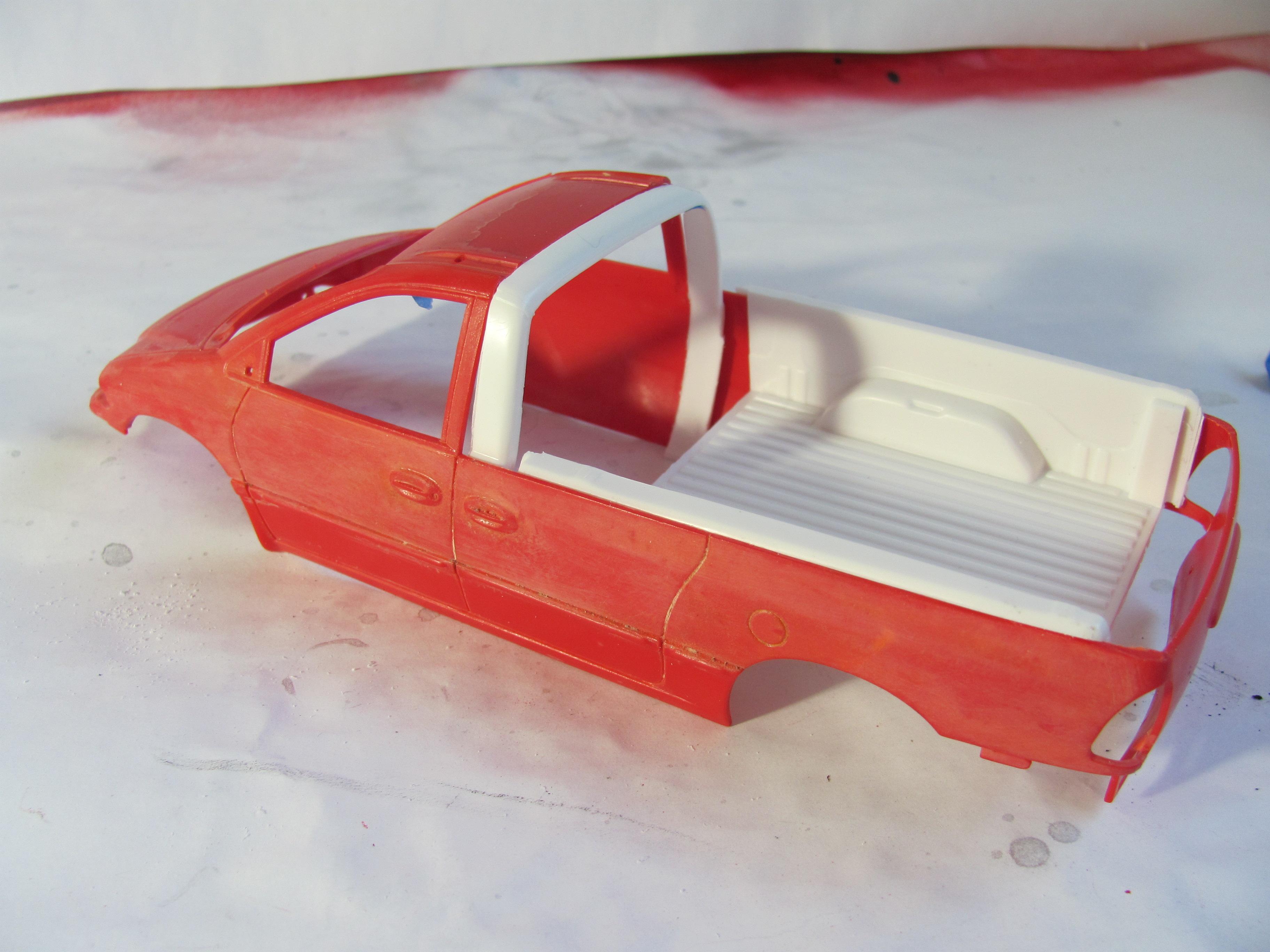

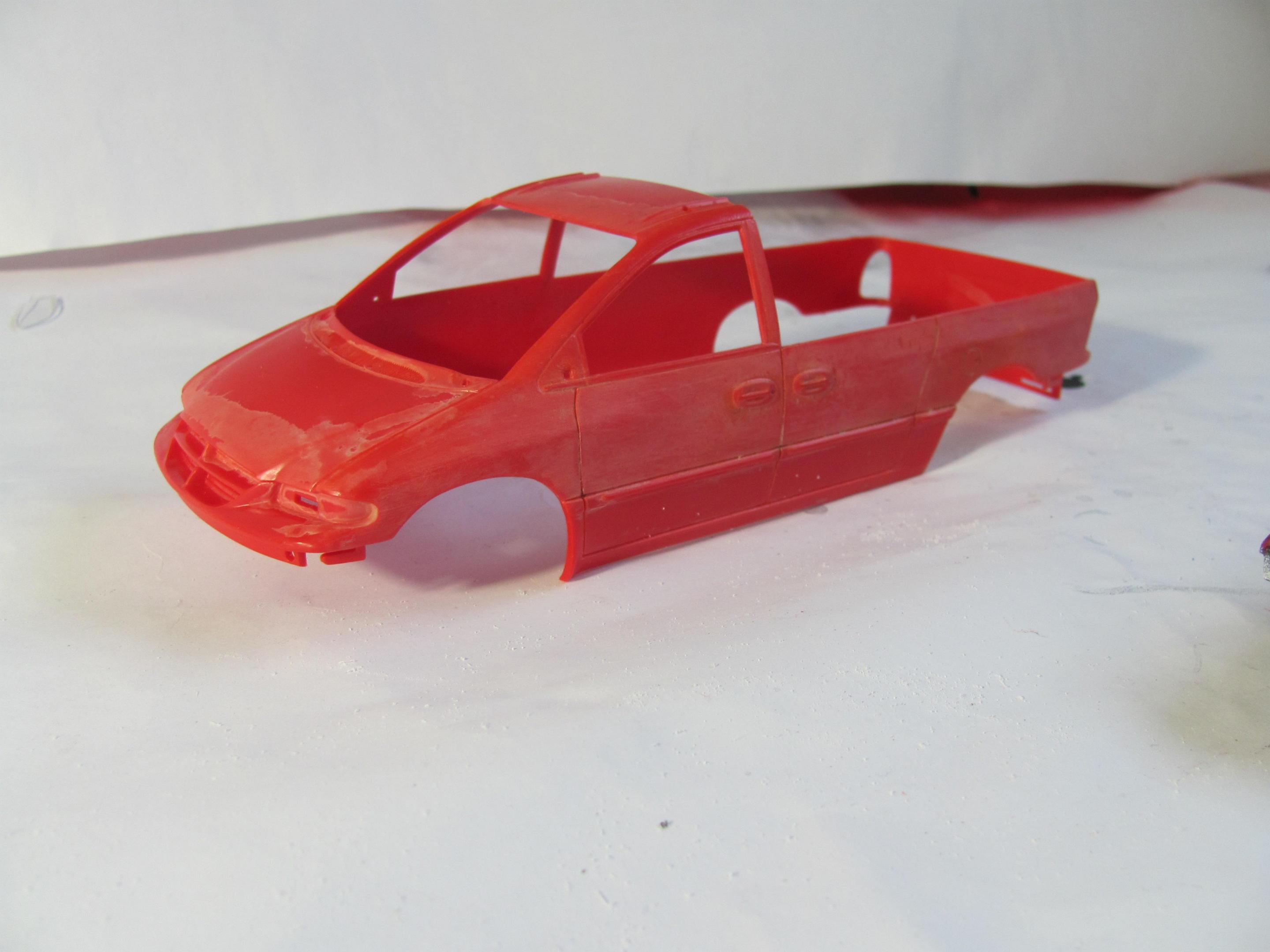

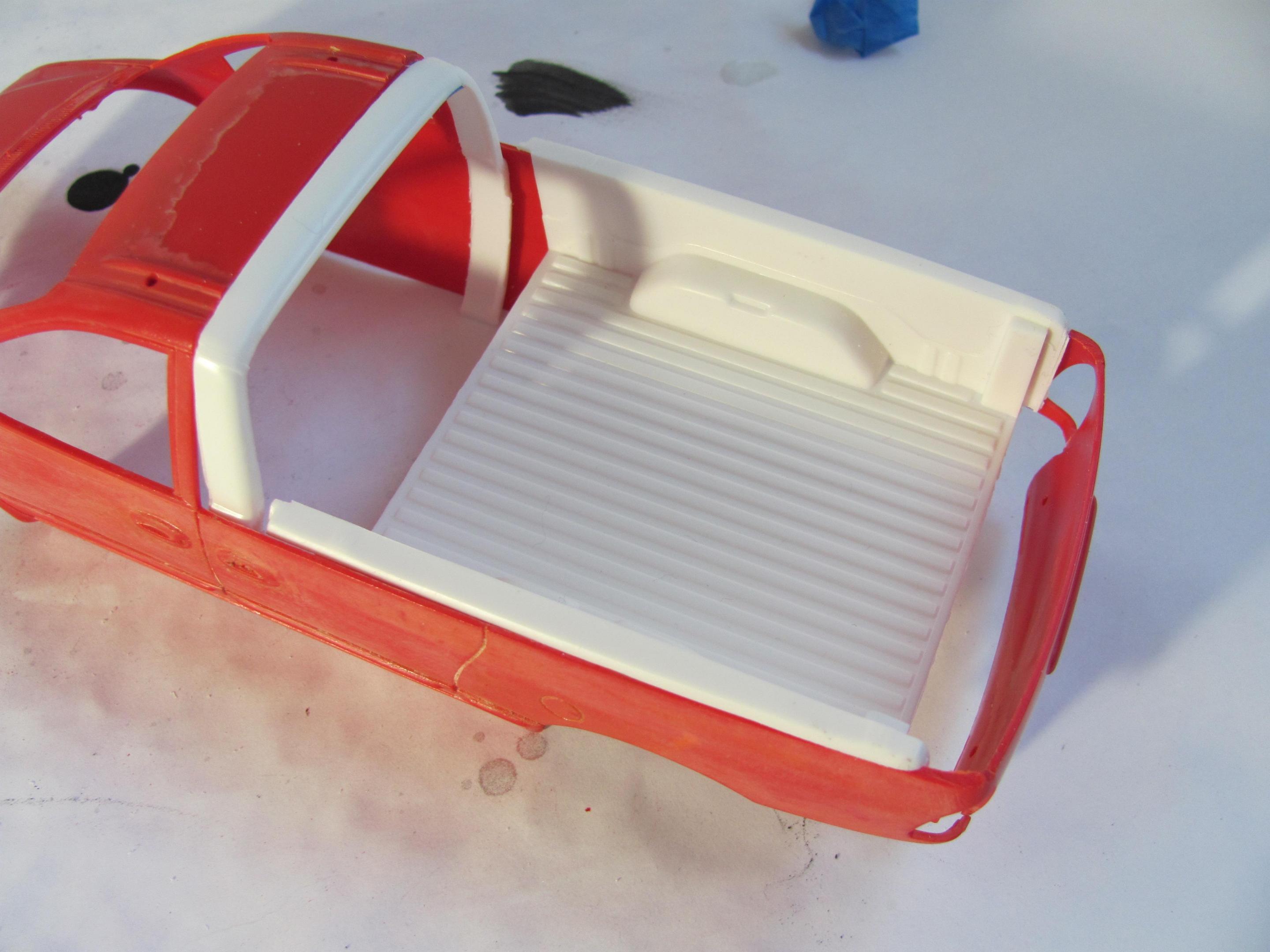

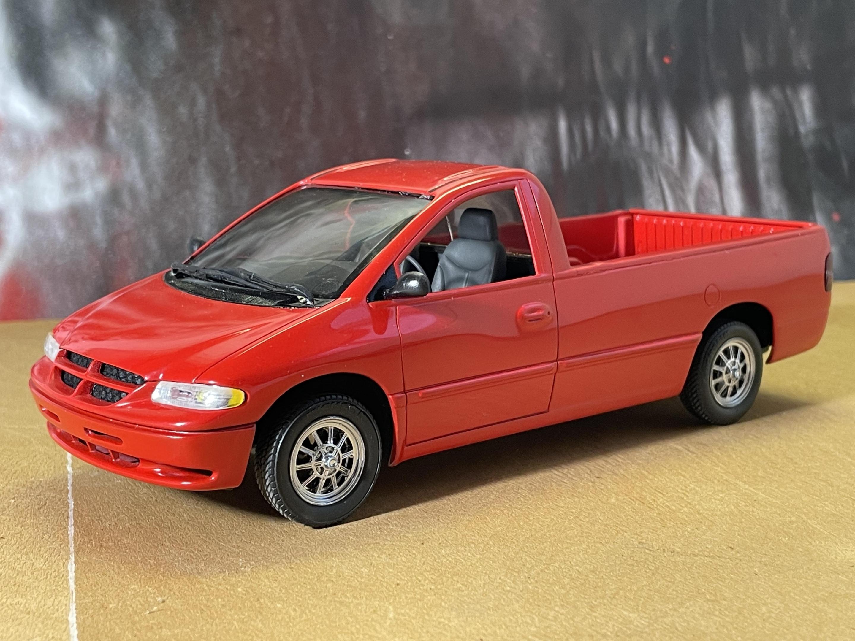

This is a "what if" or "phantom" build of a Caravan pickup (inspired by the A100) I started exactly 1 month ago. Not sure what the model name should be. El Caravano? Ramchero? I considered El Toro but its a Dodge Ram (and that's no bull!) El Ramo! No... Maybe El Carnero , Spanish for The Ram, sounds logical. Suggestions welcome.
IMG_1991.thumb.JPG.ee29147e6a9d2ef924ba4cf0f91e42a8.JPGIMG_2000.thumb.JPG.149294c650c5ed21ba54b7f6db9dc831.JPGIMG_2001.thumb.JPG.3ffb35fedc4a57c13af0684d68fece01.JPGIMG_2026.thumb.JPG.a6c4e445aff74f44d09629f4162bc02f.JPG

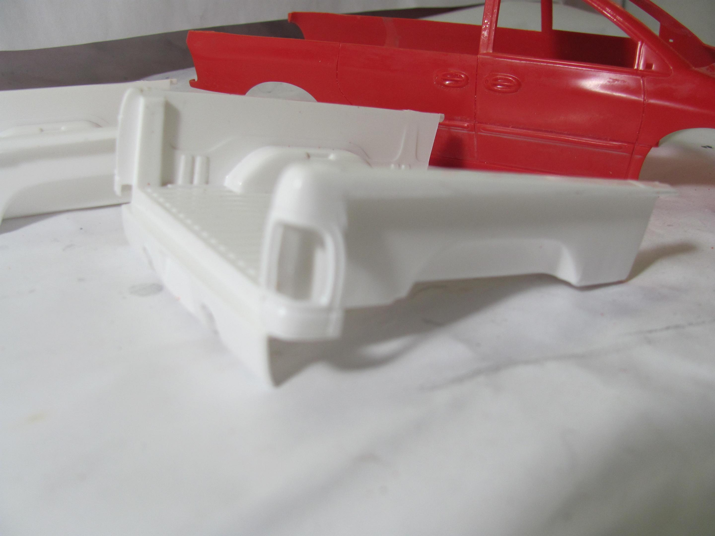

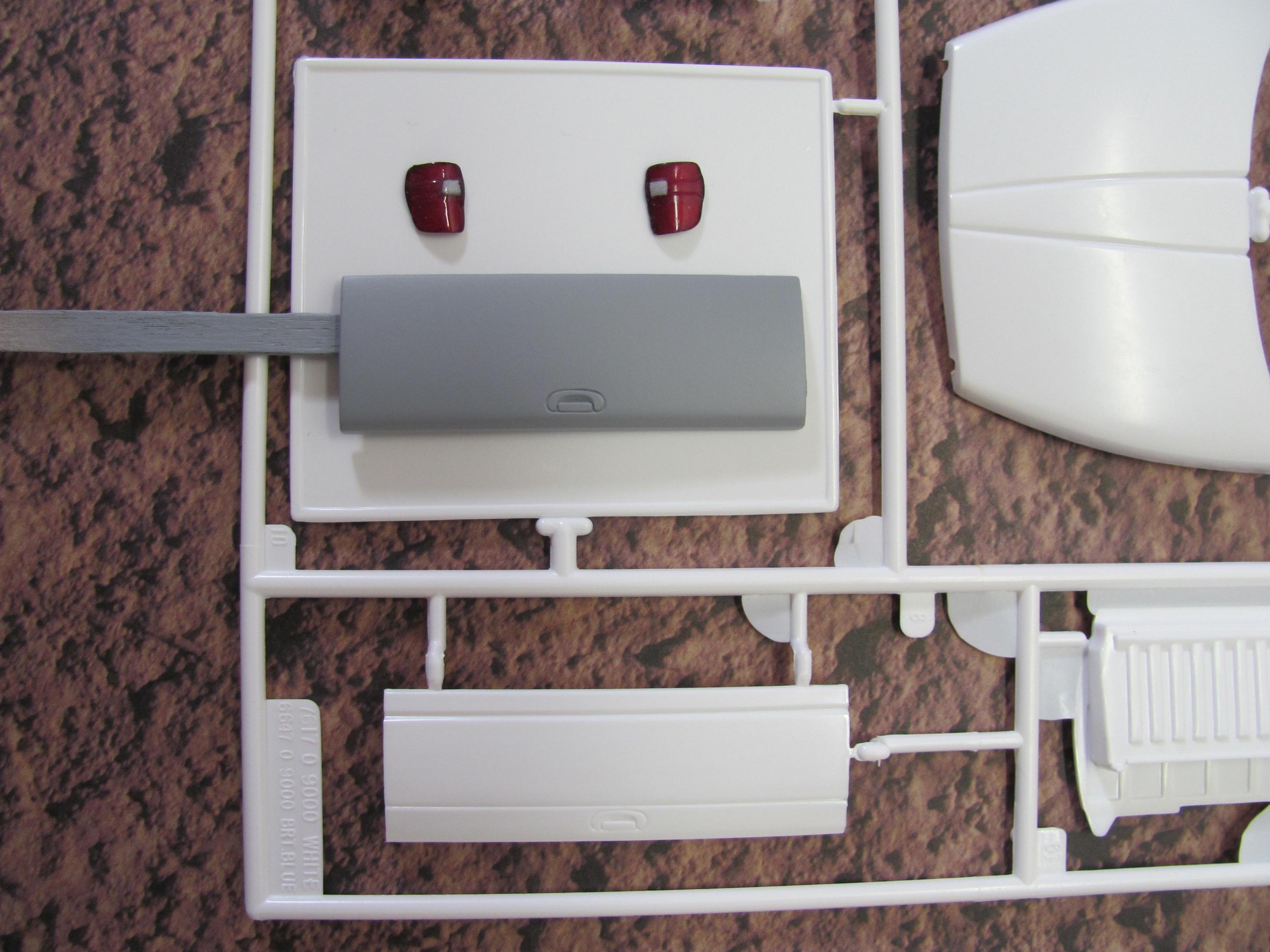

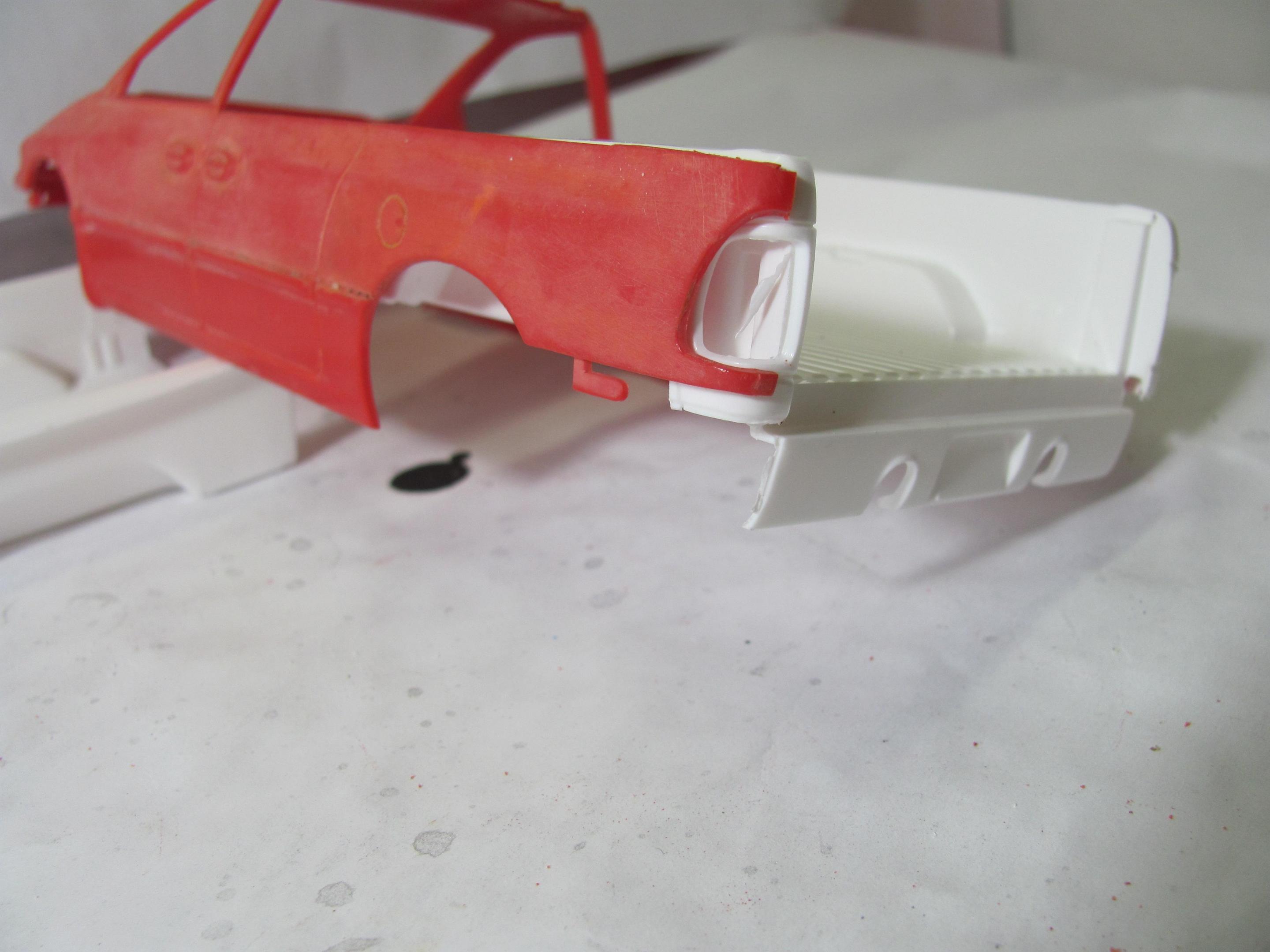

I am using the Revellogram Dodge Ram VTS pickup to complete the conversion, using the cab's back wall, bed, tailgate, taillights &bumper. The bed is actually to short for the Caravan so I graphed on the appropriate length from a 2nd VTS kit. I would have liked to the Caravan taillights but had to flatten the shape at the rear to accommodate a practical tailgate. I also pushed out the rear quarter panels from about the back edge of the wheel opening on back, which allowed for a full width box. (Box length is approx. 7 1/2 scale feet.)

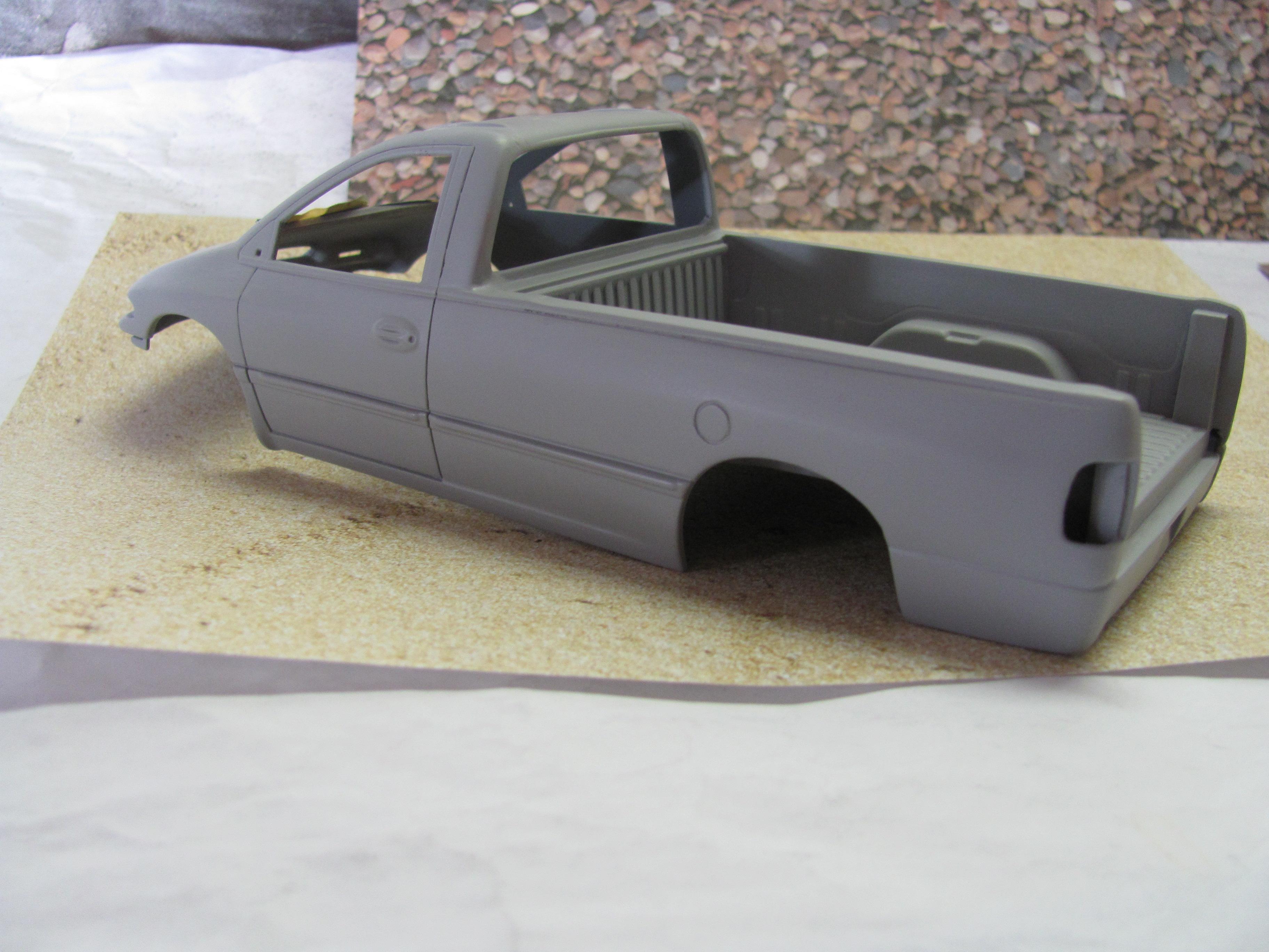

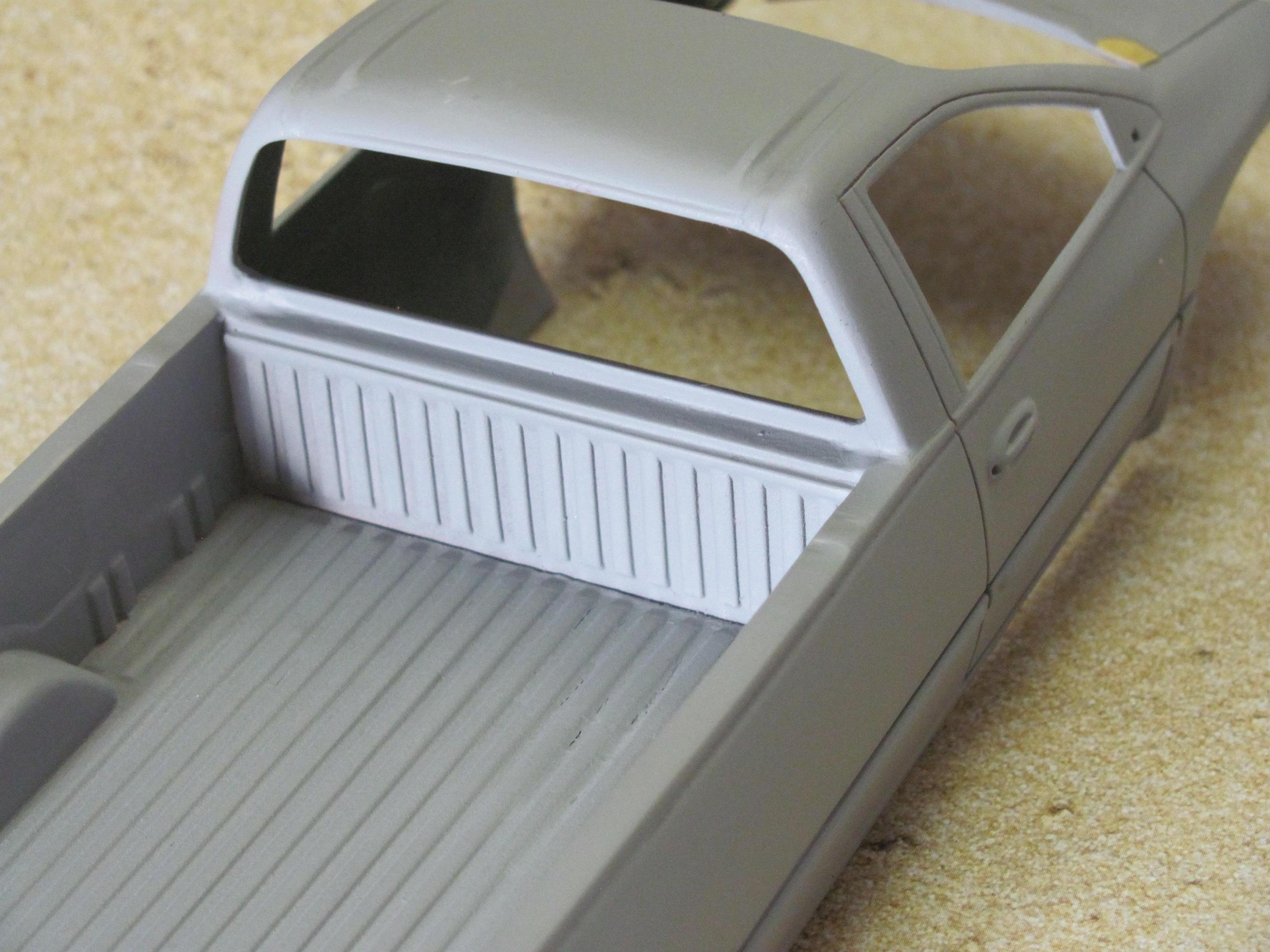

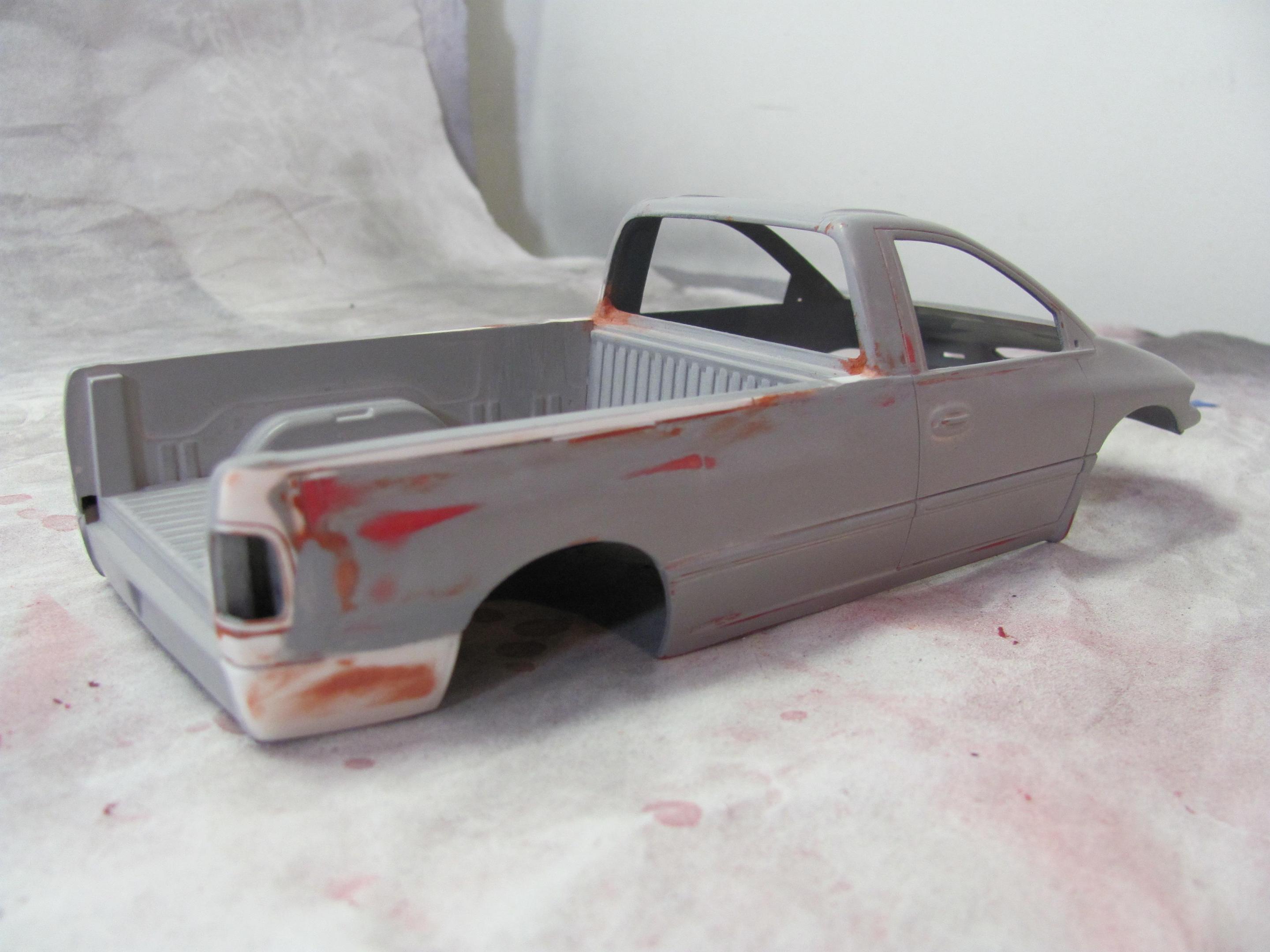

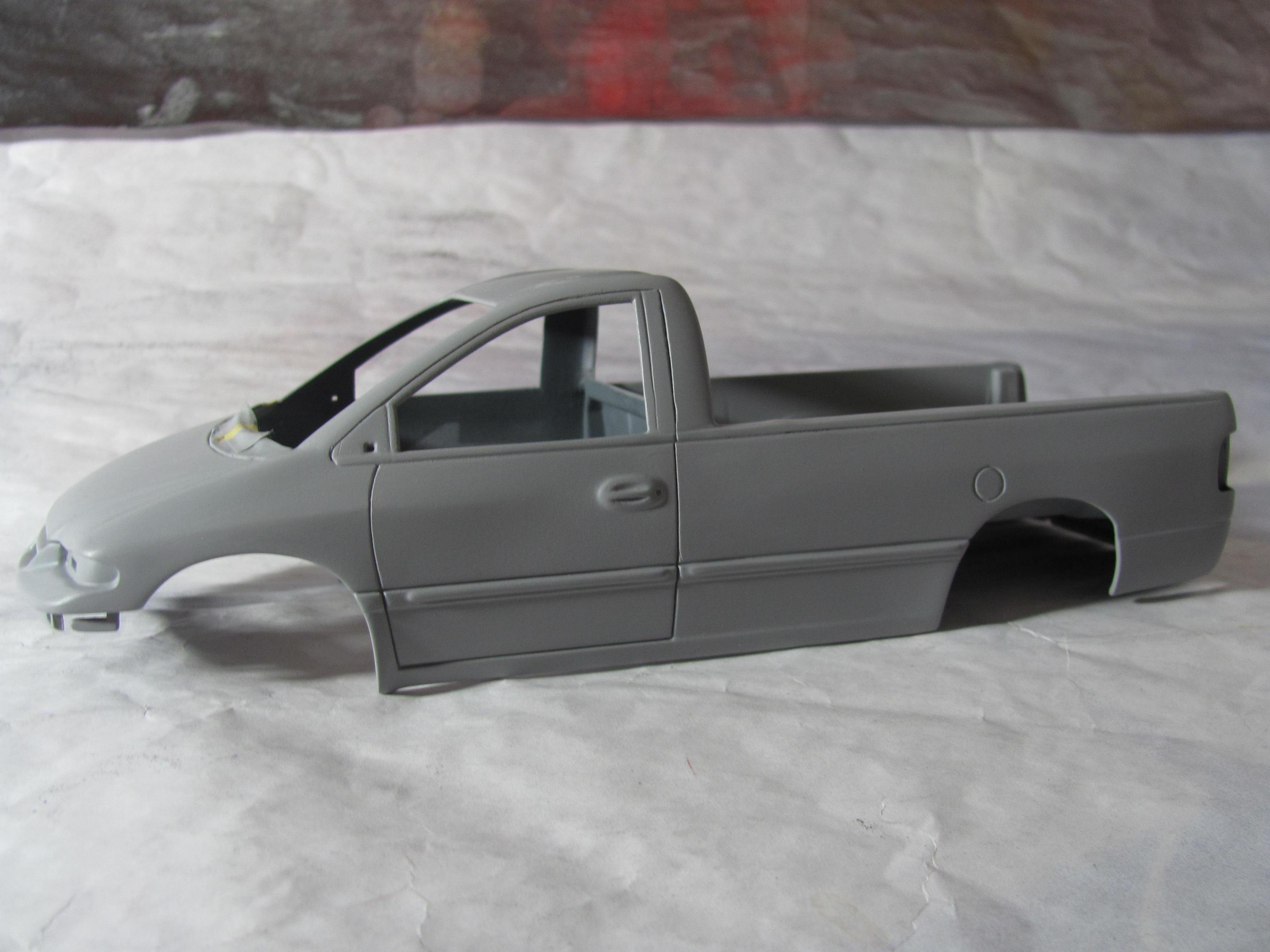

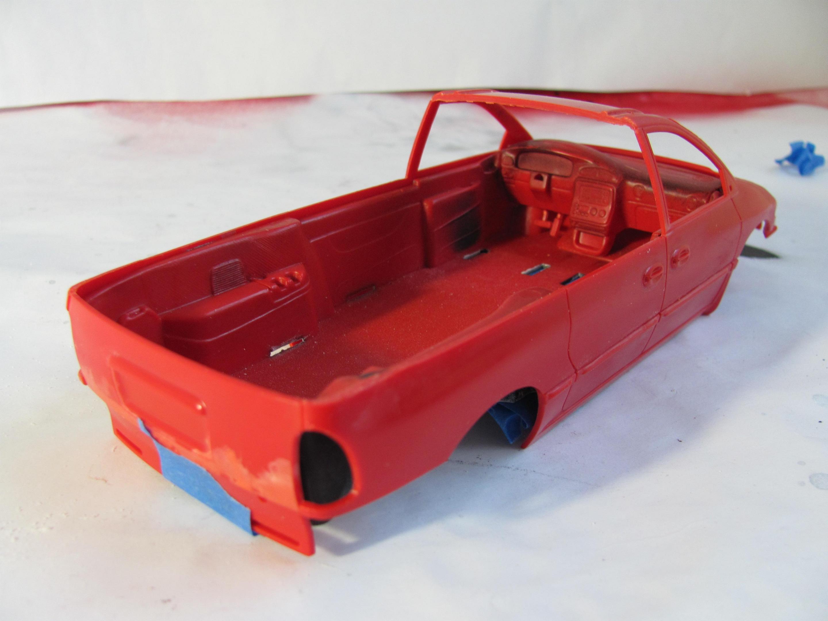

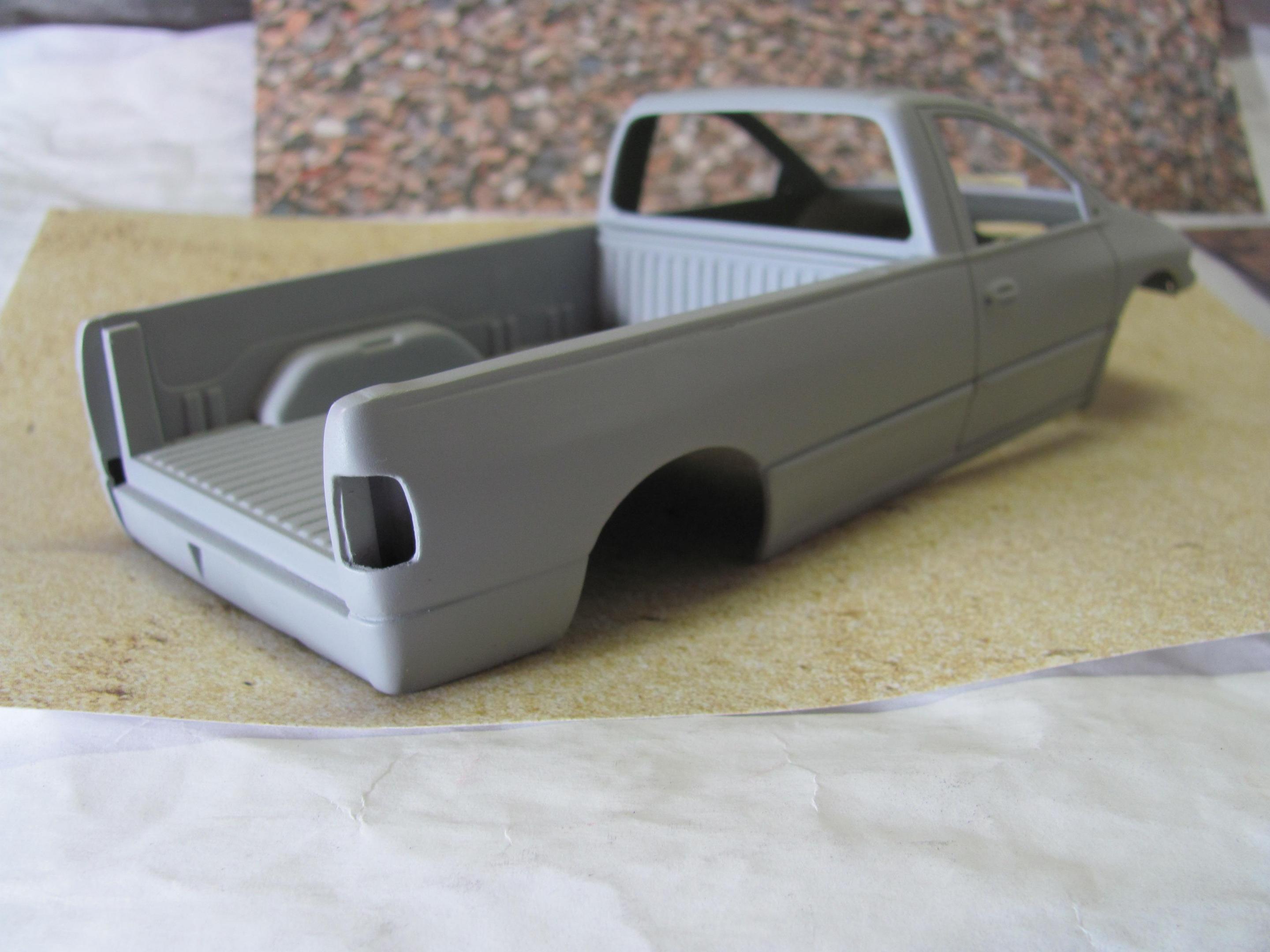

Finally I have an update & pics! (Camera & computer not getting along ?). I have been fighting & procrastinating over extending the "belt line" to the bed sides. I had envisioned a smooth side bed, however the belt line just fell into place and after several attempts at ignoring the obvious to achieve a smooth side, I finally relented!IMG_2042.thumb.JPG.52fbb60a99cbdb6236d0e494928a66e6.JPGIMG_2043.thumb.JPG.dd98cf1179e36f00076fcabd6dbee3f9.JPGIMG_2045.thumb.JPG.2117dcd7b3c6aa3d6cf5a9987359dbc9.JPGIMG_2044.thumb.JPG.2c72316859bda4d63822f1a3253e4d90.JPGIMG_2040.thumb.JPG.c70b8176cdd1e862e55a3f79fb280984.JPG
I added back up lights & removed the character lines from the tailgate. It is ready to paint at this point. Will post more pics then.

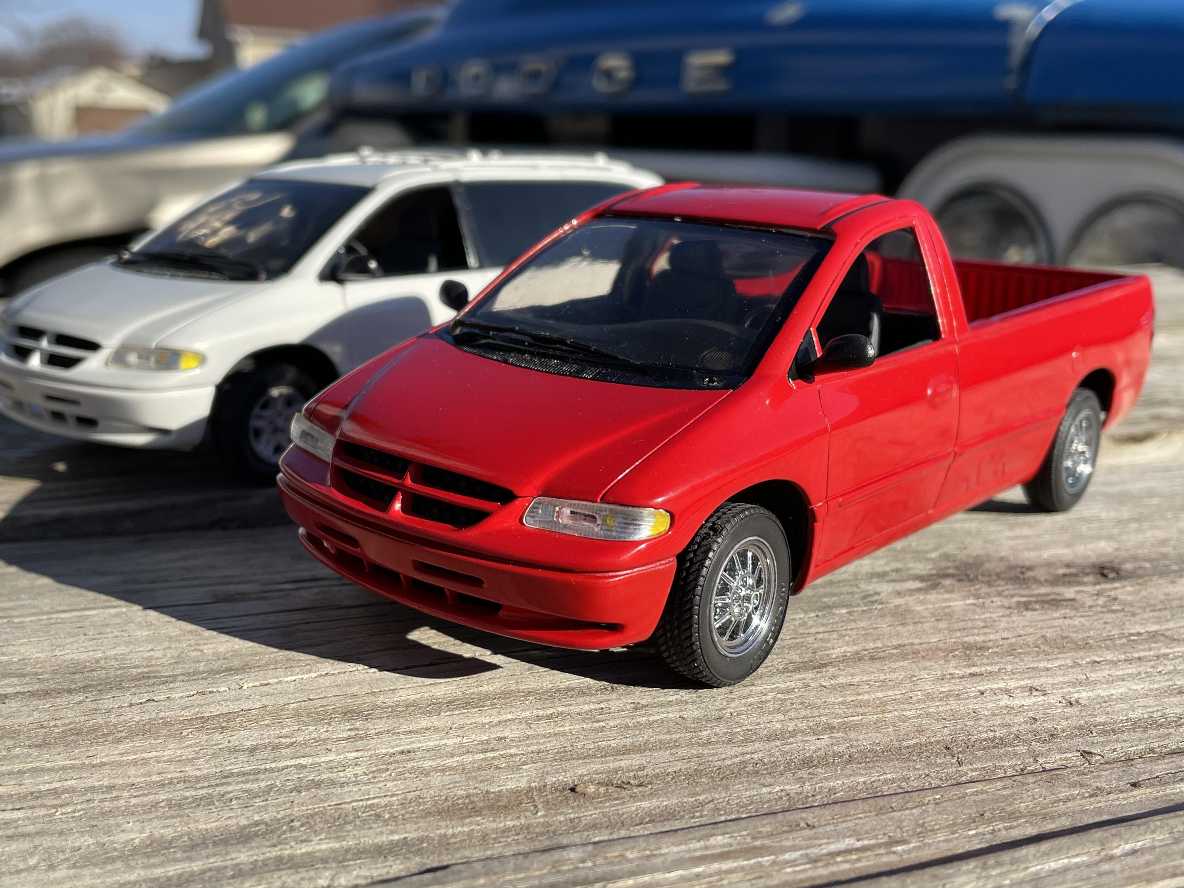

  • 1 year later...

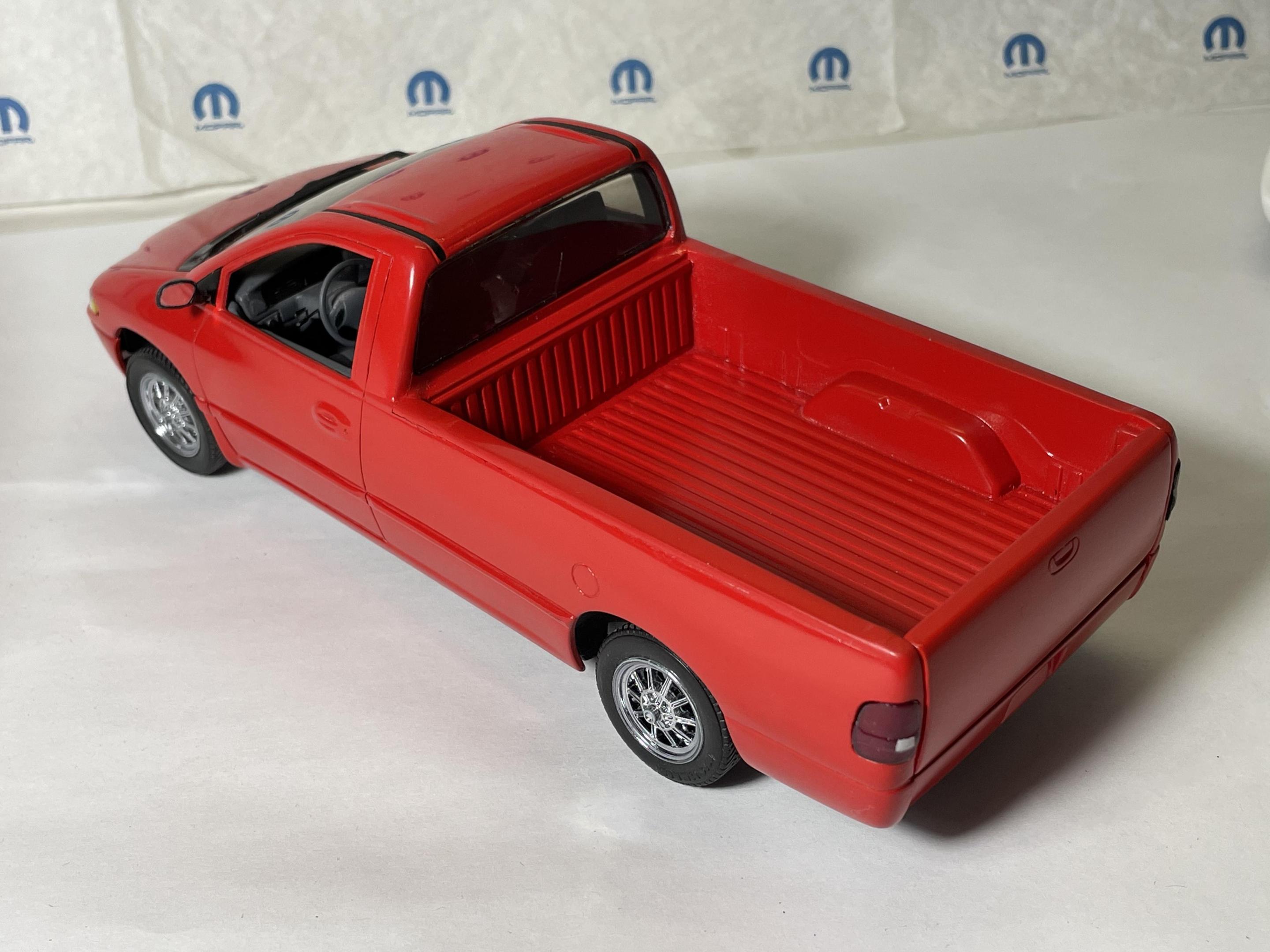

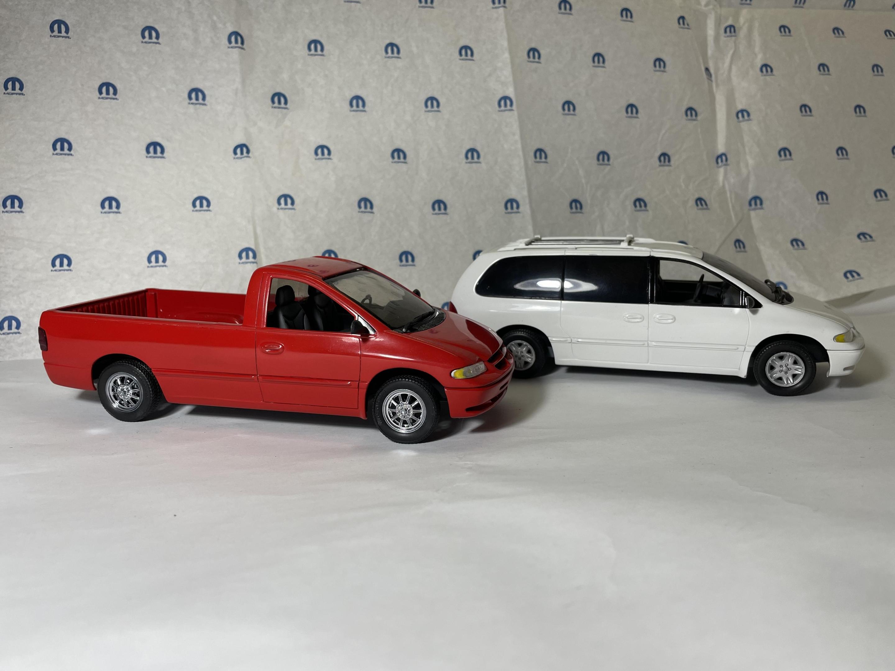

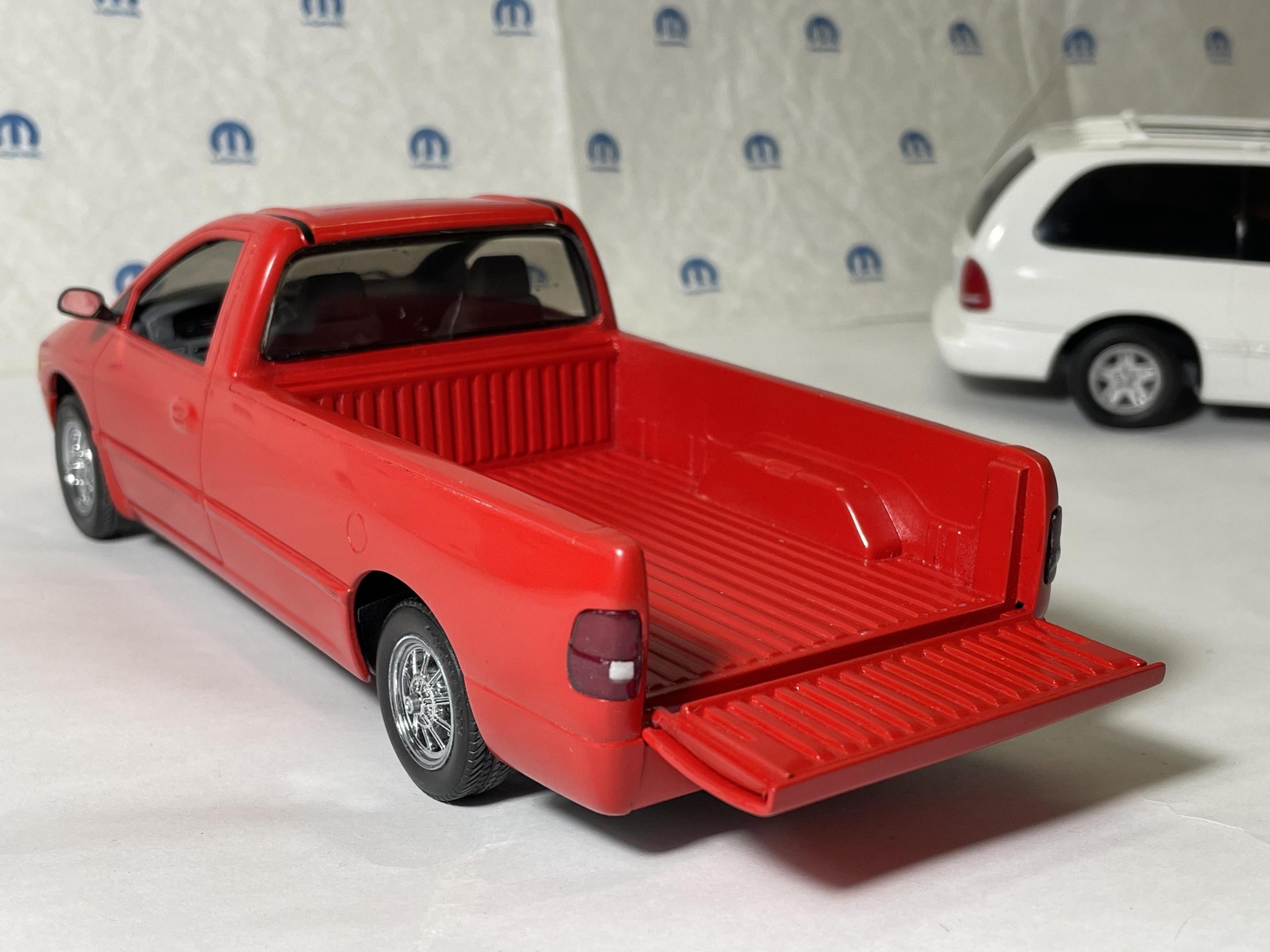

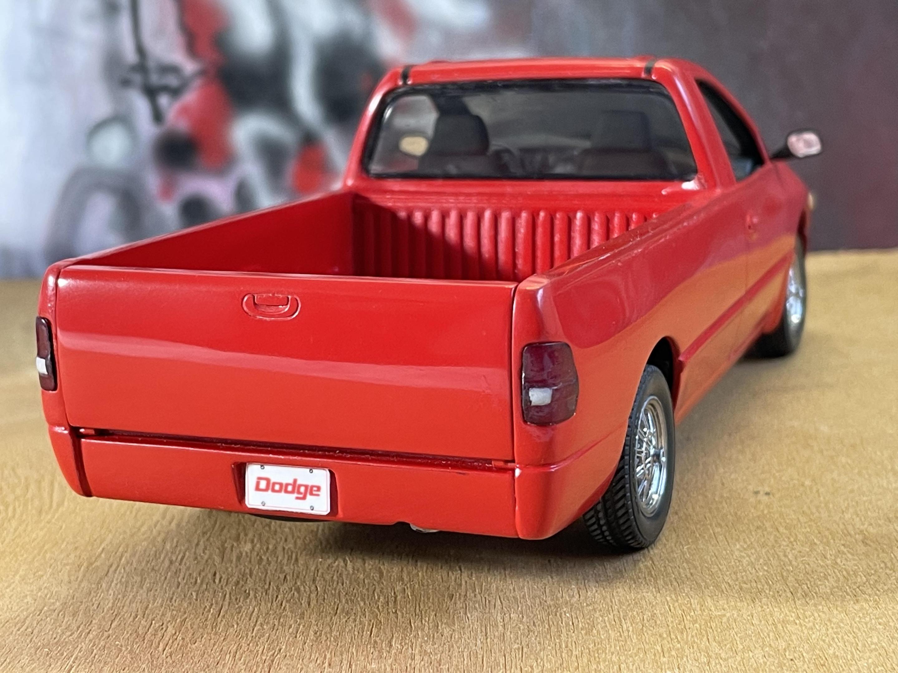

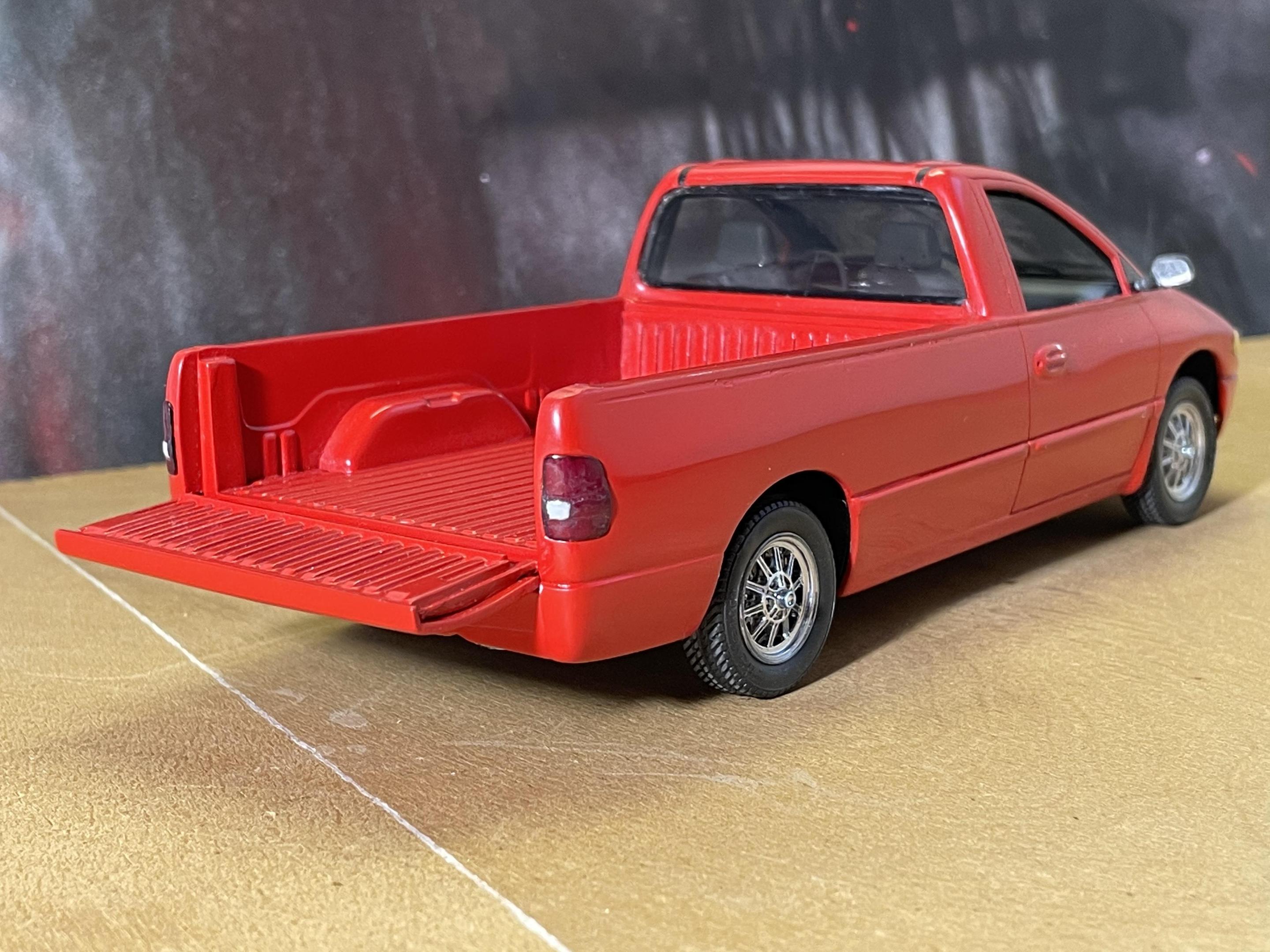

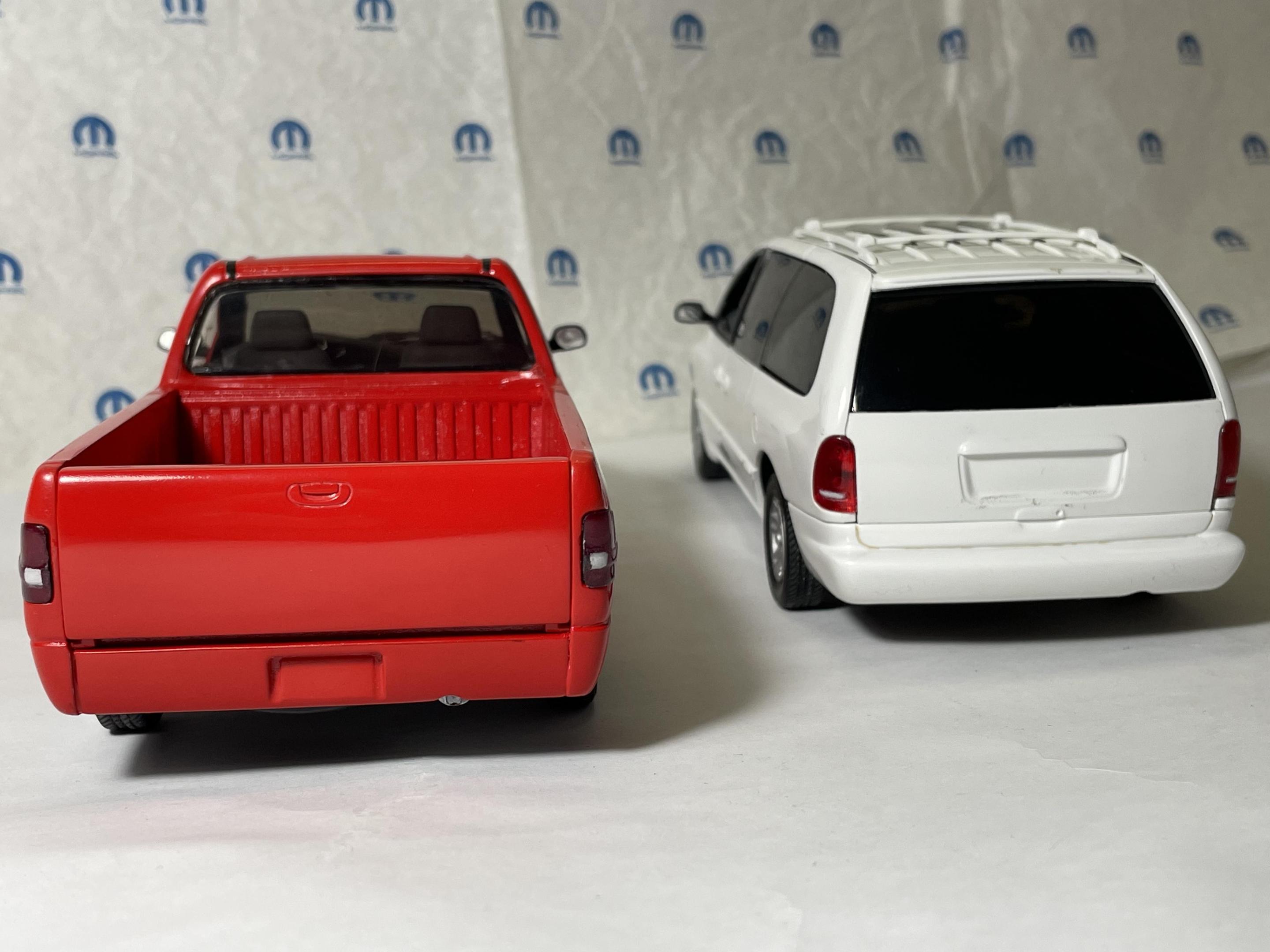

Two years to the day from when I started this thread and the CaraRam is finally painted and assembled! (It may still need the Ram emblem fitted to the tailgate?)DBC09656-807B-4D57-A55F-6406C6A6DF49.thumb.jpeg.ad554a2c01df0290698a0664891530b5.jpeg629128B1-7B8E-4BAE-B29B-6F5E1EE733DA.thumb.jpeg.b25ca908f886c75924151c05f0b8502e.jpegFEADAEDB-F4F9-41F1-88EA-B60B186EEB95.thumb.jpeg.34650157eb17df414edcc6561f54fc10.jpeg9F8CF5D8-A3A3-4BC1-923C-4FAD45F31F3F.thumb.jpeg.186c59d0bf6e36986e3066a8ce3abeb7.jpeg52EF091C-D4CC-4FF5-B473-EA9E58A57D77.thumb.jpeg.958ba0240fcfced75c1b2a1f175b6484.jpeg30FA7BBB-84F5-4338-83D9-4D1D6F589803.thumb.jpeg.95e348f3dcf85db66f7bb48e5bf11590.jpeg7087416B-9B25-4906-A999-D2D653AF7A00.thumb.jpeg.ff12af2ba95bbb49a4009a461f37f151.jpeg92999122-7A2C-4955-8850-D7C9DDF84606.thumb.jpeg.7233ca297c42f195db88b585608de1b7.jpegThanks for looking! All comments welcome.
That worked out really well! I really dig the proportions; it looks "right" to me. Very well done, and you painted it the right color!
Thank you! I chose red as it seemed to be a color Dodge used a lot in advertising ( as I recall) and as a nod to the A100 and the Lil Red Wagon.
7 hours ago, Mattilacken said:
Cool! Looks like something you could find in Brazil!
Thanks. That’s an intriguing comment as I really don’t know much about the vehicles there.
I've seen a few such conversions over the years, but this is the first one I've seen, real or in scale, that looks absolutely correct and production ready. The best phantoms are the ones that keep you guessing whether it is a production vehicle or not. That's one minivan I would drive every day. 10/10.
Nicely done! The end result is very convincing. I can just imagine that van hauling painting supplies in Mexico or something.
Ditto Mike's comments above!
That's a perfect 'his' and 'hers' combination for the family transportation stable. The names you came up with got me thinking......"El Caravano" and  "El Carnero"....so is that like traveling meat eaters?
