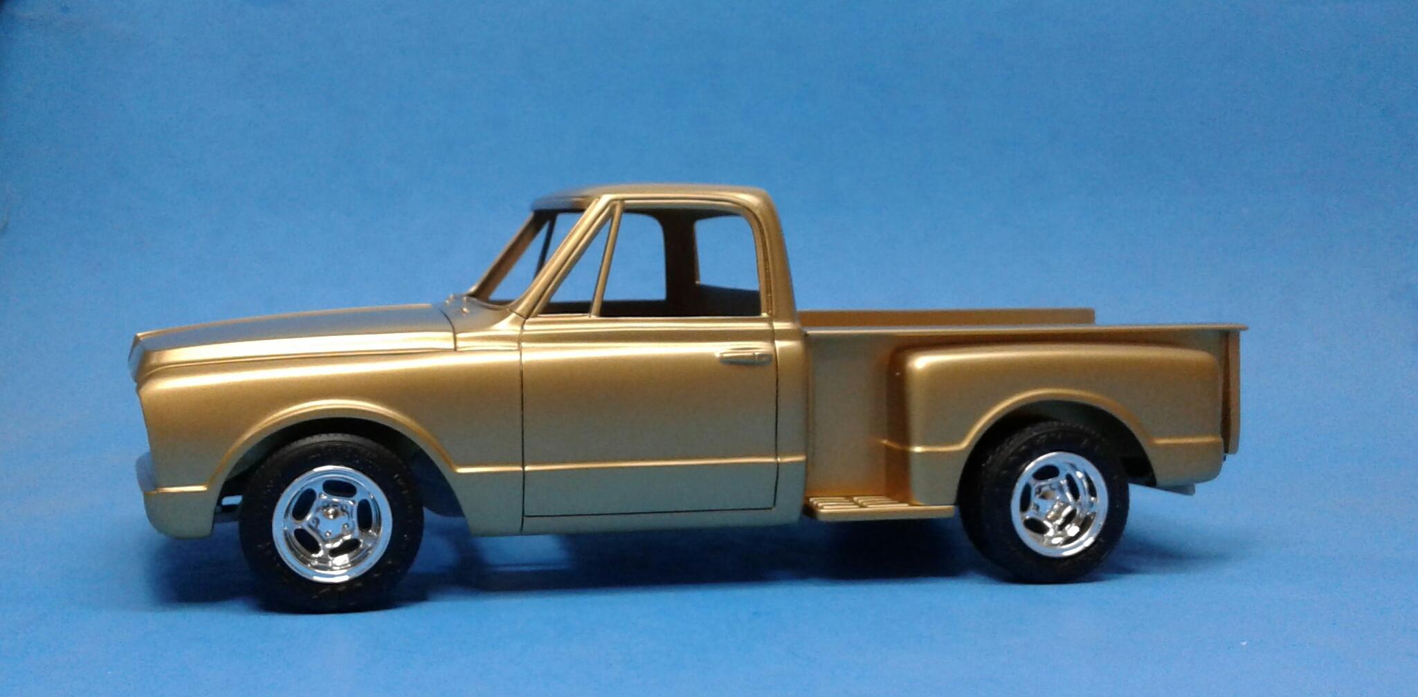

Plowboy Posted April 8, 2020 Posted April 8, 2020 (edited) I got this MPC kit from Tom Kendall in a trade. I loved this kit when I was a kid! I thought that boxart was so cool! Of course when I built it then, it looked like garbage. Runny paint, glue smears, crooked decals. It had it all! Now, I have a second chance! This model is going to be just for fun. No detailing, corrections, etc. Just like when I was a kid! It's going to be a tribute build (not a faithful rendition) to the boxart. Only better. No long stepside bed! Ugh! That was one thing I really disliked about this kit. In just a little while and swapping the chassis plate and bed with the AMT '72 GMC, I had a better looking Chevy stepside. The tail gate was just a touch too tall. I removed 1 mm from the bottom. I removed the Cheyenne trim as I couldn't find a stepside with that trim anywhere in my research. Plus, it just looks wrong with a stepside bed. I also decided to get rid of the non matching marker lights. They didn't match on the original fenders either. I filled in the cab corners and the recess on the rear stake pockets. I opened the grille to make it see through. This was the most time consuming and difficult grille I've ever done! I literally wore the chrome off from handling it so much! And I'm still not done! I'm going to also get rid of the molded in headlights. That shouldn't be too difficult. Once they're done, I'll paint the grille, do the blacked in the recesses and do the surround with a Molotow pen. The plan is to paint it gold and if the decals hold together, use them also. I'm going to change the color of the seats/interior to some kind of tan instead of white. Not sure about the side pipes. I may fix them so they can be installed and removed easily. Should be in primer soon. Edited April 8, 2020 by Plowboy

Plowboy Posted April 12, 2020 Author Posted April 12, 2020 I got the body in paint! It's Tamiya Gold. I'm going to shoot a coat of clear, add the decals and shoot more clear.
Can-Con Posted April 12, 2020 Posted April 12, 2020 (edited) Roger, is the overall width of your bed the same as the width of your cab? I"m asking as I'll be starting on mine soon and the rear fenders have always looked too narrow to me. I did widen the fenders on the last stepside I did and plan to do it on this one as well. , , Update, measured mine, found that the bed is 79mm wide, abiut right. Bed with fenders is '74mm wide. So, my fenders need 2.5mm added to each. Yours looks great in that gold paint !! Edited April 13, 2020 by Can-Con
gotnitro? Posted April 12, 2020 Posted April 12, 2020 Wow nice work ! That short box definitely looks better
Plowboy Posted April 13, 2020 Author Posted April 13, 2020 17 hours ago, Can-Con said: Roger, is the overall width of your bed the same as the width of your cab? I"m asking as I'll be starting on mine soon and the rear fenders have always looked too narrow to me. I did widen the fenders on the last stepside I did and plan to do it on this one as well. , , Update, measured mine, found that the bed is 79mm wide, abiut right. Bed with fenders is '74mm wide. So, my fenders need 2.5mm added to each. Yours looks great in that gold paint !! I hadn't just because I'm not concerned about it. This build is just for fun. I measured the cab and bed. The cab is 77 mms. The bed is 74. Off quite a bit. But, not enough for this model. I don't know if it would be worth the effort to add 1.5 mms to each fender and the stepboards. I probably would if I wanted to tuck the tires in.
espo Posted April 13, 2020 Posted April 13, 2020 2 hours ago, Plowboy said: I hadn't just because I'm not concerned about it. This build is just for fun. I measured the cab and bed. The cab is 77 mms. The bed is 74. Off quite a bit. But, not enough for this model. I don't know if it would be worth the effort to add 1.5 mms to each fender and the stepboards. I probably would if I wanted to tuck the tires in. This is really looking nice so far. Something to remember on the bed width. The width of the bed and the fenders is about as close as can be to the Cab. The step-side bed it's self has always been narrower than the Cab.
gman Posted April 13, 2020 Posted April 13, 2020 21 hours ago, Plowboy said: I got the body in paint! It's Tamiya Gold. I'm going to shoot a coat of clear, add the decals and shoot more clear. That looks really good so far- the paint, the truck, everything. I am looking forward to seeing it under clear coat.

Plowboy Posted April 18, 2020 Author Posted April 18, 2020 Thanx Carl! I got the interior finished and ready to install. I tried to de-Cheyenne it some by painting the woodgrain sections black. And big surprise. The decals didn't work out even after sealing them. May be a good thing as I probably wouldn't have liked them anyway. I'm liking the way it looks now that I have the paint polished. I should have it done in a couple of days or so.
slusher Posted April 19, 2020 Posted April 19, 2020 Roger, you really do nice work. I really like the interior...
Modlbldr Posted April 19, 2020 Posted April 19, 2020 Roger, Great looking work! You've done a beautiful job on this. Love the stance and the color. I'm glad this went to you. I have another set of those decals, if you want to try again. Let me know. Later-
