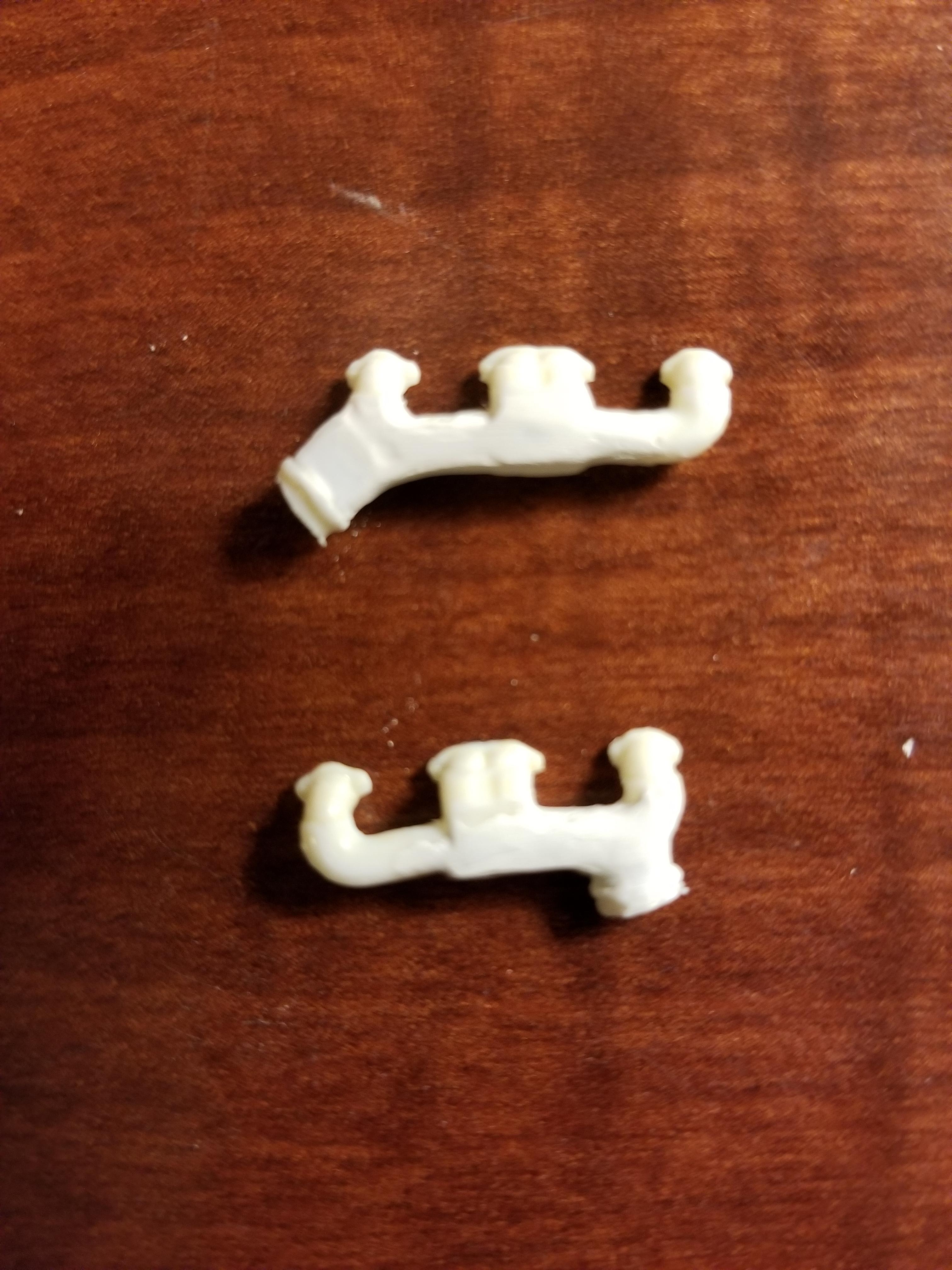

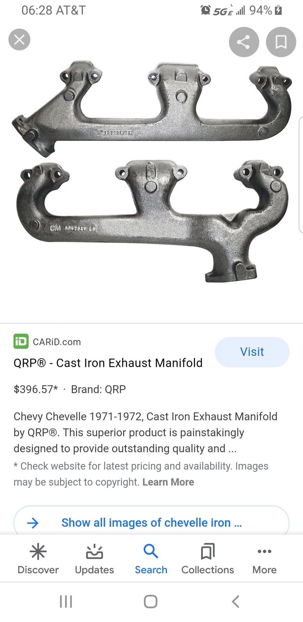

I got a little more accomplished on the Chevelle. Below is a photo of the stock exhaust manifolds for a 2-bbl v8. You can see why it only made 130 hp!

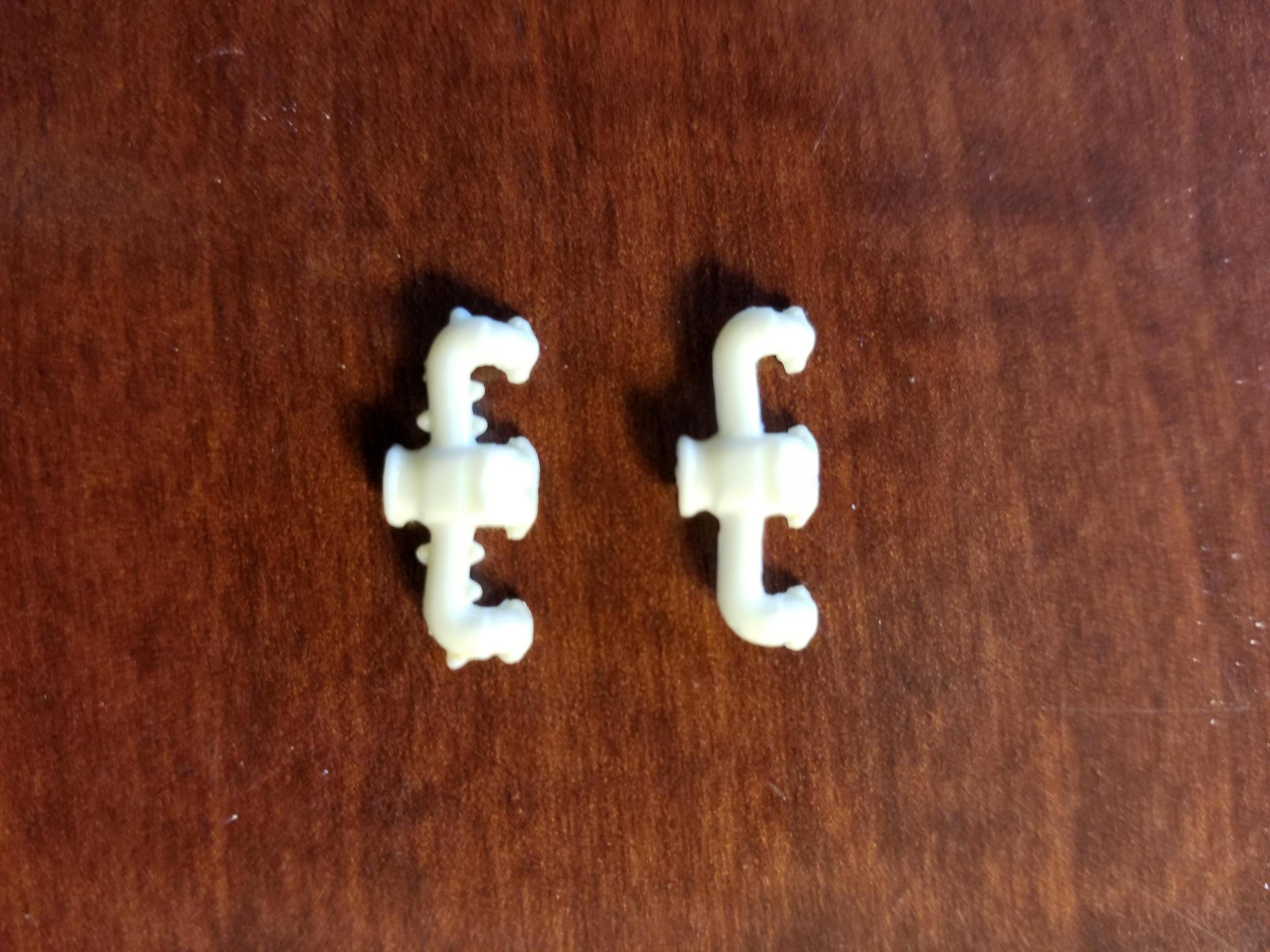

I started with a set of manifolds from a Monogram C4 Corvette. The one on the right has had all the bumps removed.
Here they are after modification.

Thanks. I've got an original Mule Skinner pickup but it would be a shame to part it out. The exhaust manifolds are not that obvious from the top, but the connections to the y-pipe on the bottom will look better this way.
Nice exhaust manifolds. The original Revell '69 Nova SS kit offered stock exhaust manifolds as well as headers. The stockers would be a very close match to your stock exhaust.
