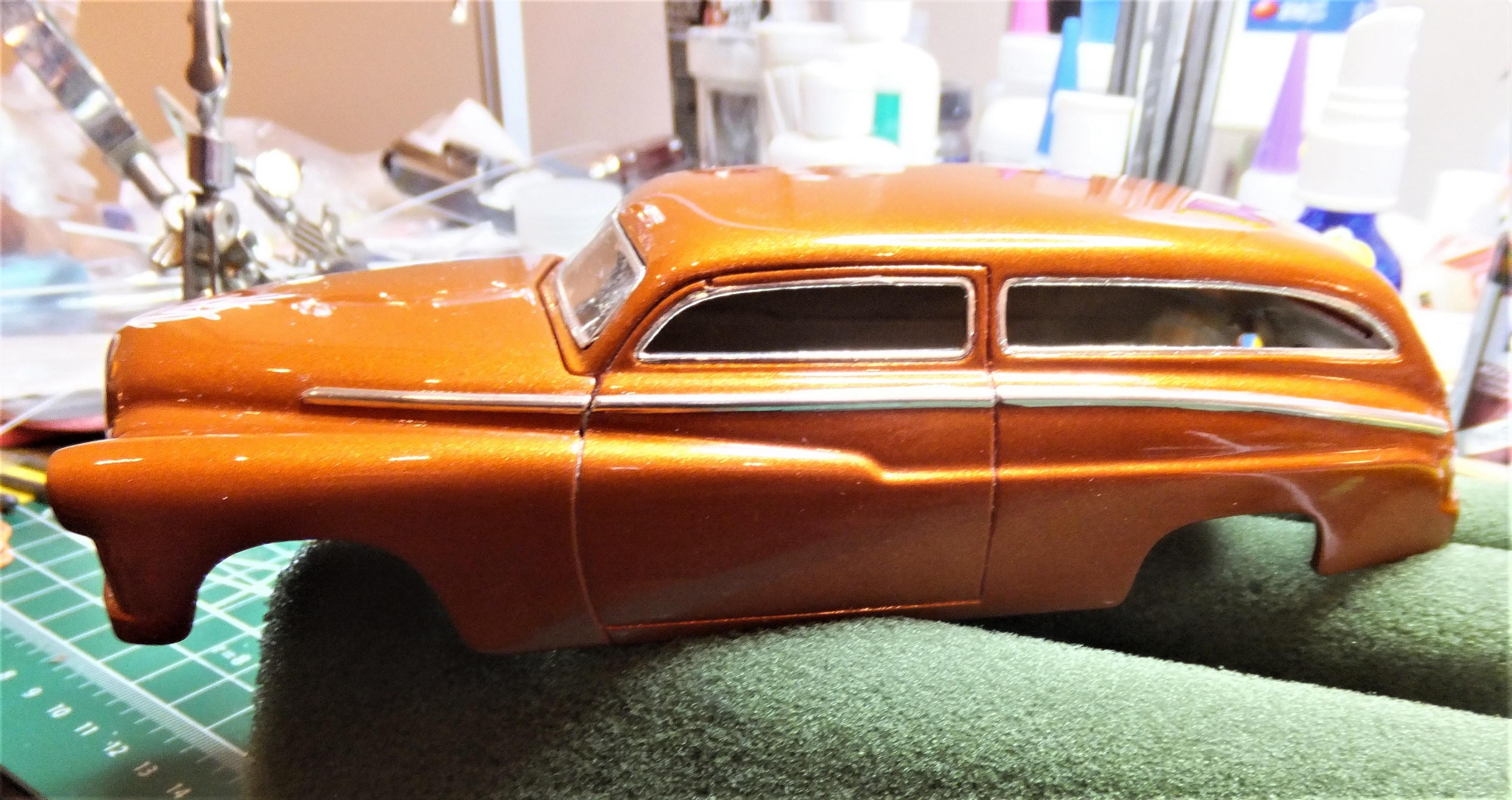

Given the look of the body, I decided to add accent trim to accentuate the shape.  Using Evergreen half round, I shaped "spear point" ends and glued to the body.

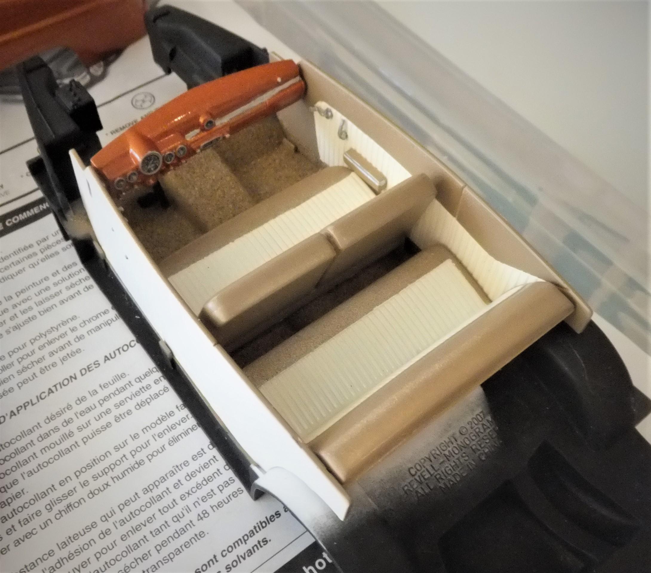

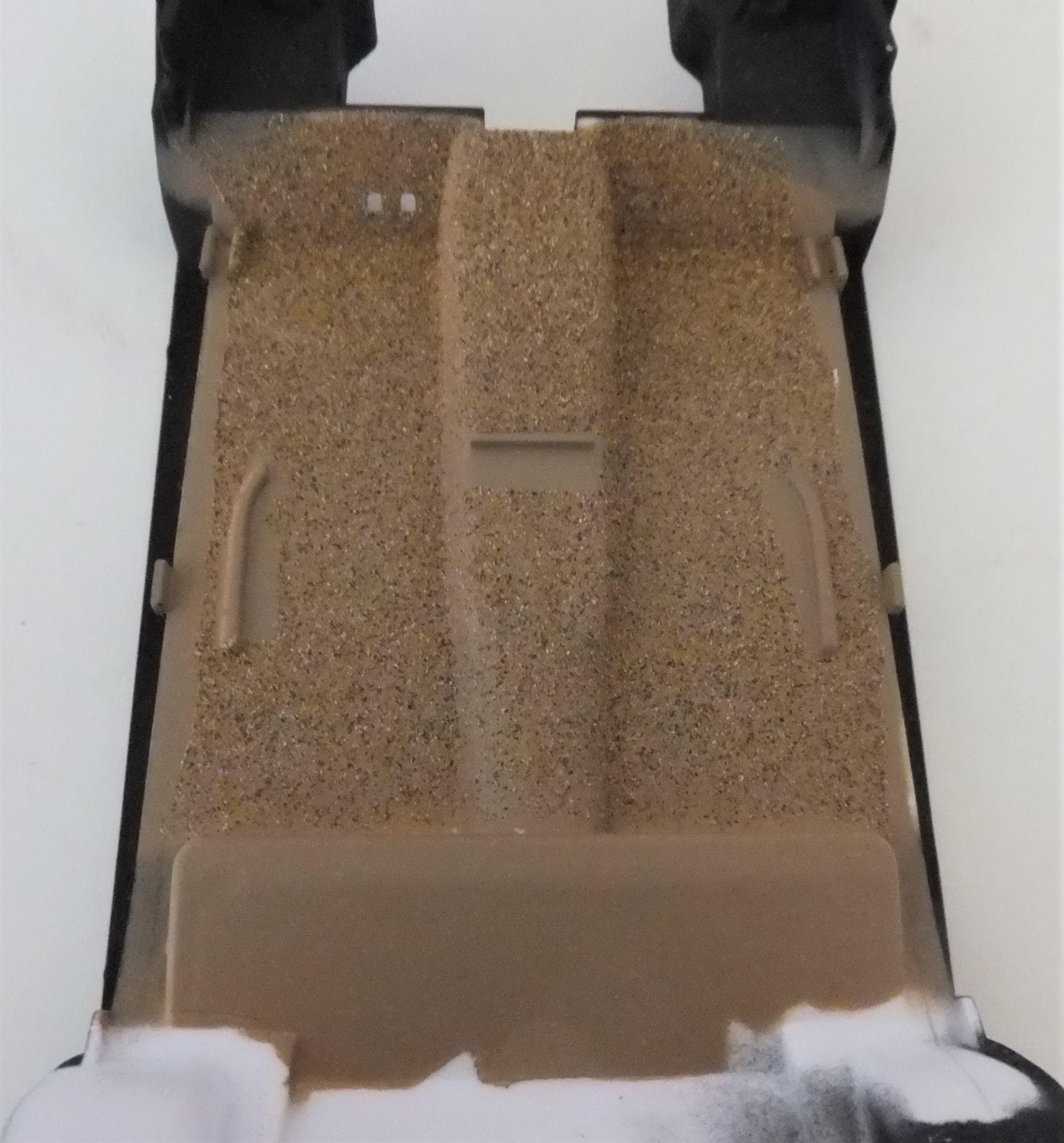

Since the roof is chopped, the interior is difficult to view.  So I used a technique of spraying paint with granules  used to simulate artifical stone.  It gives a reasonable appearance of standard carpeting.

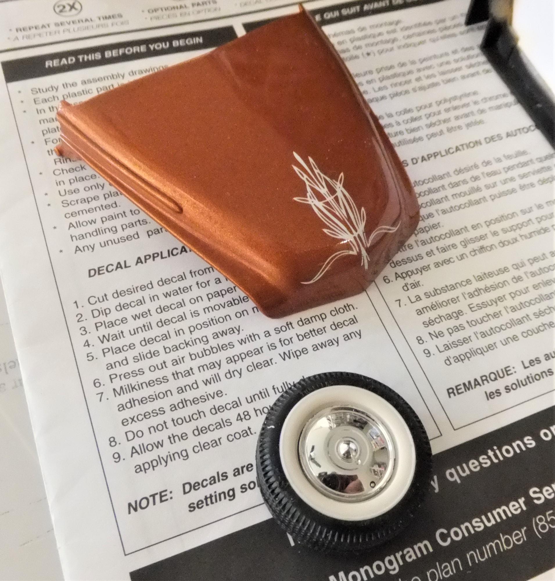

I used Testors Extreme Lacquer Fiery Orange shot from the can, as my airbrush compressor is still in the moving box and yet to be set up.  Followed by Wet Look, again from the can.  In between, I added a couple of pinstripe decals from Gofer Decals.  Allowing it to cure before polishing.  I used Tamiya Wood Tan and Racing White for the interior followed by their semi-gloss clear.  I dug into my diminishing stash of AMerican Satco wide whitewalls and coupled them with a wheel set I got from Fujimi 20+ years ago.

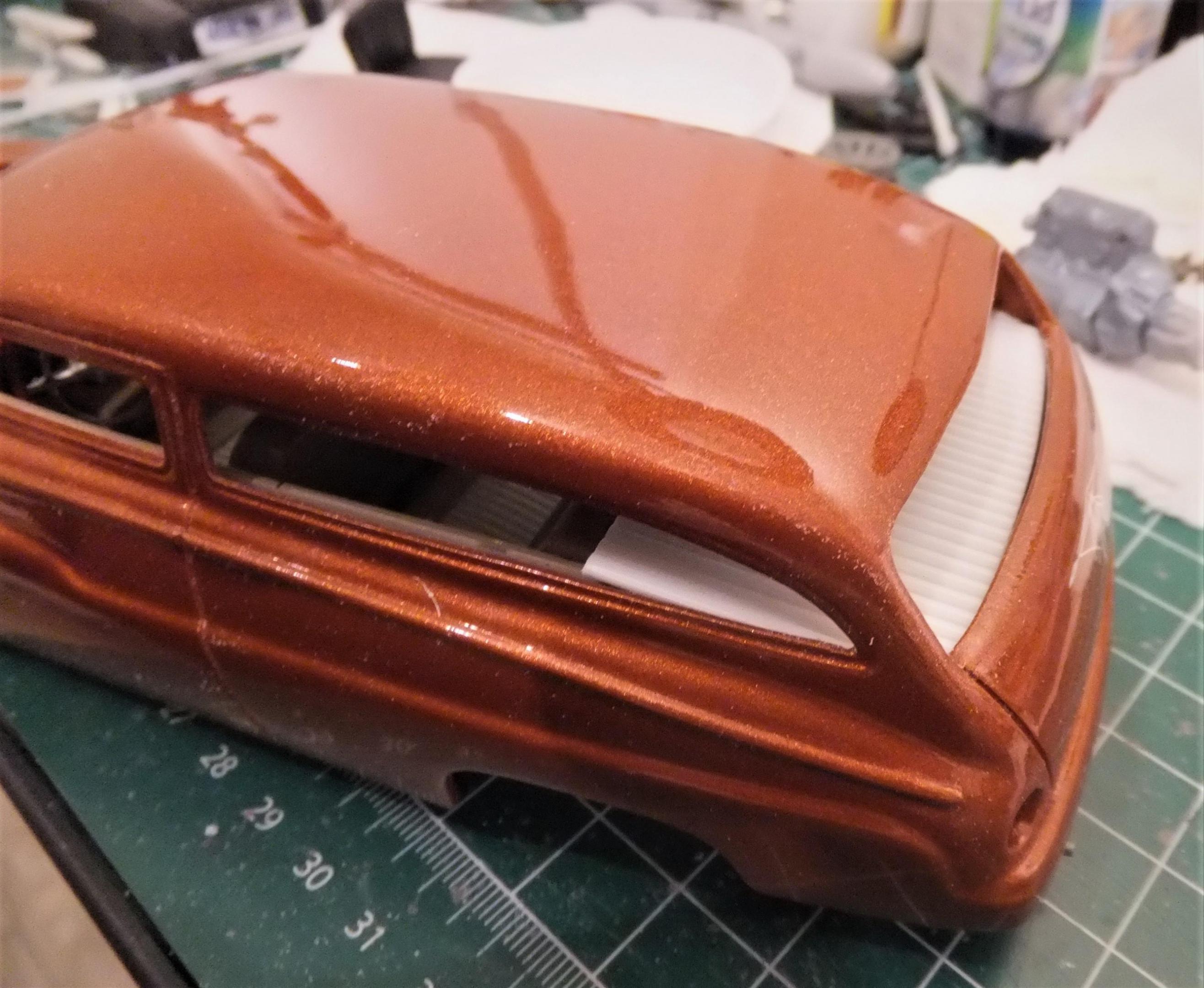

I have the body initially polished and will wait until rear window creation and back shelf are finished before final polish and BMF for the chrome accent.
The resin kit has templates for the rear side windows and shelf, but not rear window.  I have clear styrene to make these and will create a template for the rear window.  After these are cut and fitted, I will finish off the shelf and then, final polish on the body.
For the shelf, I decided to do a tufted finish like the door panels and seats, rather than carpet.  I was going to use Evergreen half round for it until I discovered that a HO scale corrugated roof sheet is close enough to the size to use that.  Once the basic shelf is fitted, I will apply the corrugation to it and smooth it all out.

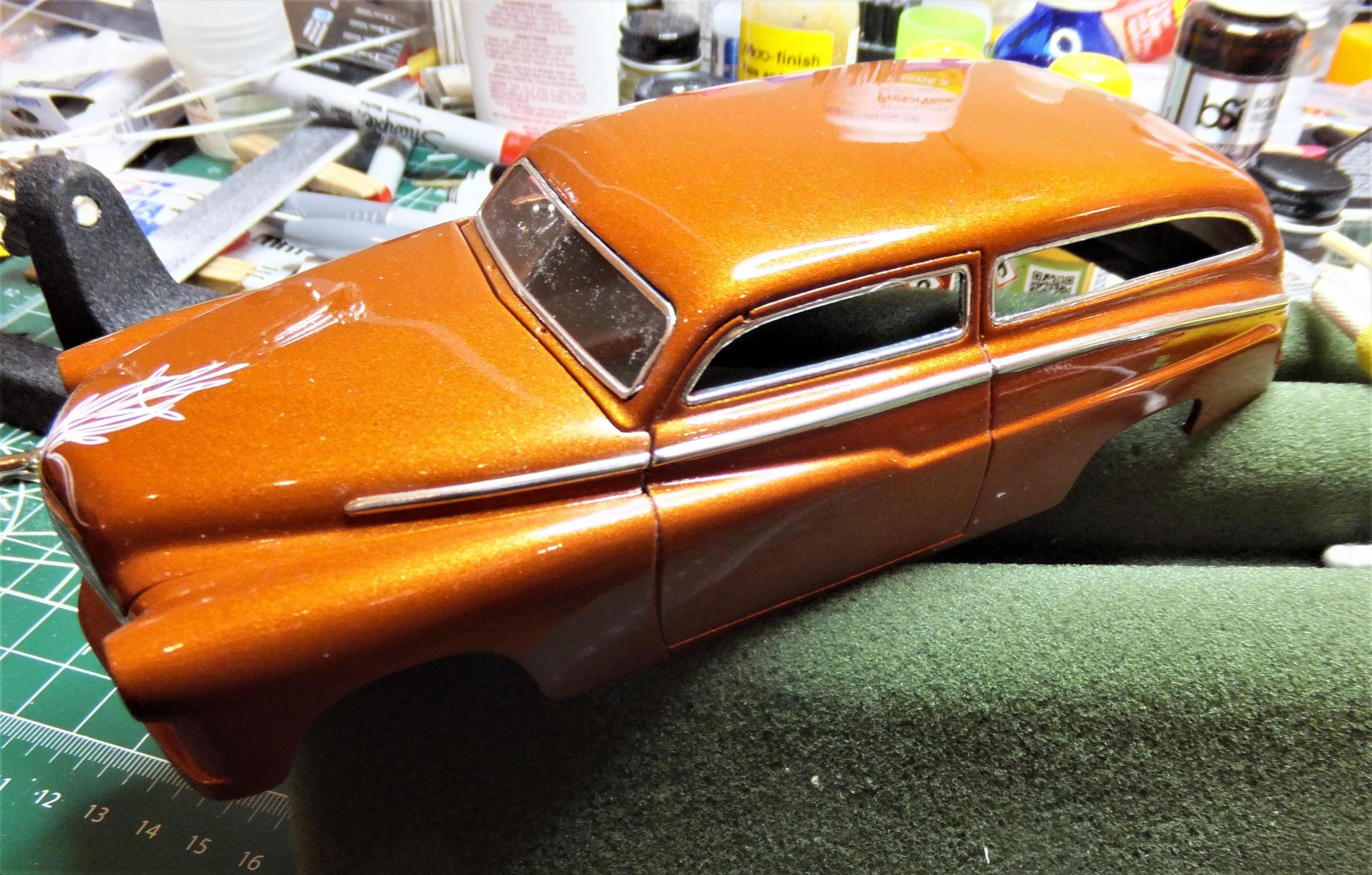

Pulled this guy back out as to get the bodywork to a finished state.  BMF is about half done.  I think, in retrospect, the side body trim is too large.  I was concerned that the dark color would "swallow" a smaller trim piece.  Anyway, it is what it is and staying there.

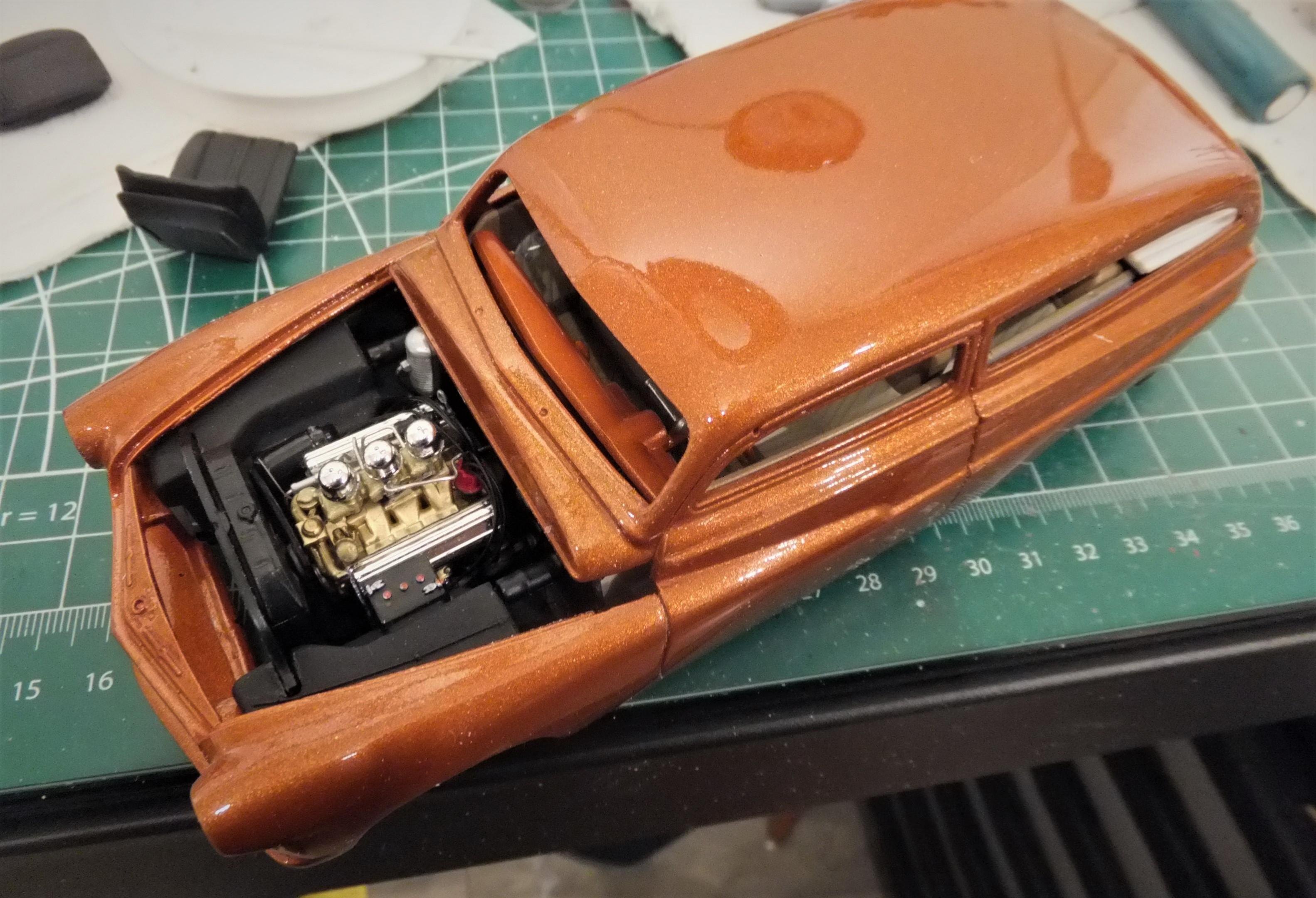

13 hours ago, Exotics_Builder said:
Test fit on exhaust system.  Anyone have an idea of where this is going?
Looks like flame throwers
