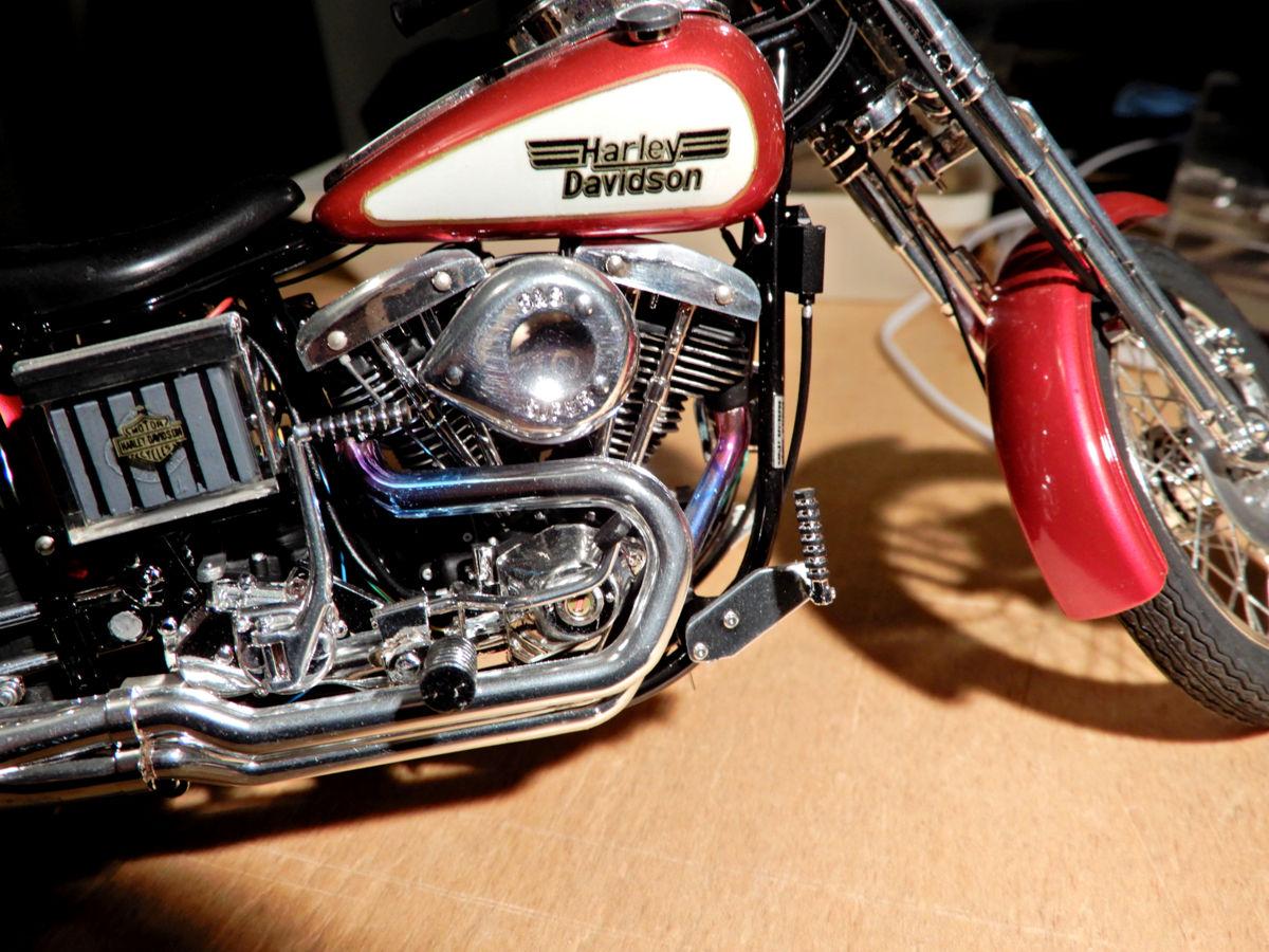

peteski Posted January 6, 2021 Posted January 6, 2021 I have only done the heat-bluing process on motorcycle models. Here is one of them (1:12 scale HD Springer). I think that even on that one it is slightly overdone (by me).

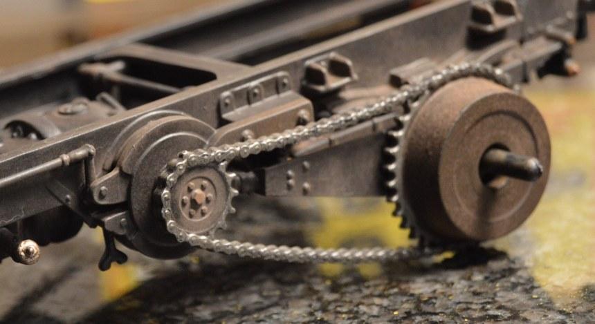

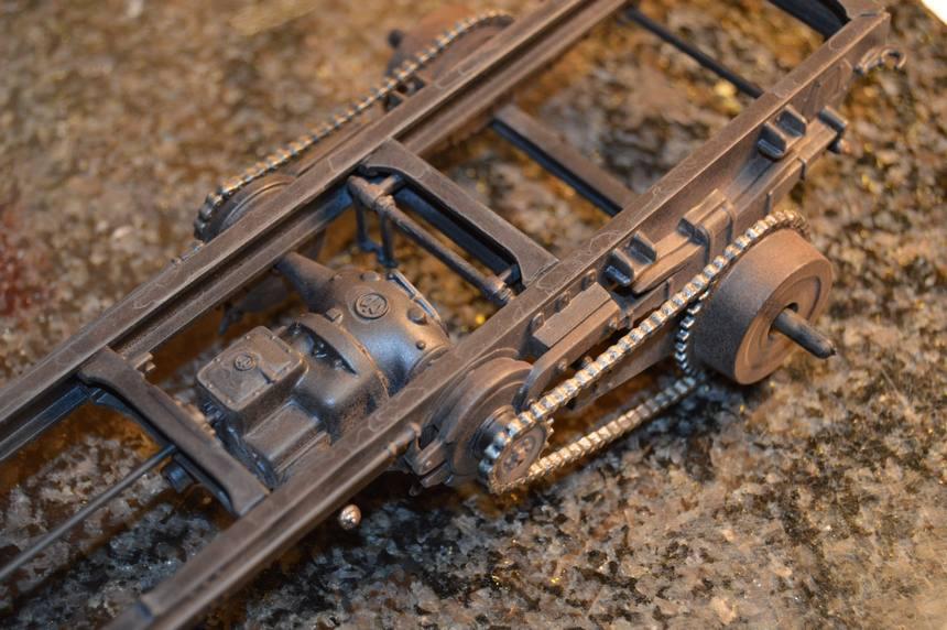

Straightliner59 Posted January 9, 2021 Posted January 9, 2021 On 1/8/2021 at 10:48 PM, chepp said: I didn't have much luck in using any of the powders. I think that they need a matte or flat surface for best results. Expand I suspect that the powders are nothing more than ground pastel chalks. It does work great, and look beautiful applied to flat or semi-gloss paint, but, it definitely needs some "teeth" to stick to. Then, it needs to be set with a clear coat. Many people use hair spray, to set it. This chassis is pastels over semi-matte black, dry-brushed with a mixture of oils and enamels. Finally, working in sections, I applied a mixture of ground pastels. and set it with Dullcote. I need to coat the chain with something oily-looking.
