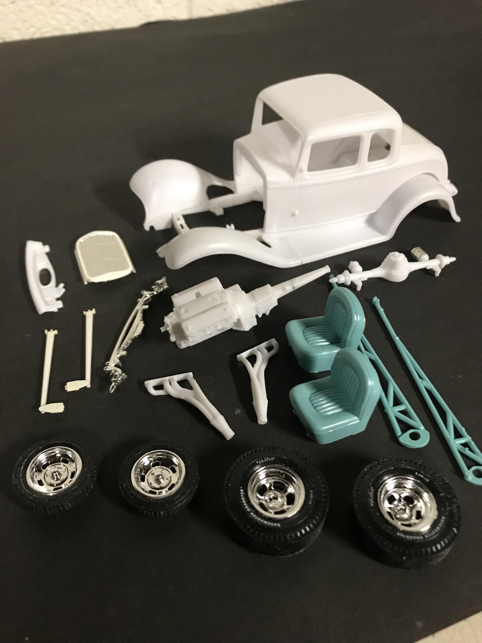

I have collected parts and here is whit I have so far:
Body: Revell 32 5 window coupe
Engine: Revell 57 Ford Y block with fenderwell headers, Edelbrock valve covers, 2 4brl carbs with air cleaners from the Hemi in Revell 32 kit
Rear tires: AMT Racemaster slicks with Halibrand kidney bean mags
Front tires: AMT front tires from the 41 Willys with Halibrand kidney bean mags
Front suspension: chrome tubular axle from Revell 32 kit (will be modified), split wishbones from the Revell 29 roadster
Rear Suspension: Ford 9" rear from Revell 32 kit, air bags removed and coil springs attached, long ladder bars from Revell 41 Willys SW&C gasser
Misc: moon tank, seats from the Revell 41 Willys, gas pedal from AMT 41 Willys,

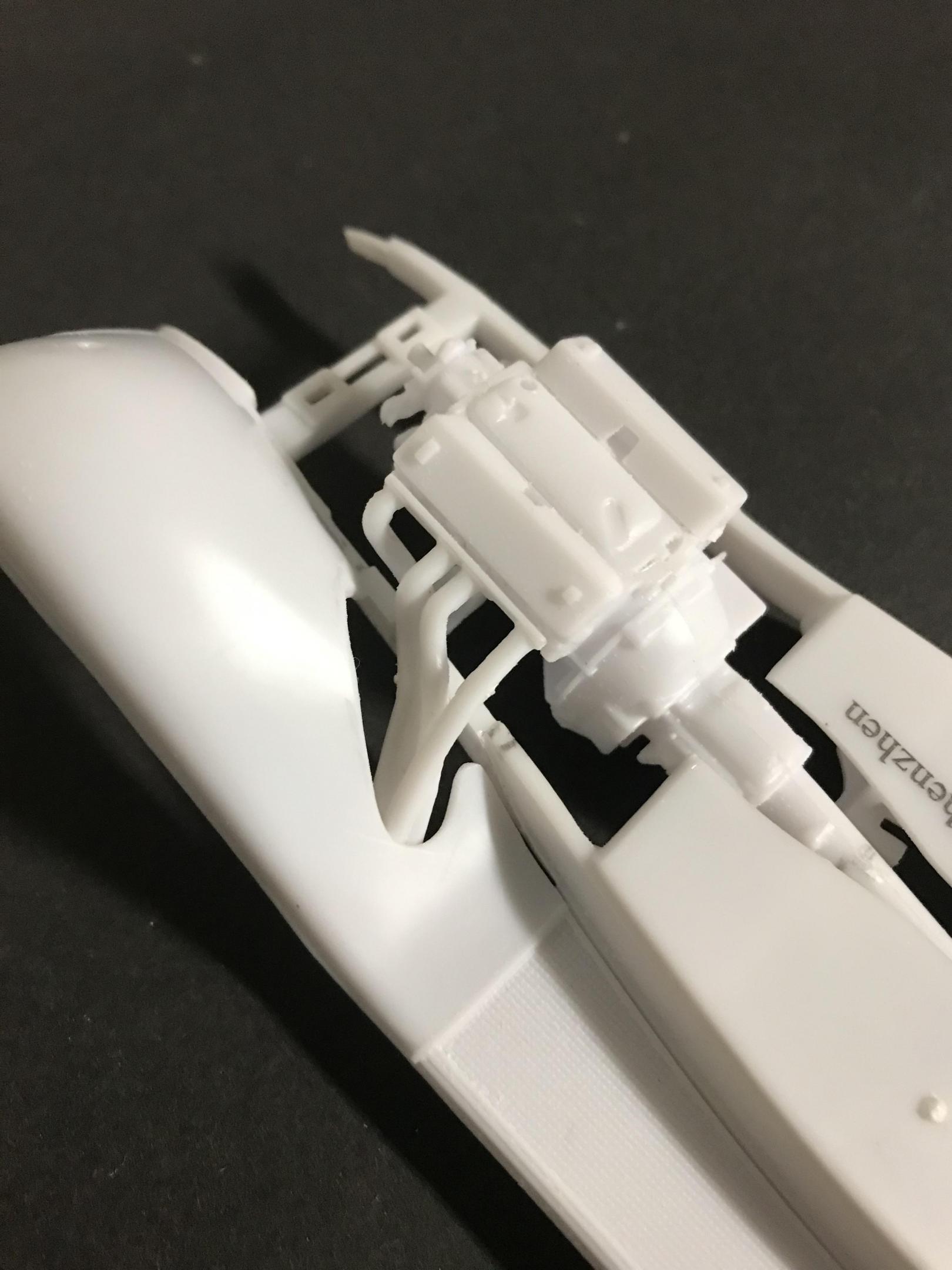

The first order of business (and one of the primary features I wanted to highlight) was to get the headers through the fenders. I love the look of the headers tucked up under the front fender behind the front wheels. I cut both fenders and test fit the headers before attaching the fenders to the frame. I got lucky with the Y block motor mounts lining up with the 32 frame without having to create my own. (not accurate, but I'm trying to keep the scratch building at a minimum)

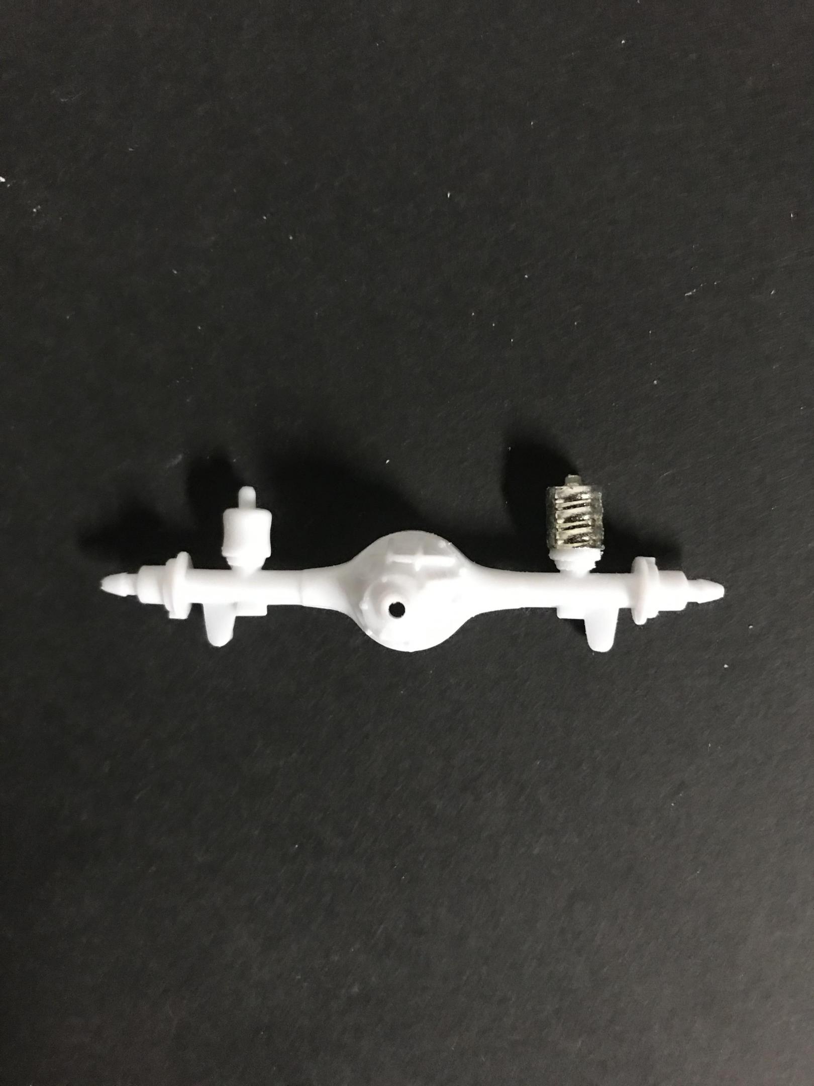

Next up was the rear end. I'm using the Ford 9" rear from the kit, but the air bags had to go. I found some coil springs in the Ala-Kart kit that gave me the extra height I needed for the larger slicks. The coil springs would have been mounted behind the rear axle but agin, I'm trying to keep it simple.

I made a panhard bar by using one of the rear trailing arms from the 57 Ford gasser kit and "welded" it to the front of the rear end. The other end will be attached to the frame in final assembly. I also cut the axles to accept the ladder bars and mocked them up. They will be shortened and mounted to the same bracket the front bones are mounted to, so I'll need to figure out the front end placement before finalizing the ladder bars. The radiator from the AMT Willys gasser was a great fit in the 32 grill shell. I just needed to sand the front to a desired thickness to make it appear recessed into the shell.
