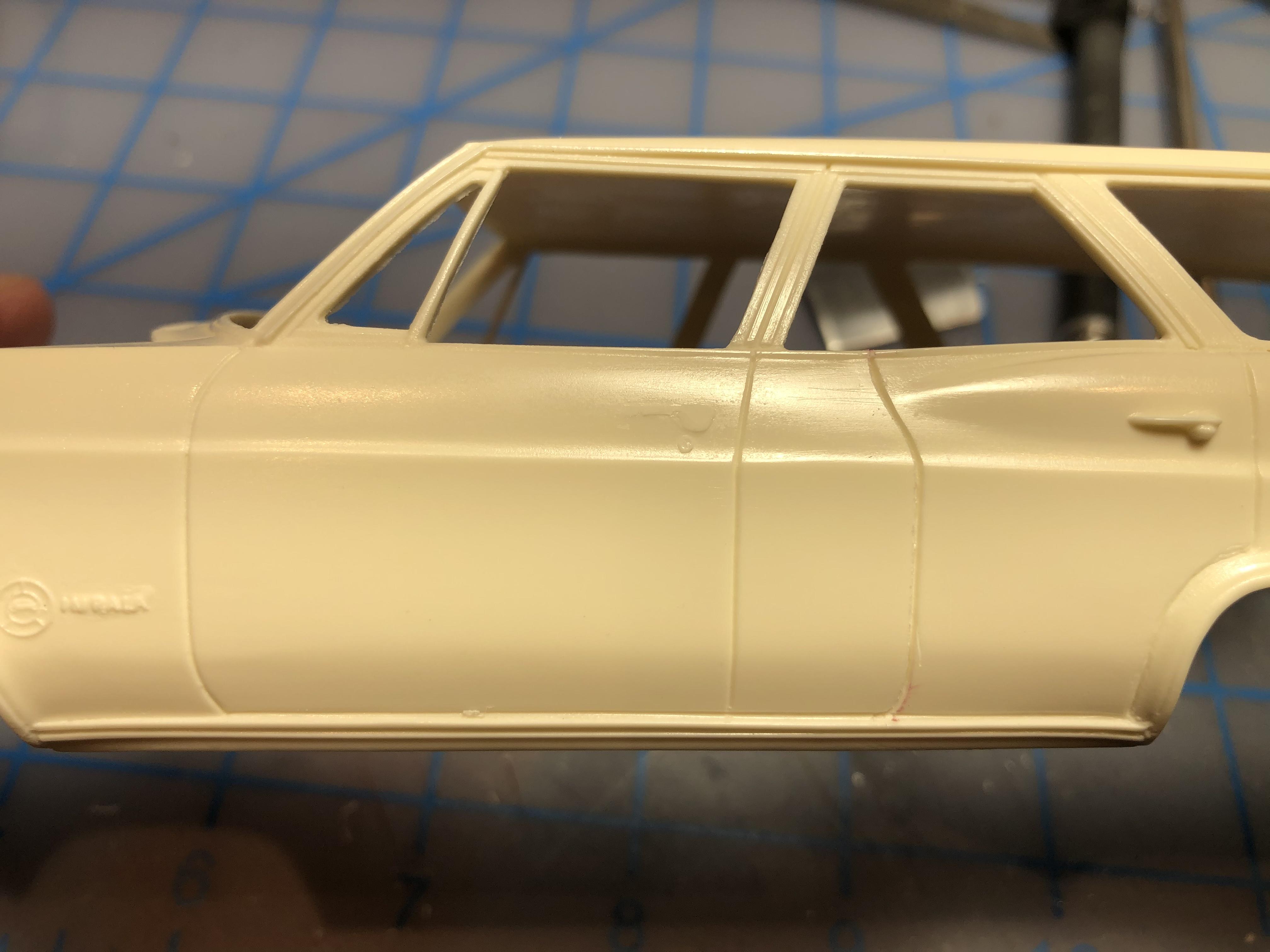

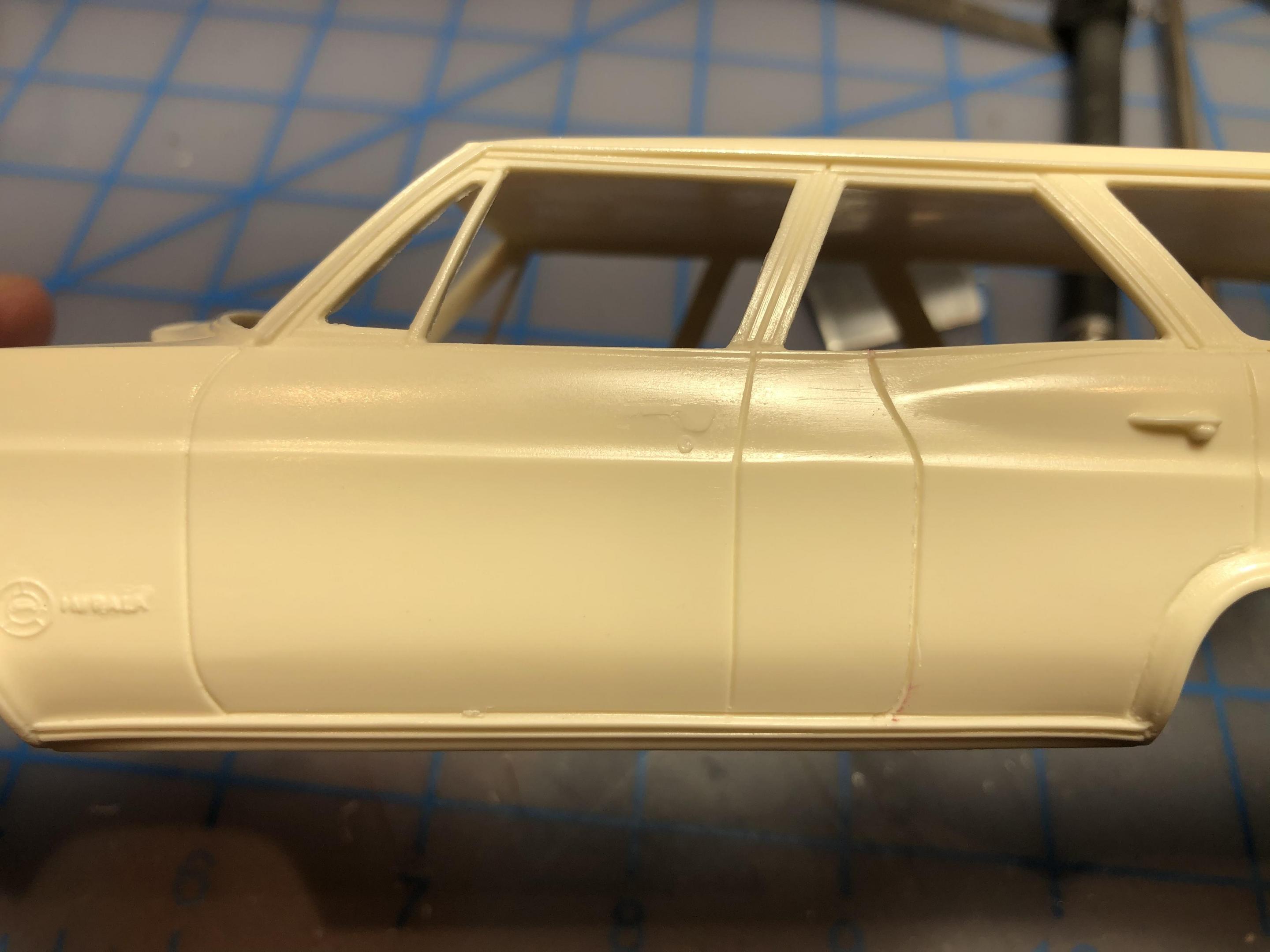

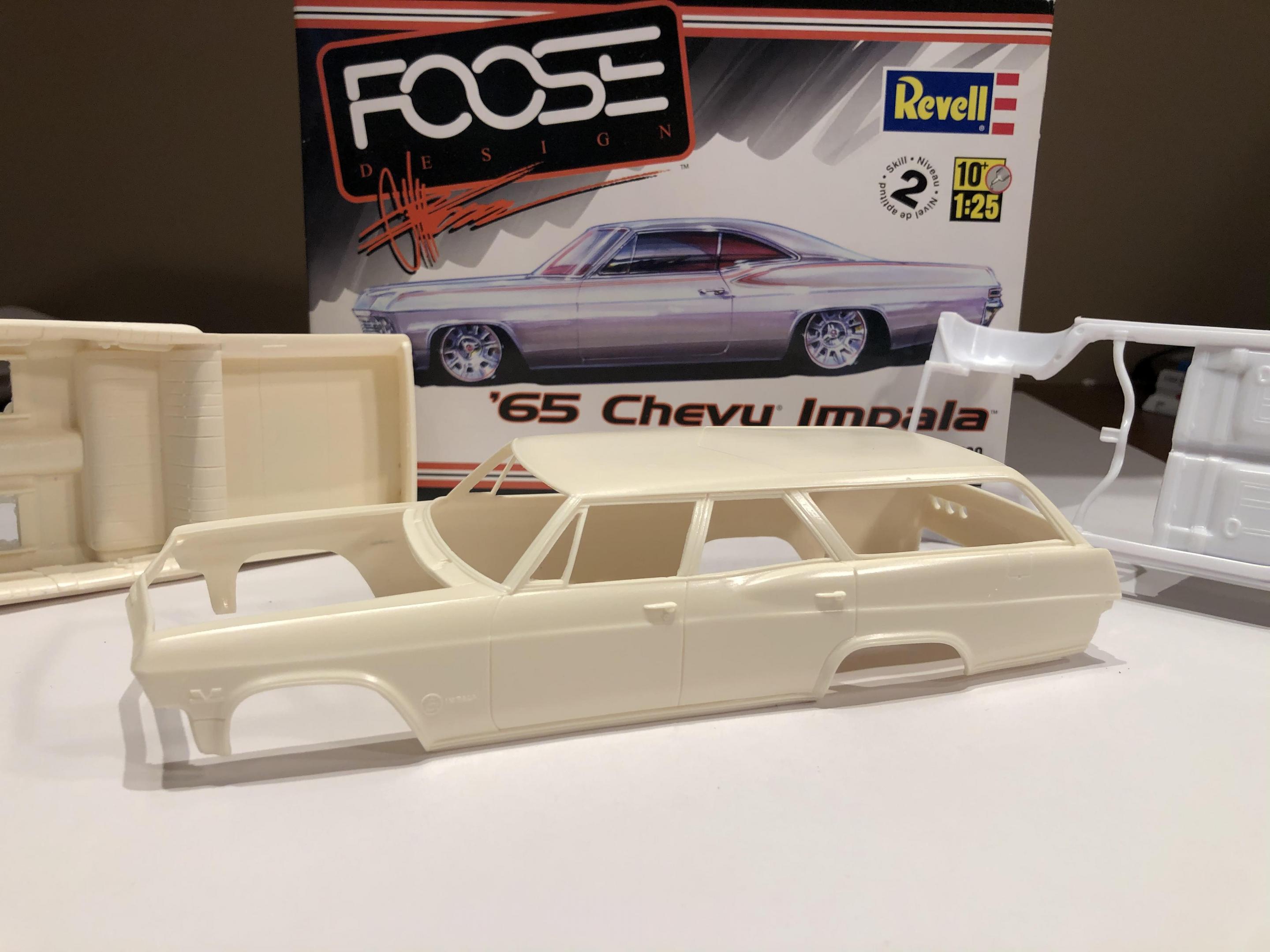

Next up, A Modelhaus resin 65 Impala wagon. I’m going to kit bash it with the Foose 65 Impala kit. ( I will need another one of these as I really like the Foose kit)
If you have seen my builds, you may have guessed it will be low... yup.
Still gathering bits and planning, so it will be a slow start. The resin kit will supply the body, interior tub, (which will need some mods), glass, and rear bumper. Everything else will be from the Foose kit, or parts stash. I played around a bit with the notion of converting it to a two door, but will likely take the easy route on this one and stay with the 4 doors. Probably Pegasus “T” wheels, which are my wheel of choice for this type of build. Sort of classic, sort of modern at the same time in my opinion. The engine will be a big block, deciding between a BNL resin 454 with modern induction set up, a Ron Olsen LS engine with a similar modern intake, or a good ol 409 with a modern intake, maybe a belt driven turbo. Decisions, decisions....
The body has a slight “twist”, or warp to it. I will try to straighten it, but failing that, it is subtle enough to live with, and I think when glued to chassis it will probably right itself. Any input on straightening would be welcomed.
As always, any thoughts, comments, input and ideas welcomed. Thanks for having a look.
Cheers, Steve

Well, just since you asked....B)
That B-pillar (the door posts and between them) slants backward at too sharp an angle. If I were building this, I'd have to cut that out and reposition it more correctly. But it's your model, and if you don't see it or it doesn't bother you, by all means, drive on! B)
Makes you wish that Modelhaus was still in business, their kits were always among the best.  Snake 45's comment on the center door pillar is correct for a stock build and that is something you may want to correct or not. You're mentioning a somewhat modified build anyway and this pillar may work perfectly with what your vision for this is, or even a hardtop body style with no pillar at all.  What ever you do keep us posted.
Hmm, I think I'd remove the B-pillar altogether; kinda like the notion of a wagon built around a 4-dr. hardtop body.

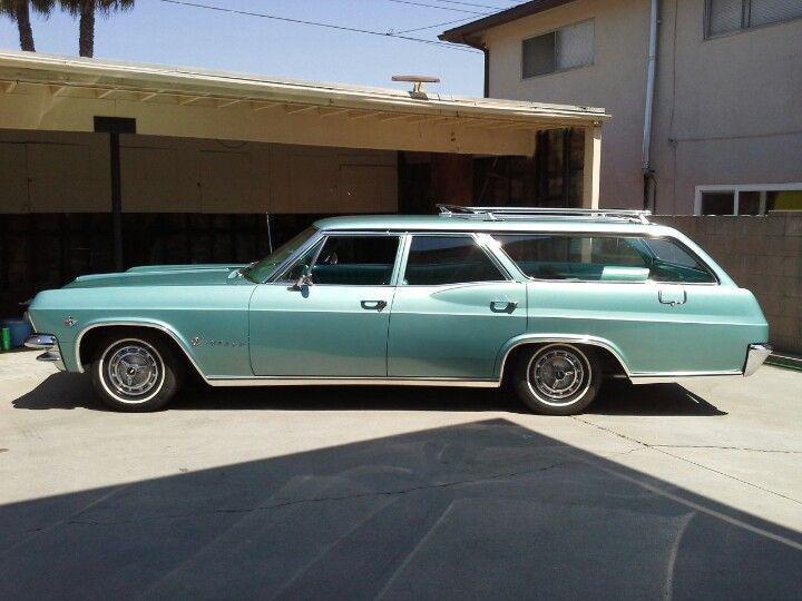

This will be another great ride Steve! I’ll chime in with Snake regarding the B post as it does appear to be a bit extreme. Here are a couple of photos off the web...
The next one may be of interest to you, while a two door, it does have a great look as a hardtop.

Looks fun!  Due to the rarity of the Modelhaus body, I’d keep the configuration of doors, post etc as it is.
I grabbed one of these at the last Modelhaus sale.  I don’t have an inspiration for mine just yet.
Wow, that B-pillar is way off from the real car. To me removing it looks cool.    The low stance looks cool but I'm one of those not on board with the super low profile tires. Bujt we all have our likes and dislikes and if you like it, go for it.
At any rate Steve, I know this will be a great looking car.  Good luck.
I agree. I think the crooked B pillars provides the perfect opportunity to see what it would look like as a hardtop.

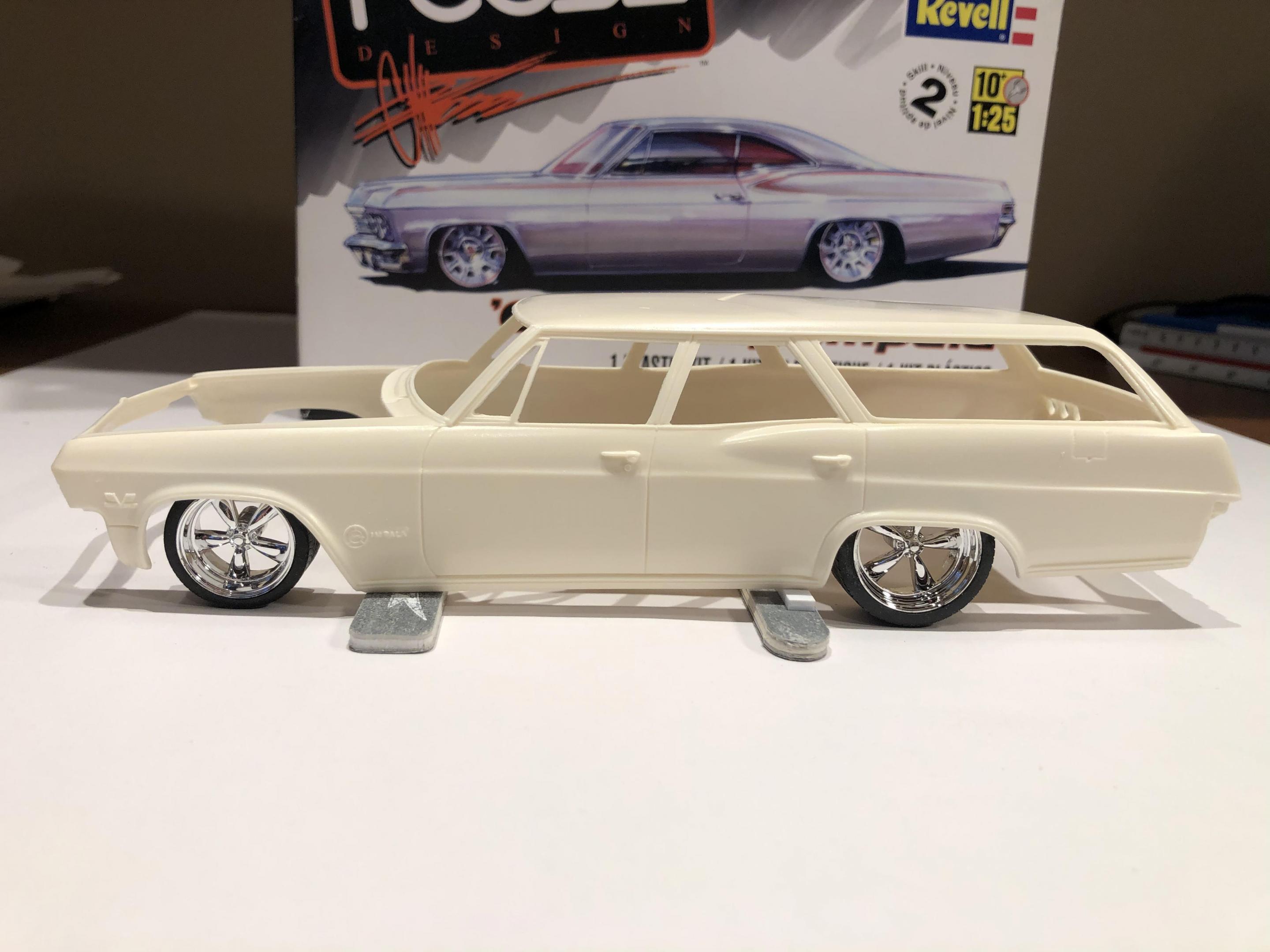

Steve, if you can get the stance exactly as you have it mocked up, it'll be perfect! Talk about nailing it straight out of the box! FYI, the AMT '67 Impala street version has a nice looking TPI BBC in it. Another nice engine is in the street '68 El Camino.

Hi Roger,  if I do anything with the B pillar, it will be removed. I am starting to lean towards 2 door. For me, I think it would be just as easy to re-scribe a door line as repairing an angled pillar. With it being a custom, I’m too concerned about it being “correct”. I do like the engine in the 68 Elky. Thanks for the input!
Hi Snake, thanks for comments. It always amazes me how knowledgeable the people on this forum are. I don’t think I would have noticed the pillar issue. I appreciate the keen eye. I am leaning towards 2 door hard top....
Hi Mike, thanks for the comments. I totally get the tire thing. For me, it’s more about getting it down low.

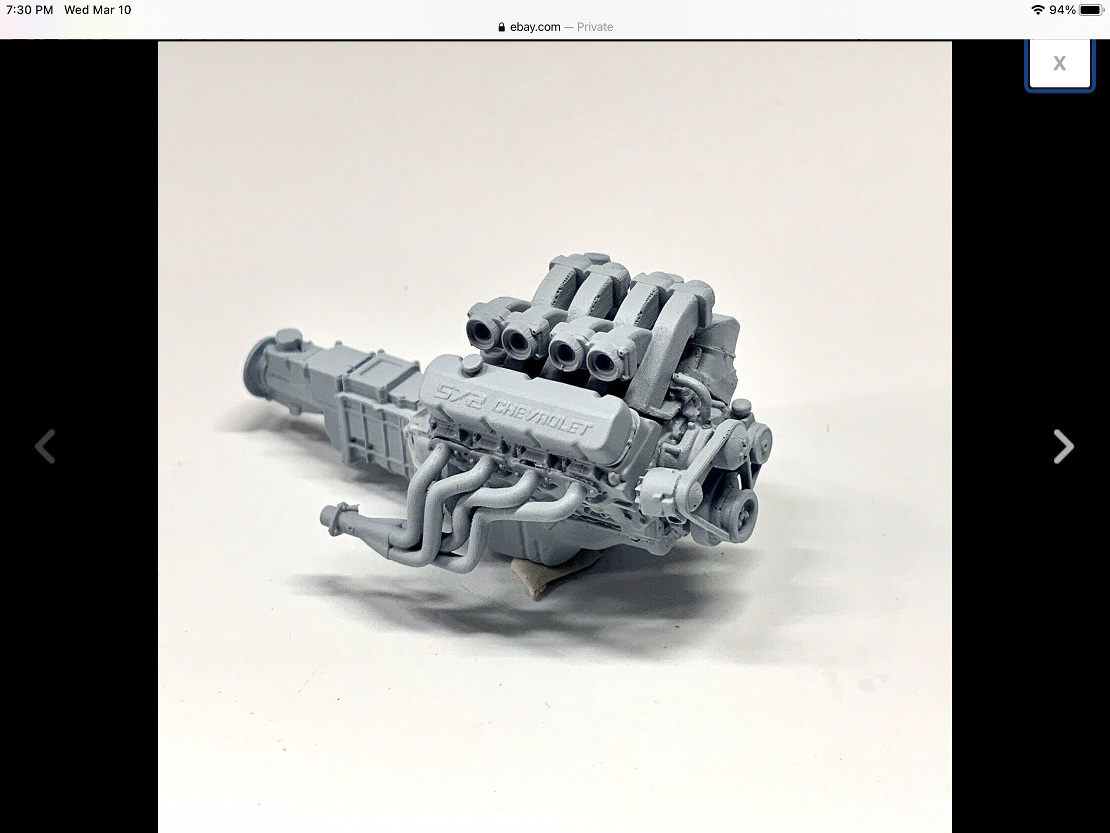

On 3/11/2021 at 4:36 AM, Steve H said:
Excellent choices!! I have all 3 of the shapeways options, and one on the short list is the Edelbrock cross ram. However this one is kinda sexy too..
Thanks again for the ideas!

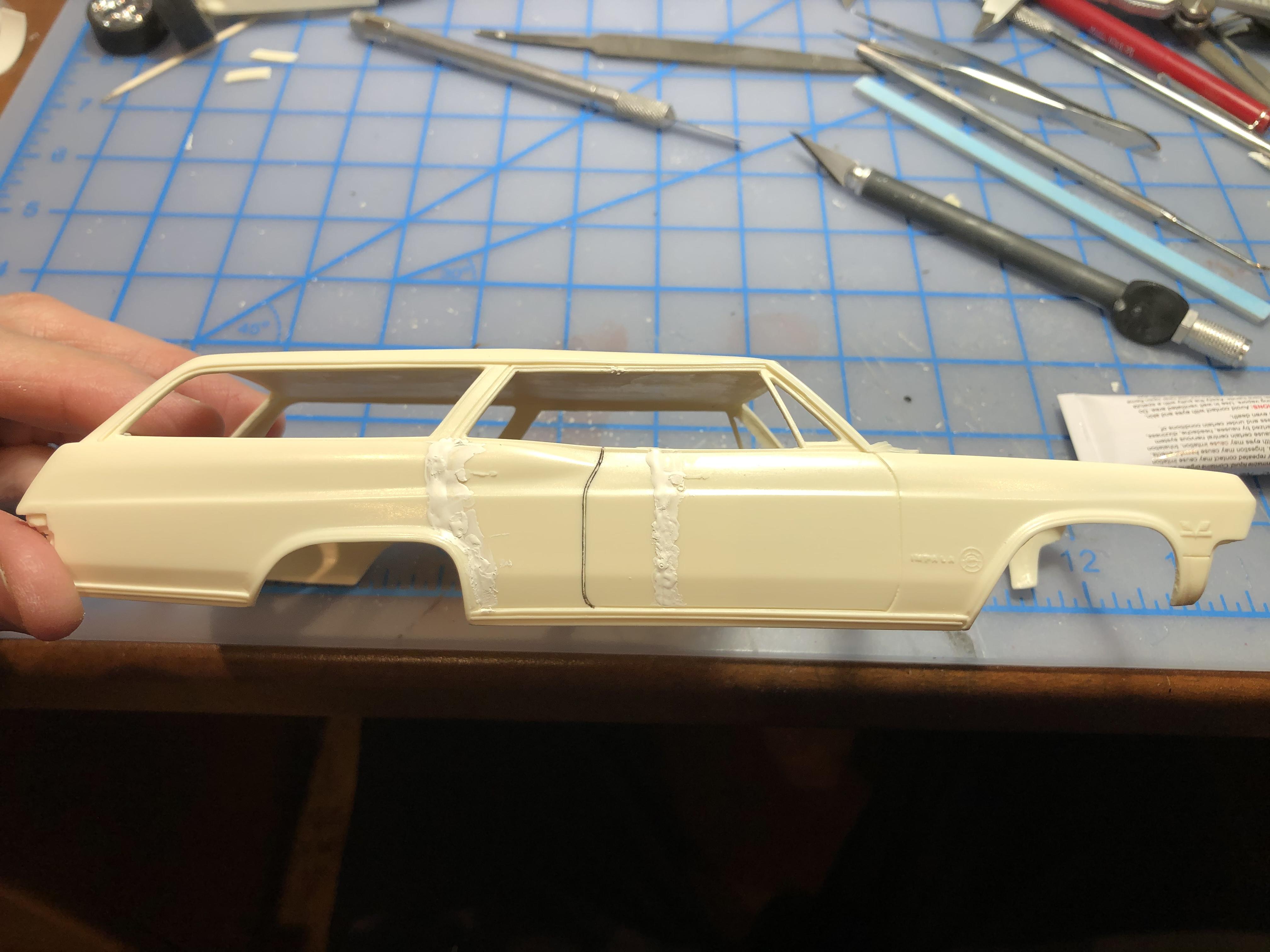

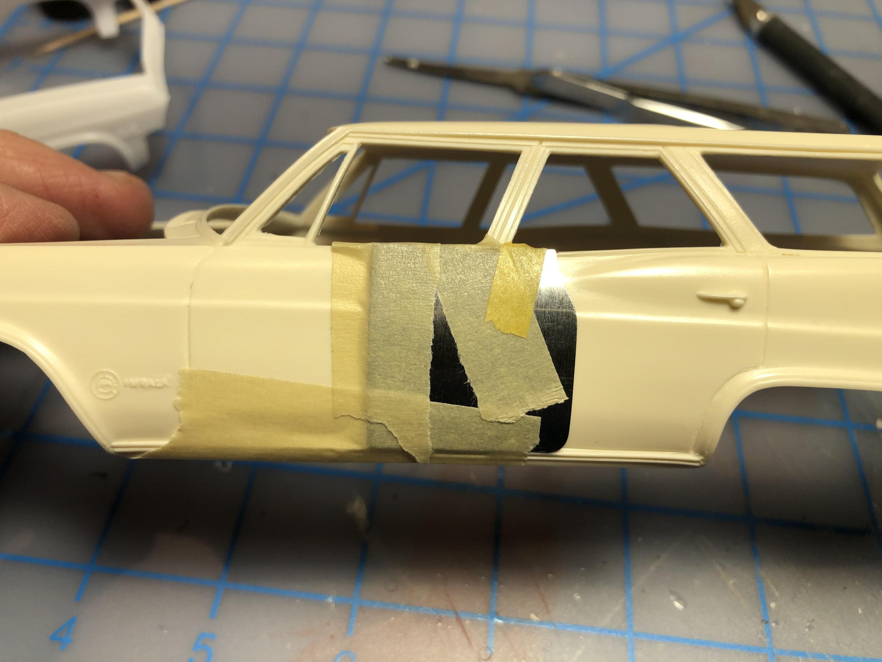

Hi folks, thought I would post a small update. I’m still in planning mode, but had some actual building time today.

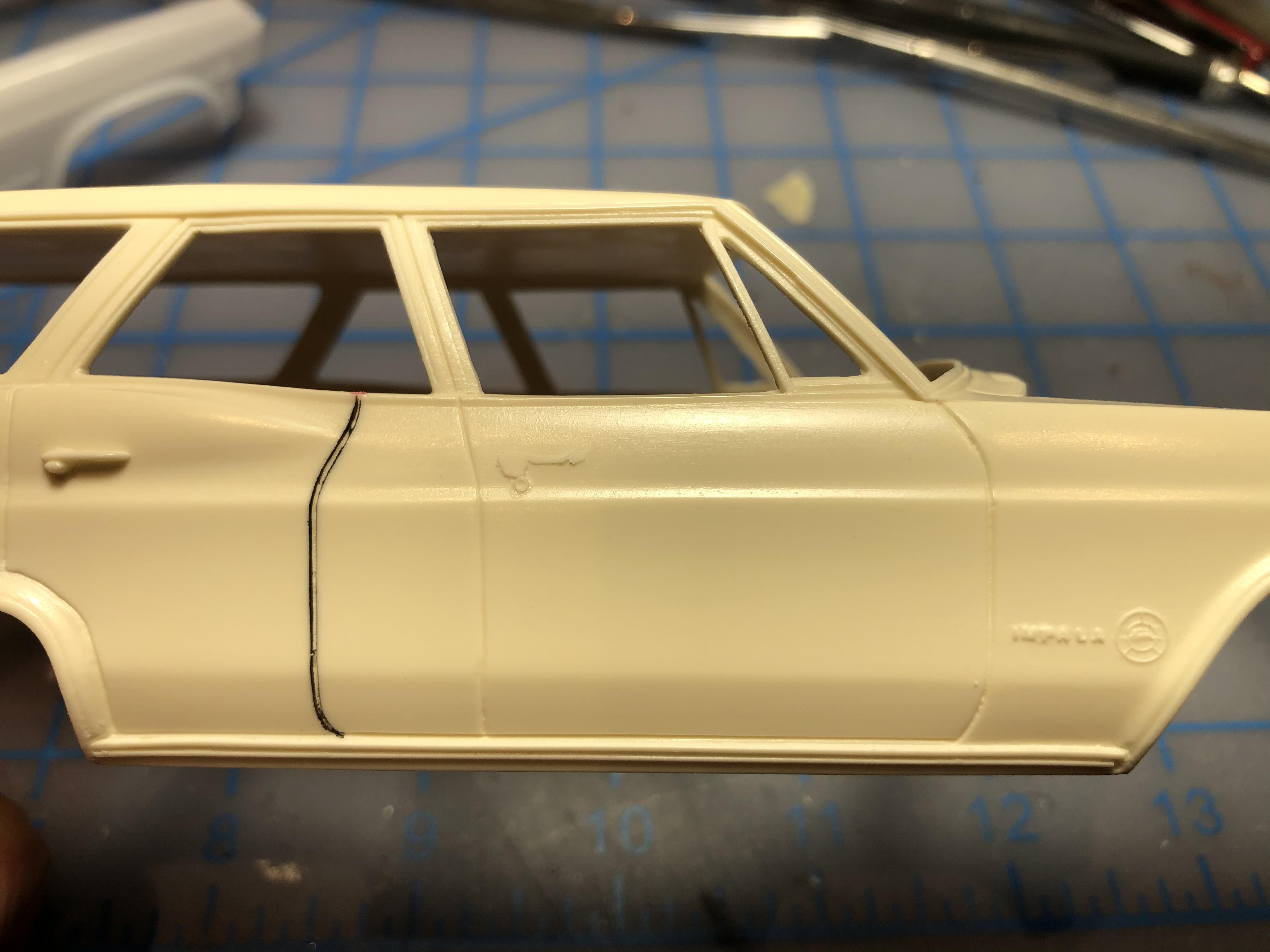

No turning back now, it’s a 2 door hard top!! This is my first time creating new panel lines. I have cut open trunks, and deepened existing lines, but not added new ones. I knew I wanted a decent edge to trim against, not just tape. I’m not sure how others would do this, but here is my approach.

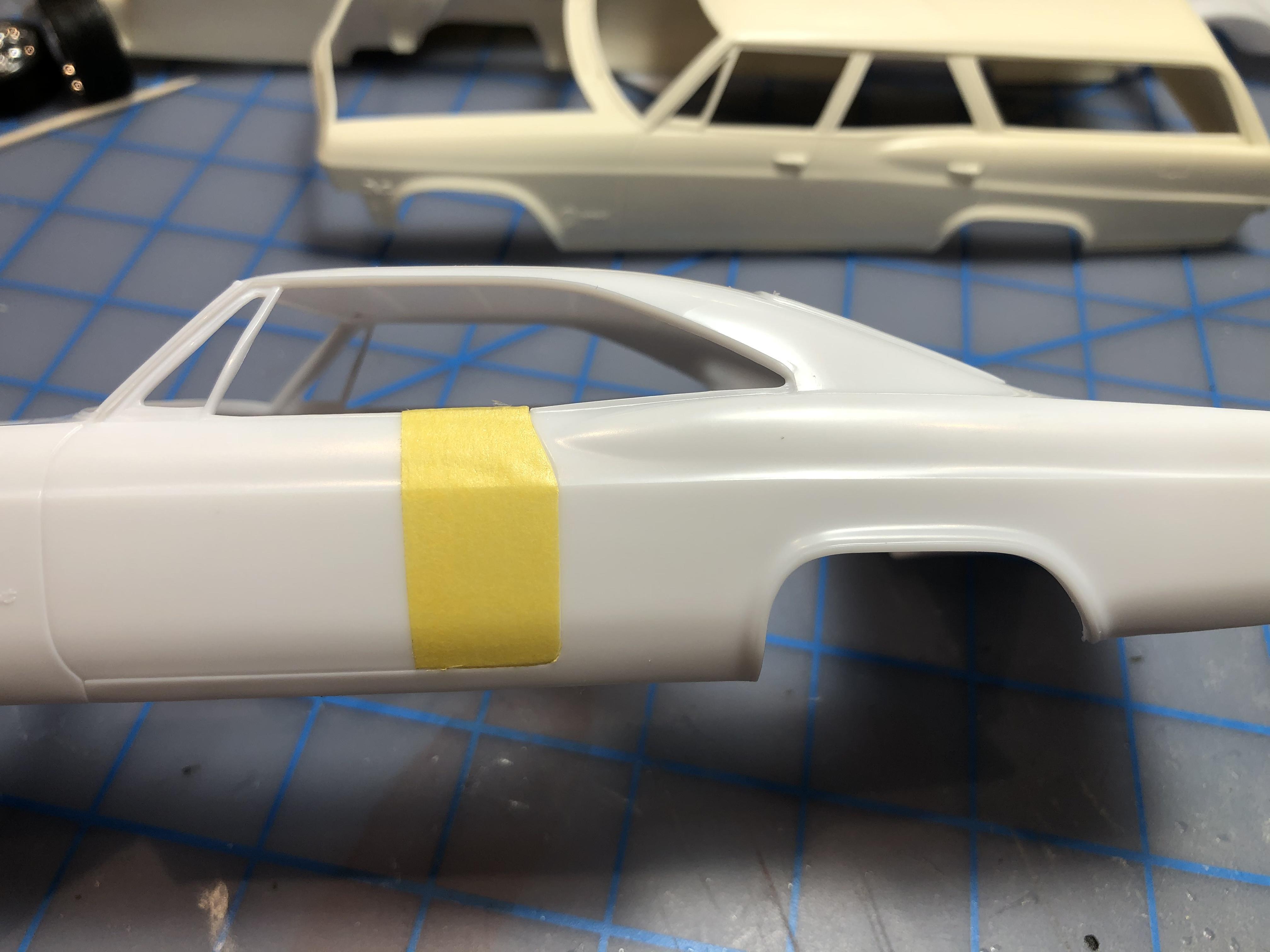

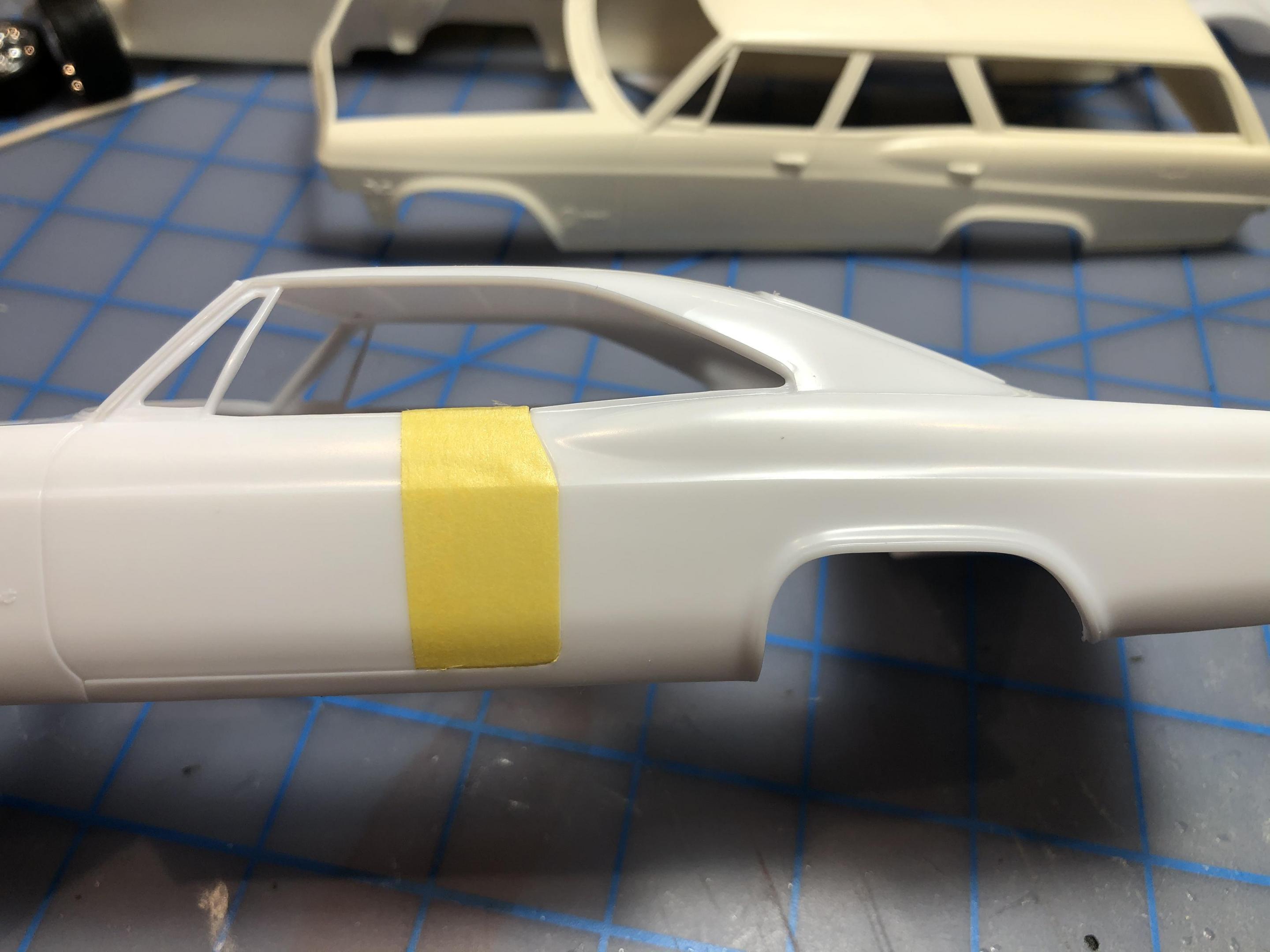

Used tape to copy outline of the Foose 2 door back edge

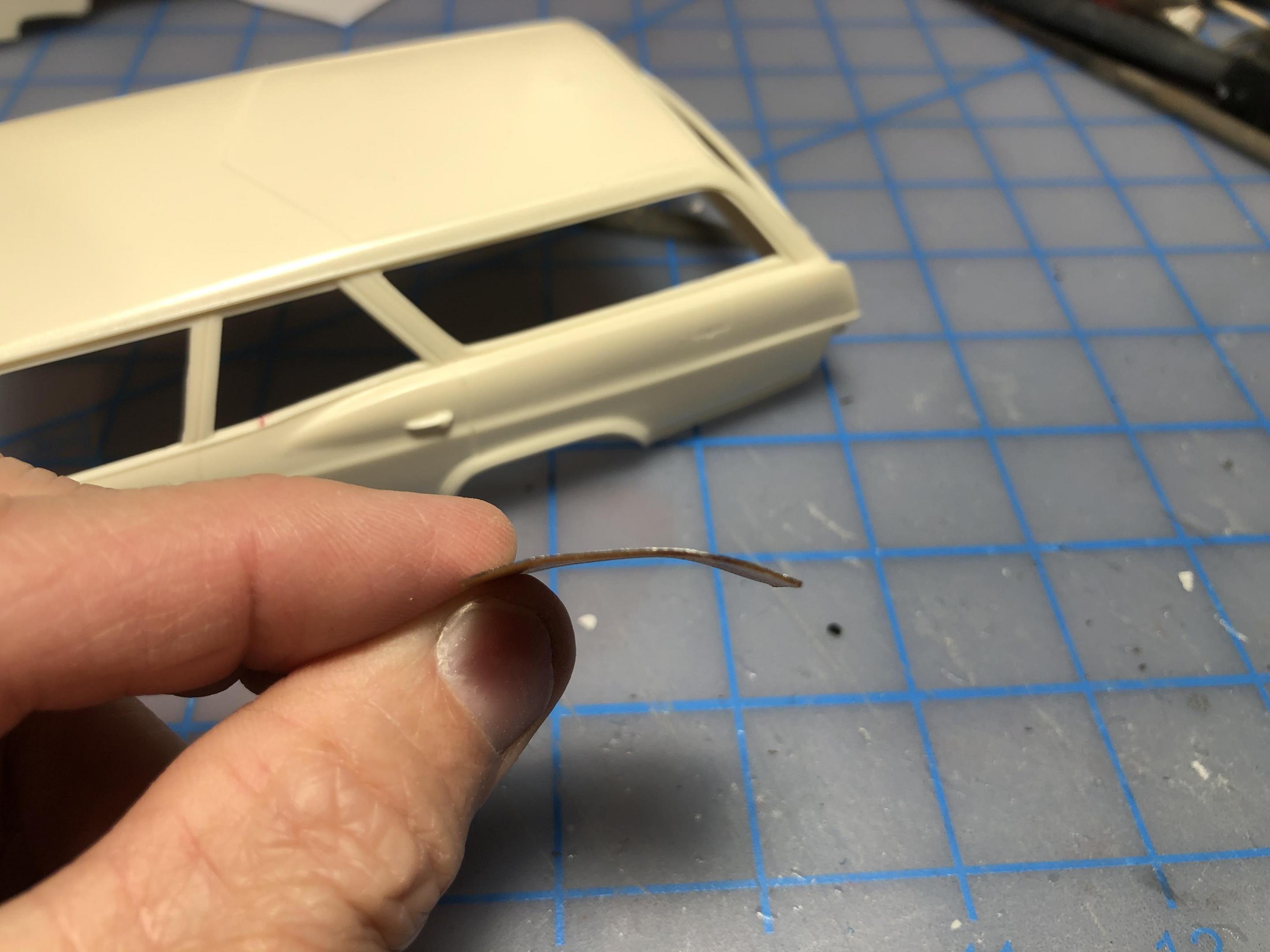

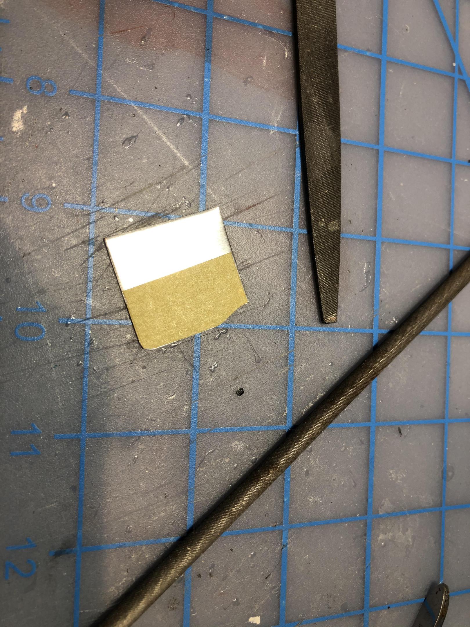

Placed that on some sheet aluminum to make a template
bent it to approximate shape of door
measured where back edge of door should be, then taped it in place and scribed the new door line
It worked pretty good! I then did the mirror image on the other side, I darkened the line here so it is more visible.
Next was removing the B pillar
I now have a 2 door hard top! I was worried that the distance between the windshield and C pillar would be too large looking, but I actually think it looks really good. A couple of rounds of fill sand prime should take care of the old door lines, and removing the door handles.  Lots of work to do on the interior, hoping to have a somewhat logical plan on how to attack that in the next day or 2. Obviously I will now be using most of the Foose interior pieces, just need to meld it all together. More on that later...
If anyone has a different approach on scribing new door  lines, please share. I have at least 2 more future projects that will require scribing new lines.
Thanks for having a look. Cheers, Steve
Great looking project so far Steve! Your idea with the aluminum sheet pattern is perfect! Much better than using tape in my opinion. I wish I did that on my 4D Malibu build. I used tape and you have to have a very light touch on the first scribe with tape! Luckily it turned out.
Something I've noticed on that body is the beltline crease drops too much on the quarter panels. It's especially noticeable in relation to the top of the bumper.
My method for scribing new lines is much like yours. Except I use .020 styrene and temp glue it to the body. I use the same method to cut straight lines when I cut a body apart.
That worked-out nicely, must remember that. I have one or two kits with standard panel lines so shallow it would be worthwhile doing when I deepen them, let alone scribing new ones.

Something about the side character line bothers me, it seems it slopes downward at a very steep angle when compared to the picture above.

8 minutes ago, lordairgtar said:
    full?d=0
Hmmmmm. You guys are definitely correct. This again is something that I would not have noticed. I need to pay more attention to details!  At any rate, with this being a custom, not a replica, I’m not sure if I will address it. I will do a mock up with bumpers to make sure it has reasonable “flow” and that it doesn’t look too weird. I love the input, it’s very helpful and informative!!
