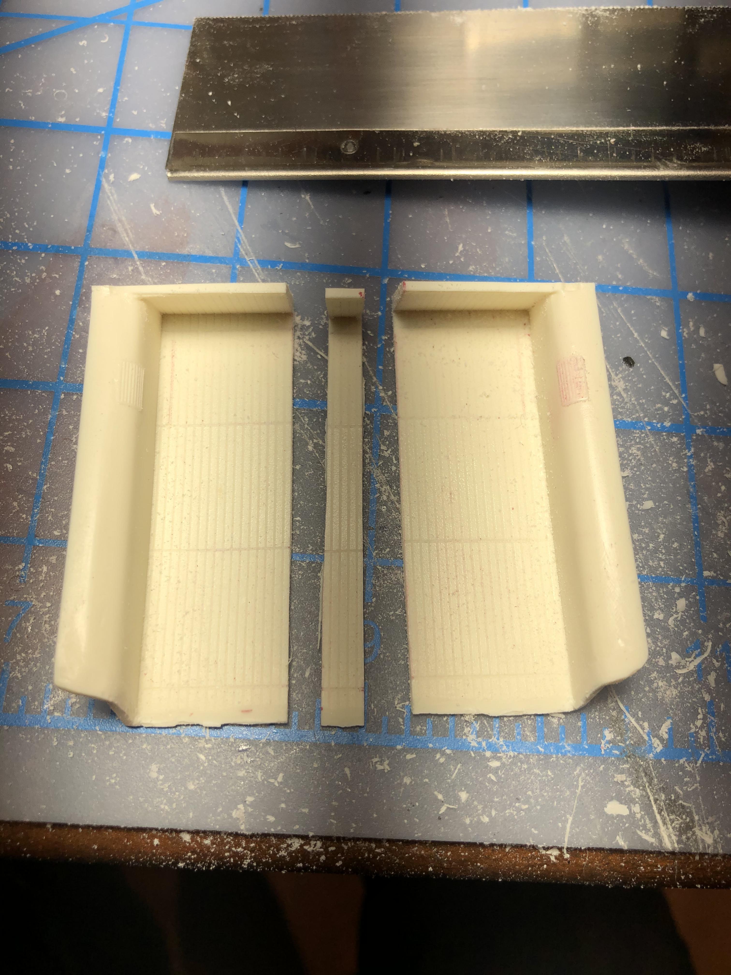

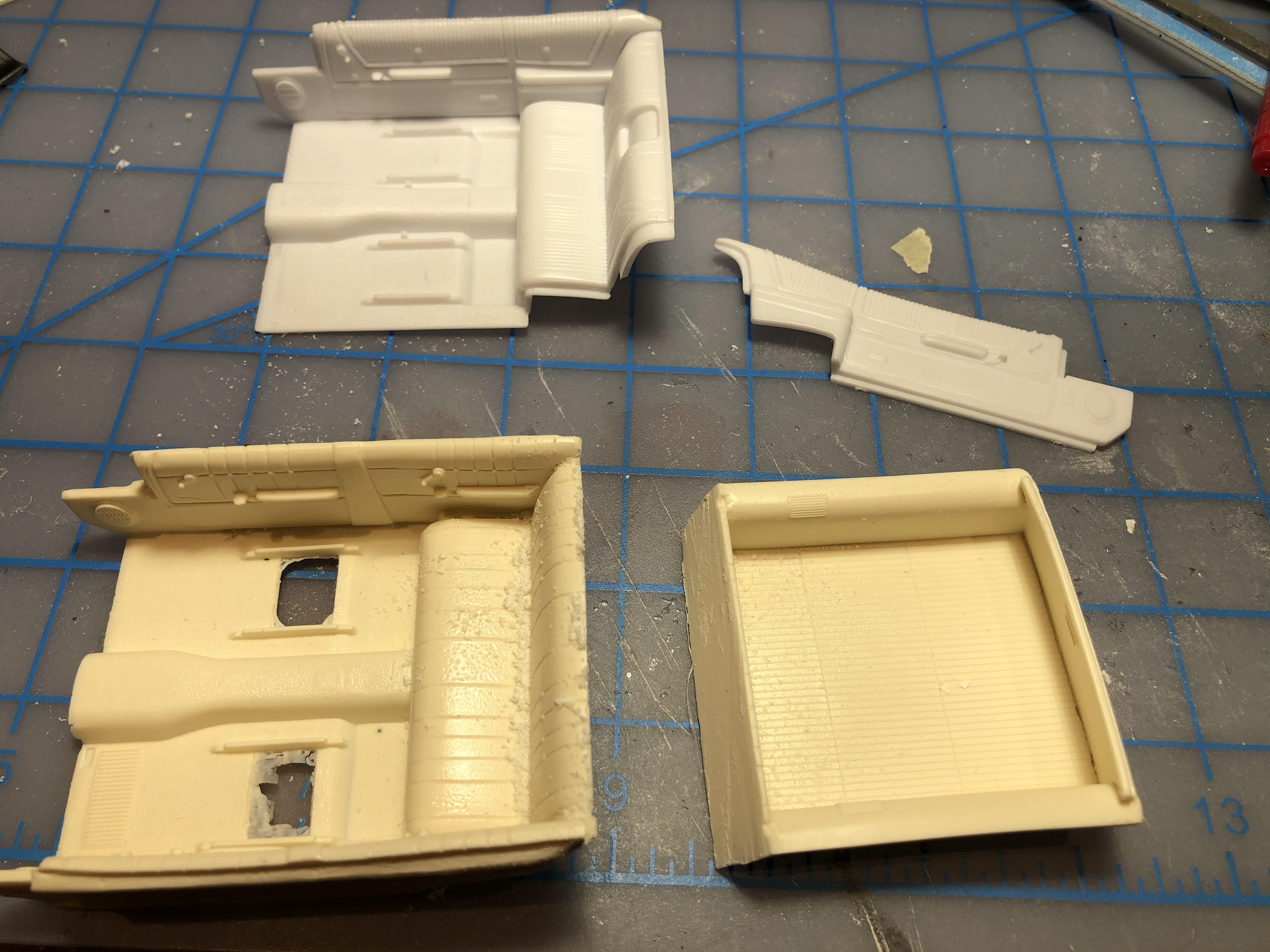

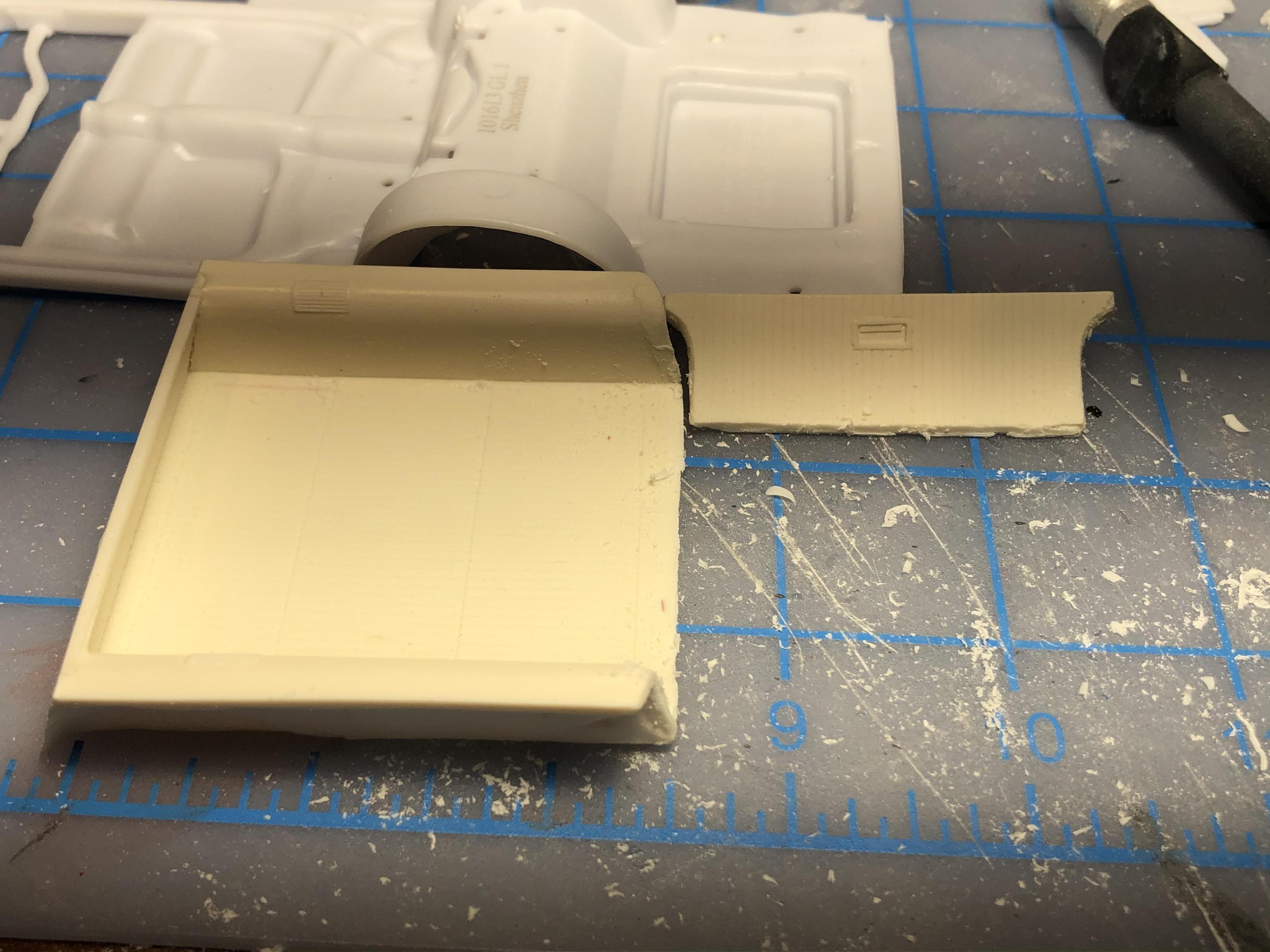

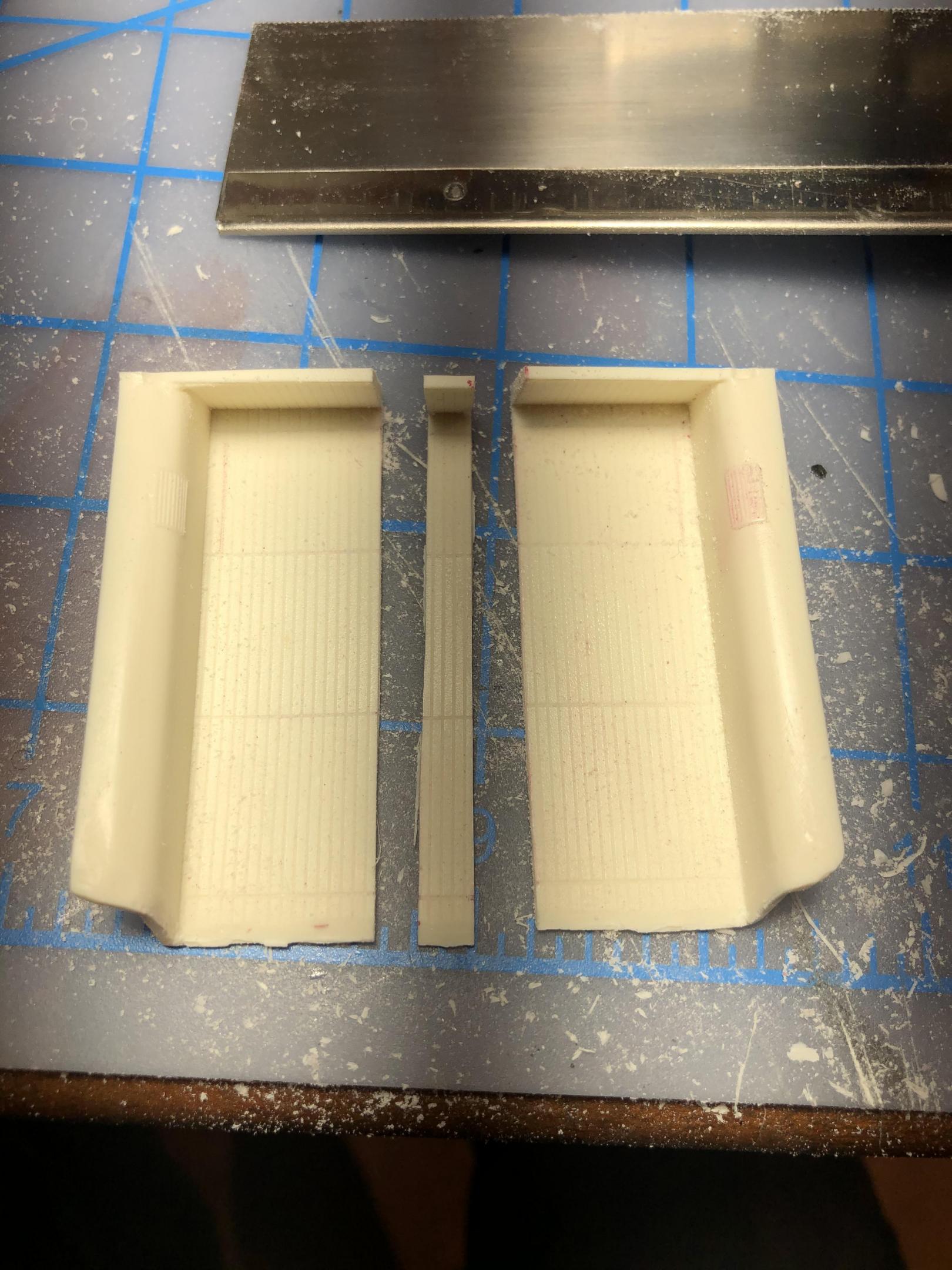

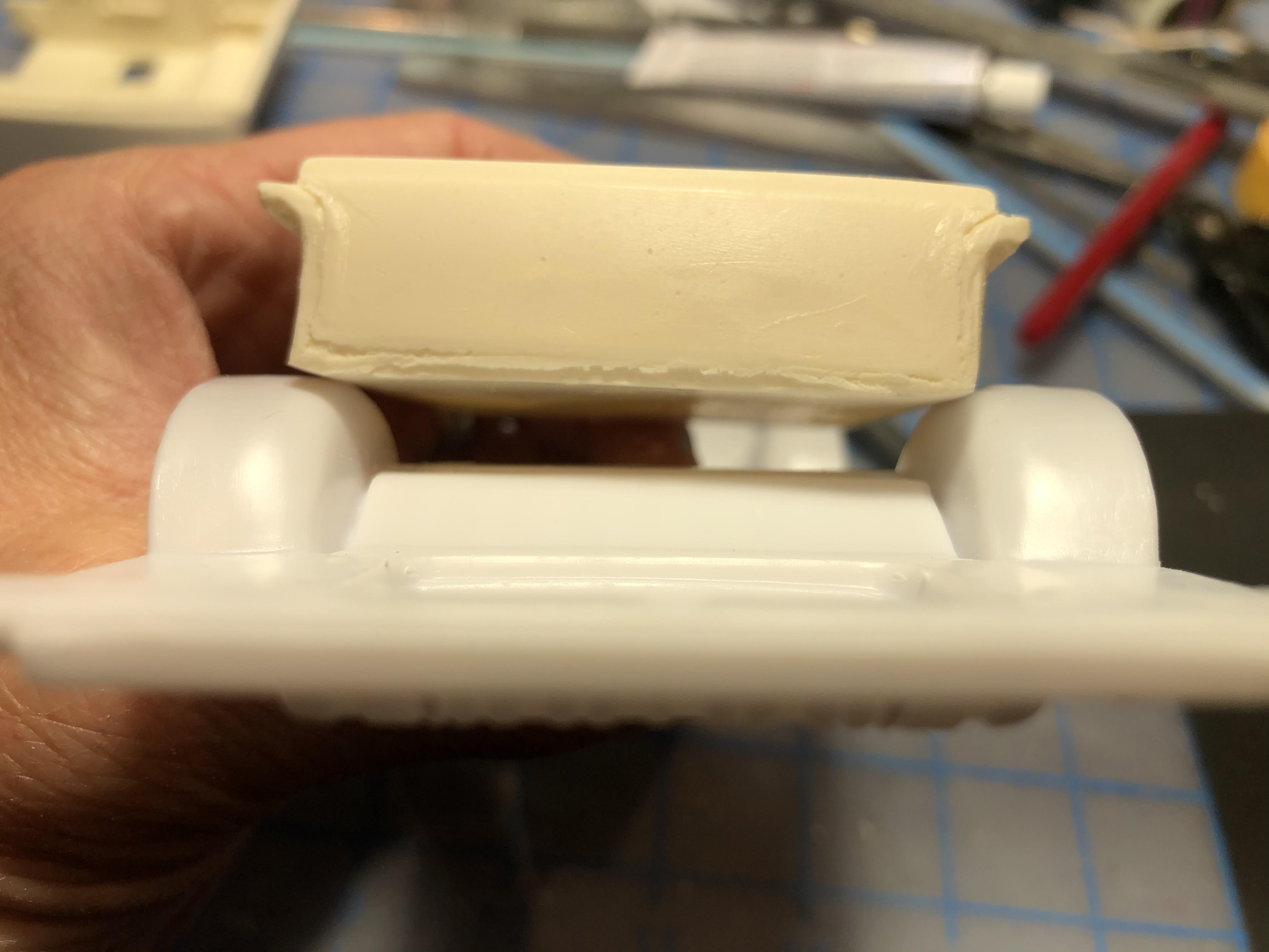

Steve H Posted March 18, 2021 Author Posted March 18, 2021 Hi all, started into the interior work. I took a handful of measurements then started cutting... This actually might be a bit easier than I thought it would be. Cut off rear package shelf from Foose kit, removed cargo area from the resin kit. The plan is to use the two-door interior bits and add the cargo area to it. The rear cargo area is too wide to fit between the rear fender wells, so.... remove rear panel Then cut lengthwise, and remove a strip from the centre... Well, the cutting part is easy.... more soon. Cheers, Steve

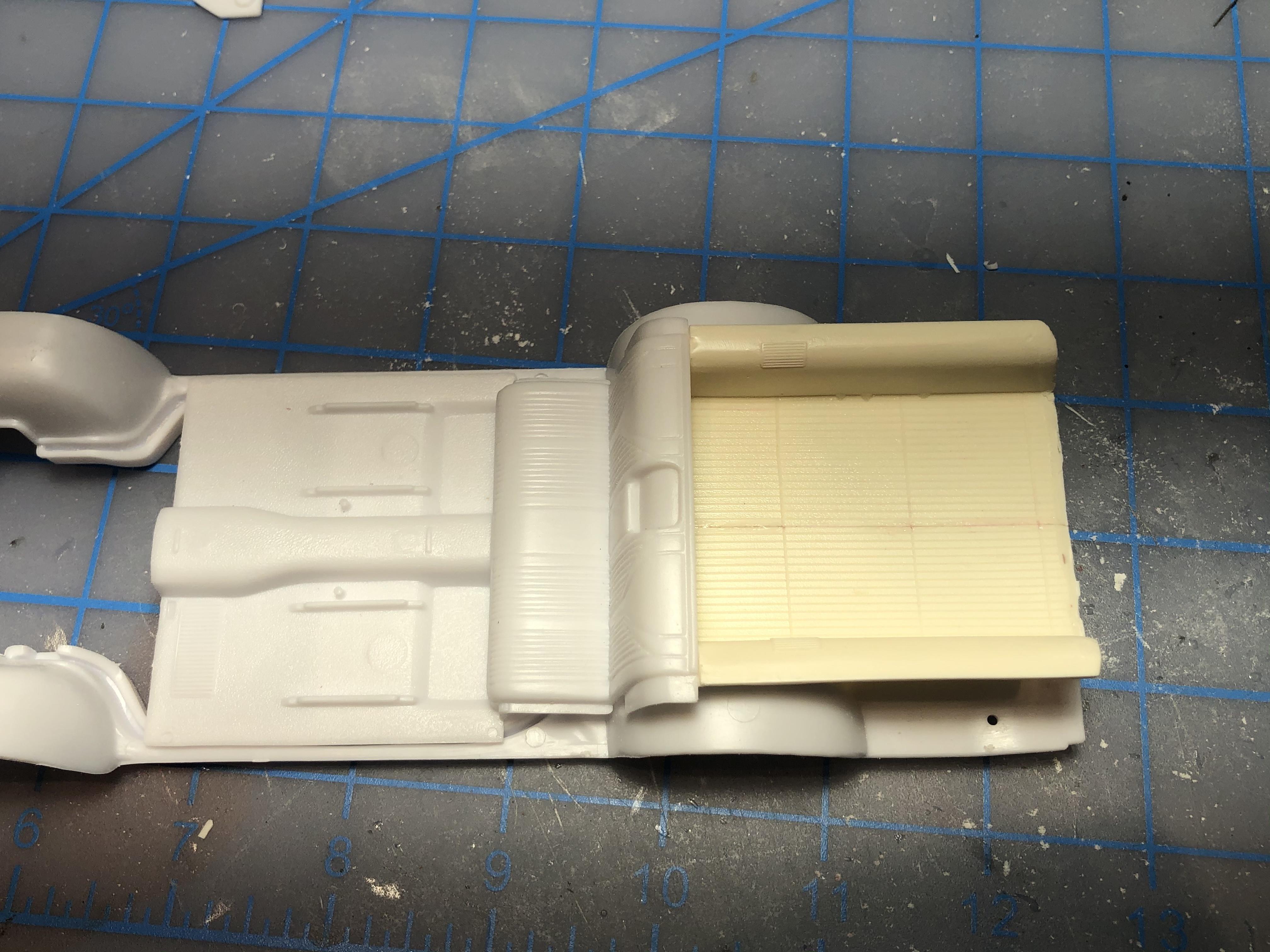

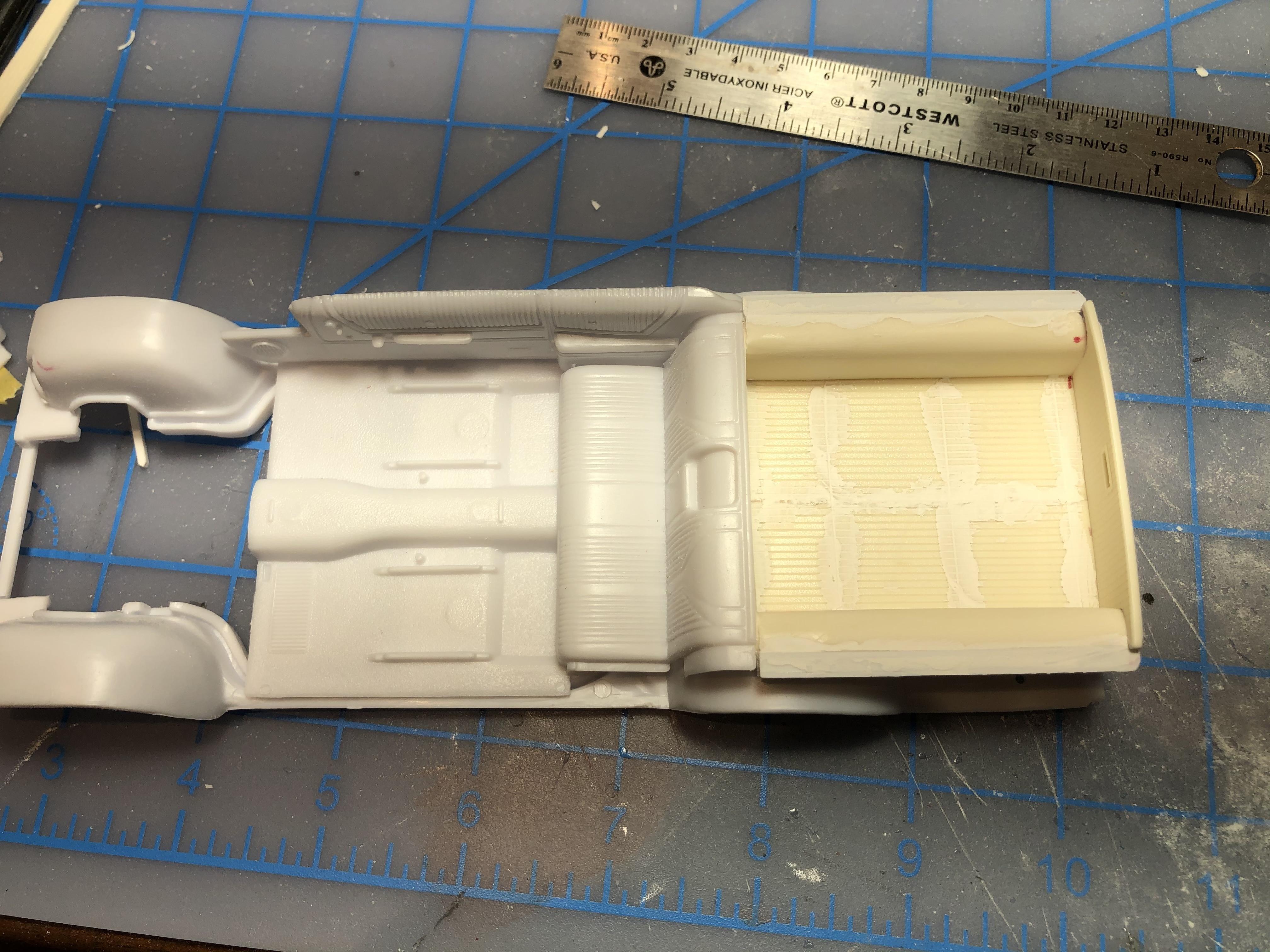

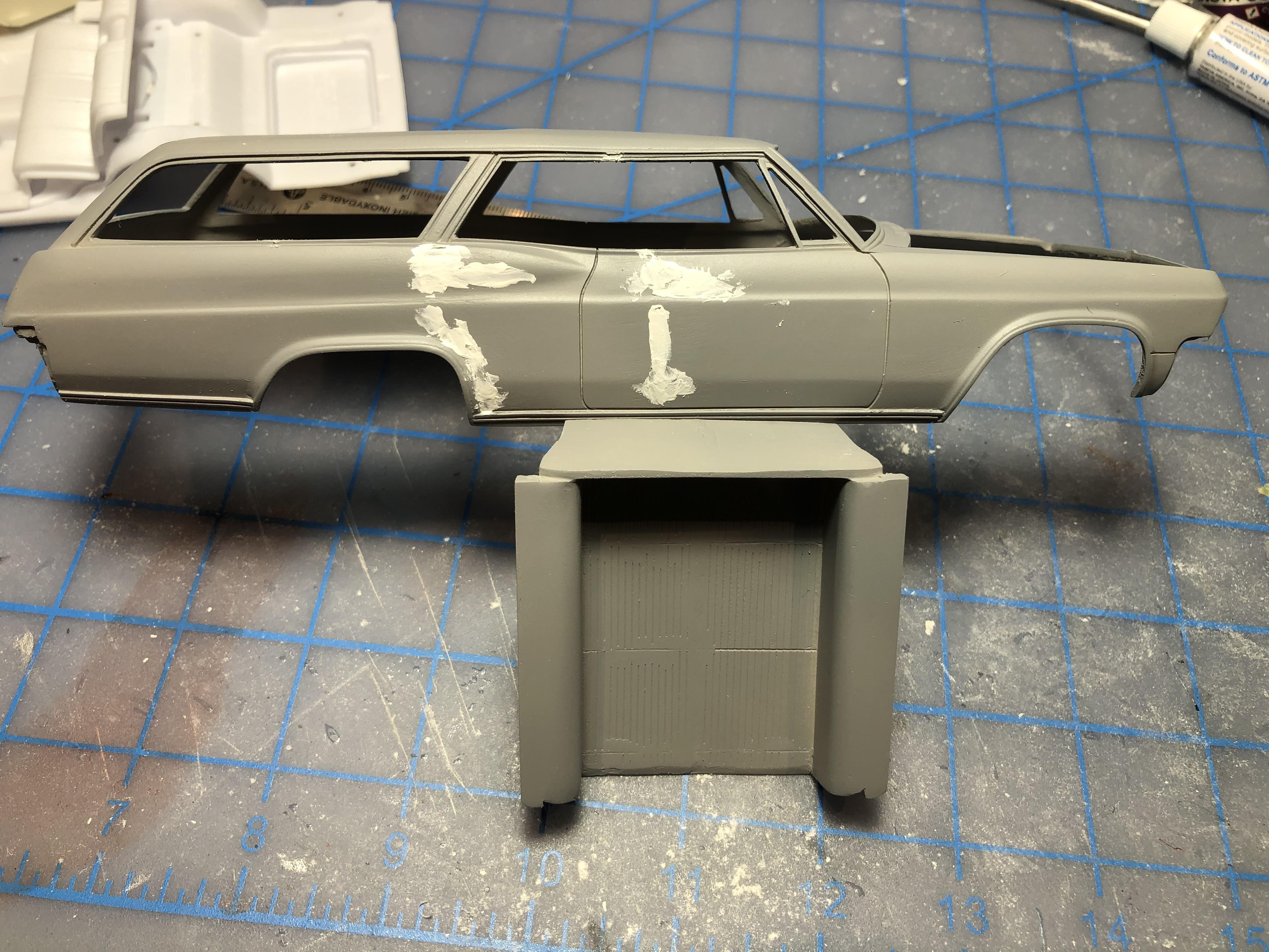

Steve H Posted March 21, 2021 Author Posted March 21, 2021 Ok, managed to have some desk time today. One of those rainy, damp west coast weather days are perfect for staying in the hobby room. I re-assembled the cargo area and fit it to match the rear seat. Obviously, it is too narrow now, so made filler pieces for the top of the side panels. In my planning, I had two thoughts on how to tackle this. It was either add wider inner fenders, or as I chose to do, narrow the whole thing and add top pieces. For me, (call me lazy) this was the easier way to go. I also had to fix a twist in the cargo area. It’s not perfect but much better than it was. I plan on flocking the rear cargo area so I will smooth out the whole area. The carpet will hide imperfections. I couldn’t resist priming the body, it still needs a lot of work, but it’s now a two door! I think it looks pretty cool. Thanks for having a look!

Plowboy Posted March 22, 2021 Posted March 22, 2021 It's looking good Steve! Just a suggestion; I would get rid of the remaining door frames at the top to give it a true hardtop look.
TransAmMike Posted March 22, 2021 Posted March 22, 2021 Ahhh, the making of a really cool Nomadistic (is that even a word?) wagon?
Steve H Posted March 23, 2021 Author Posted March 23, 2021 On 3/21/2021 at 5:31 PM, Can-Con said: That's looking great ? Thank you Steve! Your 65 is looking amazing, the paint is superb. 12 hours ago, AmericanMuscleFan said: Good progress Steve, spending time at the bench on a rainy day is the best thing to do... it's much better than housework... ? The body looks great with 2 fewer doors, It will make all the difference in the end!!! ? Hi Francis, small progress is still progress... It’s a busy time of year for me, but I am trying to keep some momentum with this project. The 2 door will definitely be a bit different, I like that. 11 hours ago, Plowboy said: It's looking good Steve! Just a suggestion; I would get rid of the remaining door frames at the top to give it a true hardtop look. Hi Roger, yes, and thanks for the input. I hadn’t dealt with that area yet, but that is on my radar. Going to do a quick search here shortly to have a look at some 2 door hard top wagons. I got all carried away when the primer came out, it was a bit premature, but I couldn’t resist. Thanks for checking in sir. 10 hours ago, TransAmMike said: Ahhh, the making of a really cool Nomadistic (is that even a word?) wagon? Sounds like a word to me! I like it. Cool is the goal, hopefully I can pull it off. Cheers, Steve

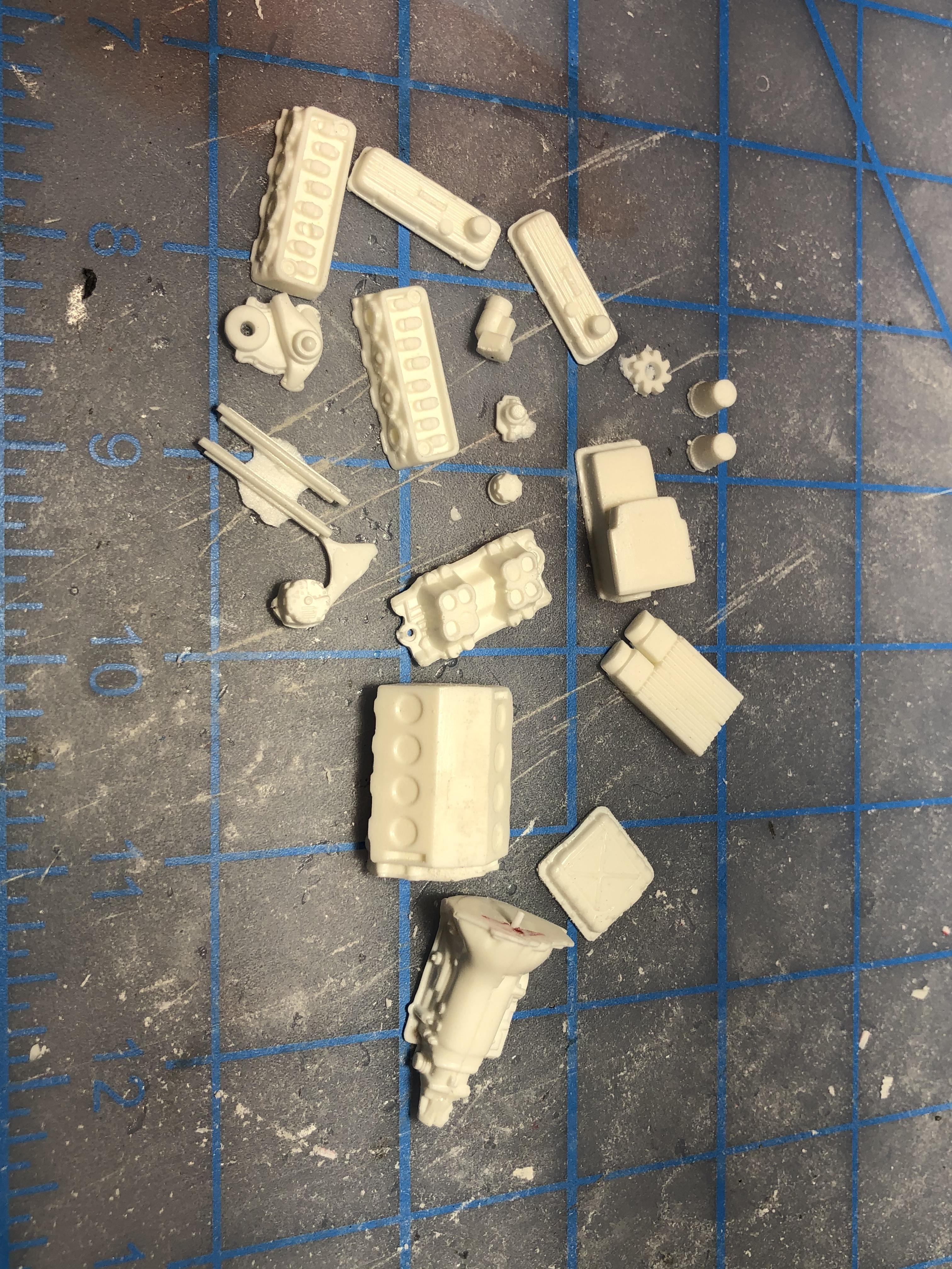

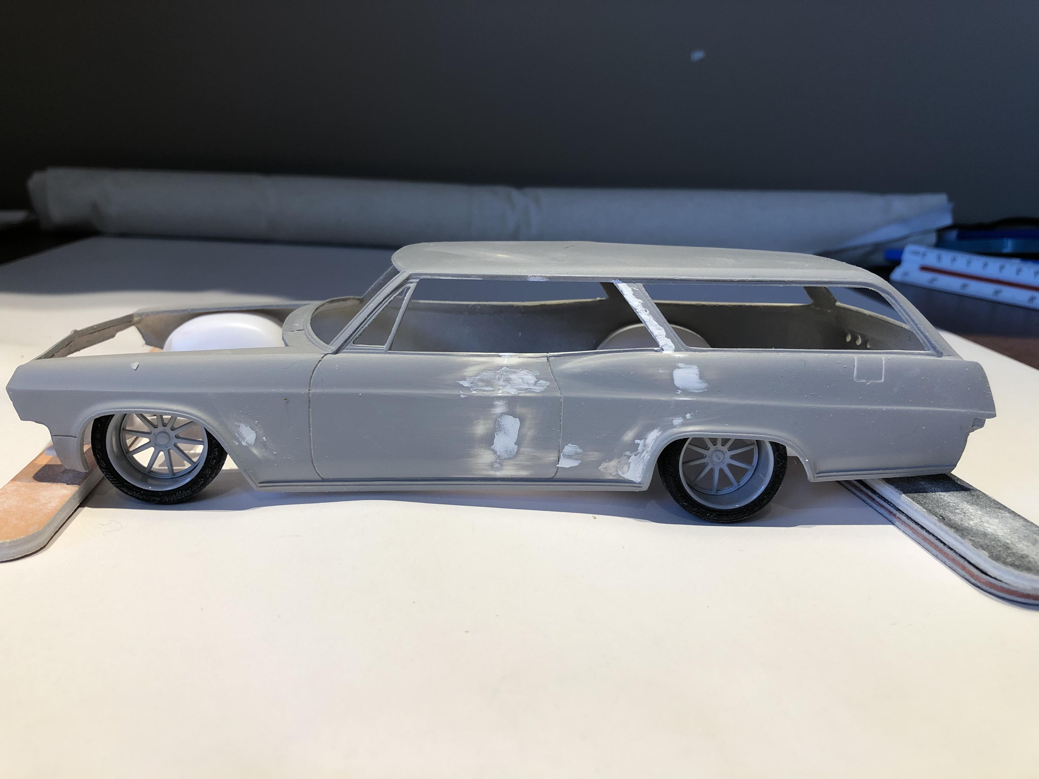

Steve H Posted March 28, 2021 Author Posted March 28, 2021 Hi folks, Small update. Not much to show, spent a fair bit of time on parts clean up. As Roger mentioned the door frames needed to be removed to open up the hard top. Still some fine tuning to do, but body work is getting close. I also played around with another wheel/tire choice. JPS wheels with Z06 Corvette tires, I might like these better, maybe because they are different. Would love some feedback on wheel choice, Pegasus or JPS ? I decided to use the BNL resin 454. I’ve had this engine for a few years, and this felt like the perfect car for it. I will likely use the oil pan from the Foose kit, and possibly different valve covers. I raised the front crossmember about 2 scale inches which gave me the ride height I wanted up front. Still need to play with ride height out back. I’m hoping to have the major components fitment issues sorted out by next week. Thanks for having a look! Cheers, Steve
