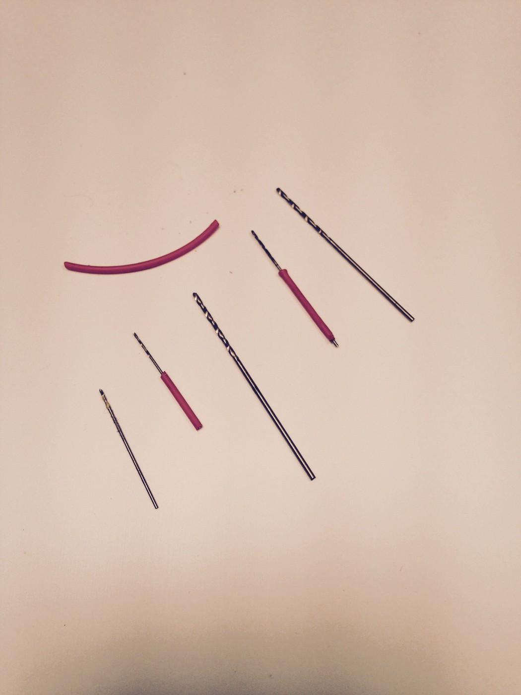

Tom Geiger Posted April 16, 2021 Posted April 16, 2021 Ive posted this before, but the mention of dedicated vices made me think of it again. When using some of the smallest bits, I’ve inserted and glued them into a short length of heater hose. It holds secure and the tiny bits don’t get lost.

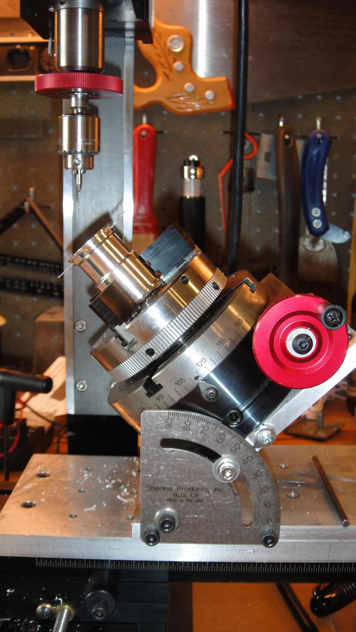

Pete J. Posted April 16, 2021 Posted April 16, 2021 (edited) On 4/16/2021 at 4:51 PM, Mr. Metallic said: Dedicated vises for a commonly used bit size is a great suggestion. I've been doing that for awhile now. I pin a lot of assemblies together using sewing pins. So i have a vise set up specifically with the bit I use to make the hole for those pins. That way i always know it's the right size, and it's ready to go at a moments notice. Pete, I'm going to investigate the industrial bits. as i dabble more and more in brass the hobby bits won't even touch drilling through bras, and barely aluminum. Expand If you get a good mill or drill press then you can use the circuit board carbide drills. They are super sharp but are quite brittle. You have a high risk of snapping them with a hand held pin vice. They don't take flexing well so you need the control of a mill or drill press. Edited April 16, 2021 by Pete J.
