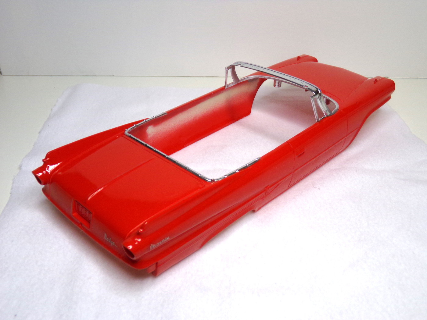

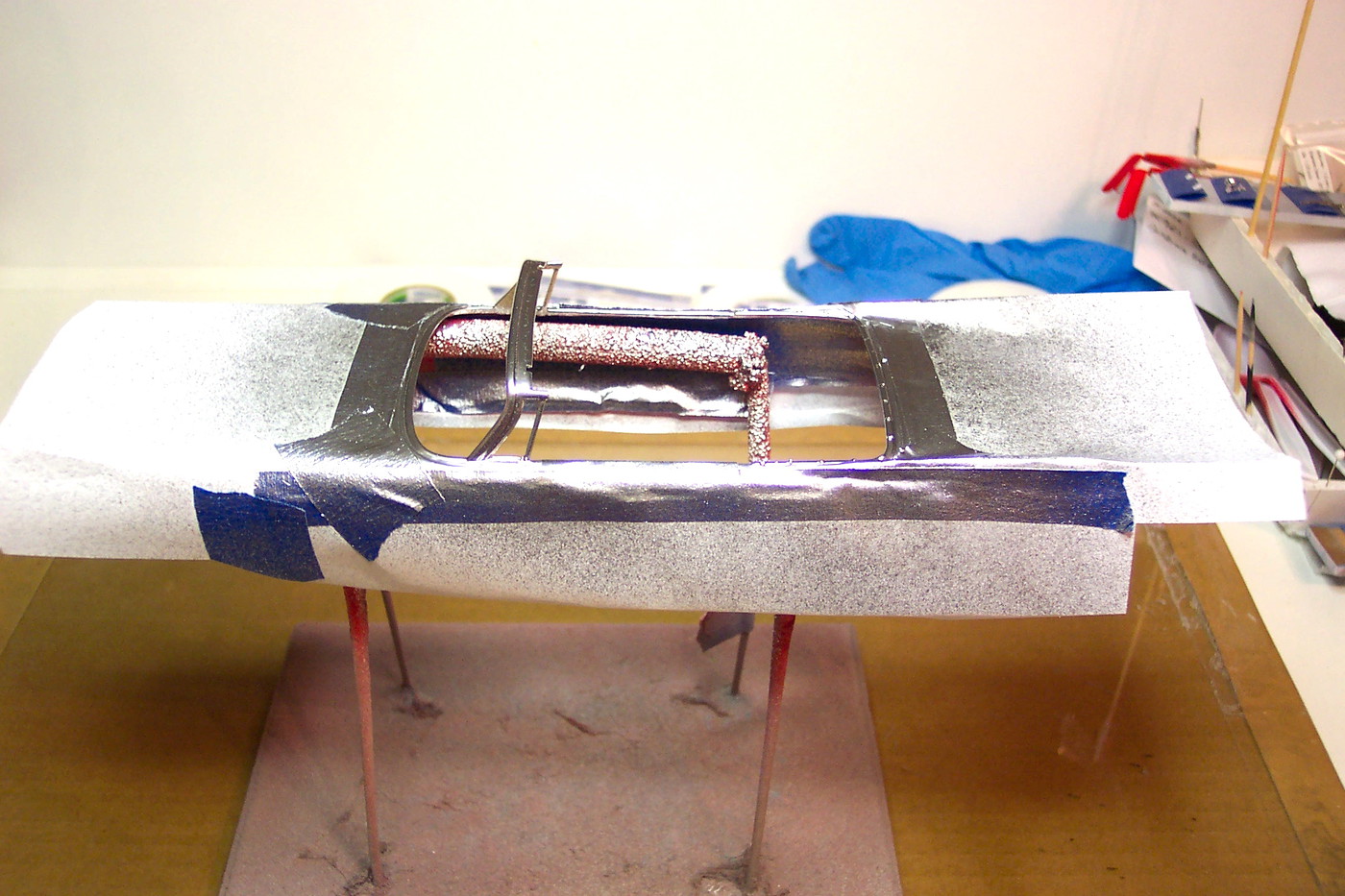

TooOld Posted October 14, 2021 Author Posted October 14, 2021 It's been a month since I've worked on this mainly because I was hesitant about foiling the body . Not because I don't like to do it , I don't mind at all and I've gotten really good at it ! I've been putting it off because I have very little of the "New Improved" stuff left , I used the smaller pieces on the interior and might have just enough left for the body . I do have a sheet of what BMF is selling now but after experimenting with it I'm not looking forward to using it . I decided to compromise and paint the windshield frame and the top/boot trim piece , this will give me enough foil for the rest of the body . After some careful masking I sprayed it with some Rust-Oleum Bright Coat Chrome , not the best but my compressor is down so I couldn't spray it with Molotow . Another compromise but it's done now and I can move on . Once it dries for a few days the foiling can begin !

StevenGuthmiller Posted October 14, 2021 Posted October 14, 2021 25 minutes ago, TooOld said: Shouldn't be an issue , Everything has been pre-drilled pre-fit and pre-assembled , it's basically finished . Plus once my bodies are painted I always wear gloves and I don't plan on handling the windshield frame . As long as it's not Molotow, it shouldn't be much of an issue. I'm no expert on these "chrome" paints, but I'm pretty sure that most of the actual paints are much more durable than Molotow ink. Steve
Oldmopars Posted October 14, 2021 Posted October 14, 2021 I like how the chrome turned out. I think it actually looks great like this as many of these carshad Stainless Steel trim and not Chrome. The spray chrome is a closer match to SS than to chrome. I say it looks great.

Bucky Posted October 14, 2021 Posted October 14, 2021 Did you use a base color under the chrome paint? It looks really good from here!

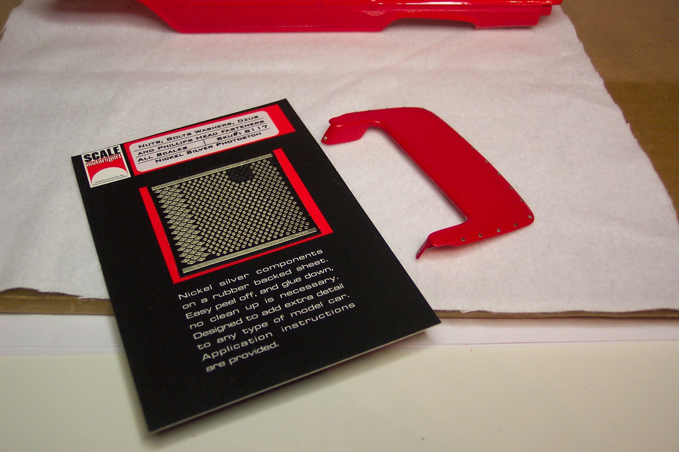

TooOld Posted November 6, 2021 Author Posted November 6, 2021 It's been a while since I posted an update but finally had some time last week to work on a few things . After painting the top boot I applied the snaps by dabbing a little clear and then positioning the washers , when everything dried it was sprayed with some semi-gloss clear . Also glued the headlight lens in place to finish the grille/bumper . The big task was foiling the body . Not a lot really but it was more difficult since I was piecing together small pieces of the New Improved Chrome I have left . The side trim for example used six or seven pieces and took a couple of hours to finish each side . The rest was pretty straight forward except for the taillight bezels which are a combination of foil and Molotow Chrome . There are several small details to take care of and then I can start the final assembly . I might just finish it this year !!

TooOld Posted November 6, 2021 Author Posted November 6, 2021 On 10/14/2021 at 6:20 PM, Bucky said: Did you use a base color under the chrome paint? It looks really good from here! It was sprayed directly over the red paint . These chrome paints spray very heavy so you need to hold the can at least 18 inches from the part being sprayed and move the can side to side quickly .
