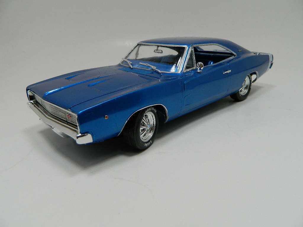

mrmike Posted August 5, 2021 Posted August 5, 2021 (edited) I'm interested in seeing this painting process and I would like to see more. Here's a picture of my latest '68 Charger R/T painted with Tamiya TS-54 Light Blue Metallic that I recently finished. I started this build 4 years ago. Edited August 7, 2021 by mrmike 2
ModelcarJR Posted August 10, 2021 Author Posted August 10, 2021 Thanks, all! Nice looking charger, MrMike! Unfortunately, I ruined the paint and I'll have to start over. But its really hot and humid right now so it might be awhile before I can start over. I've ordered some Tamiya paint so we'll see when I get back to it. ?

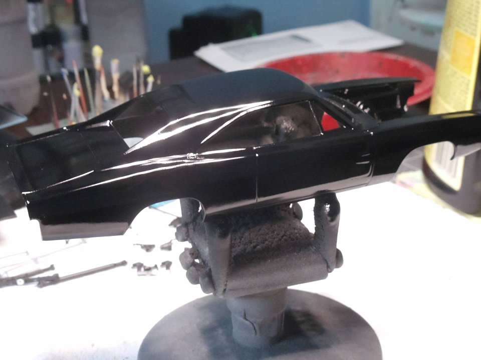

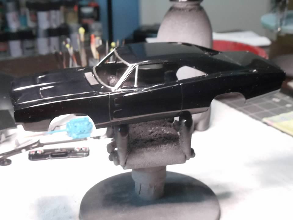

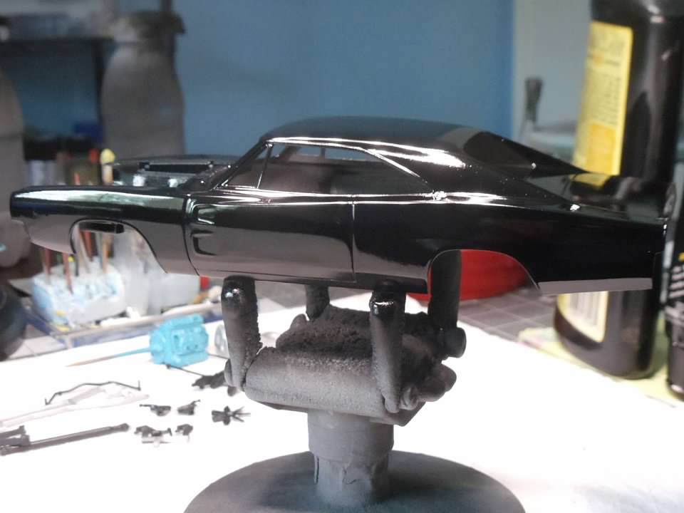

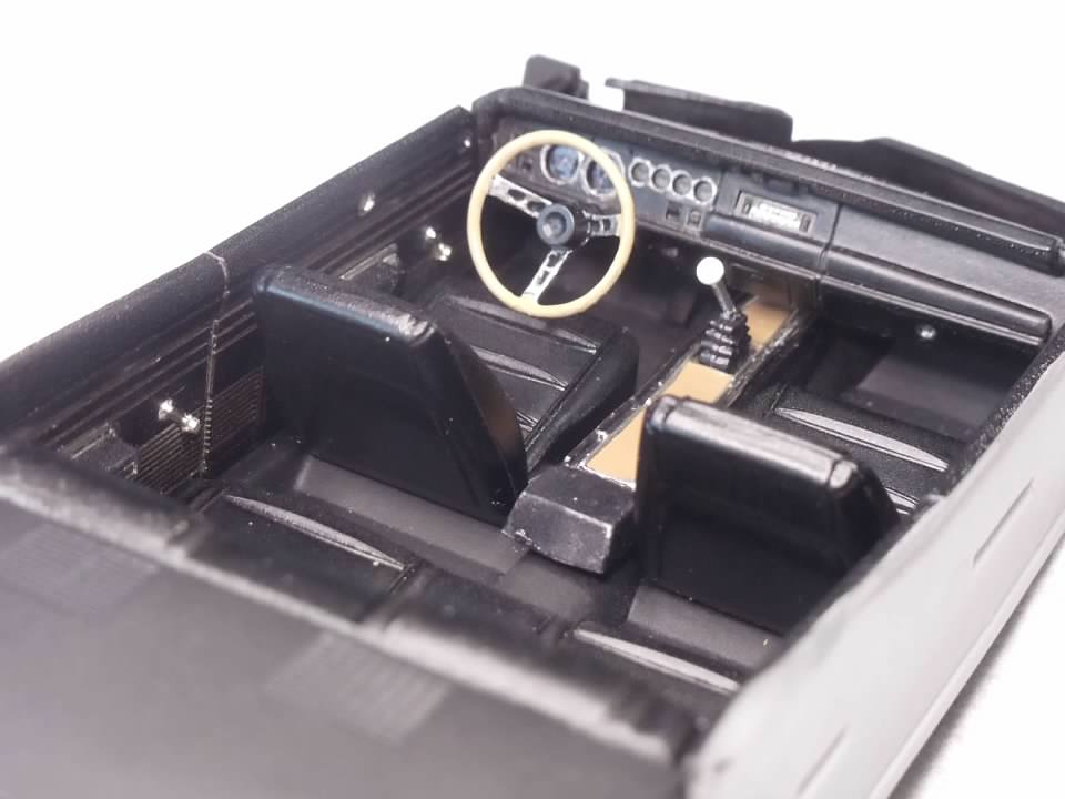

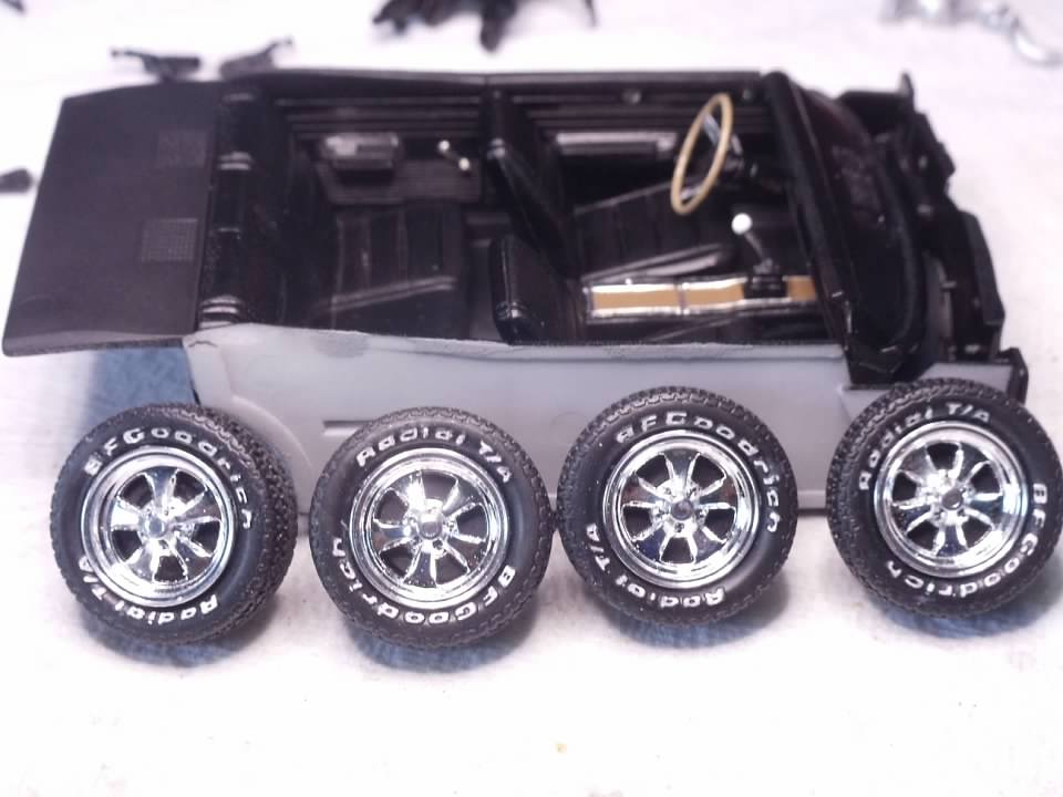

ModelcarJR Posted August 23, 2021 Author Posted August 23, 2021 Thanks, Bob and Carl! I appreciate your comments! its been awhile but I finally got back to this one and put a few things together. Found some tires and some spacers for inside the wheel to glue to the wheelback and the chrome wheel to keep the tire tight on the wheel. Also assembled the interior. Its missing a couple of pieces in this bagged kit, the grill on back of the console and the interior foot lights on the console but I can live without them. I also finally had a opportunity to get some paint on the body despite the weather. I oranged-peeled the first coats so I was forced to sand it down with some 400 grit seasoned sandpaper and let it sit overnight. The next day I added a another coat and it turned out pretty well. I don't think I can improve on it so I am just going to add a clear coat or two and see what's next. Thanks for looking! 1

gotnitro? Posted August 25, 2021 Posted August 25, 2021 wow, your black paint is looking fantastic ! My dad used to paint cars for years, always talking about the older lacquer paint jobs using this exact technique
TransAmMike Posted August 25, 2021 Posted August 25, 2021 Grrrrrr8 looking black paint....most of us would probably like to know what paint you used (unless I missed it).
David G. Posted August 25, 2021 Posted August 25, 2021 The paint looks great! Nice interior detail too. David G.

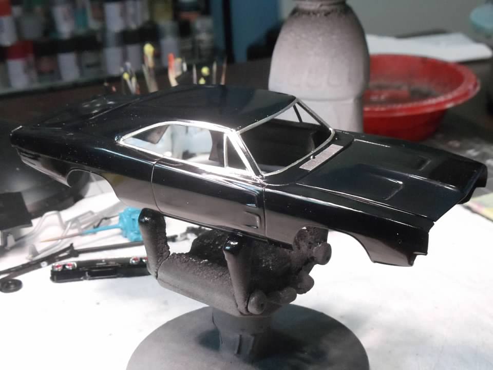

ModelcarJR Posted August 26, 2021 Author Posted August 26, 2021 Thanks, All! I appreciate your comments! Mike, the paint is Tamiya Black, TS-44 and Clear, TS-13. I had a terrible start, having to remove all the paint, but it has finally turned out well. I had planned to paint and rub out the paint several times but it wasn't necessary. Only two coats of paint and one coat of clear. I sanded out the first coat of orange-peeled paint with 400 grit seasoned sand-paper and rubbed it out after the first coat of clear. I decided I can't do any better. I am now in the process of applying the BMF. Thanks for looking! ? 2
