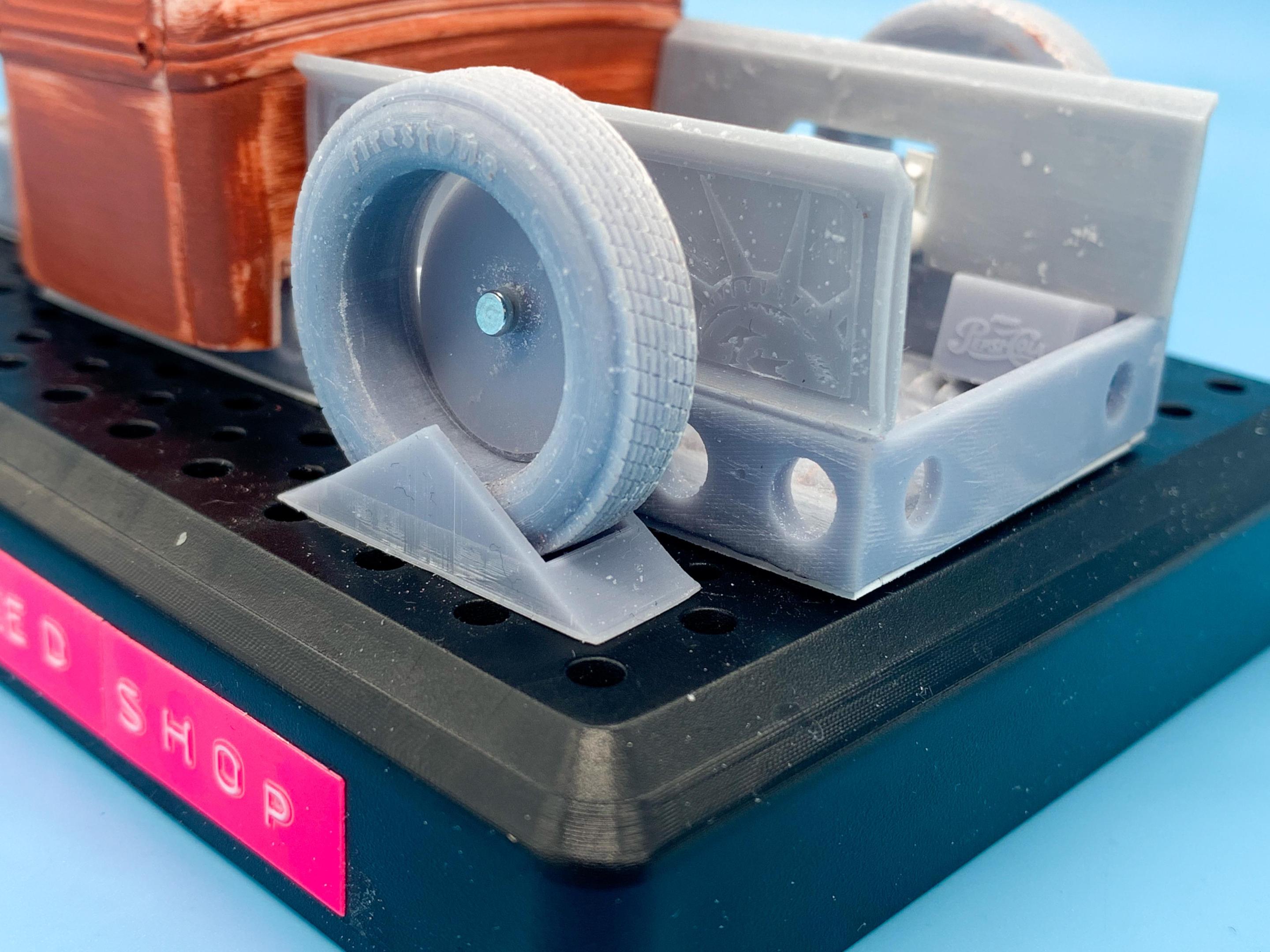

The ideas I have floating around in my head!!! Are you thinking about selling those wheels and tires by chance?
They’re probably not mine to sell, I’m afraid…the designers of most of these files sell them for a coupla three bucks for personal use but not resale.  Wouldn’t be fair for them to spend dozens of hours designing them and then they only sell one ‘set’ (the file) for three bucks to whoever feels like printing a hundred of them.
That said, there’s some great vendors like @IceMan Collections who are good at working out deals with these designers and they’re a GREAT looking part so I’m sure they’ll end up on eBay or somewhere at some point…

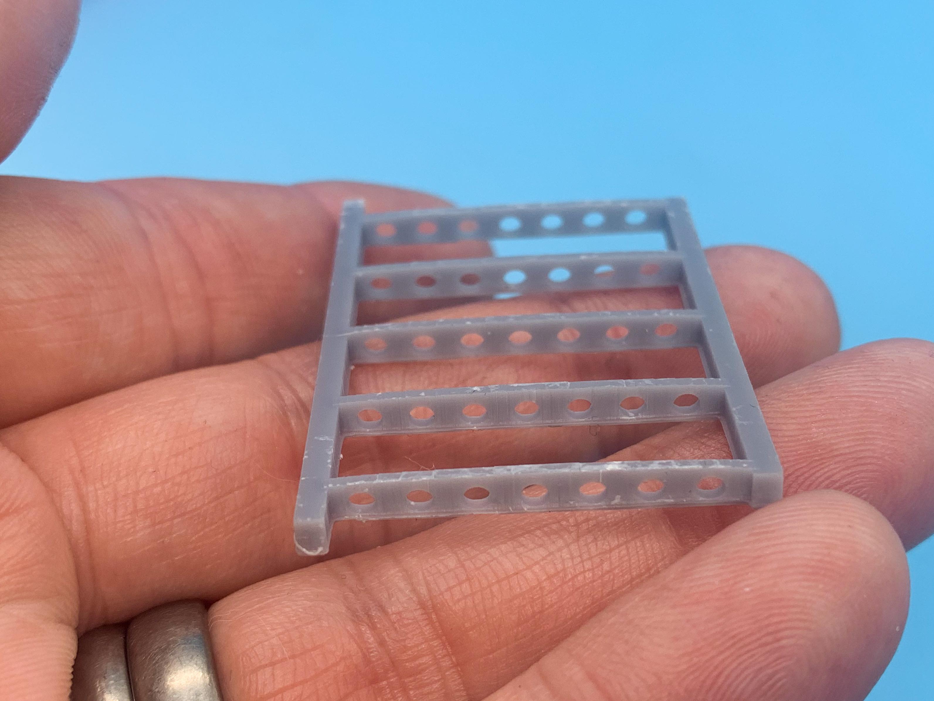

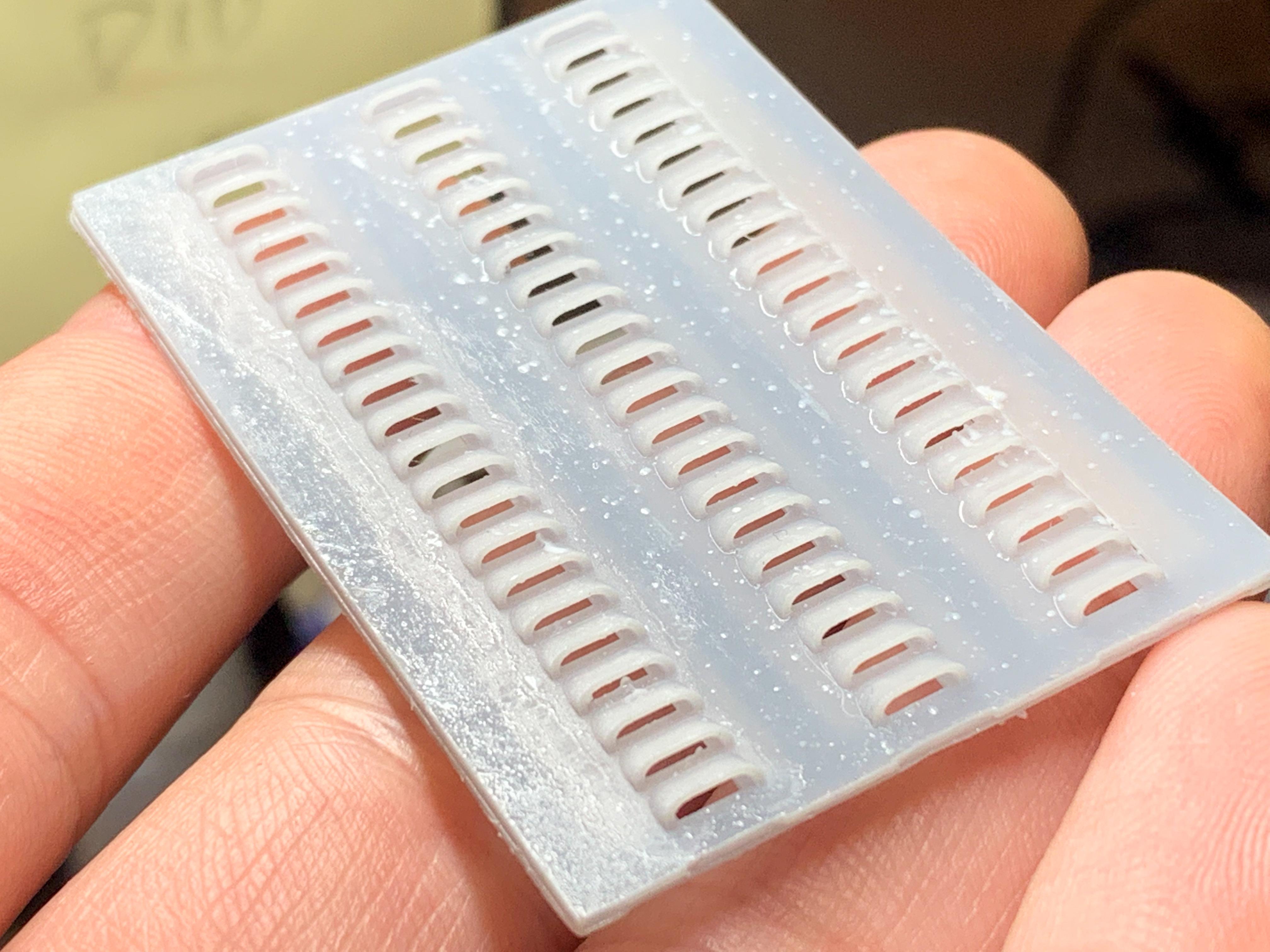

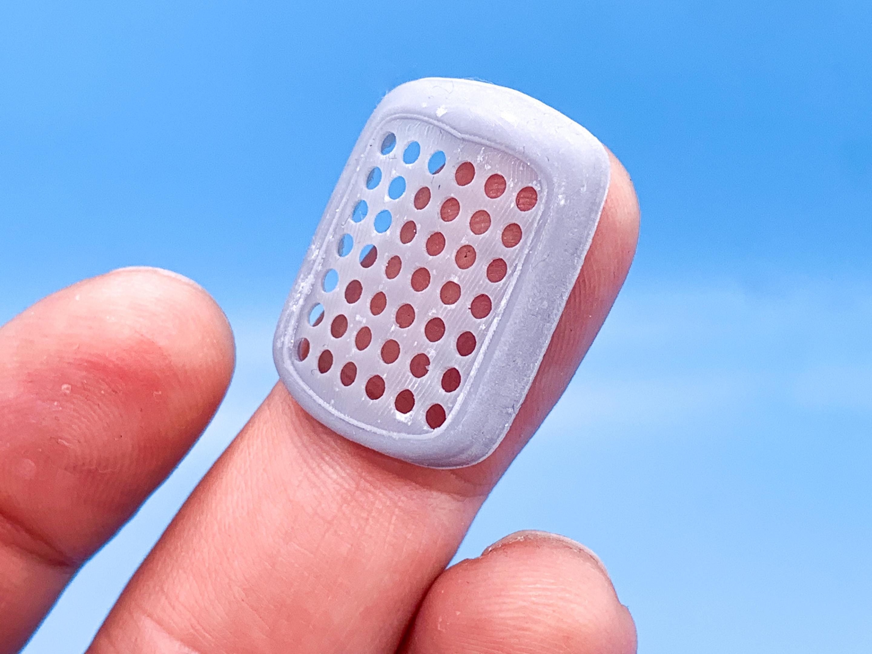

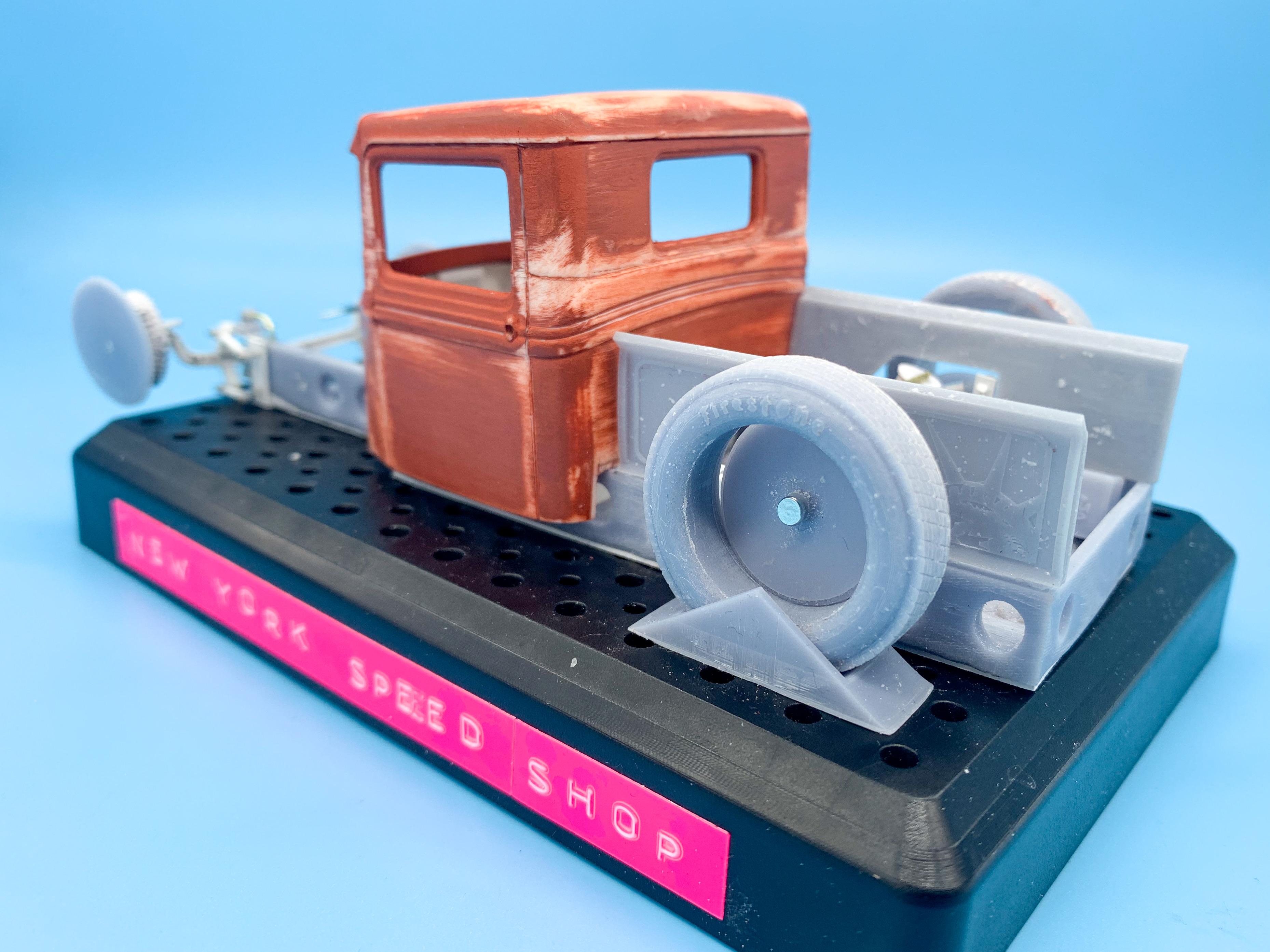

Mini update seeing as I wrote War and Peace up there anyway already…I’d been working on how to print actual 3D louvres (complete with openings) for about 100 hot rod projects I’ve got in mind - finally got a set successfully printed after a few tries this evening:
They’ll need some clean-up before paint but not too much…and it’s worth it to have those ACTUAL open louvres rather than just bumps.  Super pleased with these!
This particular test piece is also the bed floor for the truck - drops in just like this:
They should actually be the other way around if there were cooling anything…but they’re just for looks and because I had the dumb idea to try and make them work…
You’ll have to peek inside the bed to actually see them anyway once the bed sides are on, but I’m pleased!

Cab Driver, 1st time I've ever seen a open 3-d printer louver on anything! Great job! I can see now you are going to be A GREAT INNOVATOR FOR 3- D PRINTED PARTS! Thanks for the inspiration!
You're a man of honor, I see :D As a designer of 3D parts I find it encouraging to hear this sentiment expressed. It's why I don't sell digital files...yet. Eventually 3D printers will become so ubiquitous that the tide will turn.
And dude, those louvers are spectacular!
Those louvers aren't meant to bring air in for cooling, like a scoop. In old hot rods they were either meant to let hot air out of an enclosed space (engine compartment) or allow air flow through the body that develops at speed (air under the car getting trapped in the interior/trunk) So in this instance they would be allowing air that's trapped under the truck to escape and alleviate any lift it could cause at speed.
That being said, that louvered panel is sick. Glad you got it tp print successfully. Now, if you could print it on a thin enough piece that would allow you to bend it slightly to make a trunk lid or roof side panels.
Just had a thought, what if you made another louvered panel for your roof insert?

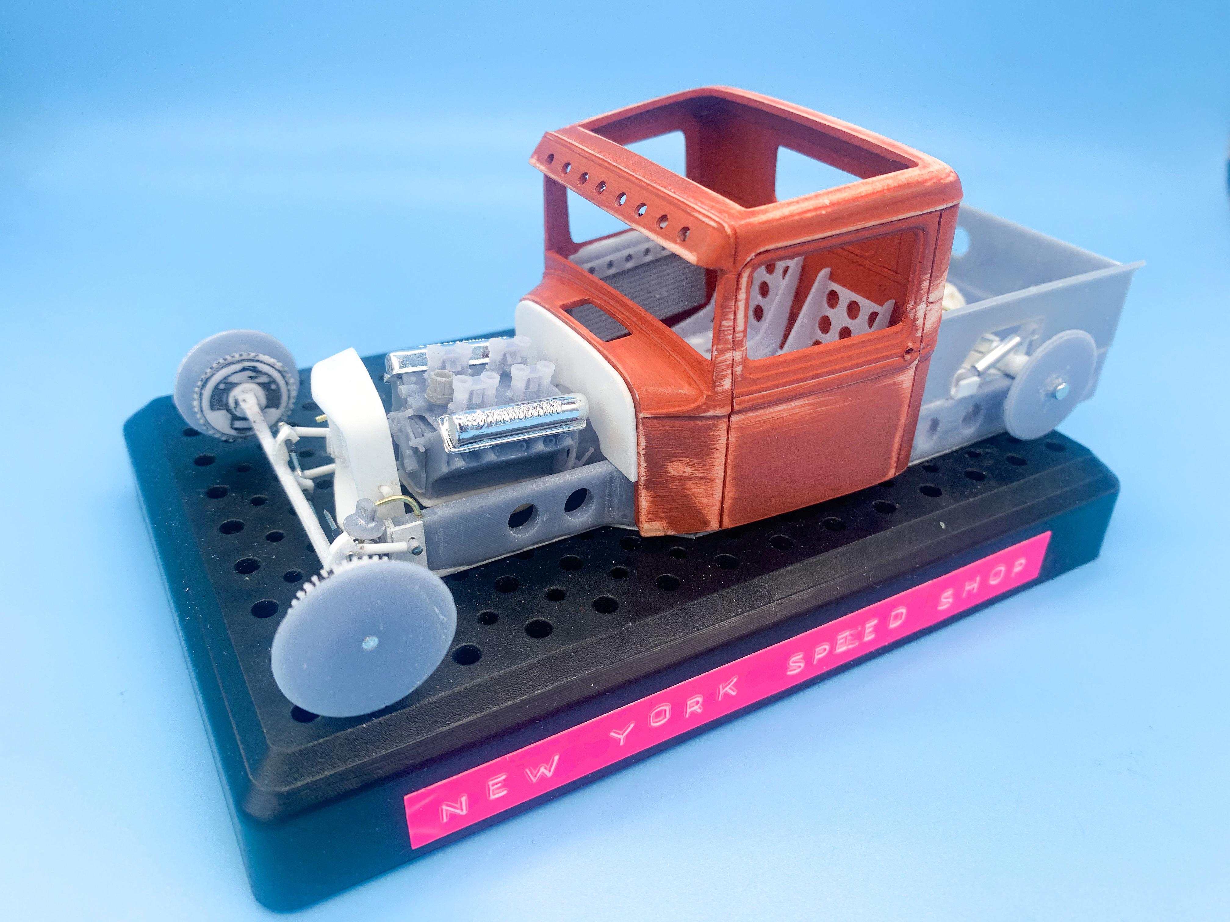

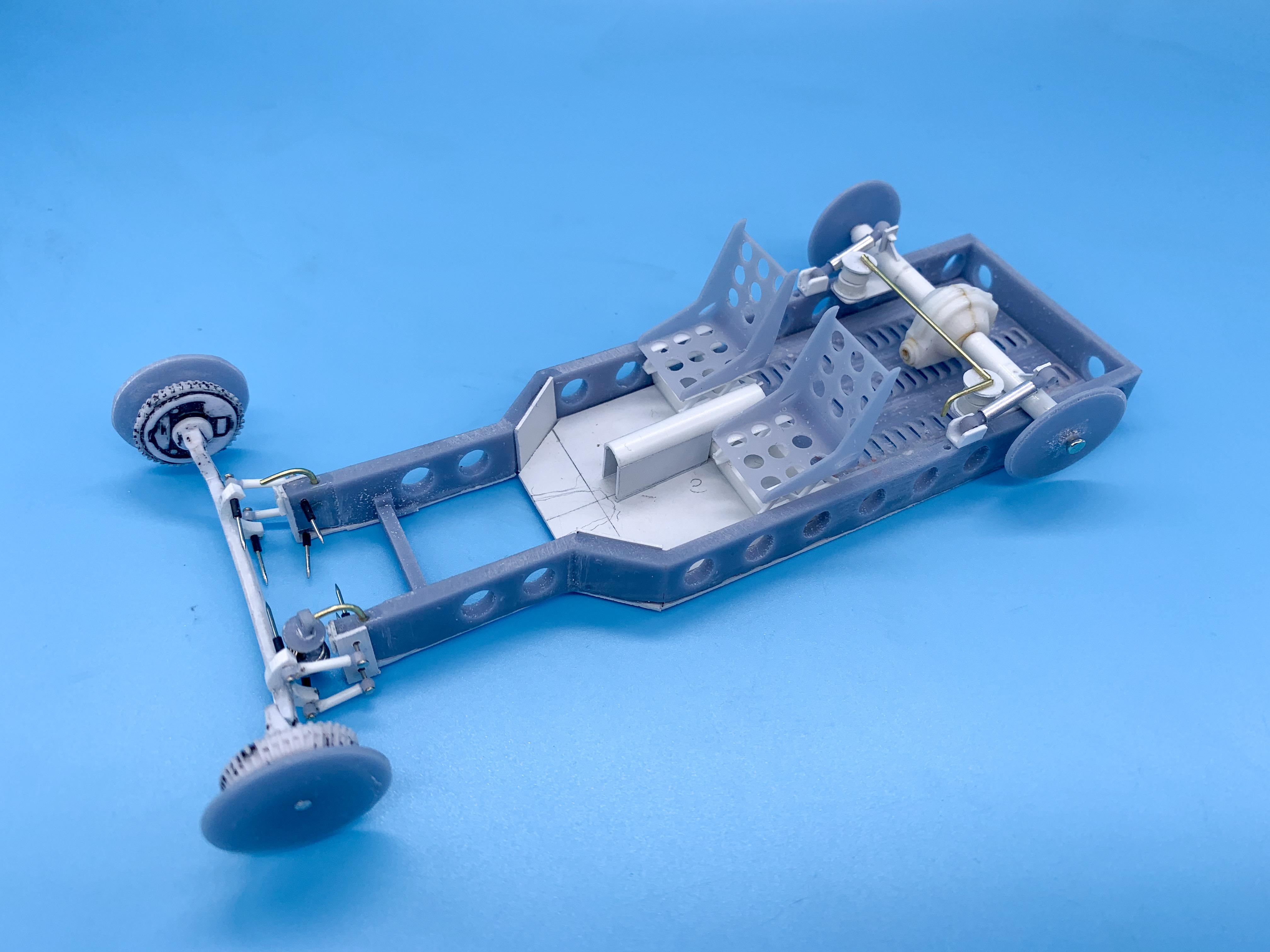

So, a little more progress today after a snowstorm got me sent home from work…
I really wanted to start work on the interior, but I’m not quite far along enough with the frame yet.  Got a floor roughed in as a starting point…

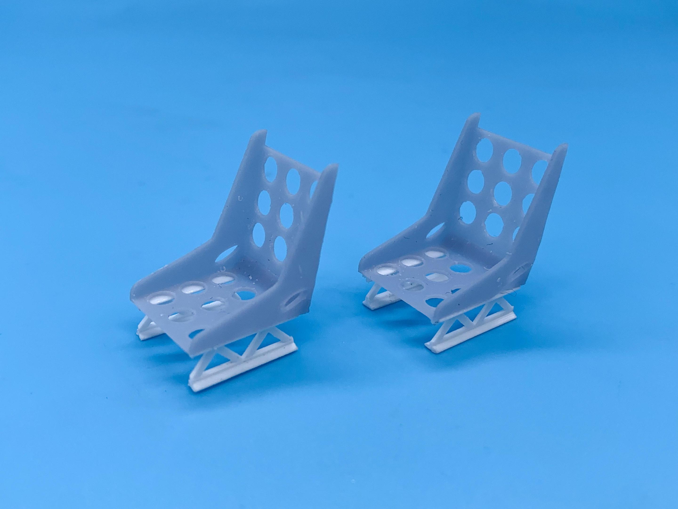

…and some risers made for those bomber seats…

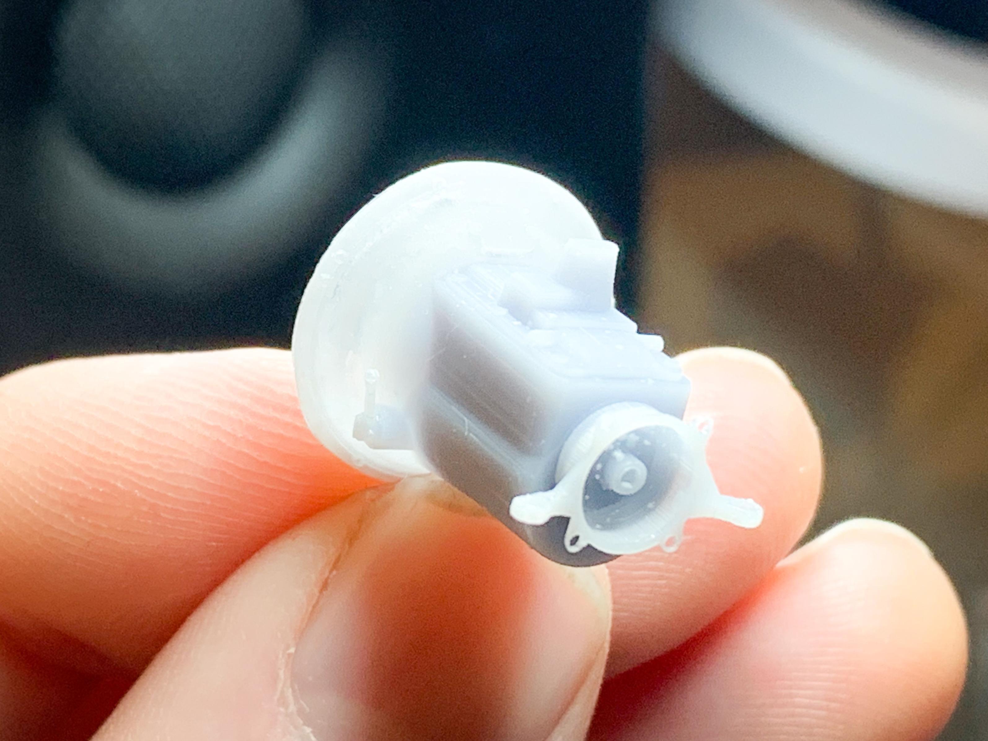

But I really need to figure out what I’m doing with the engine and trans first.  I really want to use an FE block (the Mysterion that I’m referencing with the frame ran a couple of those and the kit comes with one so it seemed fitting) but this being such an old kit the detail isn’t the greatest.  I was stumped on what that transmission was meant to be too, until @Dennis Lacy pointed me in the right direction; it’s meant to represent a Ford toploader three-speed but doesn’t look close enough to one that I could figure that out.
A little 3D printing later and I’ve got something much more realistic to work with:
Needs some work still, but a much better starting point.  As for the block, I’m either going to have to pick up a kit with a better FE, or maybe try modifying a kit motor that I have already to backdate it to the right look.  Is the Revell 32 Ford motor an FE, does anyone know?  Got a tonne of those, but I’m not sure how close a 60s T-bird mill looks like a 90s Mustang mill.  Need to do some more research!
The more I add to this frame the crazier it looks - I love it so far!
Thanks for looking - more soon!

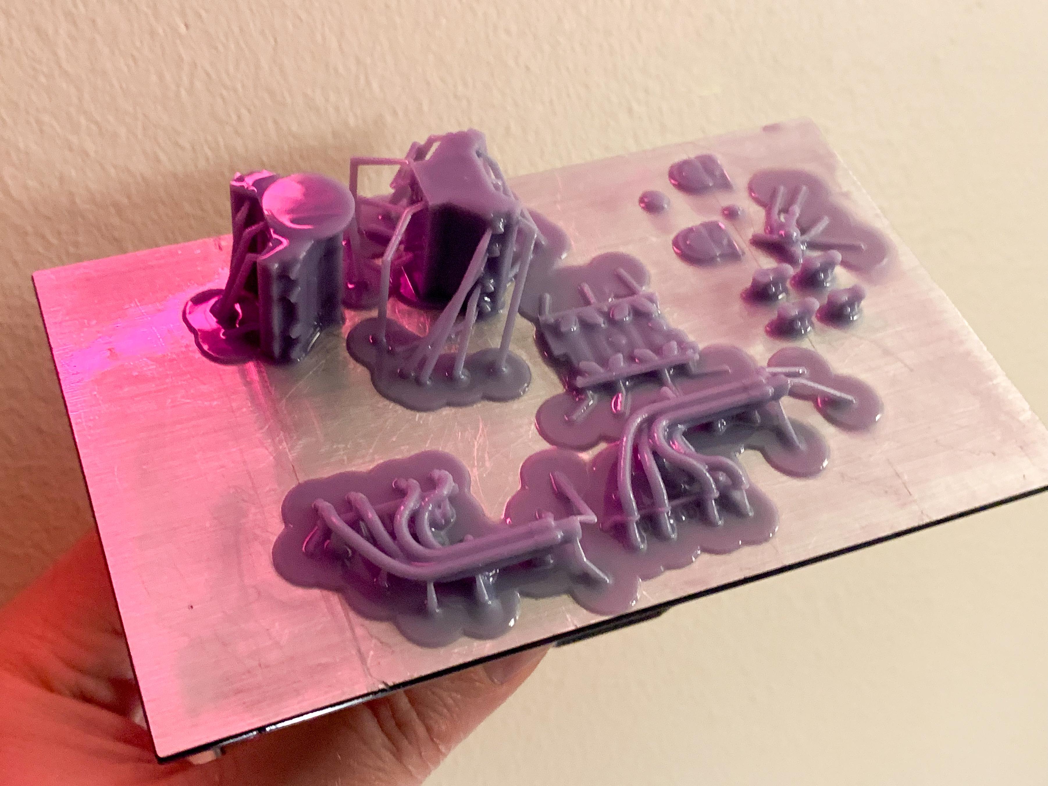

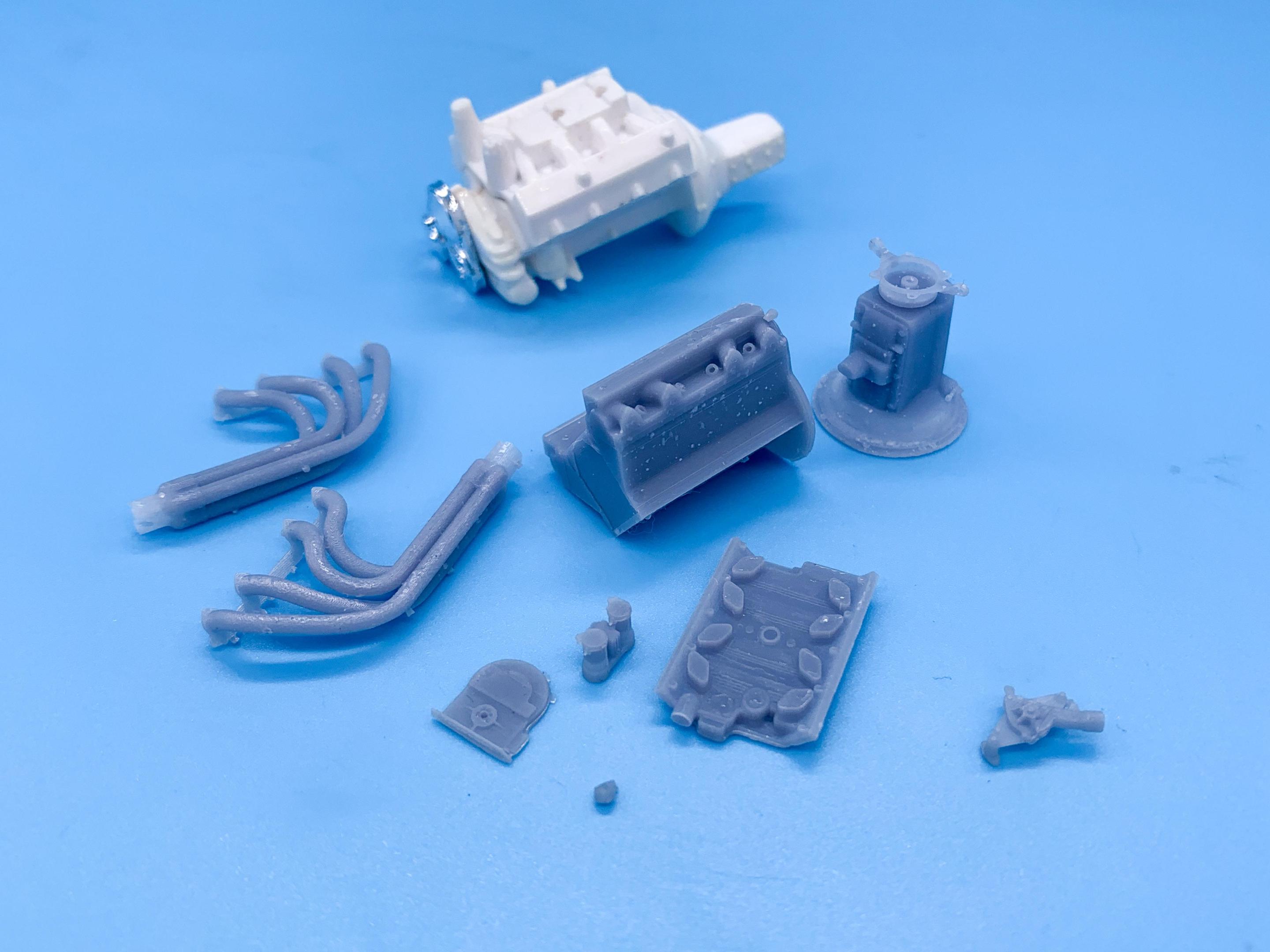

This week’s project was mostly centered around the motor, seeing as that was holding everything else up.  I considered buying one of the AMT kits that has a better FE, but I really didn’t want to wait for one to show, and Hobby Lobby/Michael’s didn’t have anything useful.  So, I laid one out in software so I could print one:
I couldn’t find a good printable FE online, but I found some useful parts and robbed what I could and recreated what I couldn’t.  I wanted to use the kit oil pan and valve covers ideally so it took some figuring out to get this layout to proper scale AND have those AMT parts fit ok…a couple of elements are slightly off now as a result, but it’s WAY better than what the kit comes with.
First rack of parts right off the printer:
And some snipping, cleanup and curing later we’ve got something to work with:

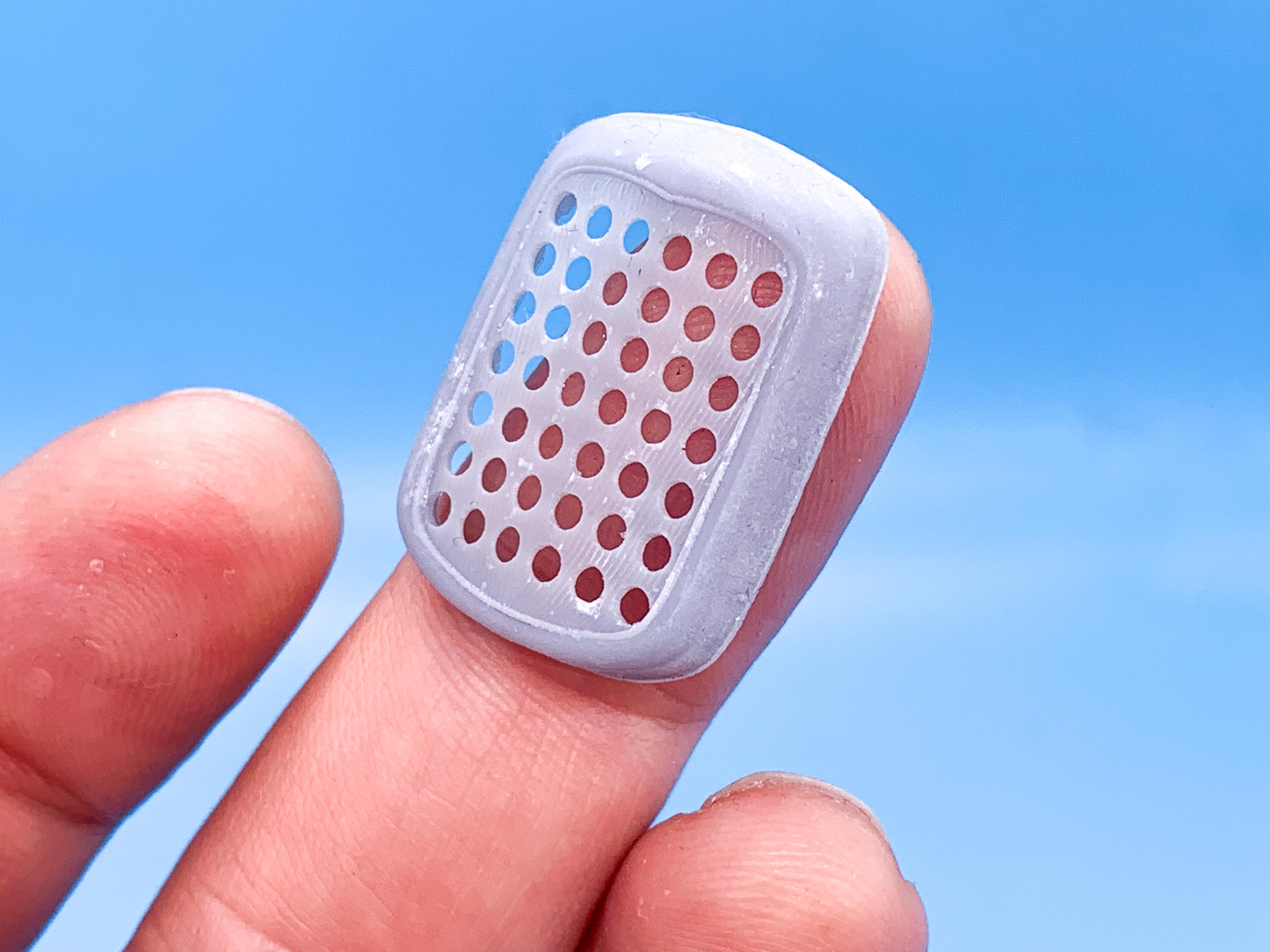

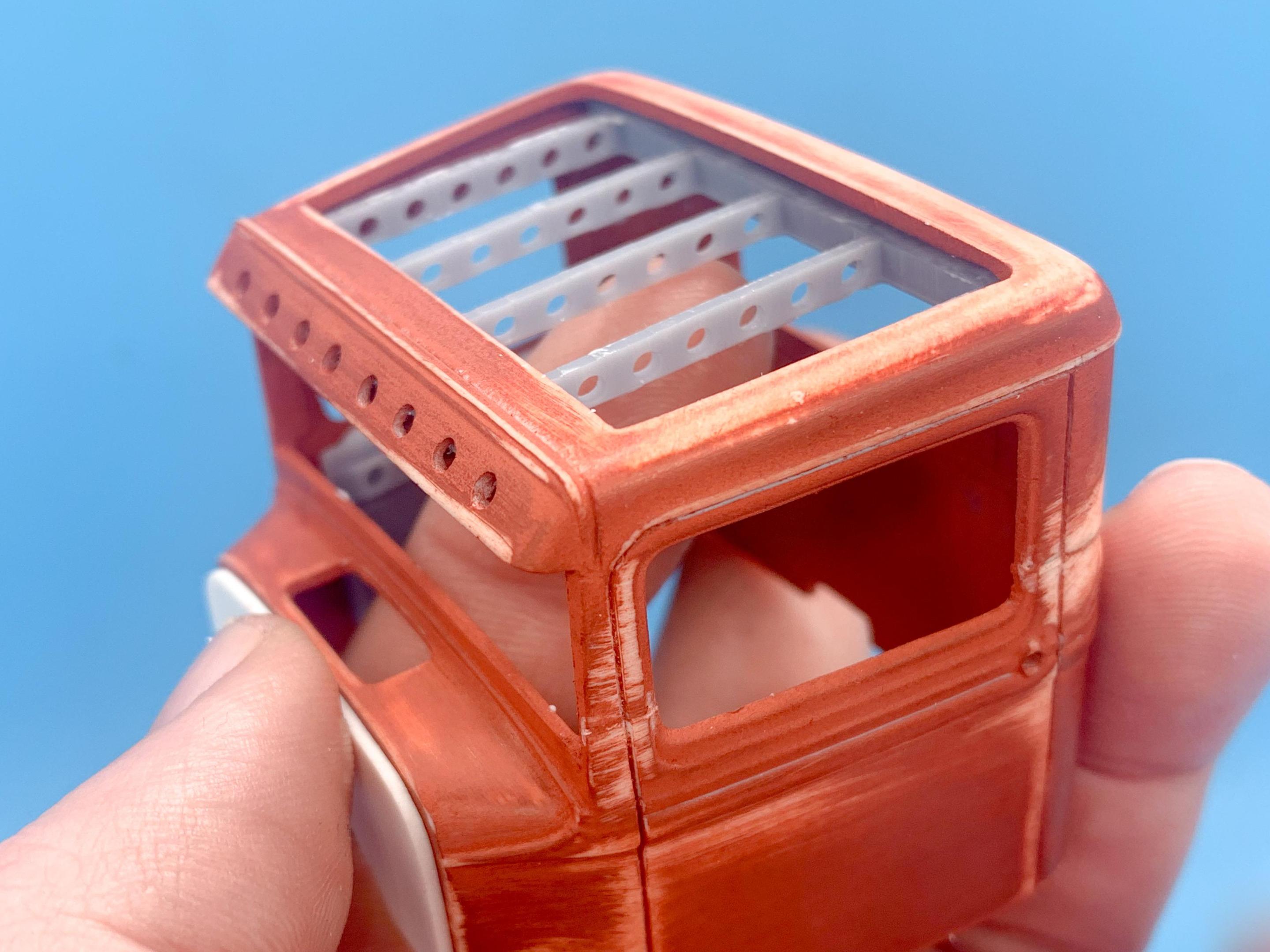

Next project was an ‘wooden’ insert for the roof - I had the idea of carrying the hole-theme through into a few other little details but mixing in some different materials and finishes…plus, I was thinking of how old aircraft wings are assembled with the slats and wanted something that looked like that, a little:
And in place:

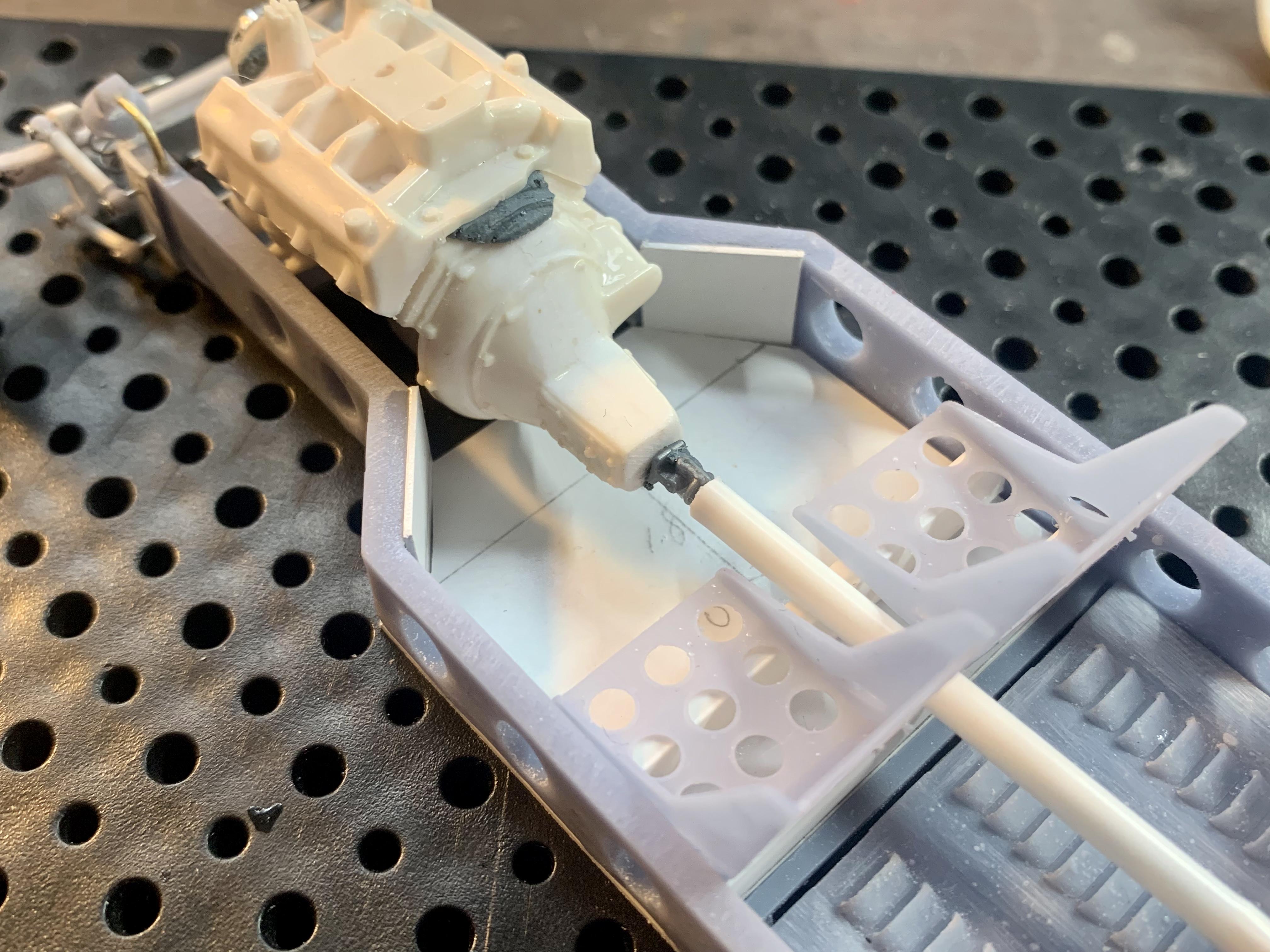

Quick end-of-week mock-up - now I know for sure how the engine and trans fit I can get to locking them in place and getting serious with the interior stuff:

Mini update from this evening’s time at the bench - finished up the design for my bedsides and did a test print:

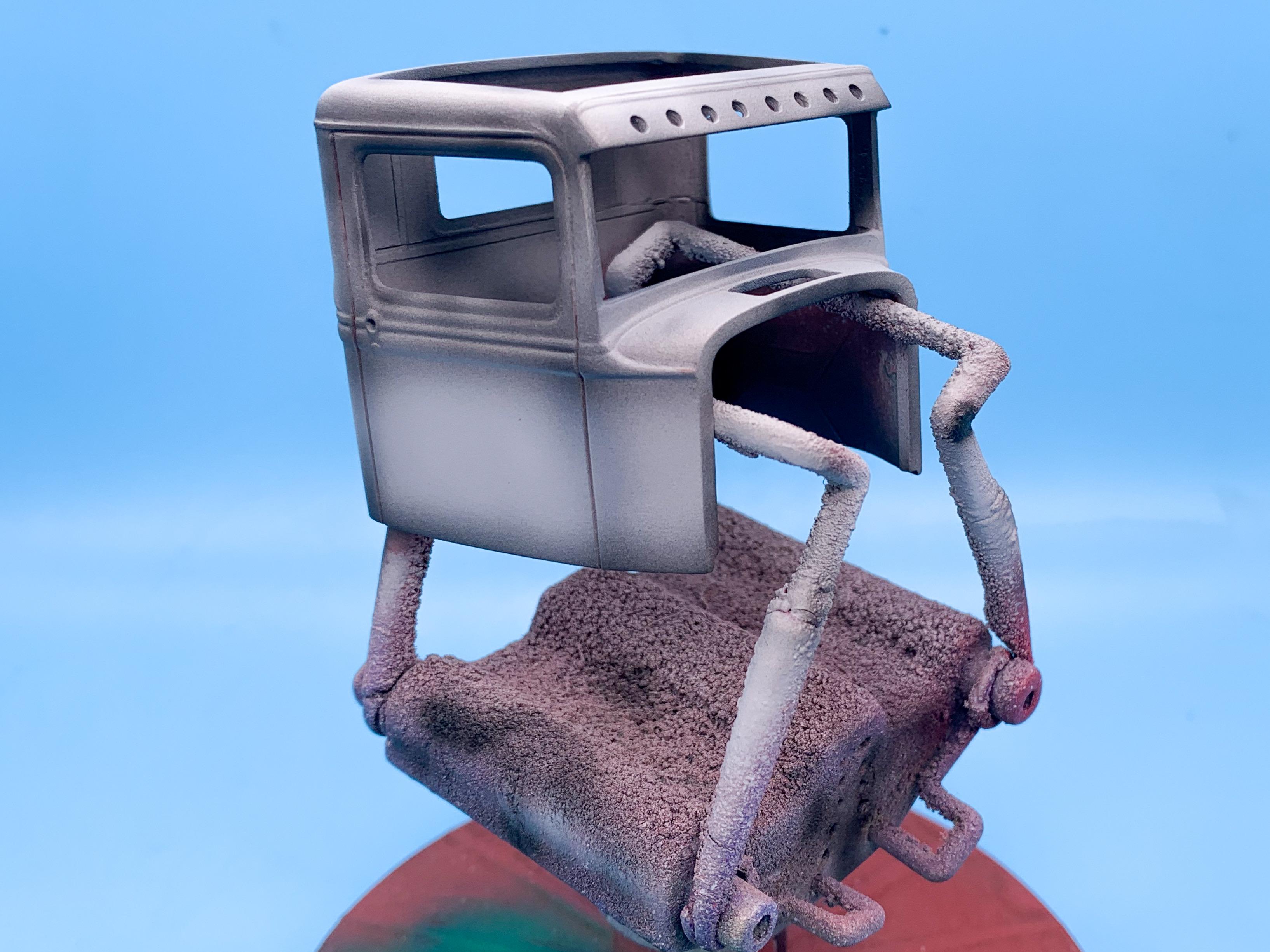

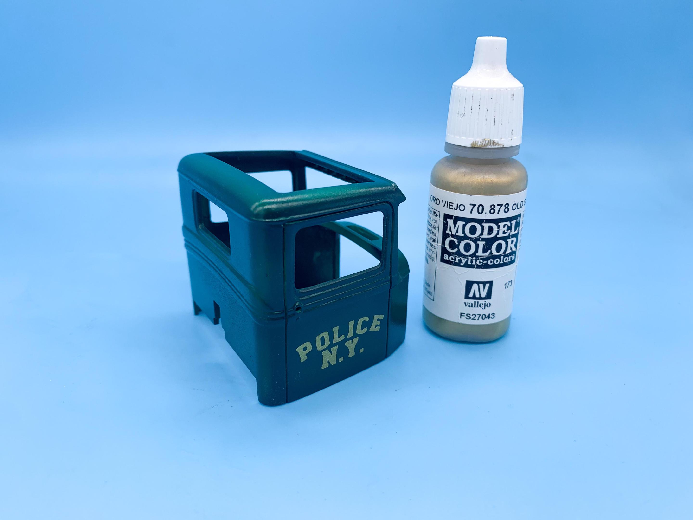

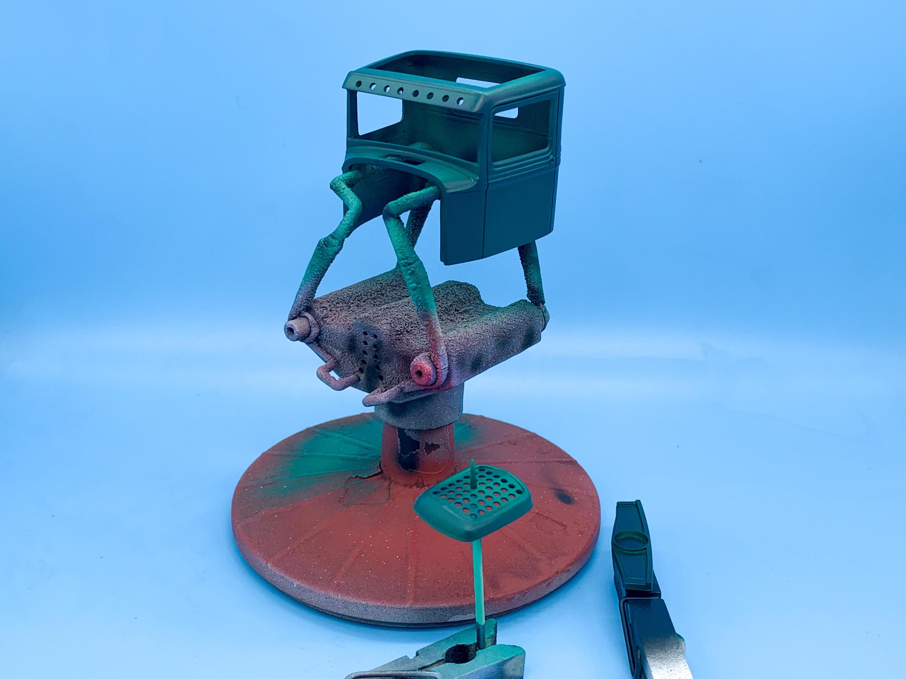

So, I didn’t update this build for a while because I’ve just been cleaning up parts and designing little doodads and whatever and learning some stuff…but I figured it was time for an update anyway…

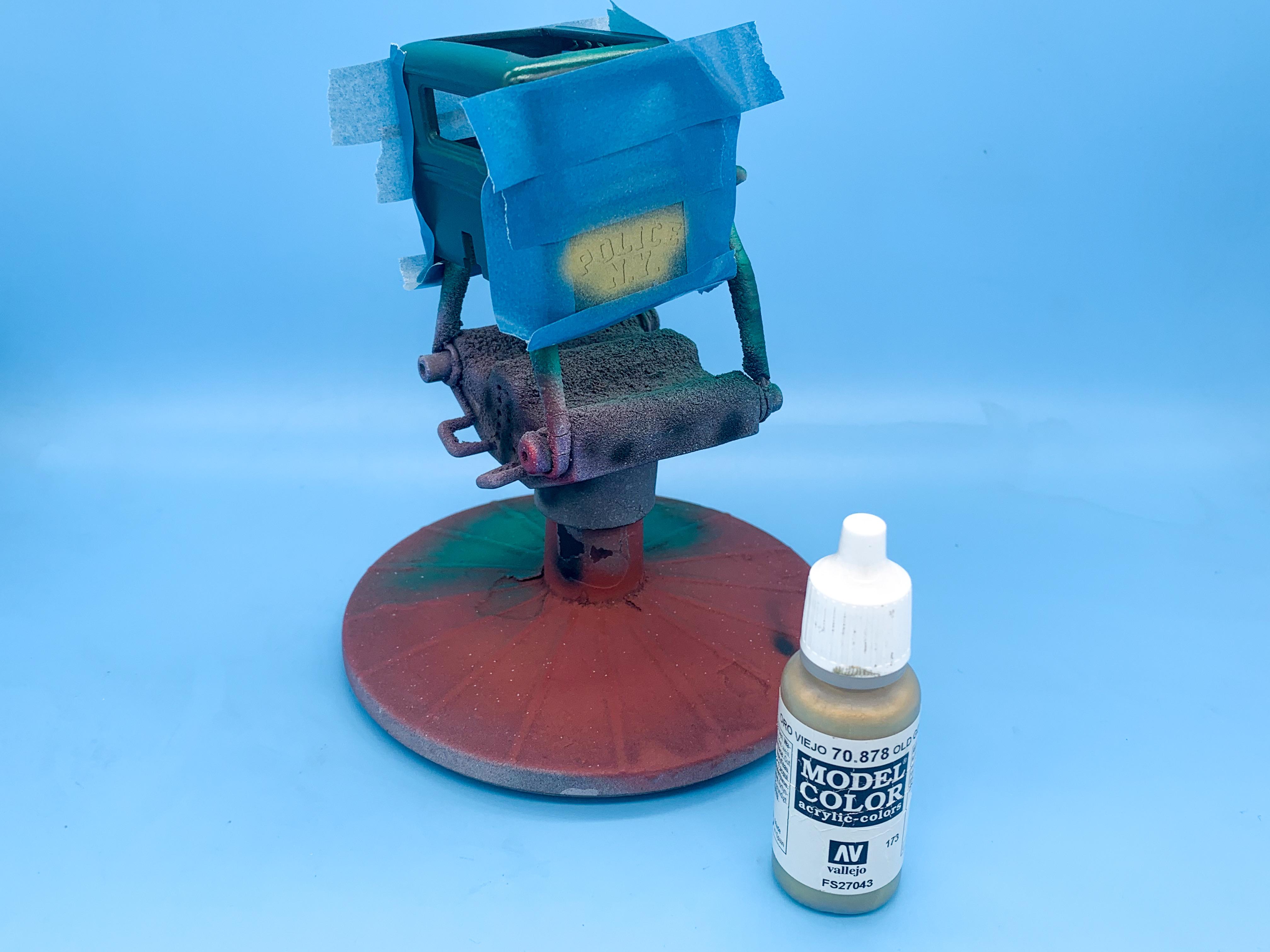

Got the body all cleaned up and into primer - I’m doing a paintjob inspired by the old trucks that the NYPD used back in the 30s.  I have no evidence that they ever used ‘34 Fords (they were much bigger, more like fire trucks generally) but they were green with gold lettering and I liked the idea that someone in the 60s found an old cab somewhere and built something Roth-inspired around it.
Military modelers use a trick where they pre-shade underneath their paint with different tones to give a simple paintjob a little more depth and realism, and because the Wicked Colors paint I’m using is a little translucent I can use that same trick to make this almost-90 year old paint look like it’s aged a little:
I’m not going for a patina’d look here, just really old but clean lacquer (or I guess enamel maybe?  Whatever they were using back in the day…)

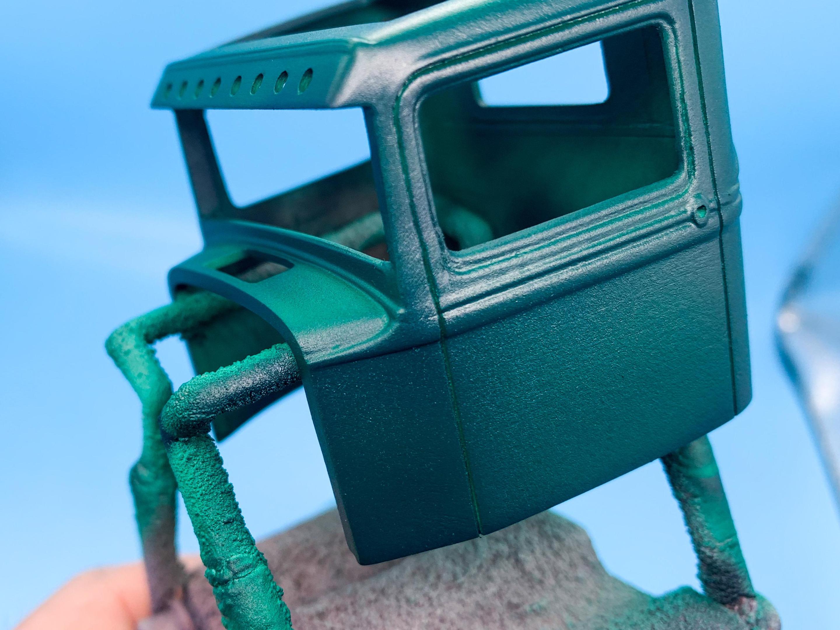

Next up, twelve coats of Wicked green:
Followed by some lettering in Vallejo Old Gold:

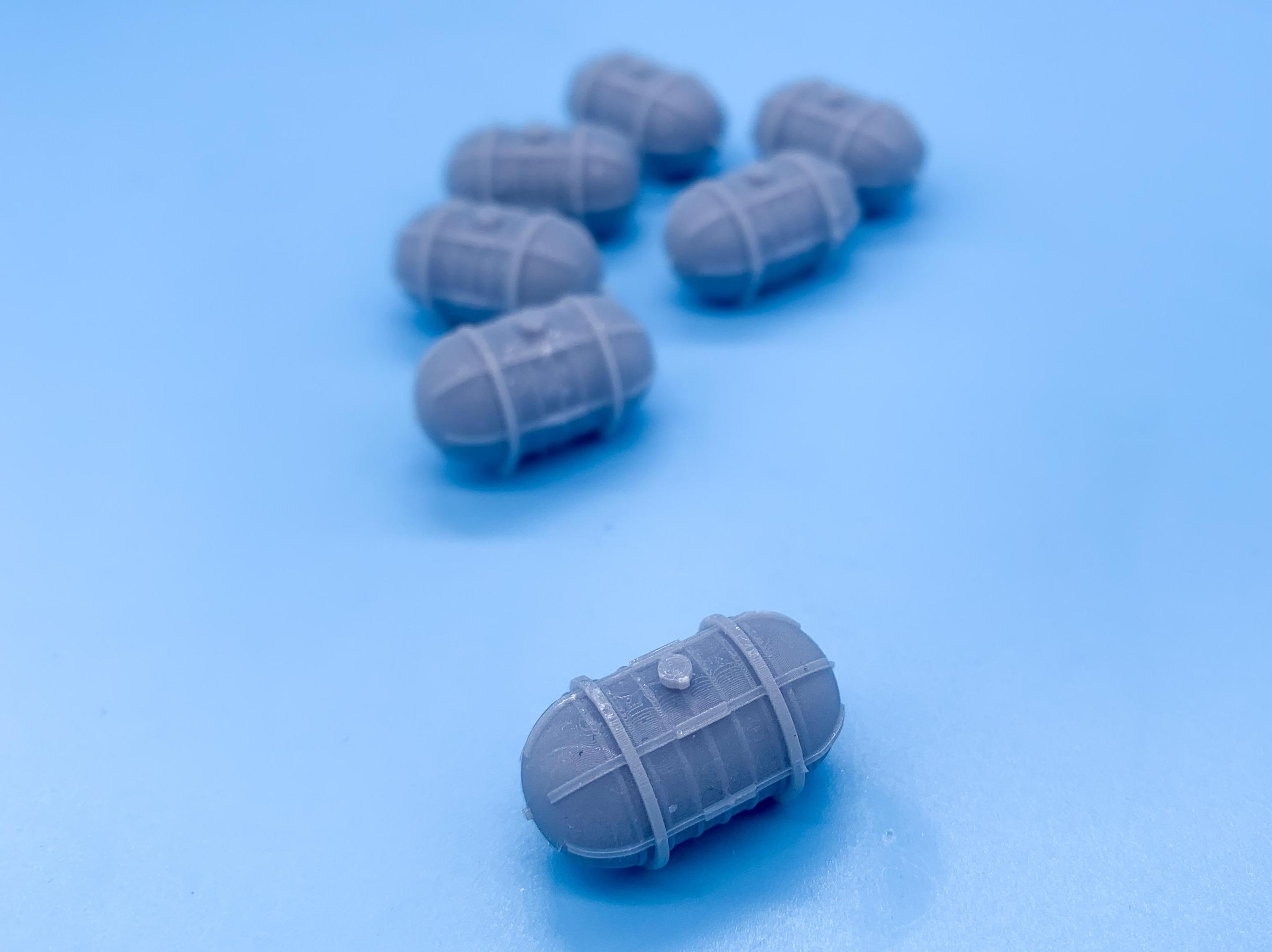

Printed some B17 oxygen tanks to use as a gas tank:
Conveniently, these things came in dark green for certain applications, so they work with the color scheme and are unusual enough that I thought it would fit with the theme I’m going with here…

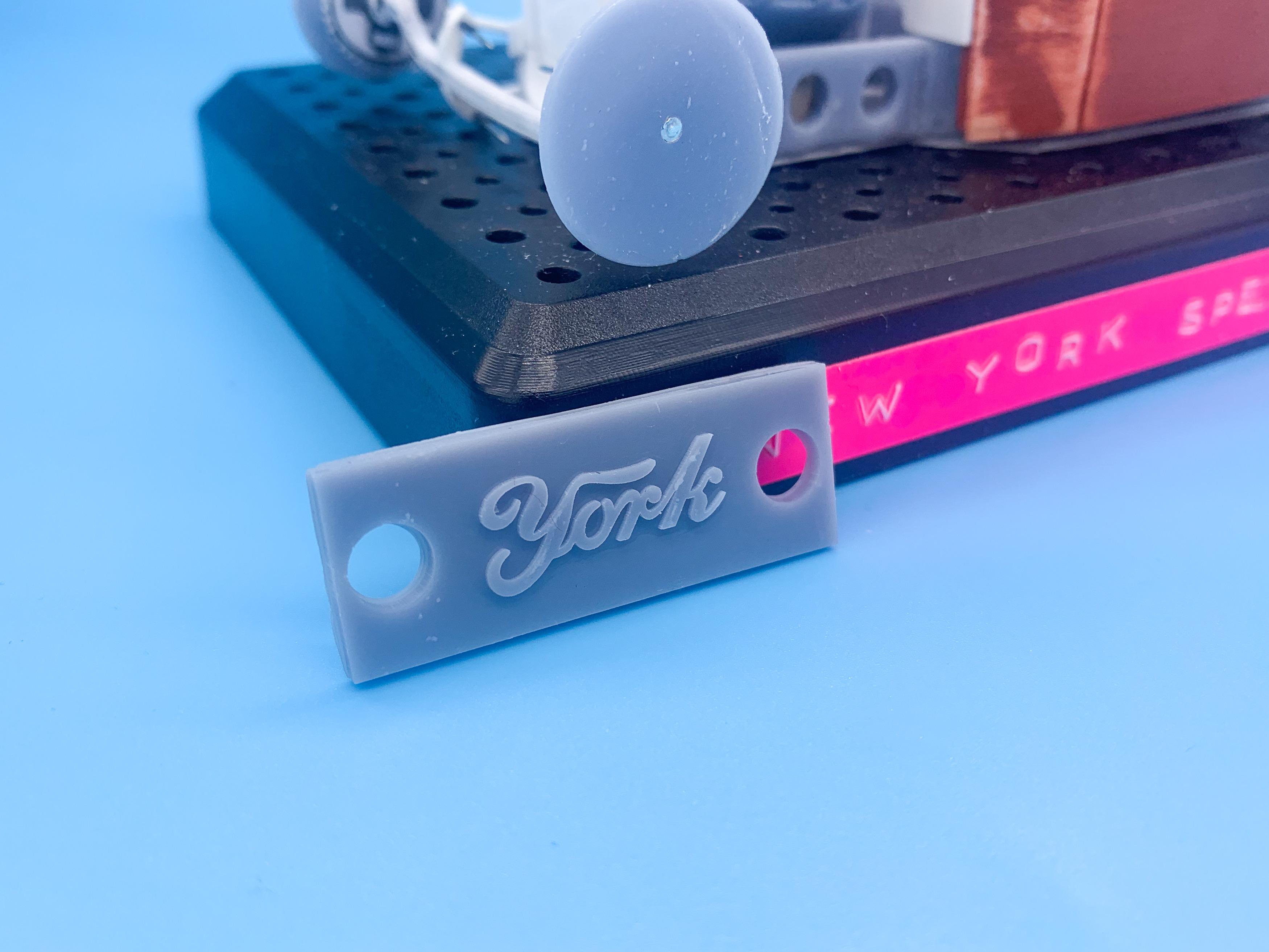

Oh, and I stumbled upon a new grill that caught my attention so I printed one of those too:
Finally getting to the point where there’s not much left to design on this thing (thank God - this was basically like designing a whole kit!) so it’s about time to start spraying some colors and doing some assembly.  More soon!
