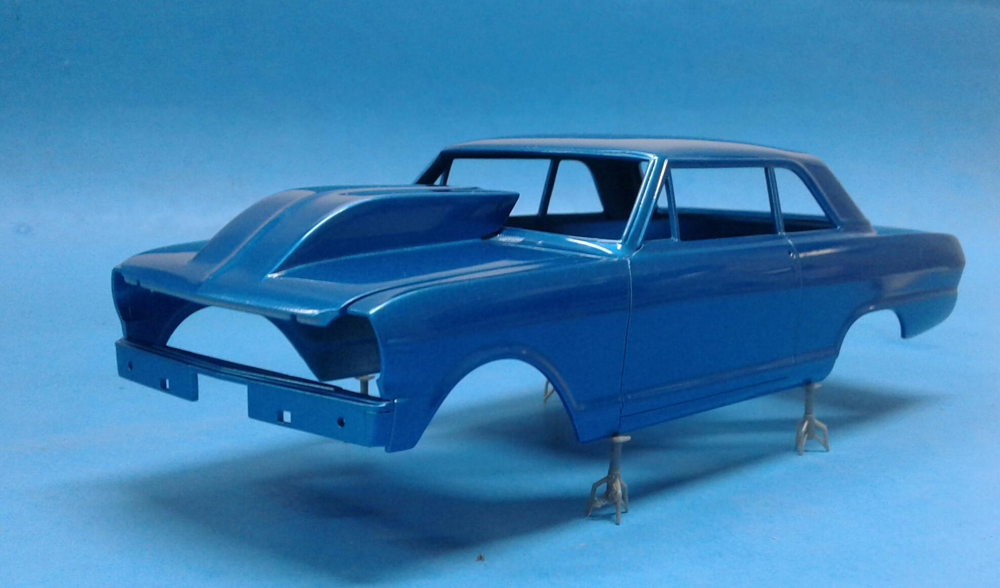

Oh ya, looking good in blue. The colour really brings all the bodywork together Roger. Looks fantastic as is, but….. If you can sneak the rear down a couple inches it’s a definite home run.

Thanx Steve! Unfortunately, I can't lower the rear any more. At least not without a ton of work involved. The juice isn't worth the squeeze. I may flip the front spindles back to original and see what it looks like. I think it will raise the frontend about the same as I wanted to lower the rear.
Just seeing this for the first time, what an excellent build you have so far. The final hood scoop looks fantastic, I think the stance is perfect as-is, and that color looks awesome. The Tamiya Metallics are great to experiment with concerning base colors.
  • Thanks 1

Nice looking bright blue color. Do you think the silver mica color made it brighter?
Thanx David! I'm sure it's somewhat brighter than it would have been over just the gray primer. I actually shot all three coats in the same session. That may have made a difference.

I now have the body in three coats of clear. Just need to sand and polish now.
Can't wait to get the chassis back together so that I can mock up the body on it again. I have the rearend in paint. Still have to paint all of the front suspension. I have it in primer. The engine and transmission are painted with Tamiya Mica Silver. With no clear, it looks pretty close to bare aluminum. I want the engine to look like it's all aluminum with different sheens on the accessories.
Roger, where did you get those Jack stands..
They came in a garage set from Fujimi. It has a lift and a bunch of other stuff with it. So far, the jack stands are all I've used.
21 hours ago, Chevy II said:
Great looking Chevy II. Where did the roll bar come from? Is it part of the original gasser kit?
It's from the gasser kit. It's a little warped and low. But, it'll work.
