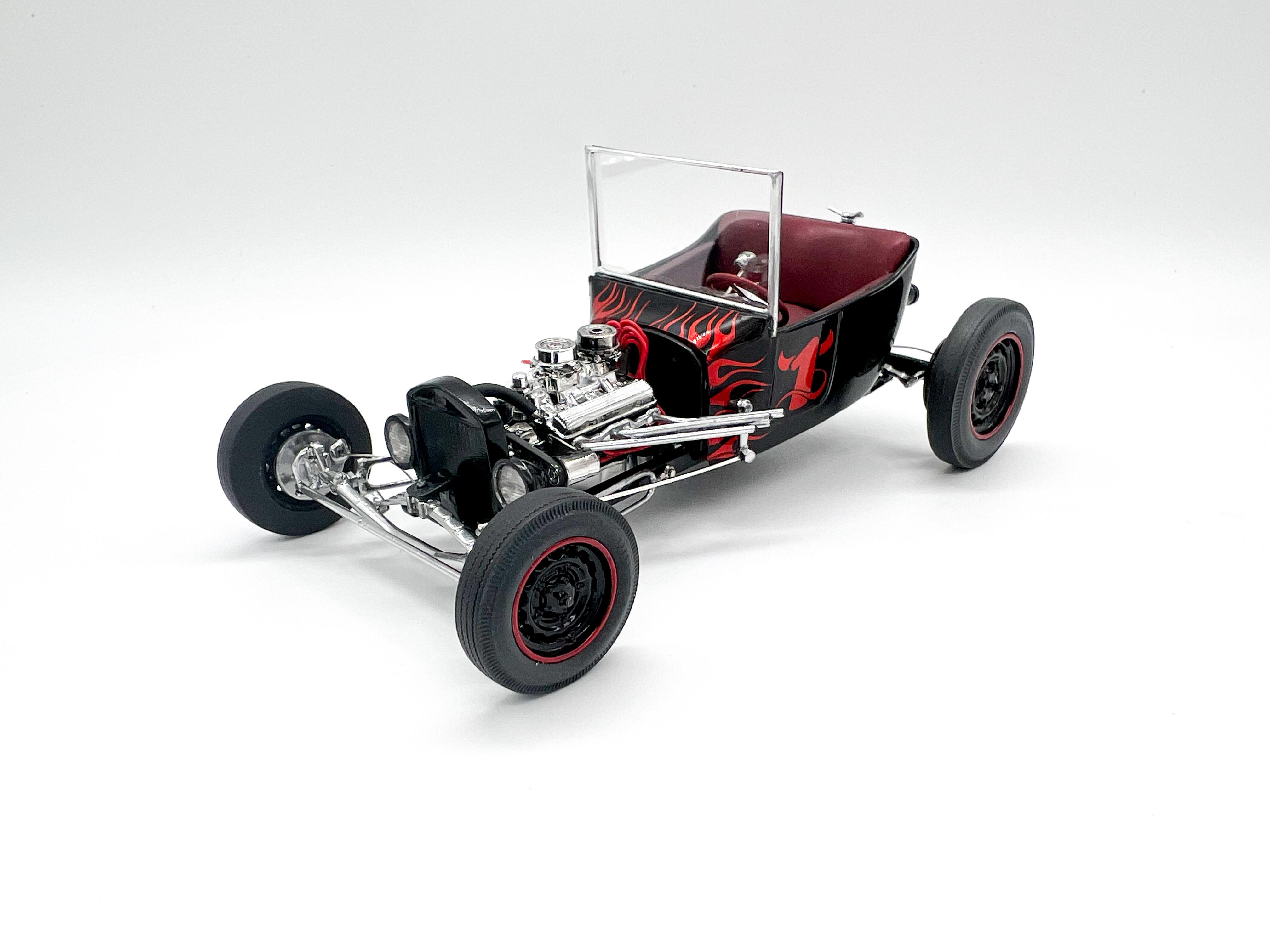

CabDriver Posted February 11 Share Posted February 11 Edit, found a couple of examples….all the chrome on this project is done with the Molotow: Plus some wheels I shot on the last project I built: I know everyone here has their preference, and I actually like using Alclad / Spazstix too, but just demonstrating that Molotow and its copycat variations have their uses too… 3 1 Quote Link to comment Share on other sites More sharing options...

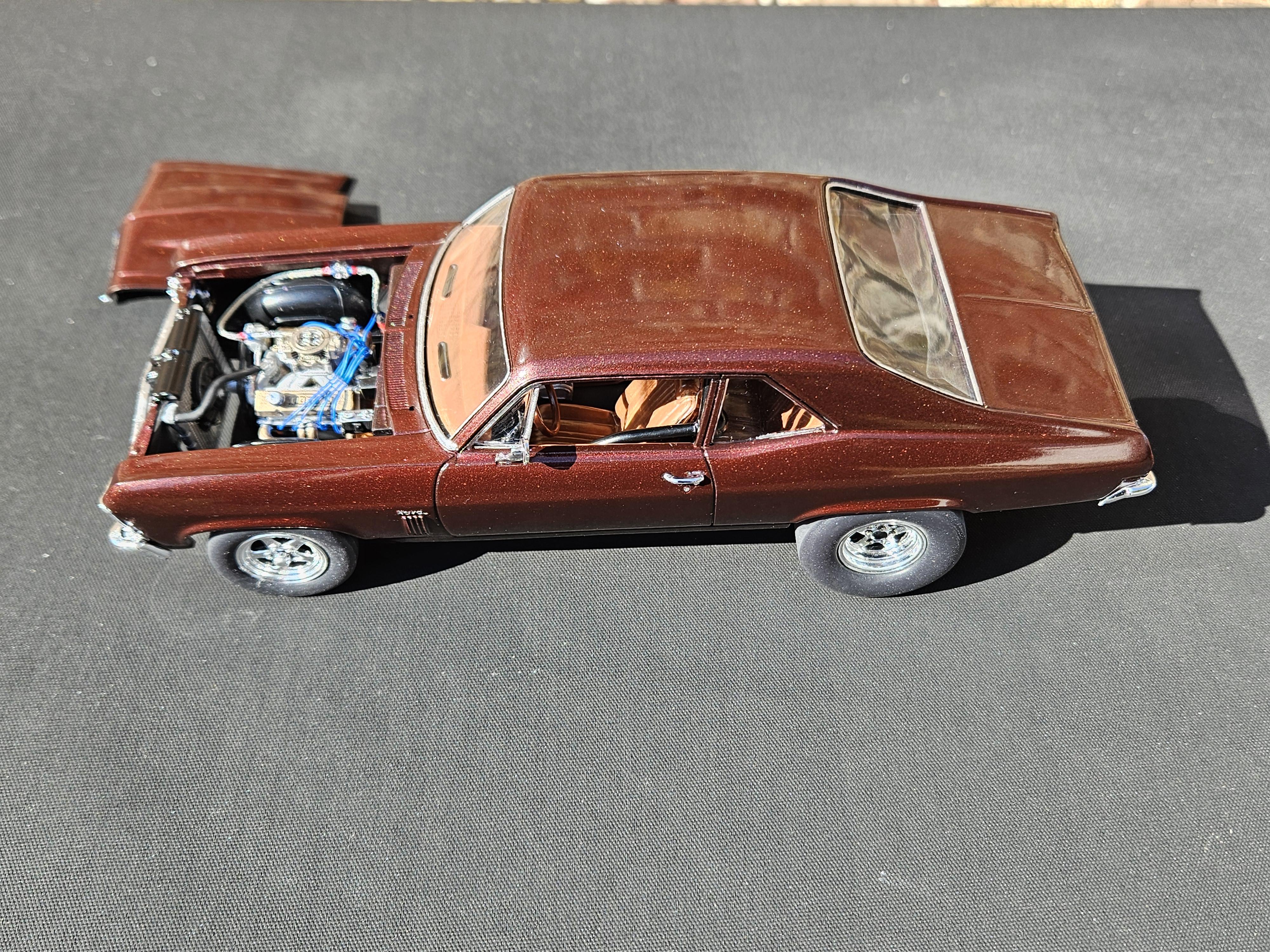

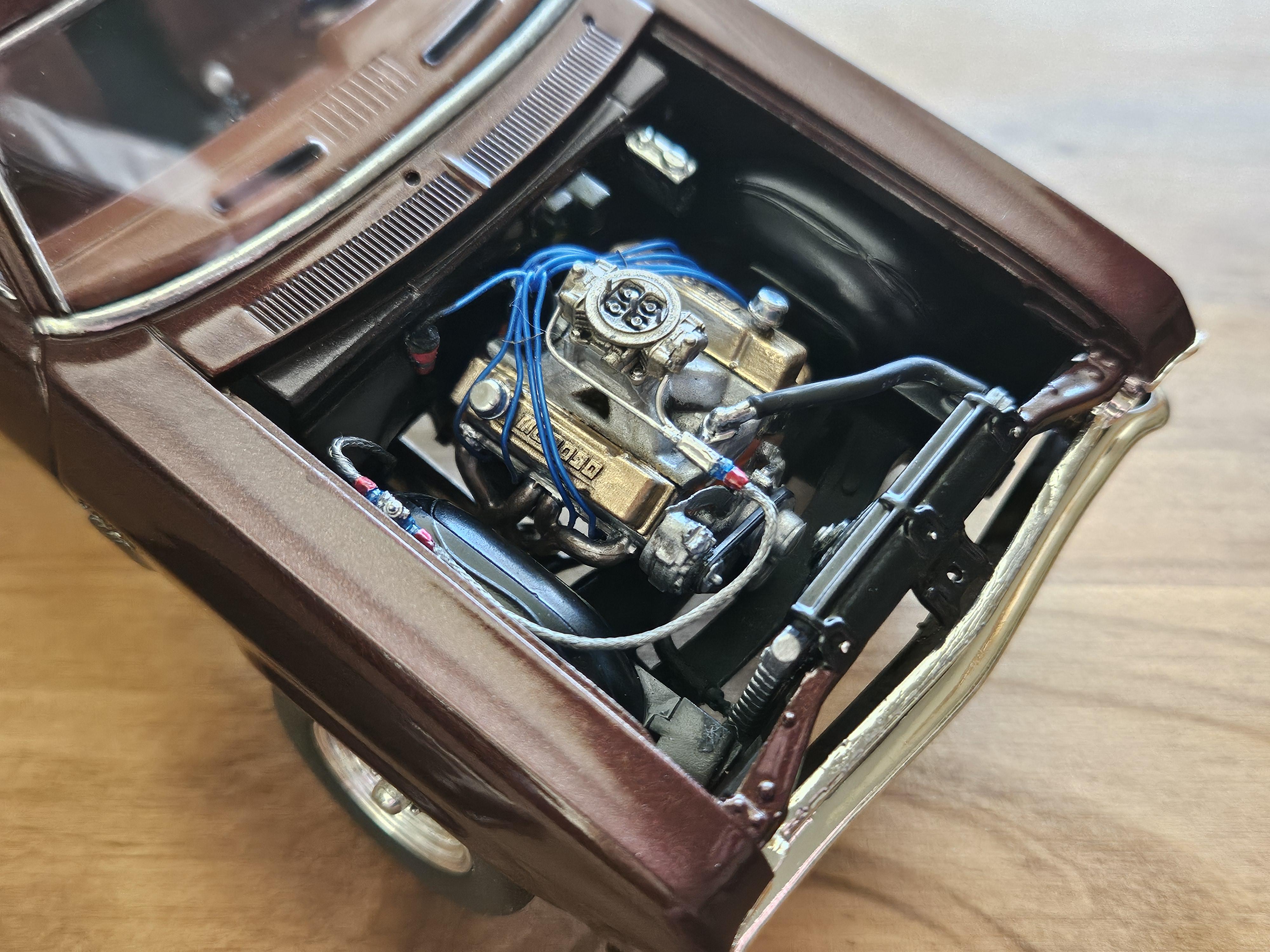

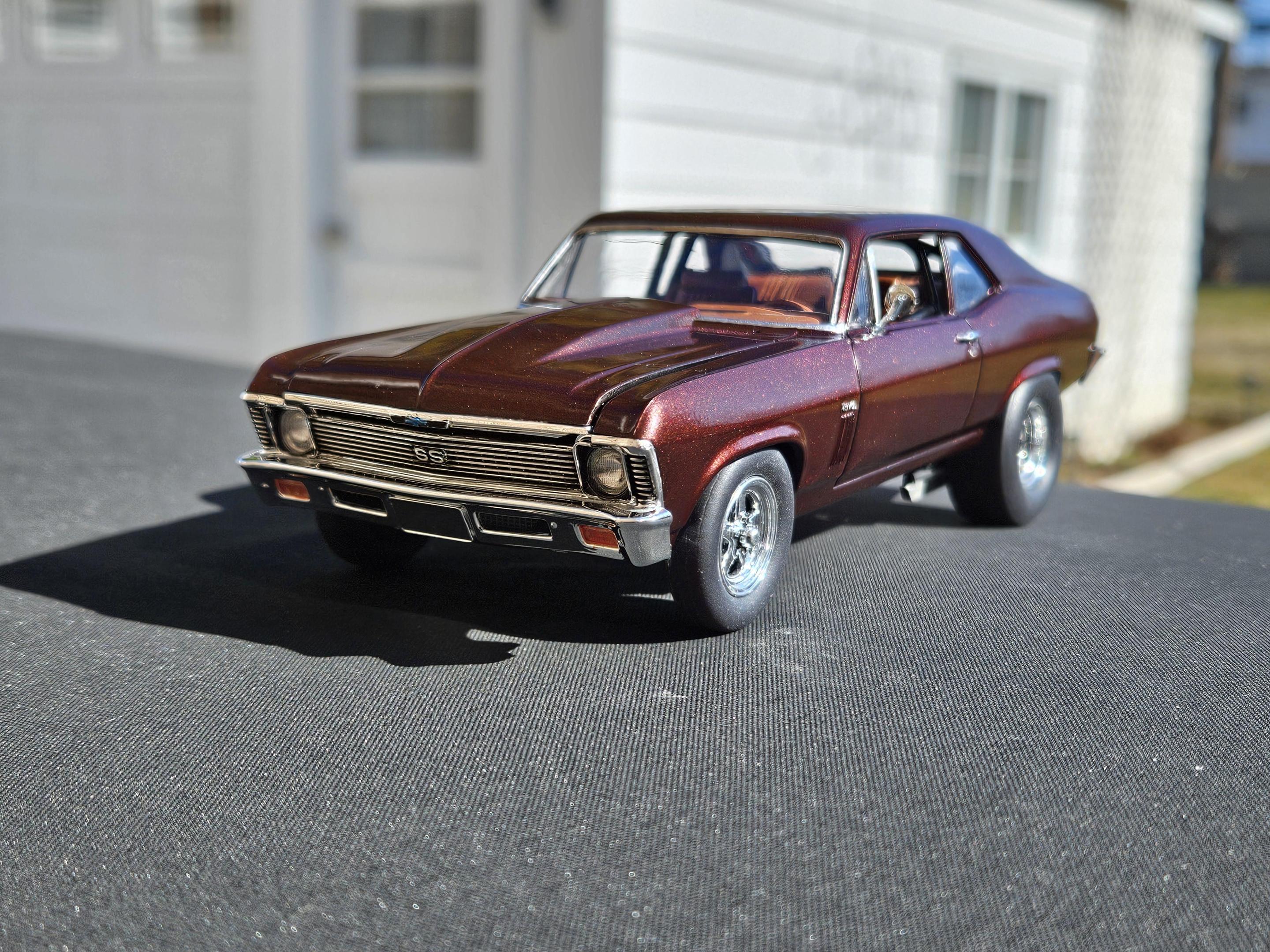

keviiin86 Posted March 12 Share Posted March 12 (edited) Coming from using testors silver paint with a fine brush for all of my chrome trim and mouldings when I was younger to discovering a pen which applies with ease and arguably dries faster and can be handled (carefully) without smudging, I'd say molotow and it's variants can produce a pretty good result. I never liked bare metal foil and thought it was a PITA, so for me a chrome pen does just fine. Did the chrome trim around the windows of my nova as well as some other random parts, (fuel line from carb, thermostat housing, valve cover breathers, master cylinder cover etc). Edited March 12 by keviiin86 Quote Link to comment Share on other sites More sharing options...

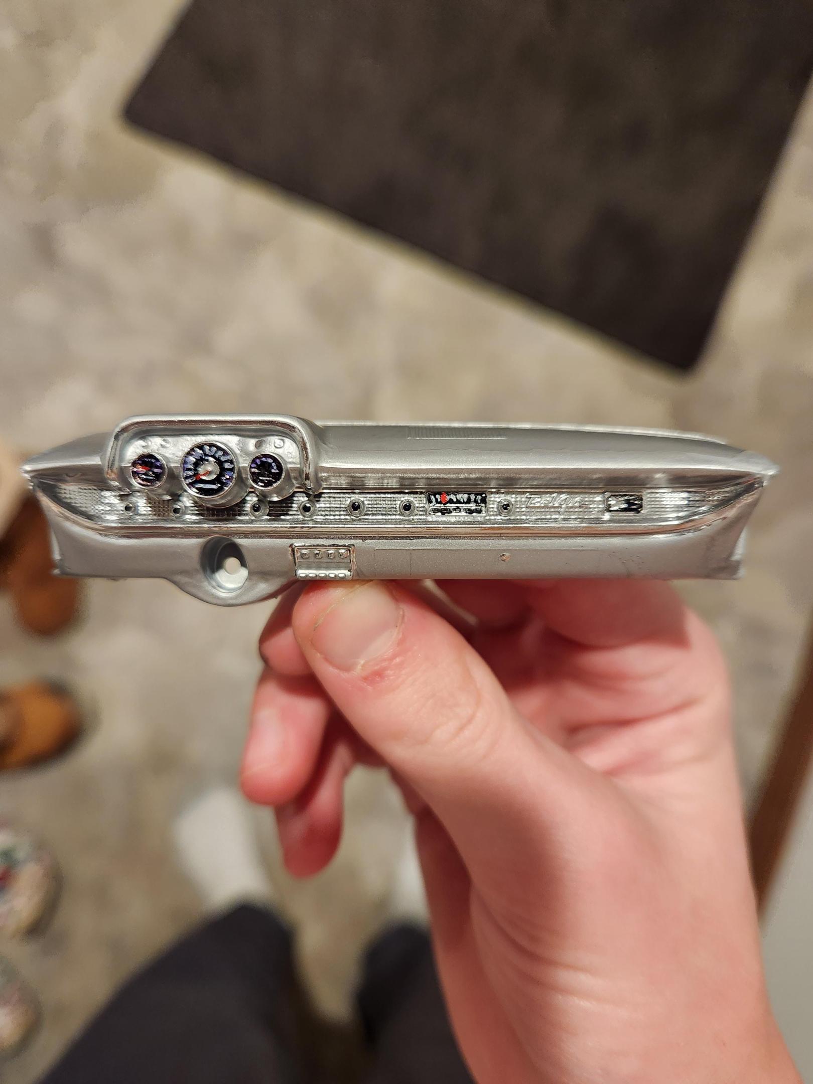

FoMoCo66 Posted March 15 Share Posted March 15 Man I just saw this thread. I almost thought when this happened $10 down the drain. I still haven't gone in and cleaned the thing. But I agree it gave great results on the first couple of days, then... This was what I did with it on the first day it was cracked open. This is the 1/16 amt 57 chevy convertible. The best dash I've ever done with no decals. Quote Link to comment Share on other sites More sharing options...

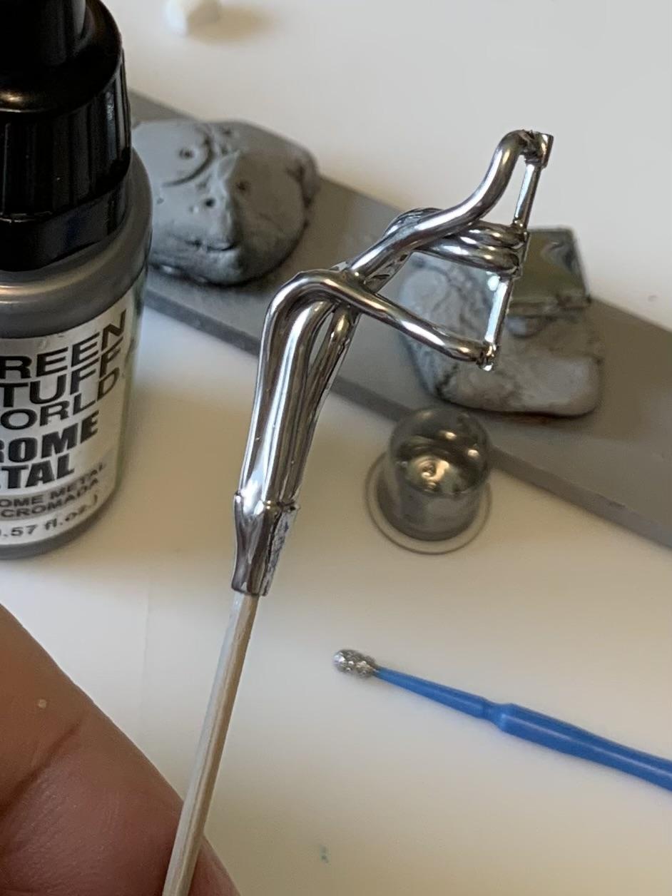

R. Thorne Posted March 15 Share Posted March 15 6 hours ago, Bugatti Fan said: My Molotow pen tip dried out and got really messy when I tried to clean it out. Saw a video on Green Stuff Hobby's website. They have an airbrushing chrome and one that was being applied by brush. They were using a figure for a demo and just dabbing the brush chrome onto it with fantastic results as far as I could see. Has anyone reading this used the Green Stuff chromes and can comment on them? I like the Green Stuff World non airbrush style daubed on with a micro brush. Wheels on the left are GSW and wheels on the right are model kit chrome. Quote Link to comment Share on other sites More sharing options...
