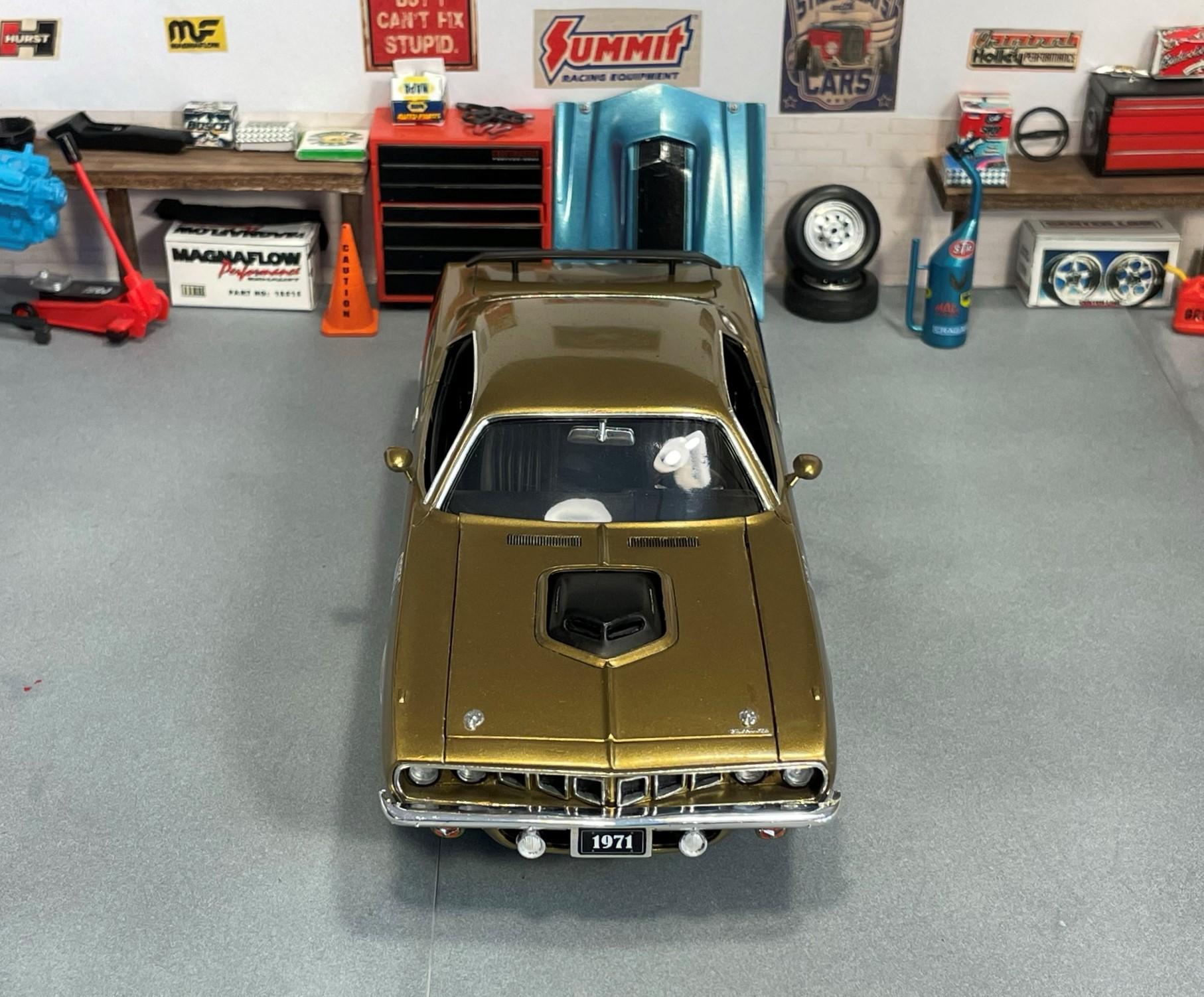

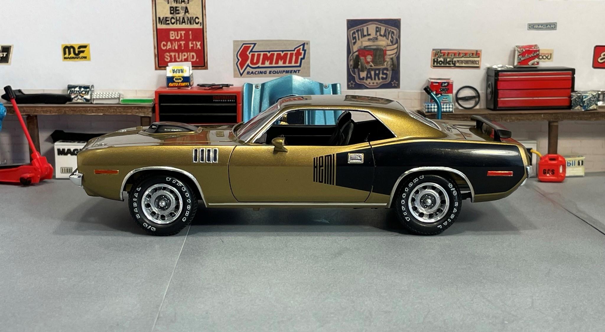

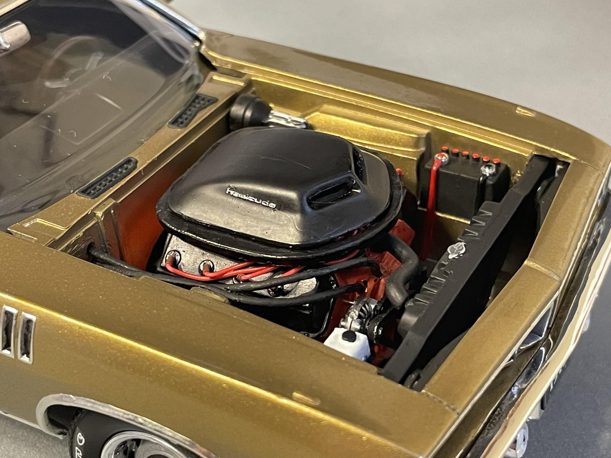

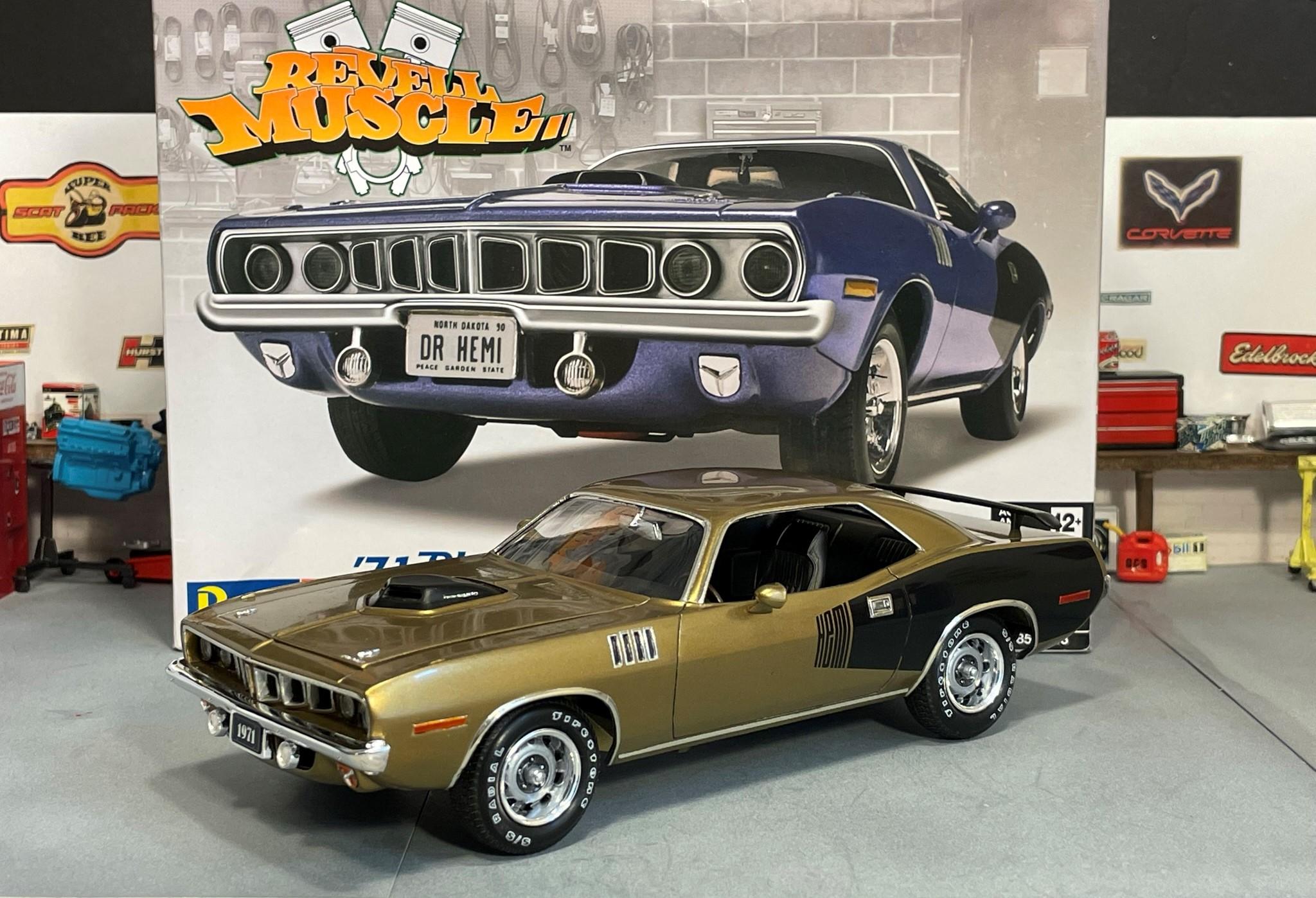

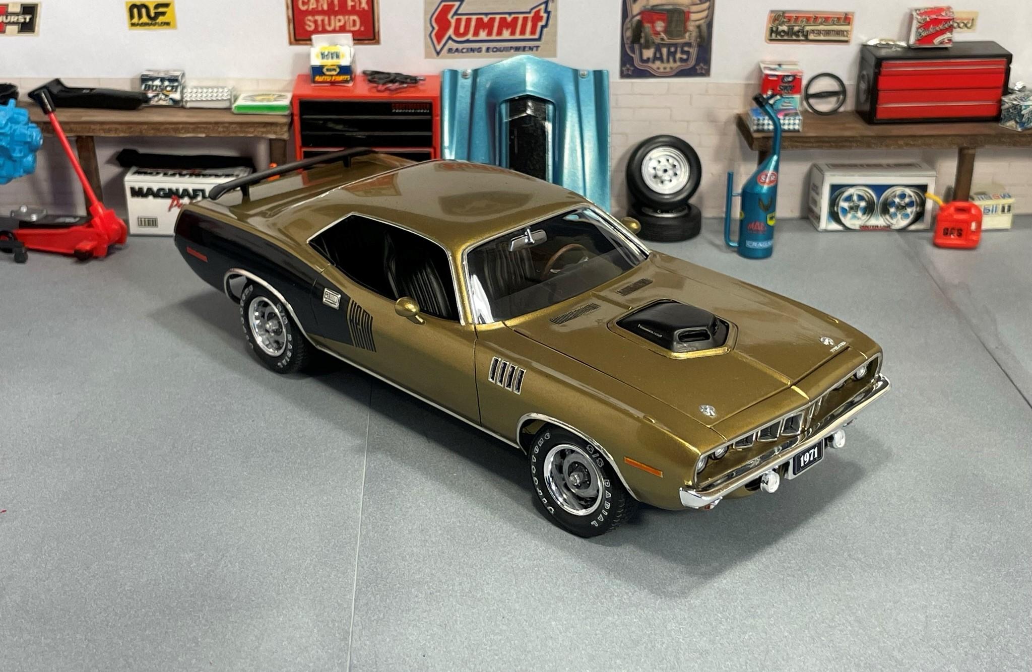

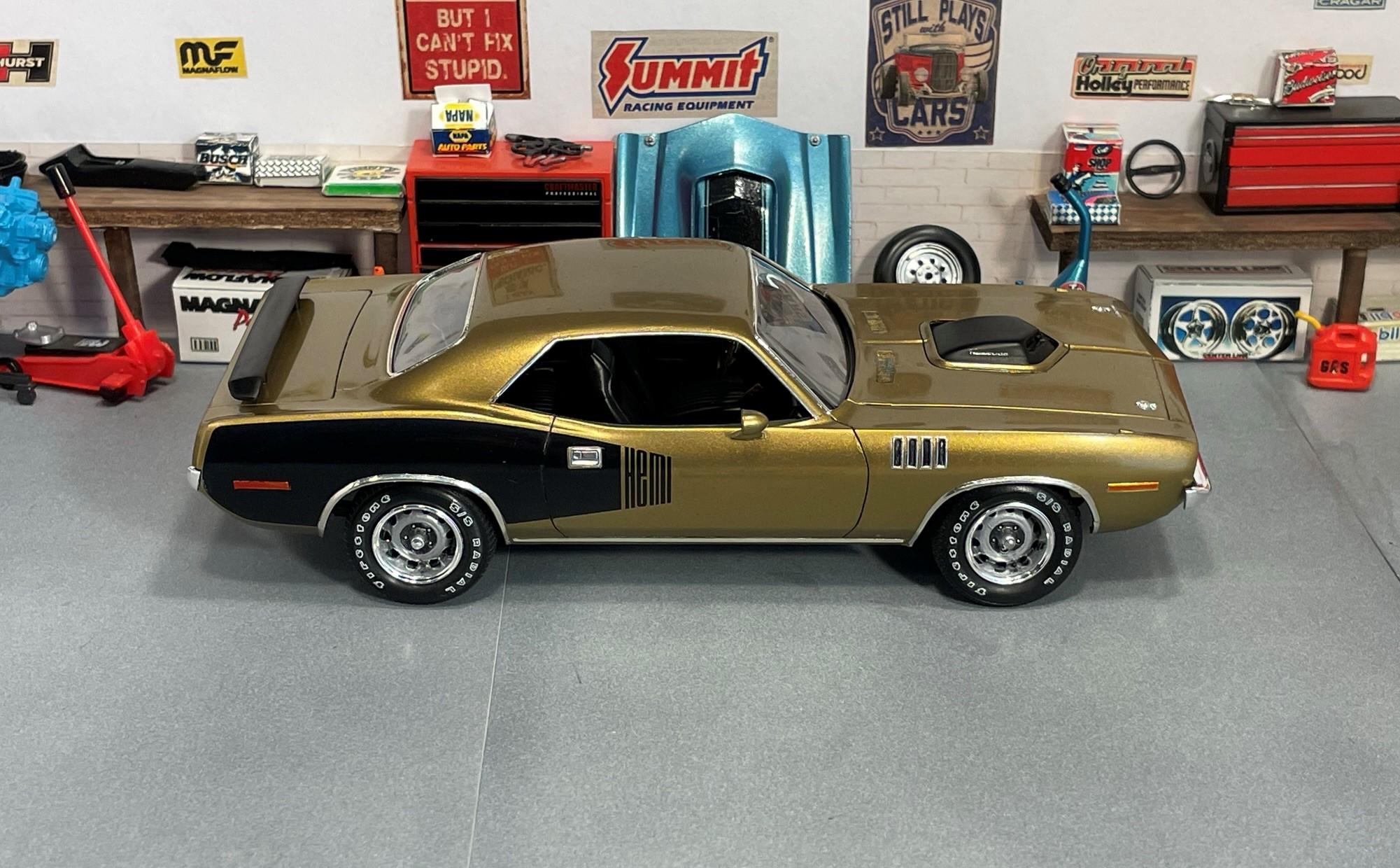

Dragonhawk1066 Posted January 17, 2023 Posted January 17, 2023 Here's my latest, Revell 1971 Plymouth Hemi Cuda. I tried some new things, at least for me. First I melded the front end to the fenders to eliminate the gap/line where they connect that isn't there on the real car, and scribed the true panel line on the front valance. I was very happy with that result. At the same time, I filled in the inner headlights and tried to re-drill them closer to the outside ones as they're molded too far apart. This proved to be a fail as I didn't center the final drill bit close enough and the distance ended up unchanged, and the surround ended up a little gouged albeit not very noticeable. I also made my first attempt at using embossing powder to simulate carpet that I feel turned out pretty good. The color is a custom mixed variation using Chroma Molten Metals Xanadu Gold, Dorado Gold, and Delta Ceramcoat Black to simulate Citron Gold, and I really like how it turned out. Createx 4050 UVLS Gloss was used for the clear and got the wet-sand, polish, and wax treatment. The trim was done in Bare Metal Foil. The interior was painted using flat black and semi-gloss black craft paint, with the fore-mentioned embossing powder for carpet. The tires were matte cleared before adding Fireball Modelworks White Letter decals, and painted copper wire was used to simulate valve stems. I added spark plug wires and heater hoses to the engine compartment for extra detail. Despite being a more basic low parts count kit with a few short-comings, it does go together quite well and pretty much looks the part. Thanks for looking!! 26

AMT68 Posted January 18, 2023 Posted January 18, 2023 That's a very sharp looking build and your foil work around the wheel openings look perfect. I continue to be impressed with the exterior colors you produce with the mix of acrylics.

Classicgas Posted January 18, 2023 Posted January 18, 2023 Beautiful. Kudos for taking the time to correct the front fender seam issue, usually ignored.

TransAmMike Posted January 18, 2023 Posted January 18, 2023 Wow Craig, that is one terrific looking build and what an unusual color...I likes it!! The finish with the Createx 4050 looks great. I have a bottle of it, tried a test of it and could'nt seem to get a gloss out of it. Maybe I should try again. Anyway, congrats a beautiful Cuda??

TransAmMike Posted January 18, 2023 Posted January 18, 2023 14 minutes ago, Dragonhawk1066 said: Thanks guys!! Thanks Tom, I just love mixing colors to try to get close to a factory color. Sometimes when mixing, I look at the stash and one just begs to be painted that color, it's a pretty cool feeling when that happens, lol. Thanks Lee. I didn't do it on my first build of this kit, but just had to on this one, lol. Thank you David, I usually try to point things out that might not normally catch one's eye as I like to be made aware when viewing others' builds. Thanks Trevor! Yes, I do often use my own custom mixed paints, but I think Tamiya makes a spray can color pretty close to this one, I believe it's TS-21 but I could be wrong. Thanks Mike! Best I can say is give it 4-5 days to fully cure then lightly wet-sand it starting at about 6000 grit to 12000 grit. More like a damp sand because the water could still soften the clear a bit even after 4-5 days if left pooled too long. Then a Novus #2 polish followed by a coat of wax. A lot of work, but well worth it. They have a new 4053 High Gloss that looks much glossier upon application, but I haven't bought any yet. Thanks Craig. I actually think I have a bottle of the 4053 also. Never tried it tho. 1
