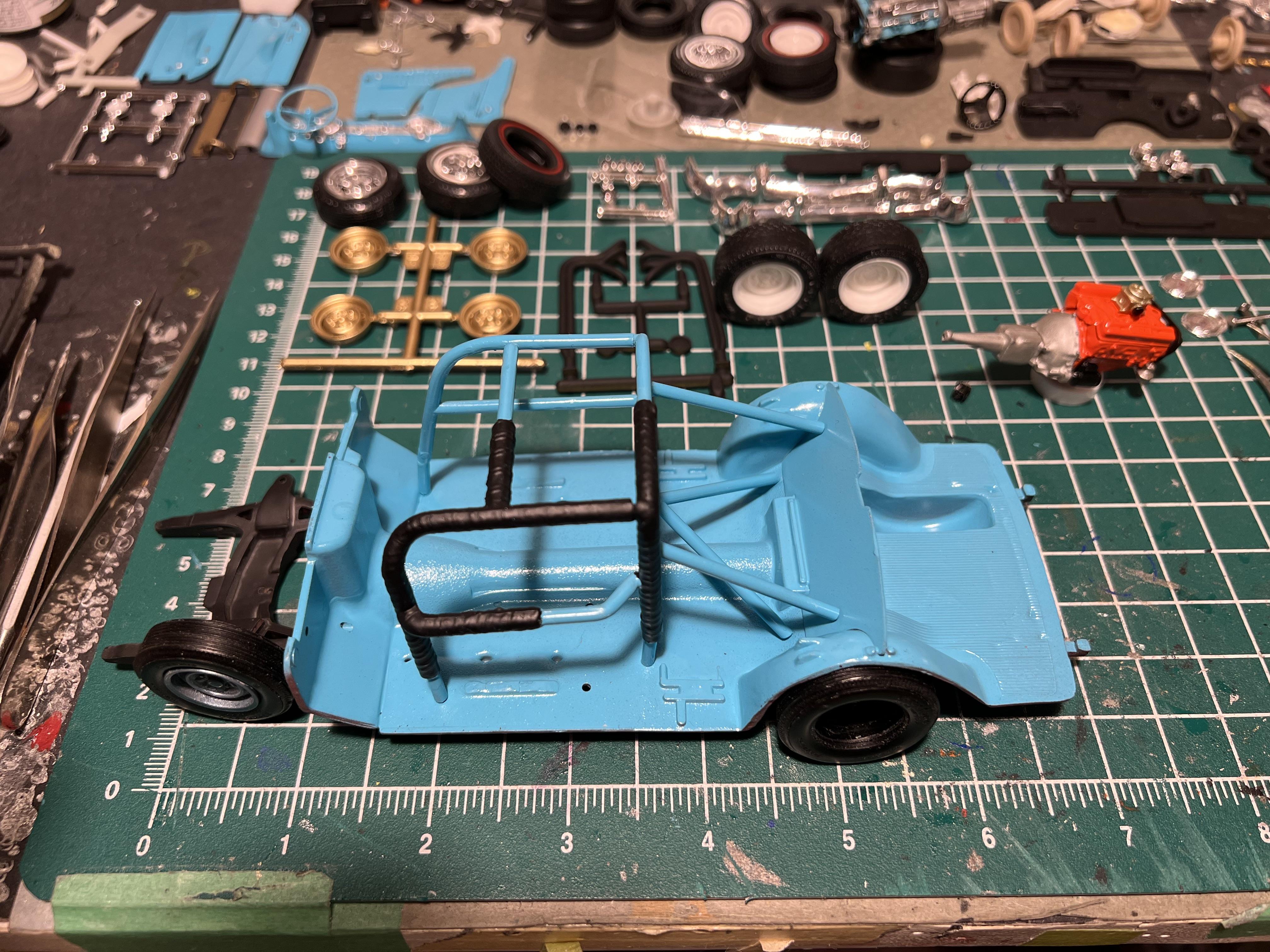

blizzy63 Posted February 5, 2023 Posted February 5, 2023 (edited) I’ve been using Dupli-color primers (grey, red, black) happily for years, except for in the last year or so the black primer sprays too watery and requires multiple coats. I’ve experimented recently with Rust-oleum 2X and some other non-hobby sprays for particular colors for interiors and racing car bodies that don’t require car show finishes. I get varying results depending on brand, color and luster. Below: Rust-oleum 2X Apple Red (gloss)... acceptable... Bottom: Rust-oleum 2X Seaside (satin) is glossier than I was hoping... Edited February 5, 2023 by blizzy63
