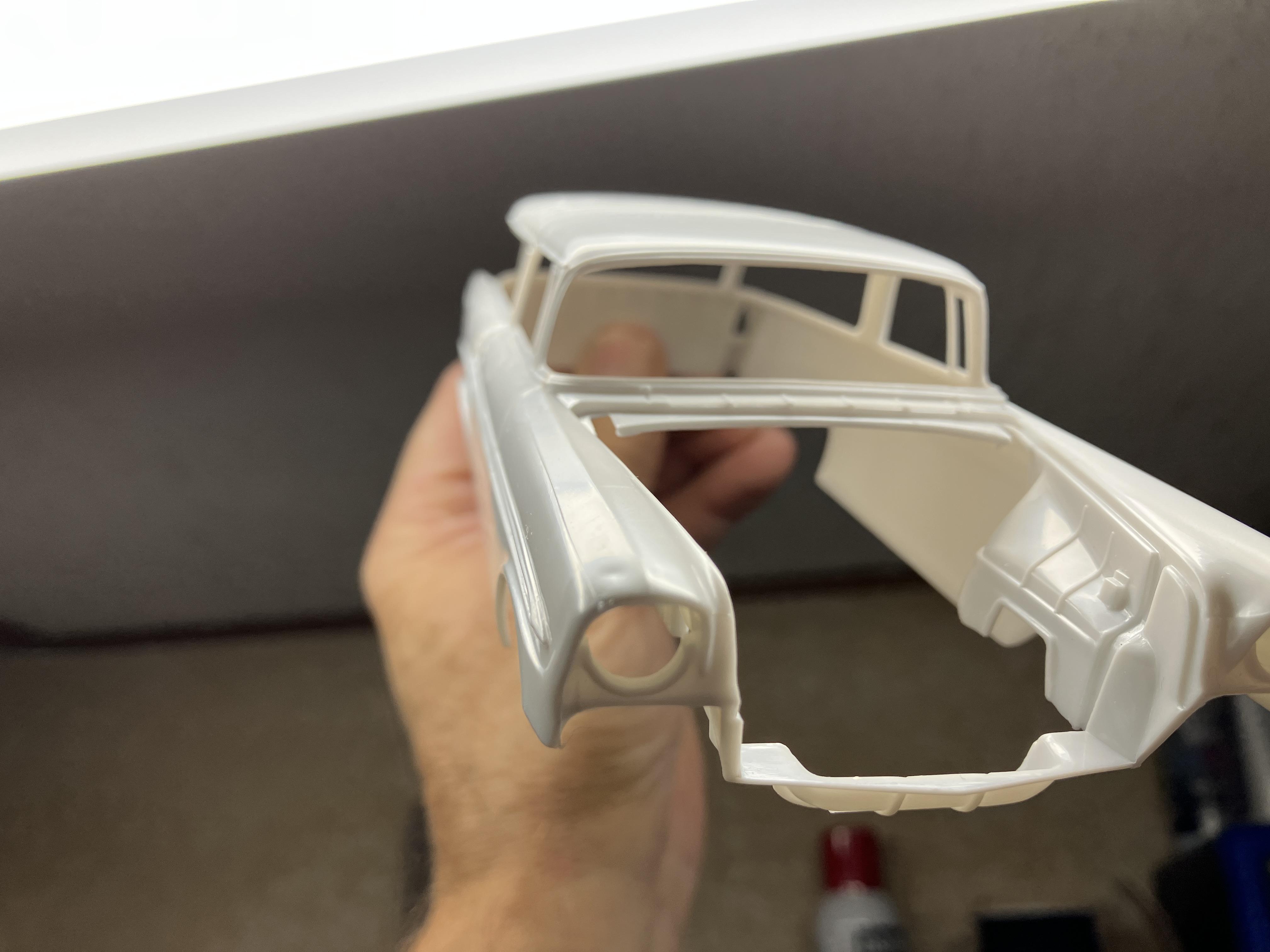

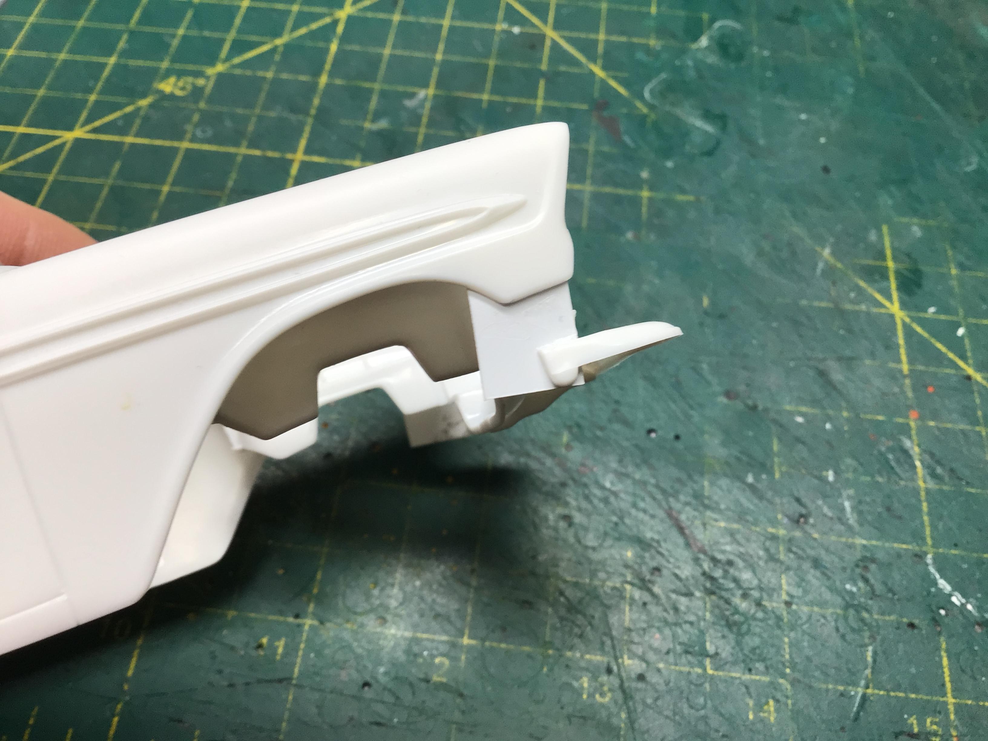

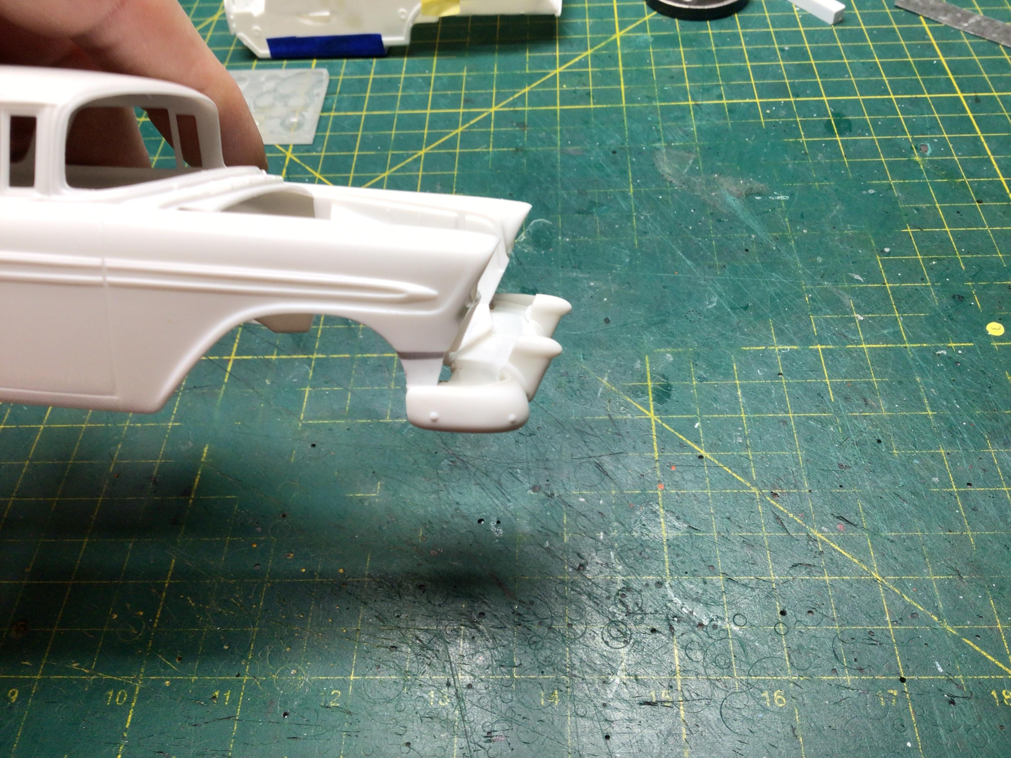

No, it’s a ‘56 Nomad.? I’ve been wanting to build one of these for a long time…so figured I’d get a start. It seems to be a nice kit.

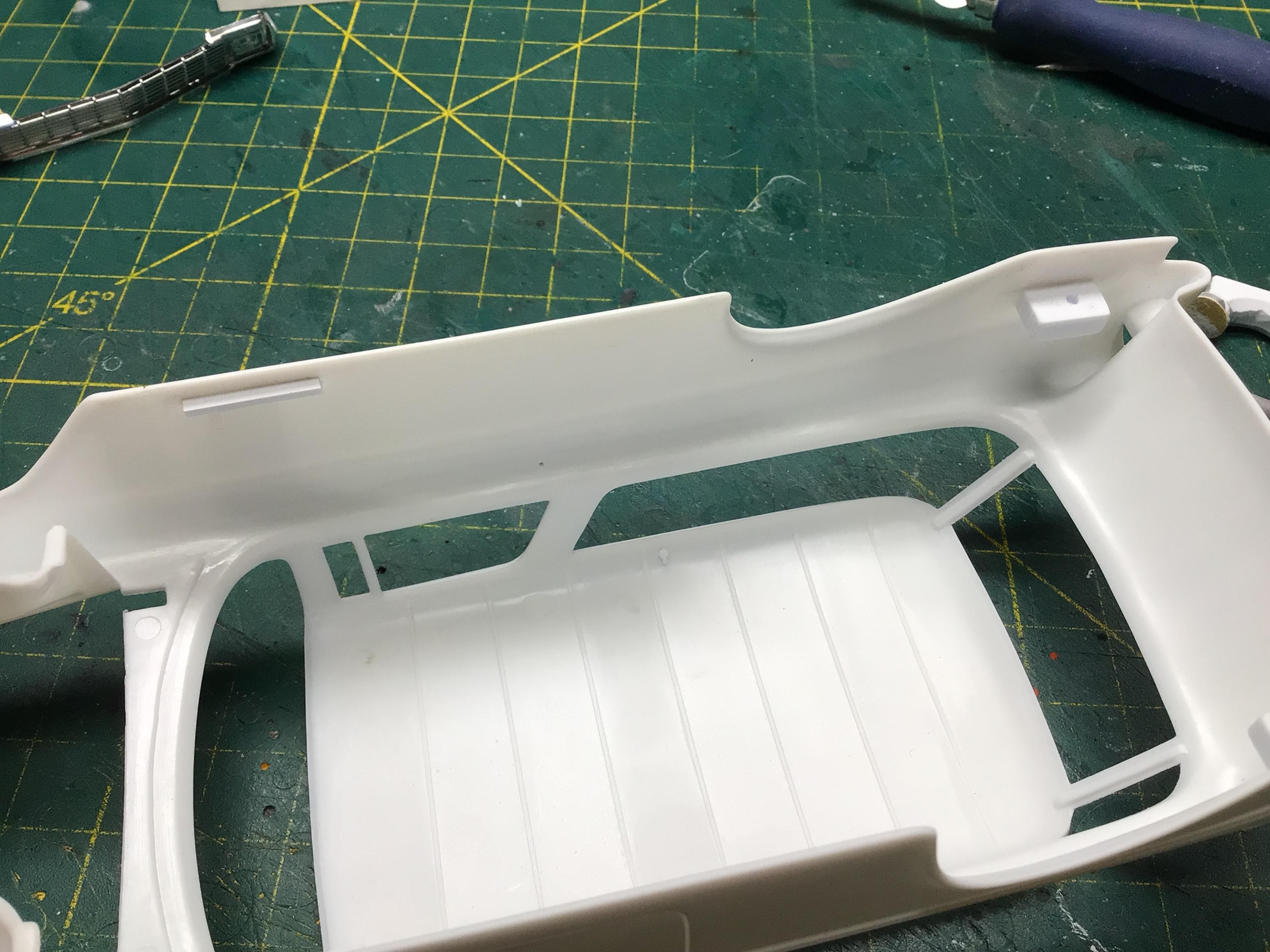

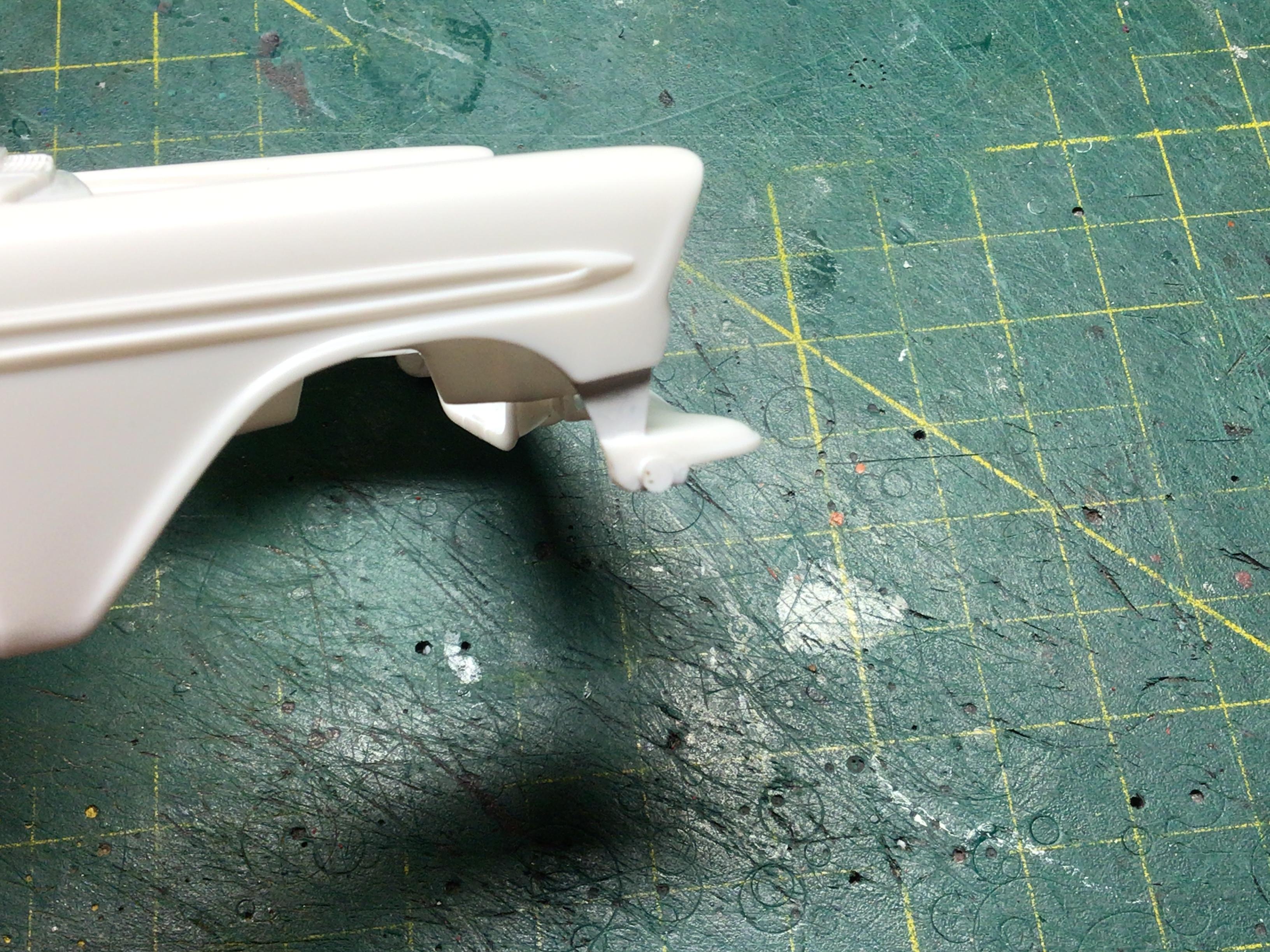

The body is nice, but has some mold seams on it as do all kits, and some peaks running down the tops of the fenders which don’t belong there. There are also a few small sink marks on the passenger front fender. Other than that she’s a beauty.?

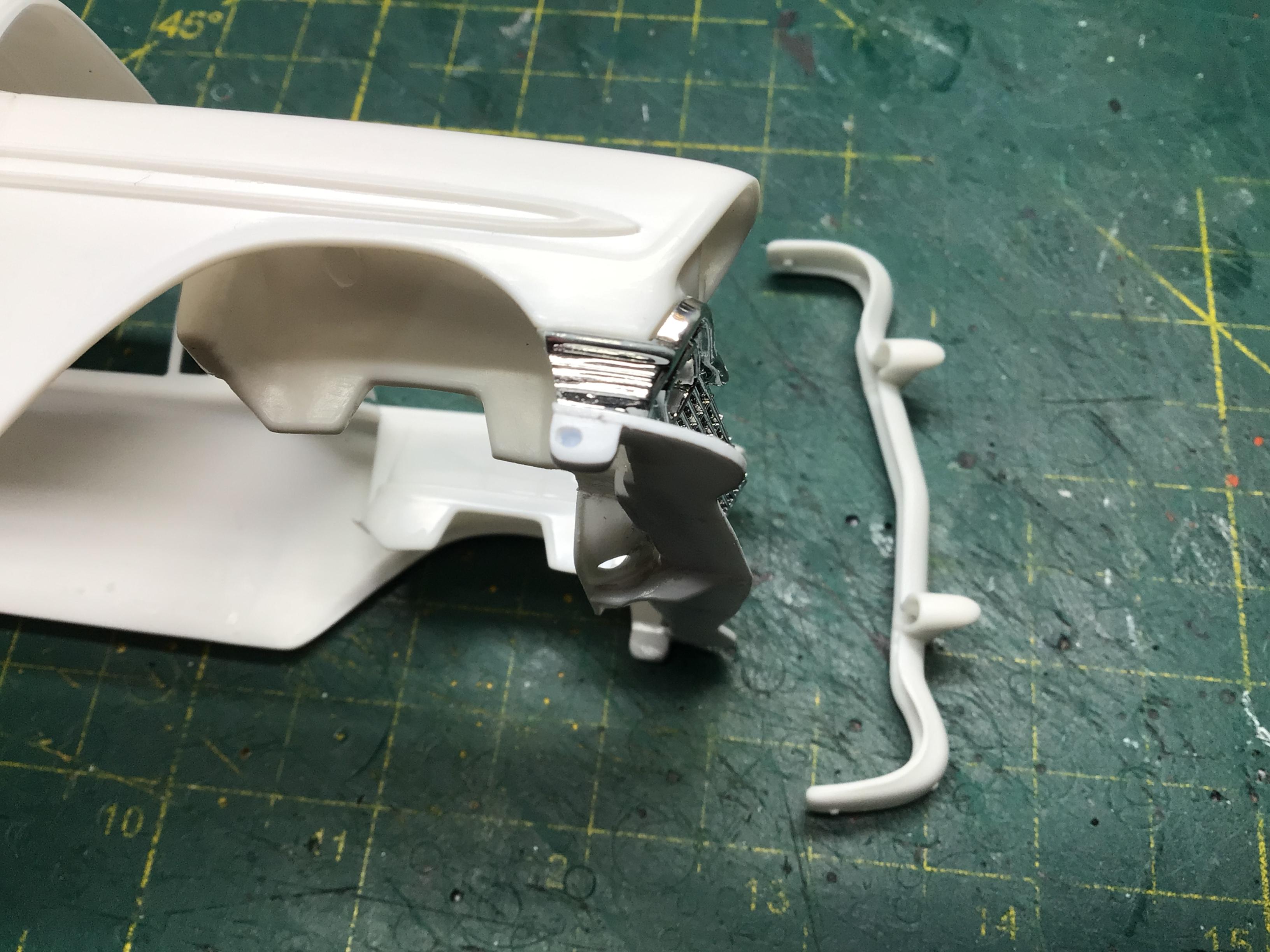

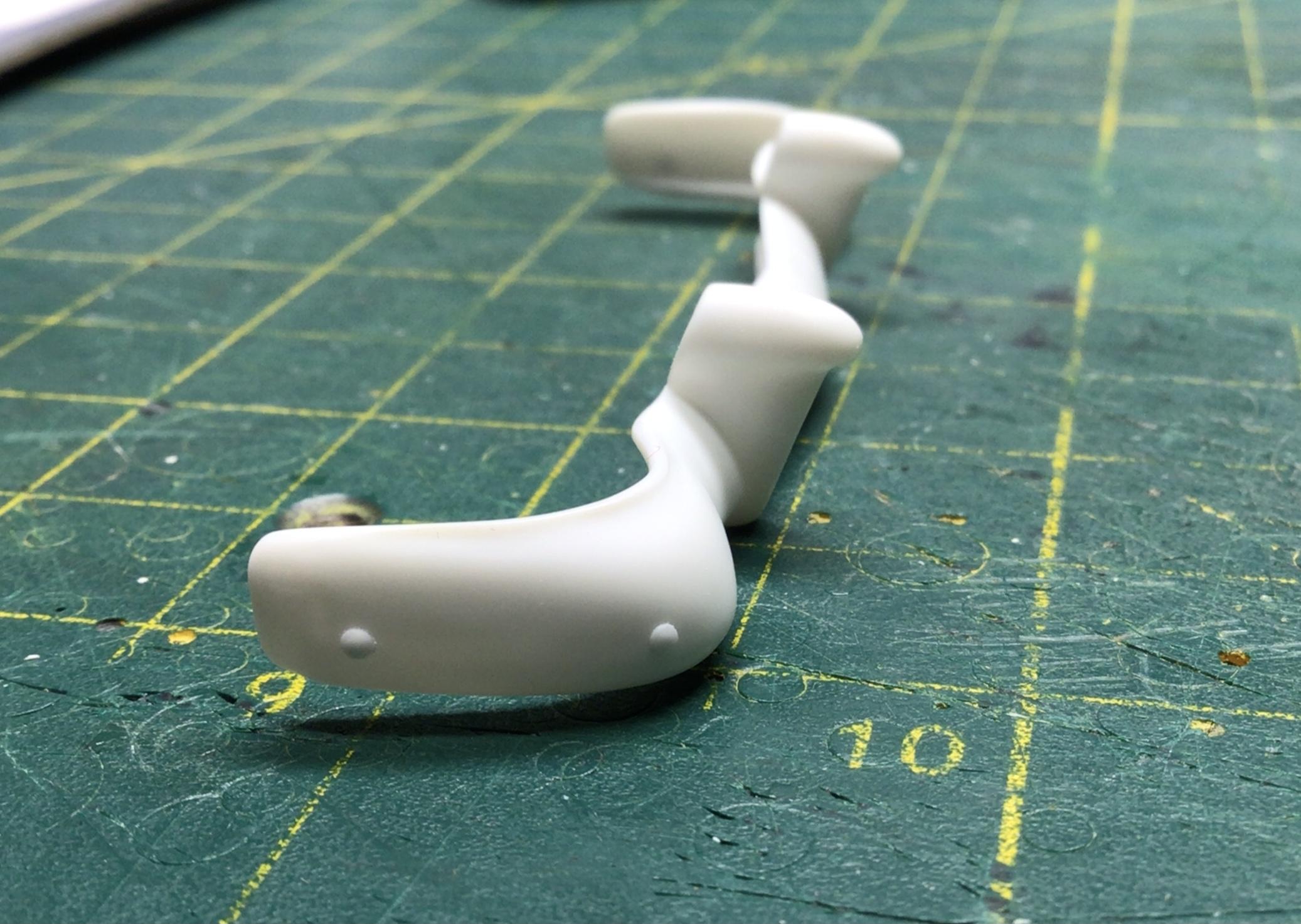

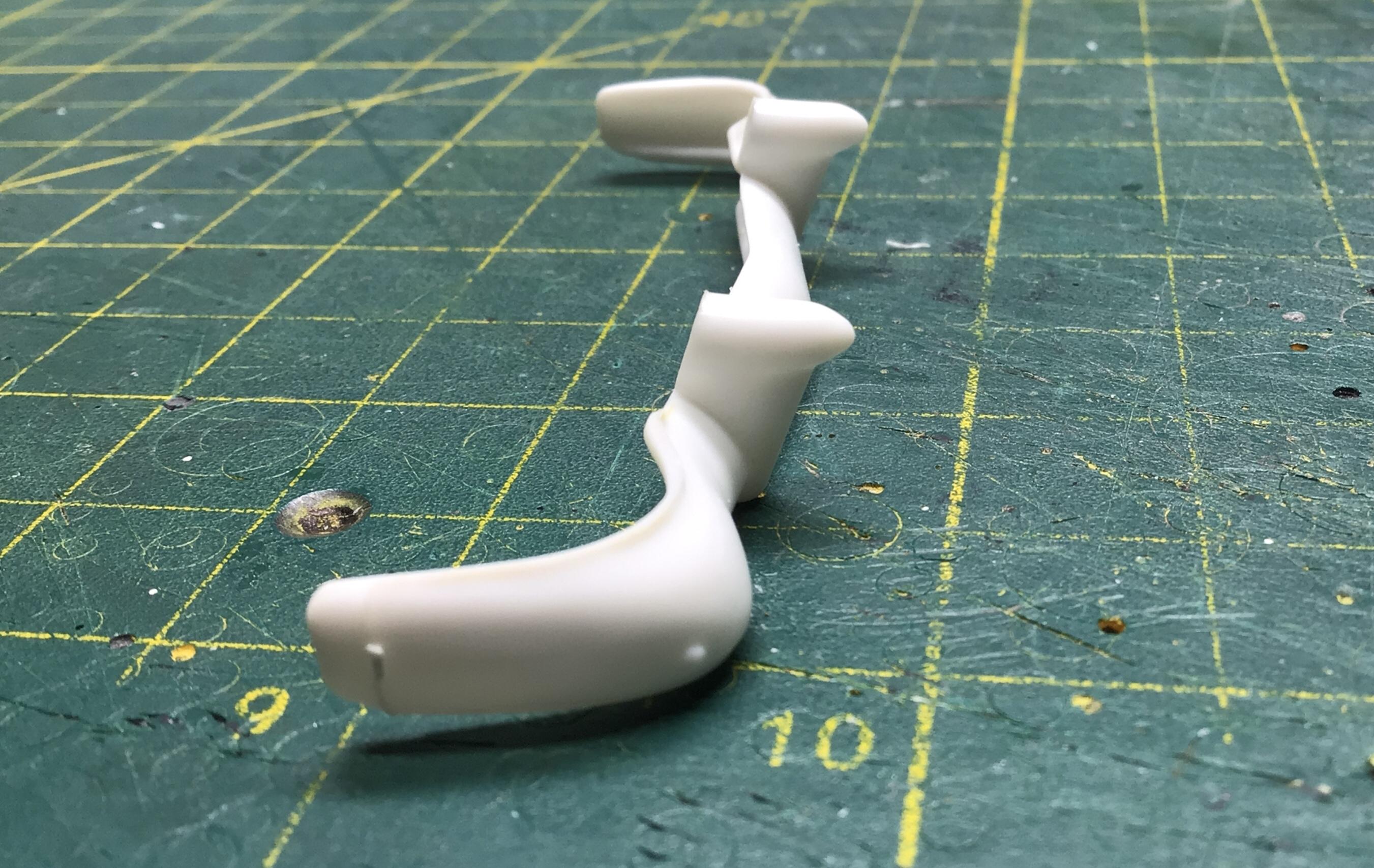

The front bumper on these kits have mold seams on the corners and a  sprue attachment point on one of them. So I stripped it and smoothed it and added the missing bolts using .040” evergreen rod. I drilled out and replaced the originals also so they would all match. The bumperettes seemed a bit wonky looking, so I sanded them down a bit too. I will spray this and some other bits with Revell chrome.

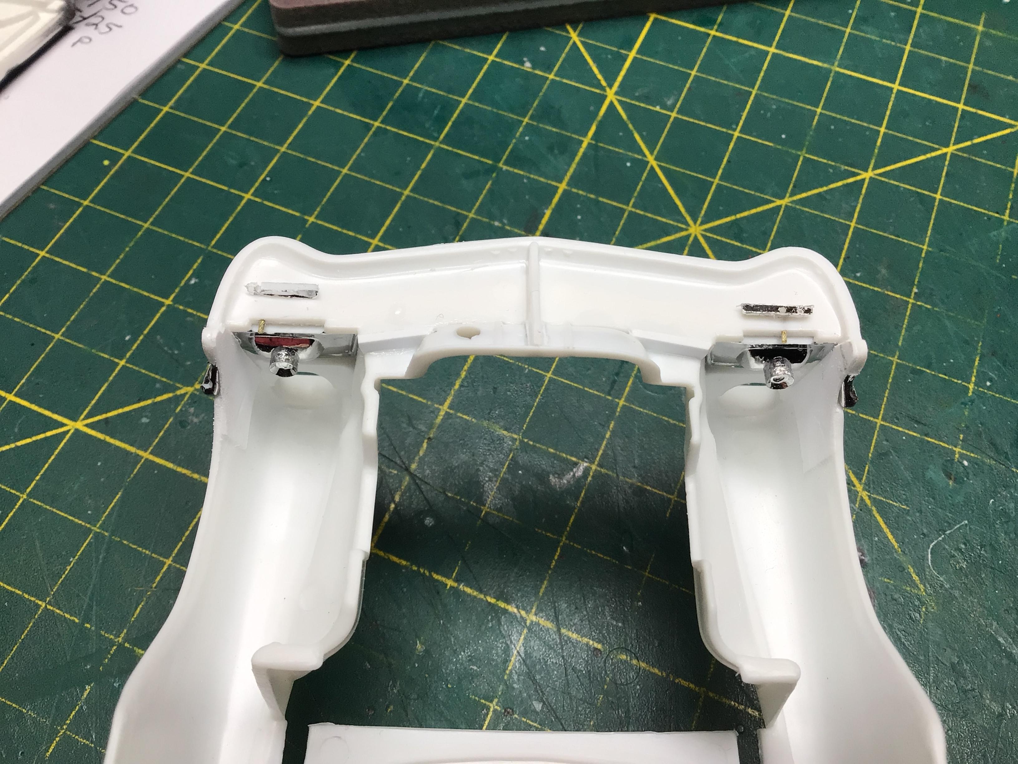

The chassis sits pretty secure in the body, but will slide back and forth a touch, so I added blocks and pegged it so it doesn’t cause any grief later.?

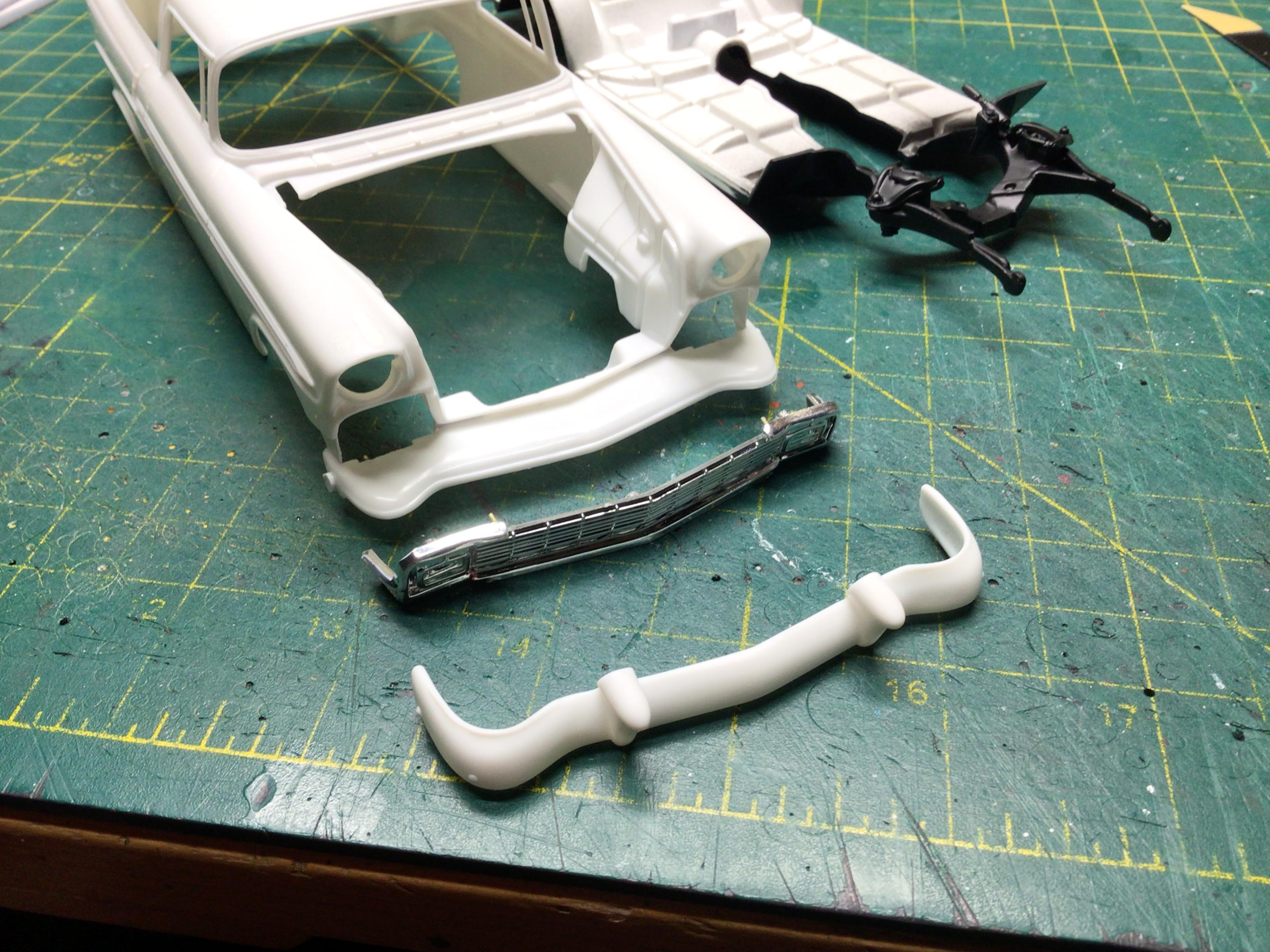

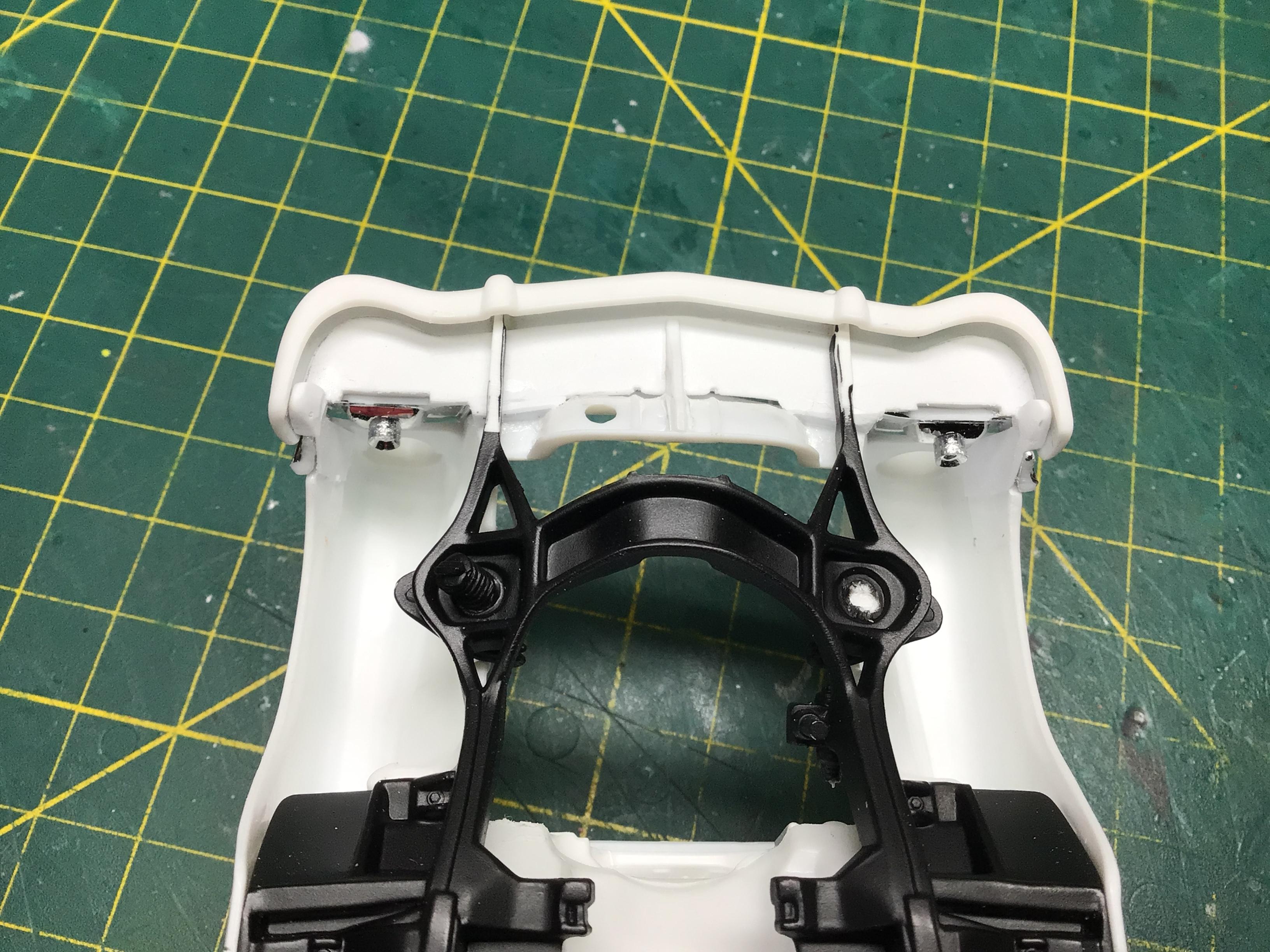

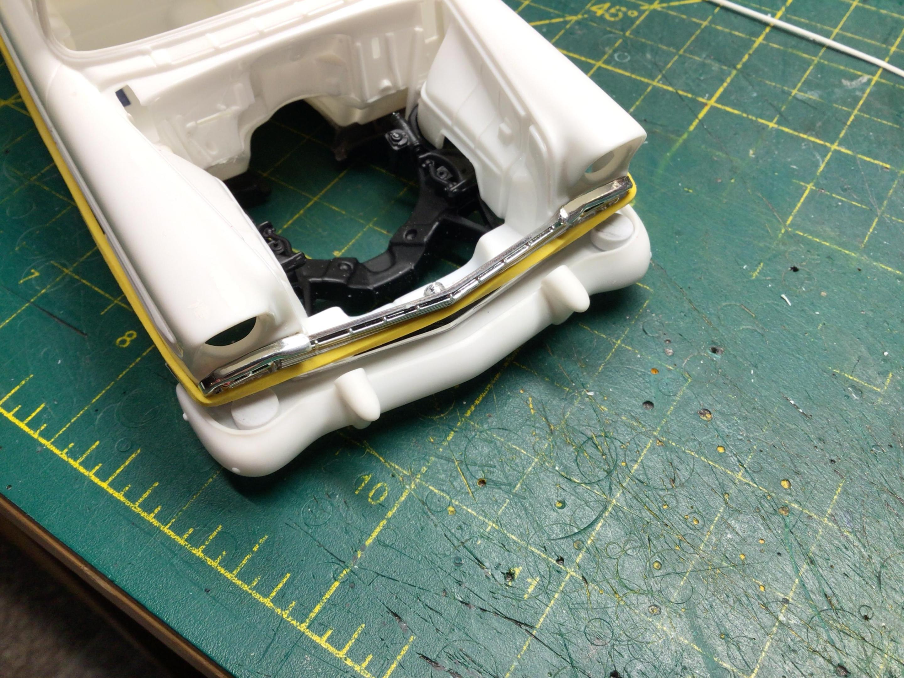

The thing that bothers me with this kit is the precarious mounting of the front bumper and valence. I pinned the grill in place and then used styrene bits to glue the valence in place solidly. Then I cut the lower tabs off the grill so it could be removed again. I added a couple of .063” spacer blocks inside the bumper and a couple of .030” discs to the outer corners of the valence. Now the bumper is a nice friction fit and stays in place even without glue.
EDIT: I did away with the blocks and discs because they didn’t work after I shortened the valence.?
Now I can paint the body and valence as a unit. Thats it for now. As always, all comments welcome.?

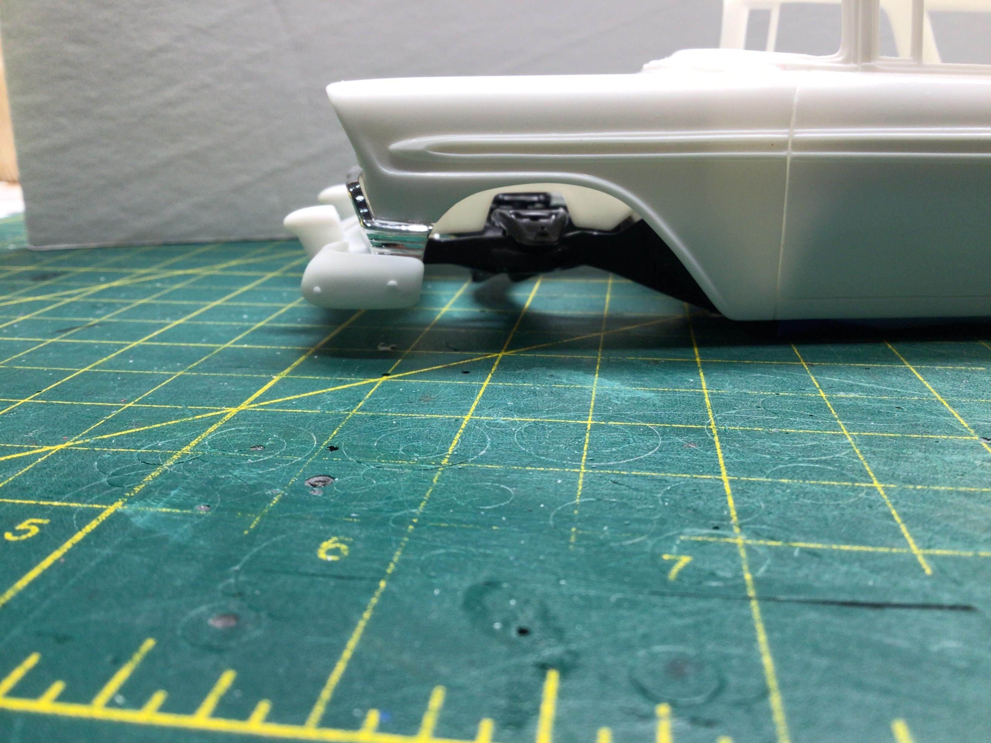

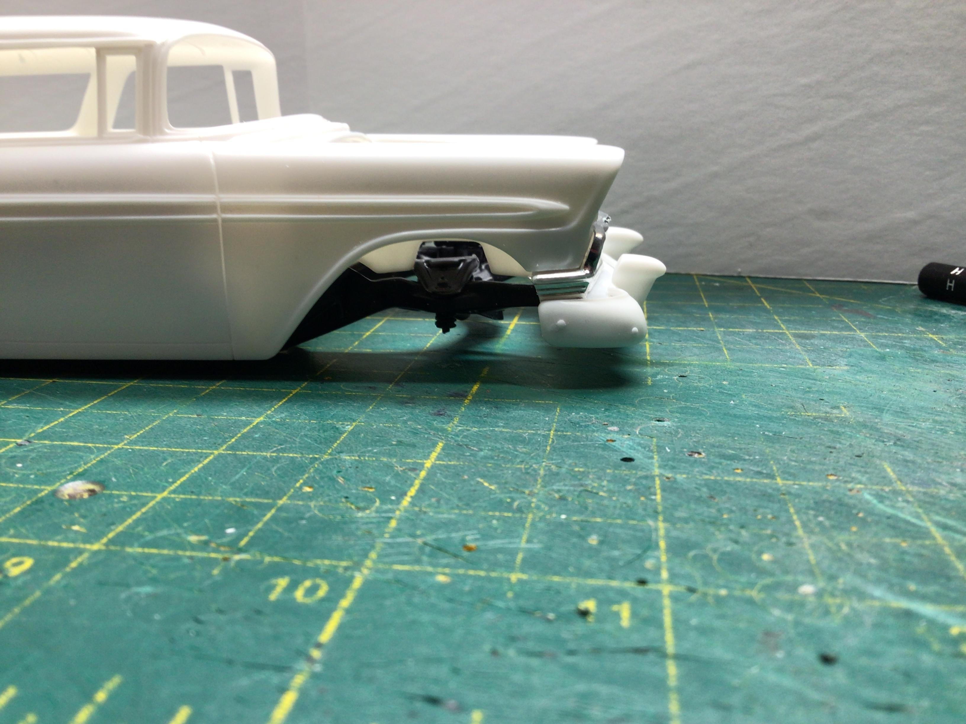

I think that front bumper sticks out too far, now's the time to trim the valance back if you wish. Since you've already removed the chrome, you can remove some of the bumper sides too where it intrudes the wheel opening, AFTER you shorten the valance!

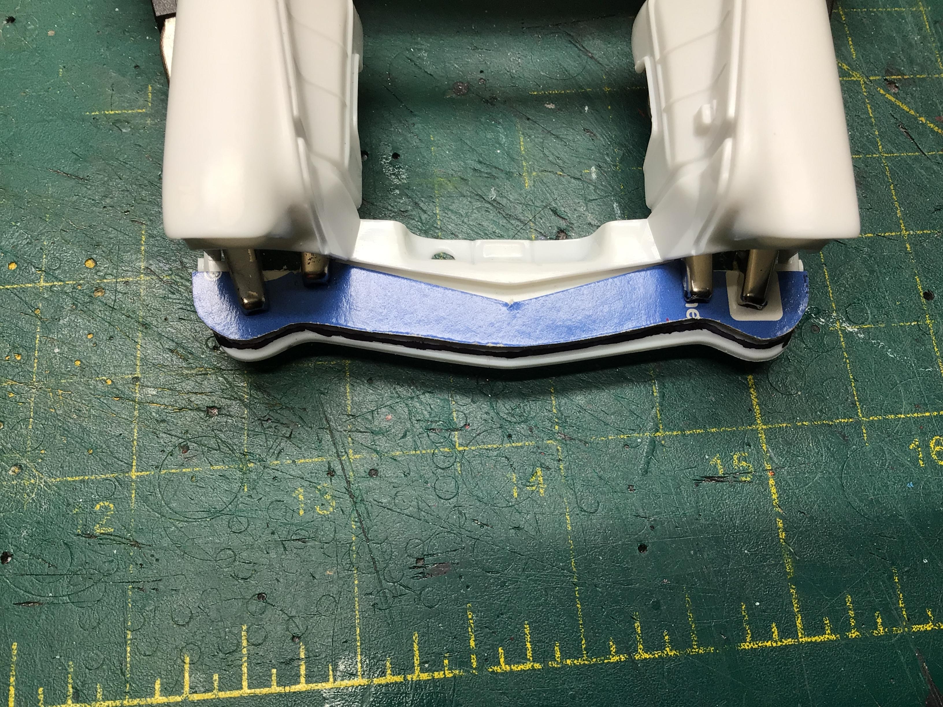

Thanks for reminding me Dennis!? Here it is next to the one from the newer Del Ray kit. At least I have a pattern for the trimming.

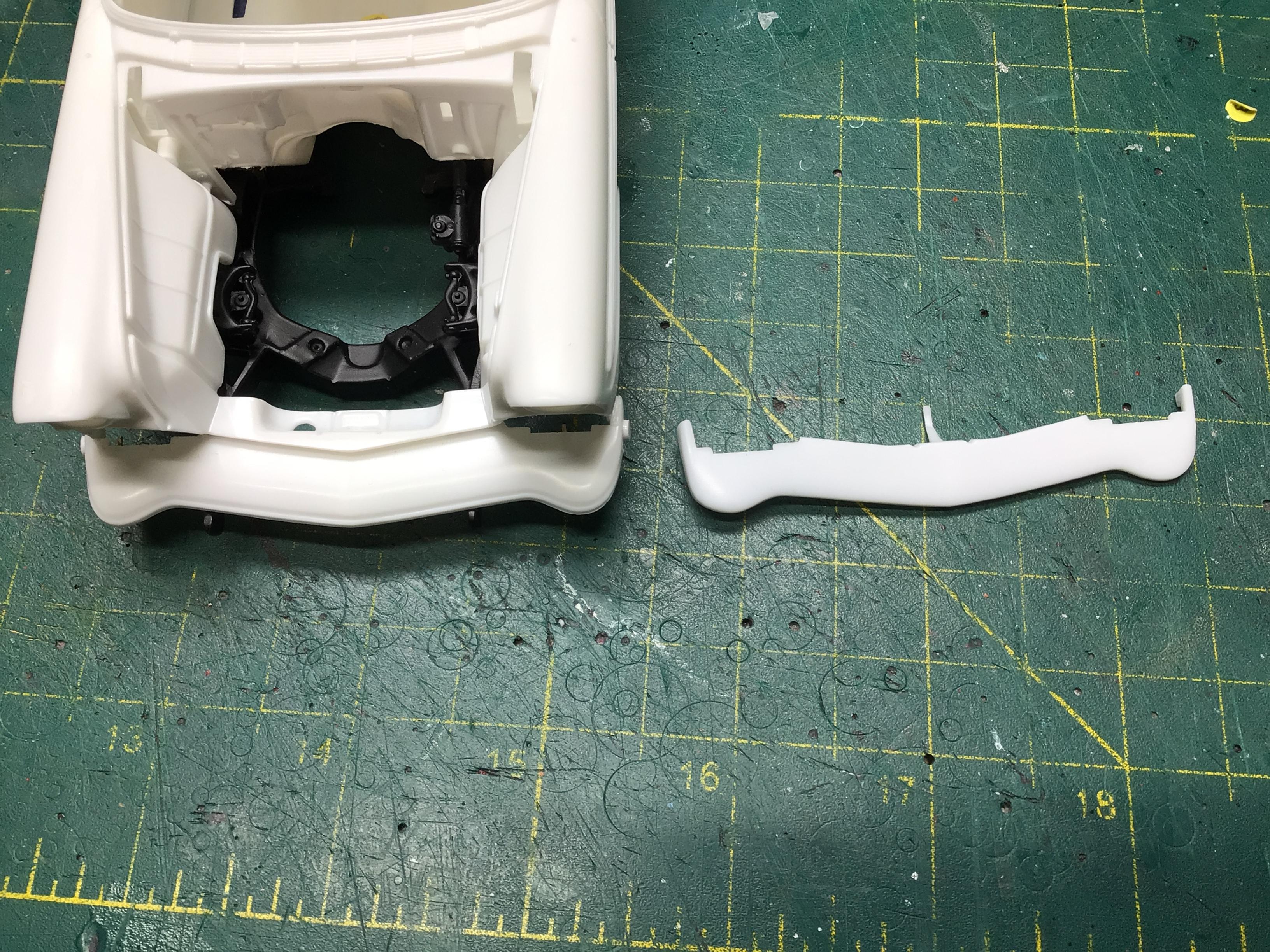

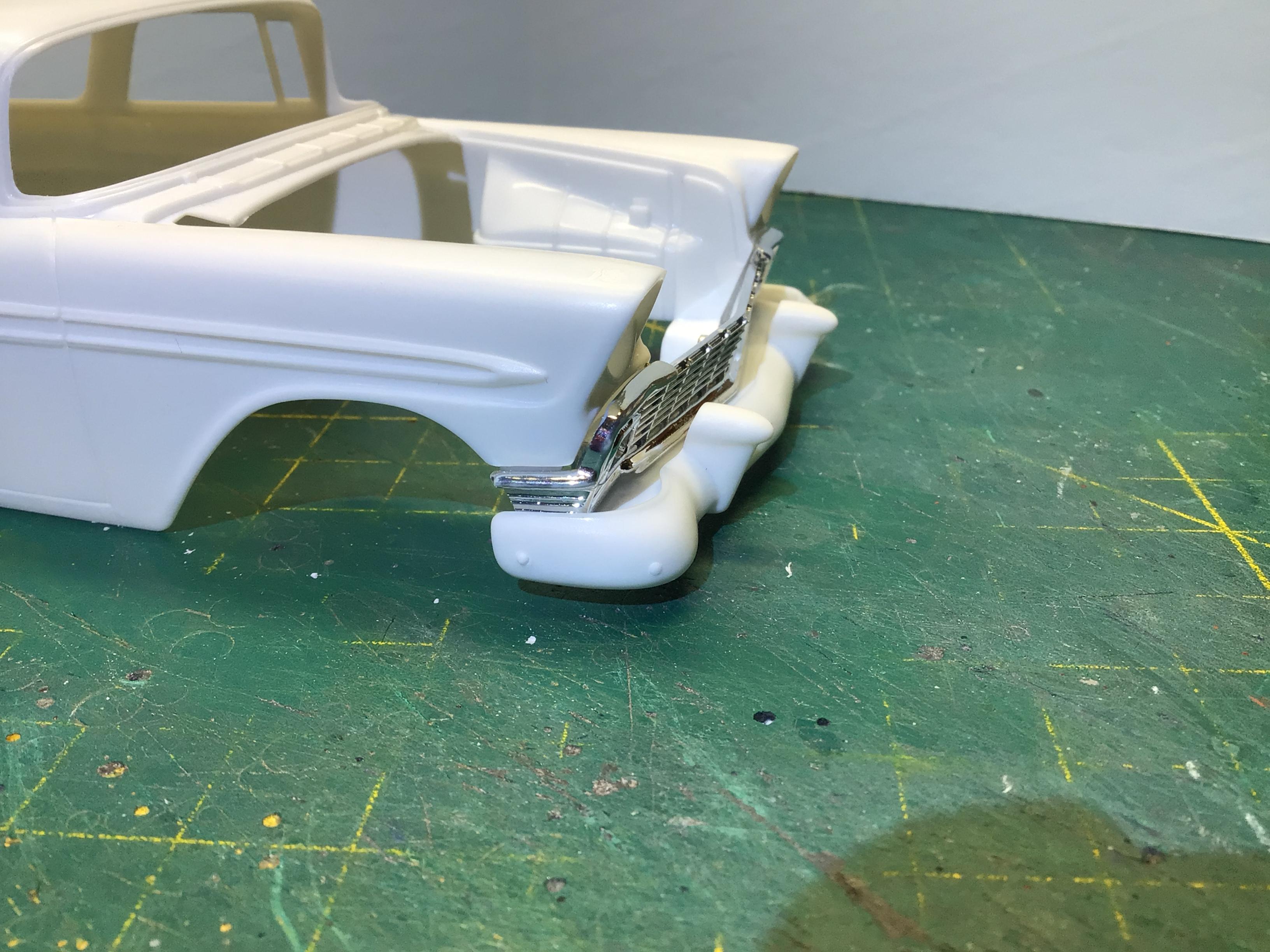

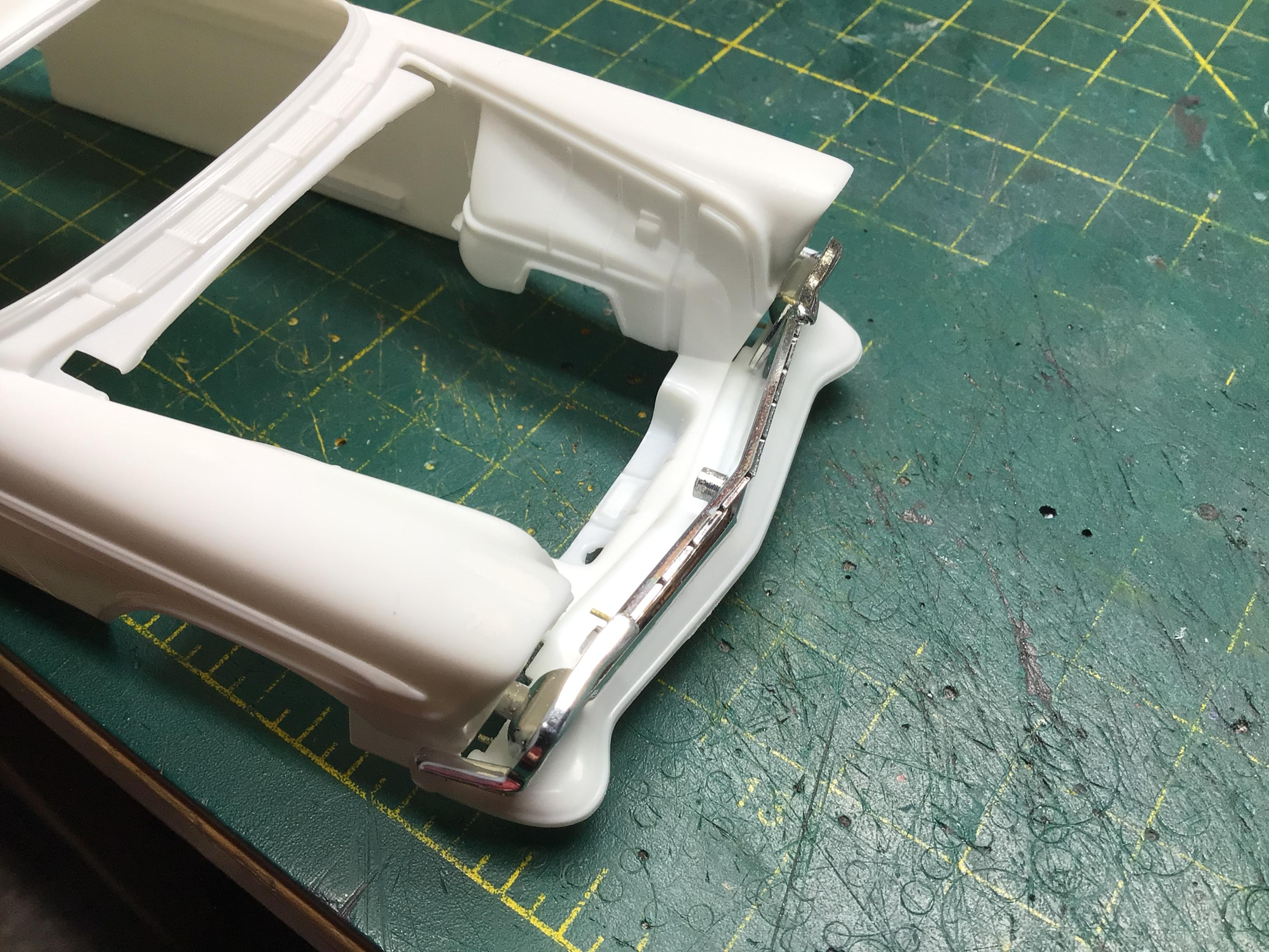

You are off to a great start Geg. I too found that the bumper sits a a long way forward and is different to the box art car where the bumper is tucked right into the body. I shortened it and tucked it into the body.

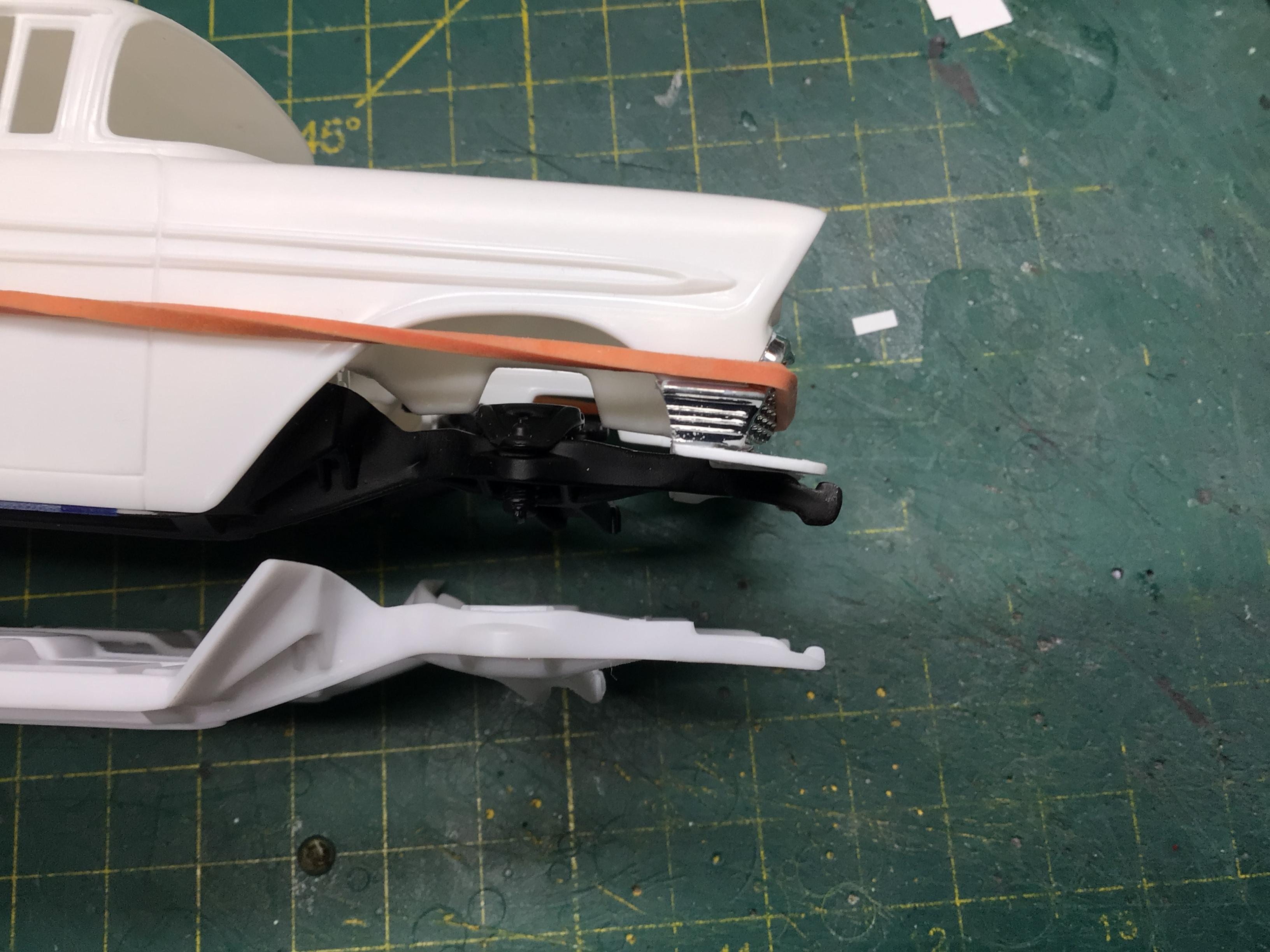

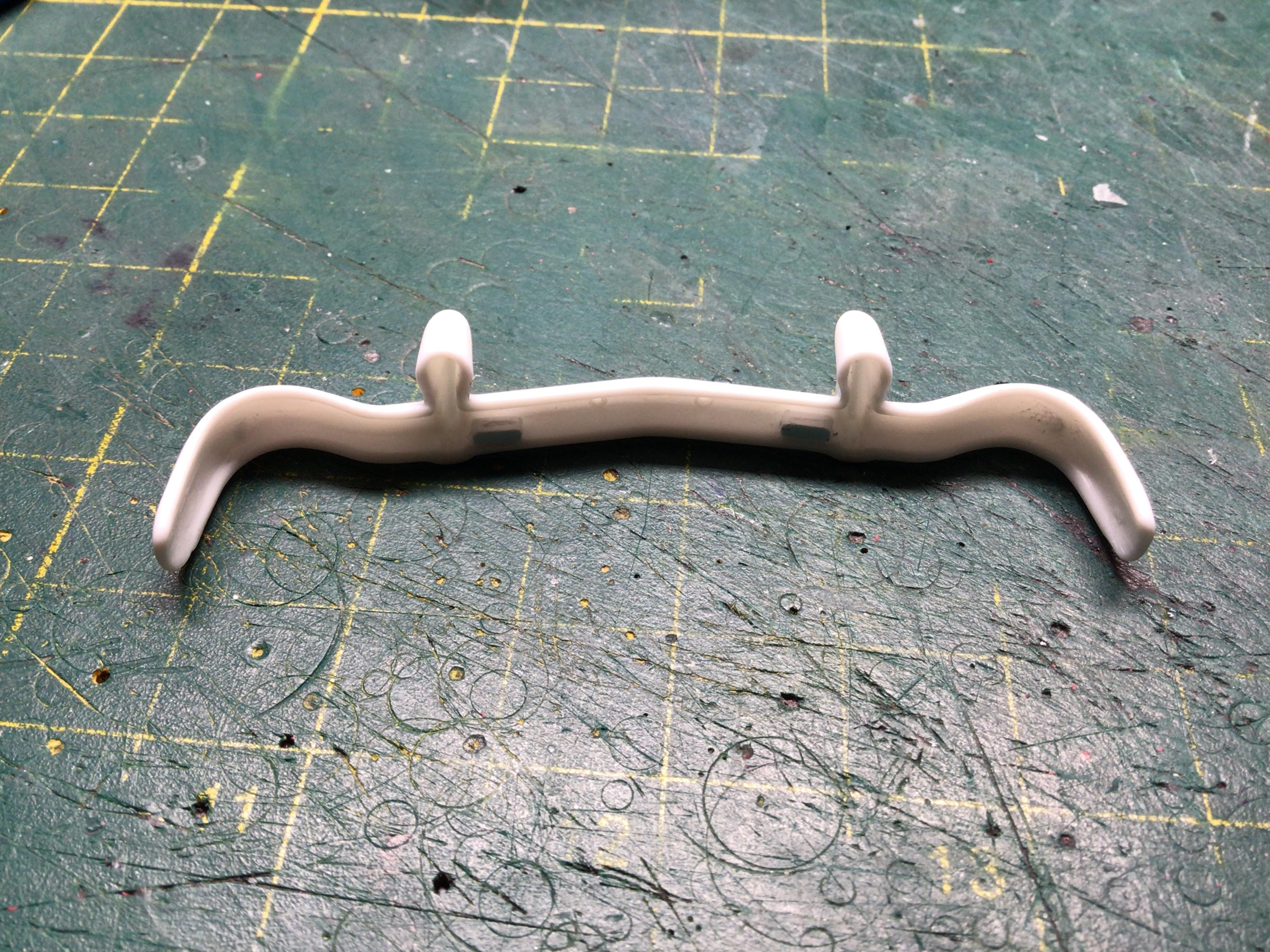

Well it took awhile, but I’ve finally got the bumper re-mounted. I traced the Del Ray  valence and trimmed the Nomad one down.
I couldn’t get the bumper to sit nicely, so I made a new valence from .040” sheet. Only after a lot of fiddling did I realize that the frame horns are quite a bit different between the Del Ray and the Nomad.? Probably didn’t need to make a whole new one.?
After paring down the frame, I used a couple of 1/4” slugs to space the bumper evenly on both sides. I found a thread on a tri-five forum that said the measurement where the slugs are should be 7” or .28” in scale…close enough!?
Once the bumper fit properly, I re-did the bolts on the rear corners of the bumper. I left them a bit long on the inside so they could act as locators for the bumper ends. It clicks into place nicely now.?IMG_9048.thumb.jpeg.96c01f0b5420569293834472211054d2.jpeg
??? Oh, and I shortened the bumper ends too!
Edited by NOBLNG
  • Like 5

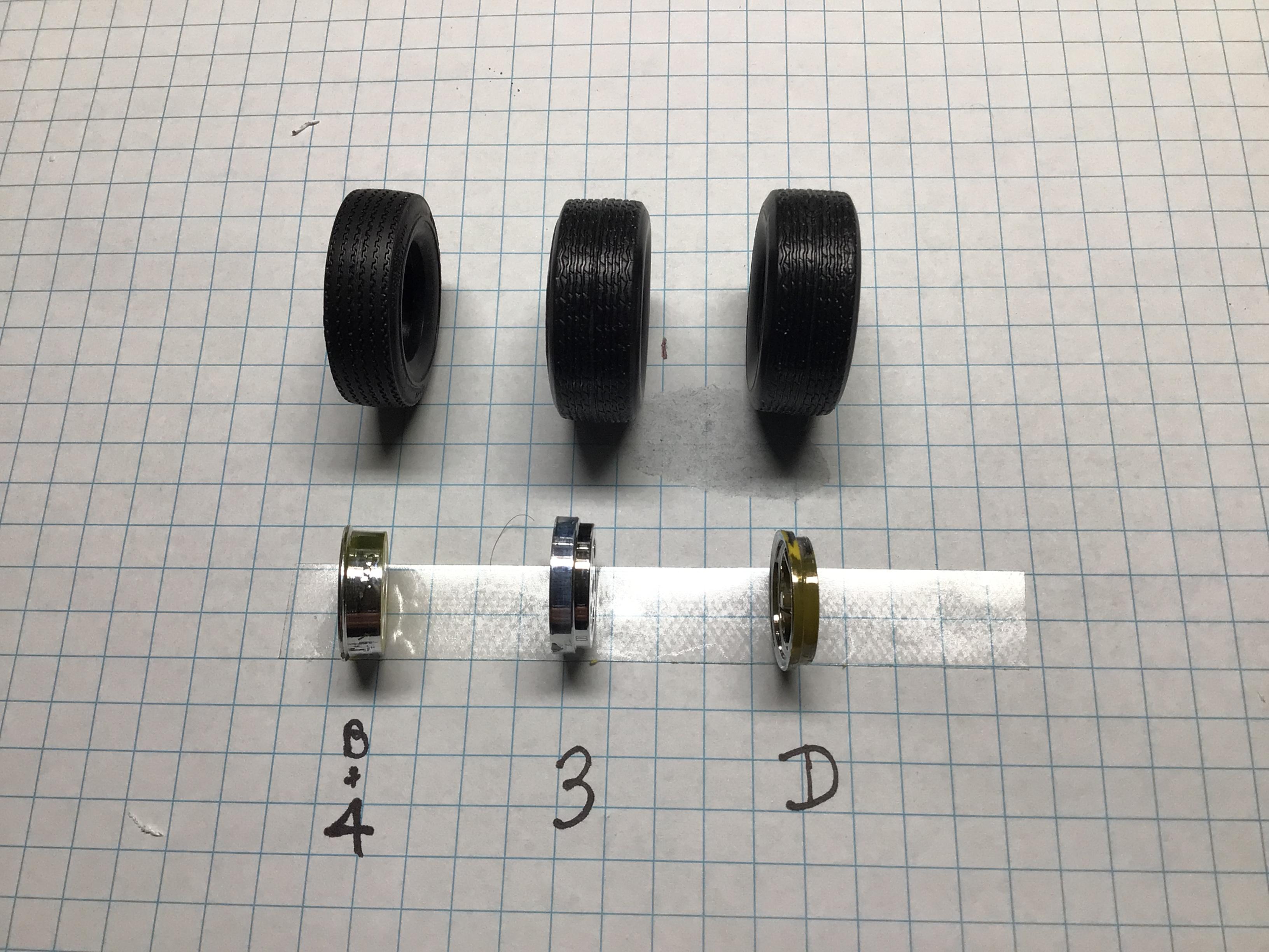

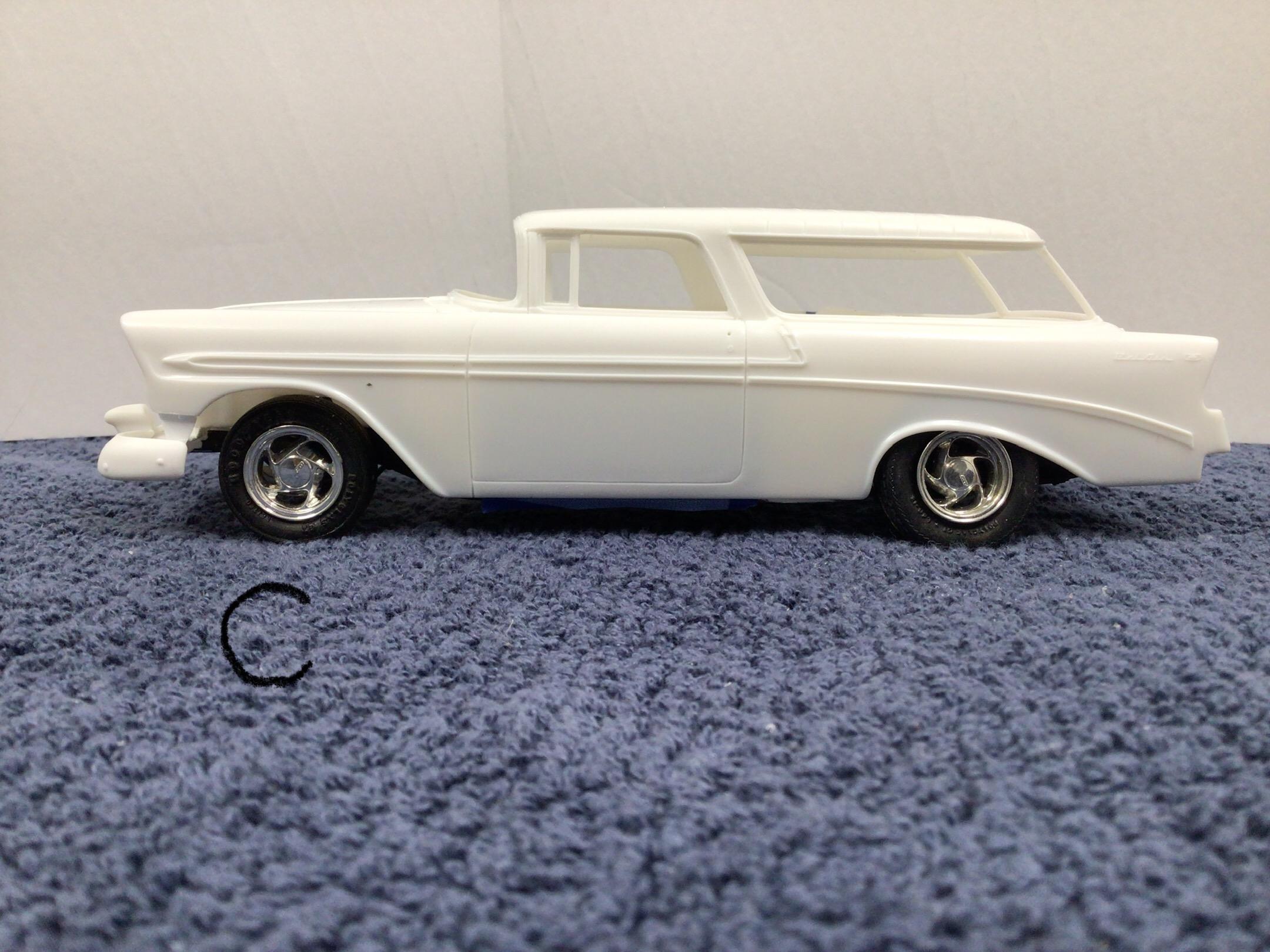

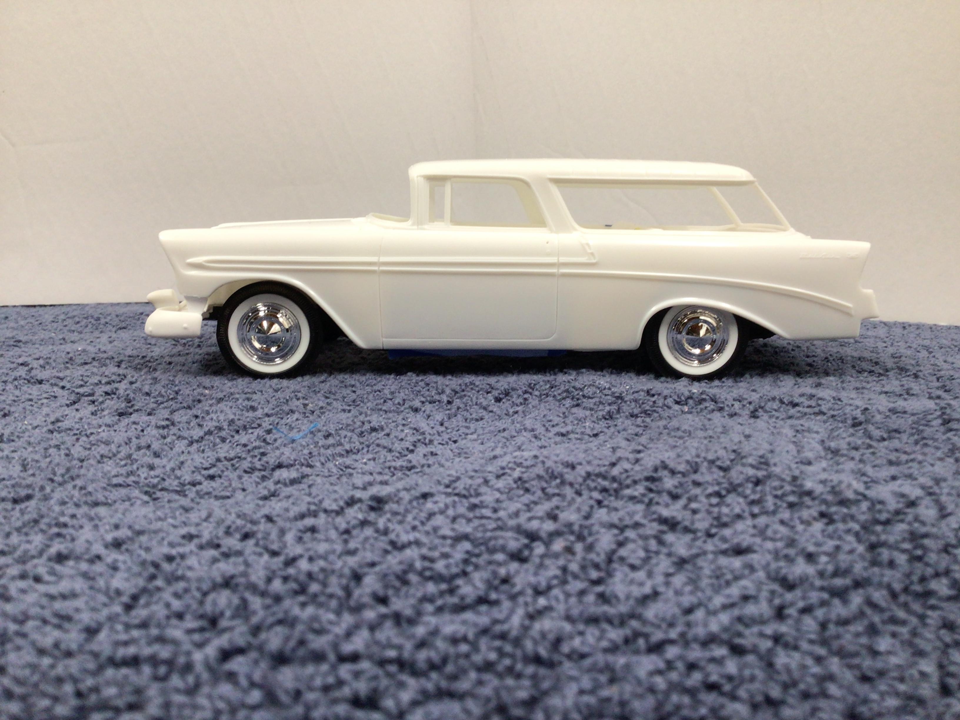

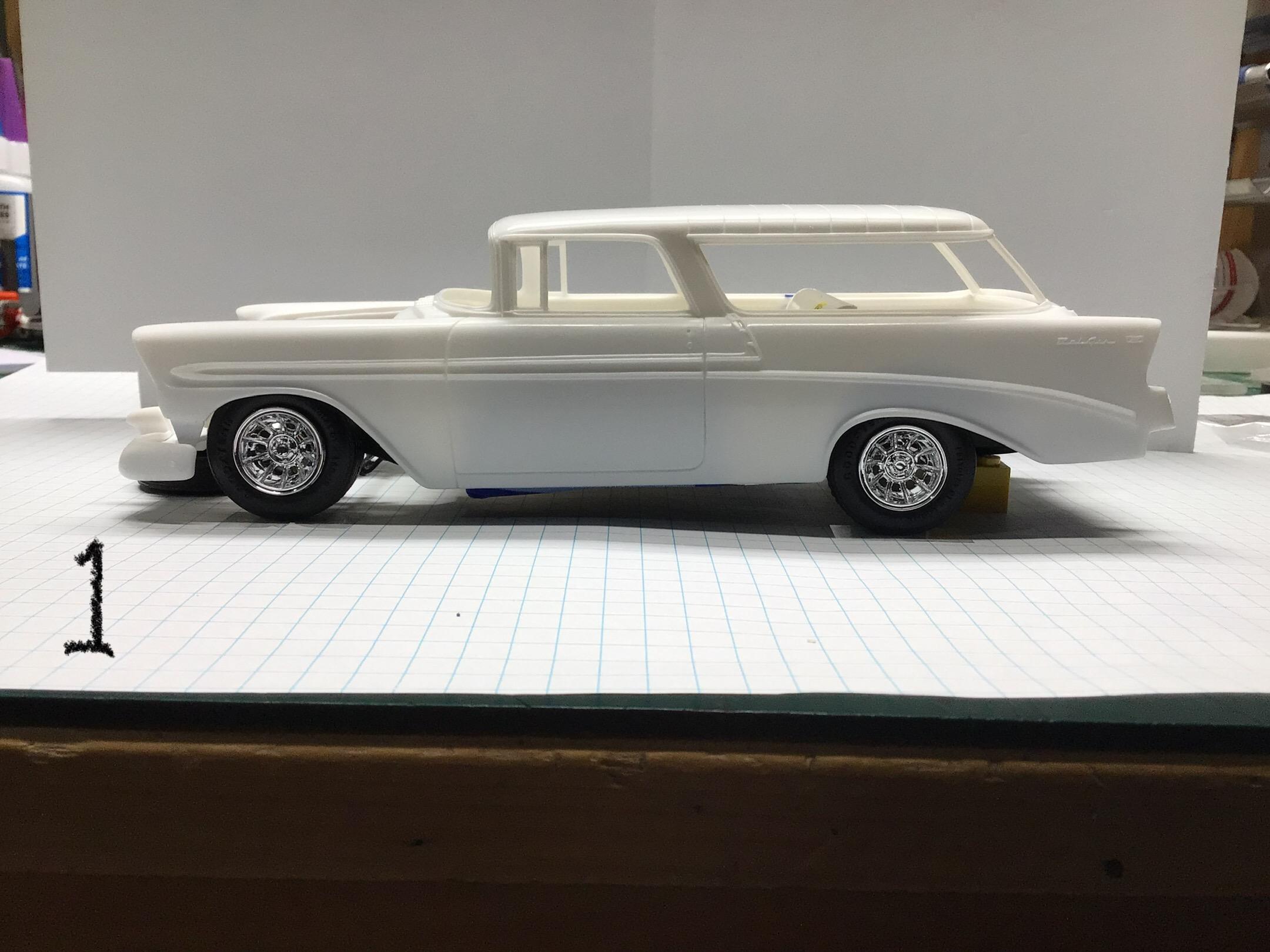

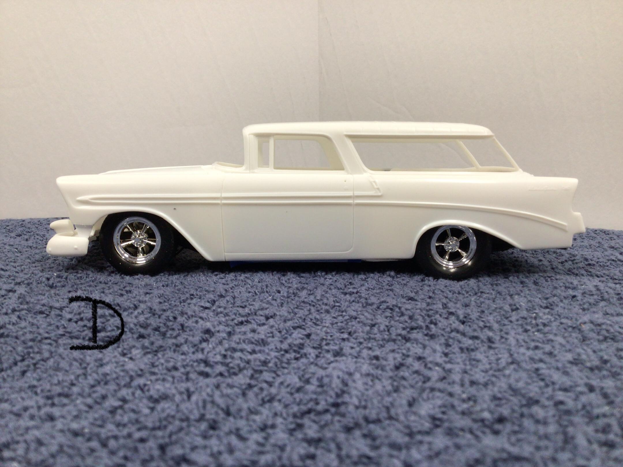

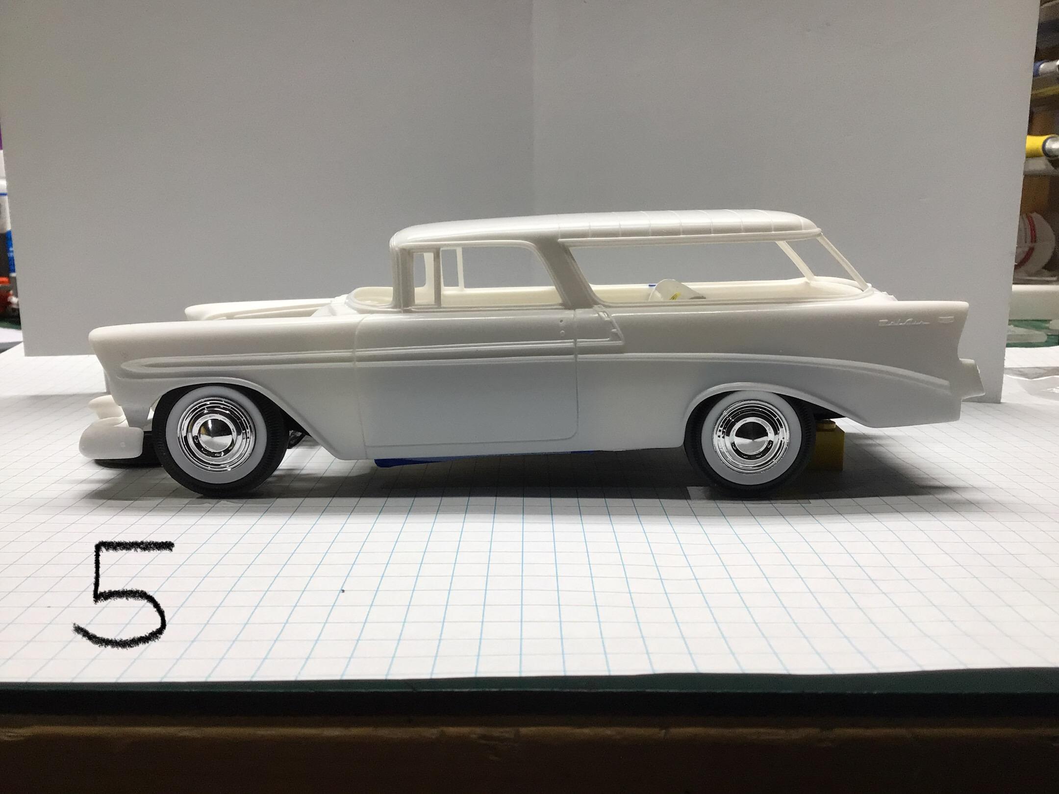

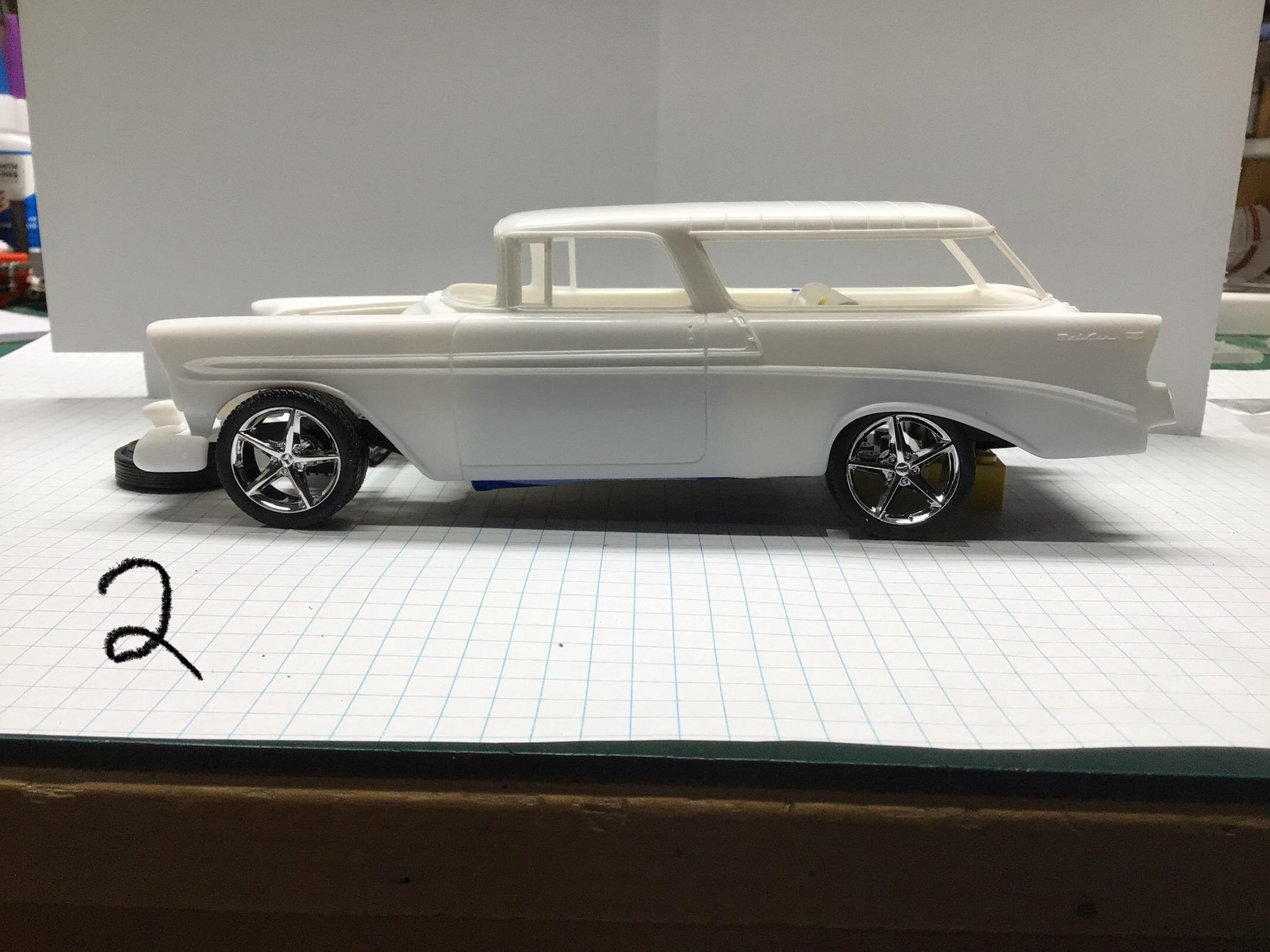

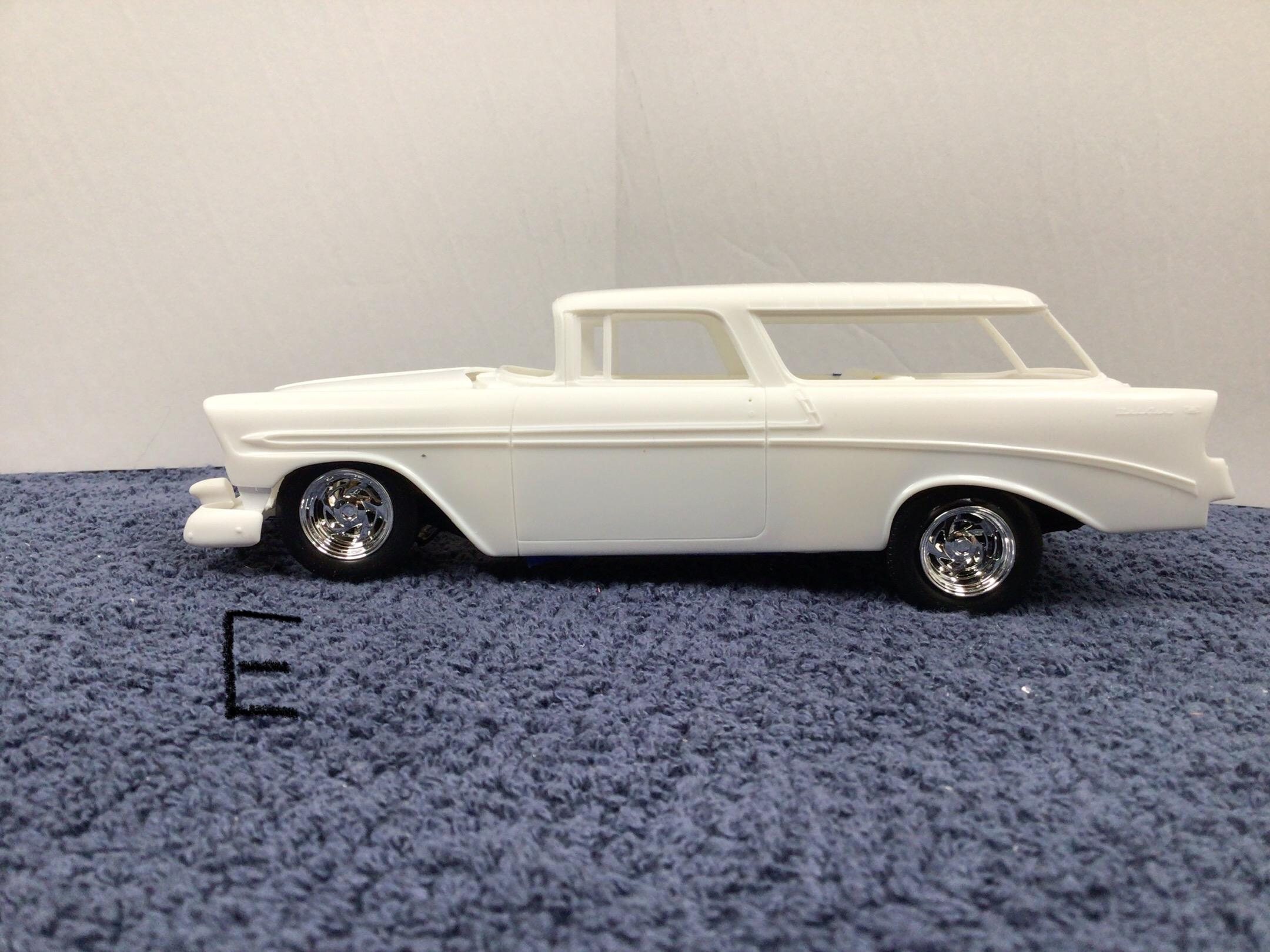

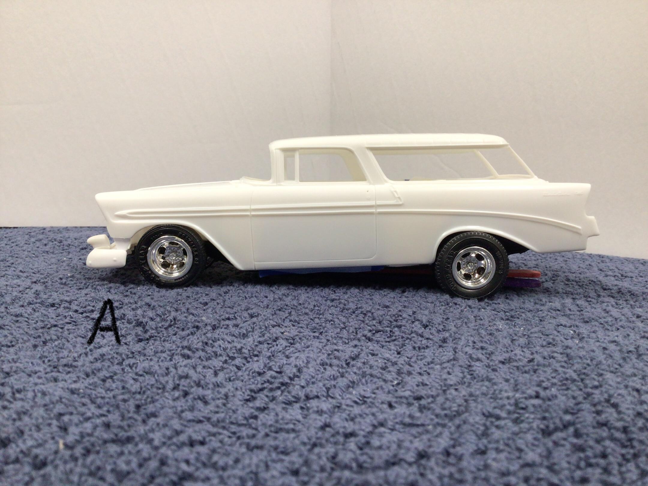

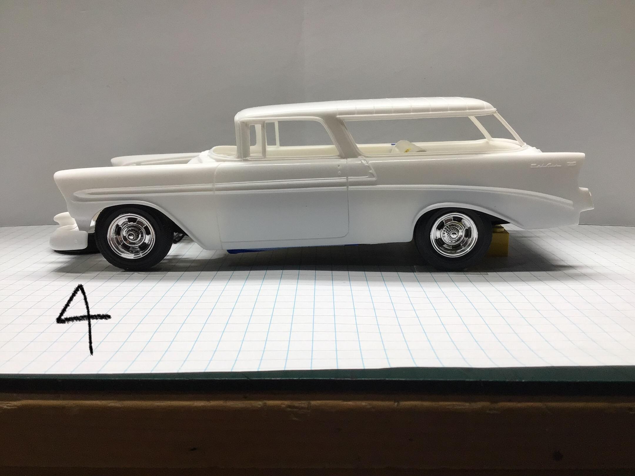

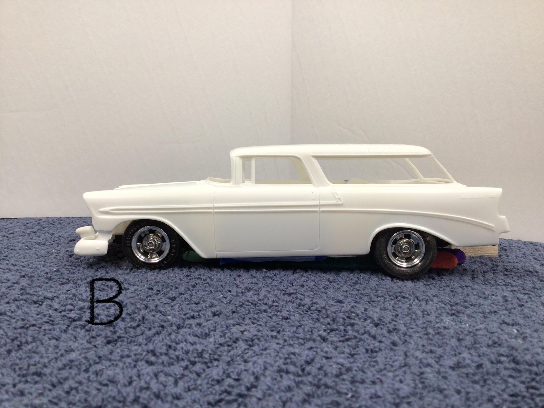

A few quick and dirty mockups.? I don’t have much for wheels and tires in the parts bin, so I may just go with the stock tires and hubcaps…with maybe a little attitude adjustment. I don’t mind the slotted rims (A) or the rally wheels (B) but I don’t really have decent tires for them.?
Edited by NOBLNG
Number 1= D. Number 2= B with the center slotted area painted to match the body color. Just one person's opinion, do as you wish.
They say that beauty is in the eye of the beholder and to my eye the front bumper and valance modifications are indeed beautiful. Well done Greg!
With regards to the wheels and tires I personally think the stock wheels, hubcaps, and white wall tires give the Nomad such a classic look. That said I’m sure you’re going to use something that will look just right.
Cheers,
Wolf
Edited by Wolf
I vote for D as well. E would also work, but they do look a bit "dated"... All depends on the overall look you are going for, and what makes you happy ?
Edited by SpikeSchumacher
Expand
Cheers,
Wolf
Expand
  On 11/6/2023 at 5:16 PM, TransAmMike said:
Yep, "D" for me also.  Should be a nice one Greg!
Expand
Expand

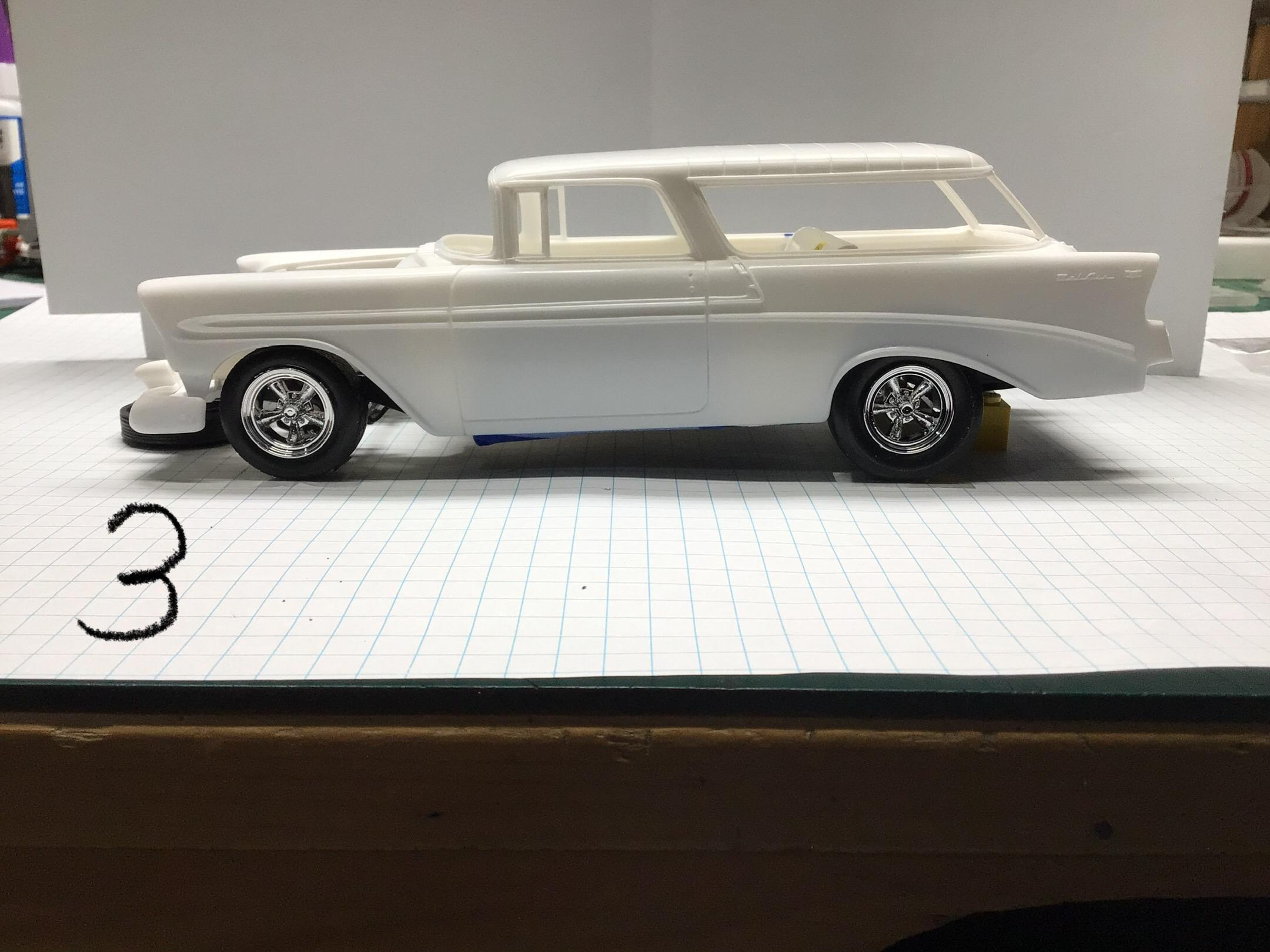

Thanks for your votes Gentlemen. I have done a few more mockups, and have pretty much decided on the rally wheels. I like them and these #3 ones from the Revell ‘32 Deuce kit…but the tires that fit those rims and the “D” rims are a bit too wide for the wheel wells, and would require some extra carving.? Different styles of wheels unfortunately.?
