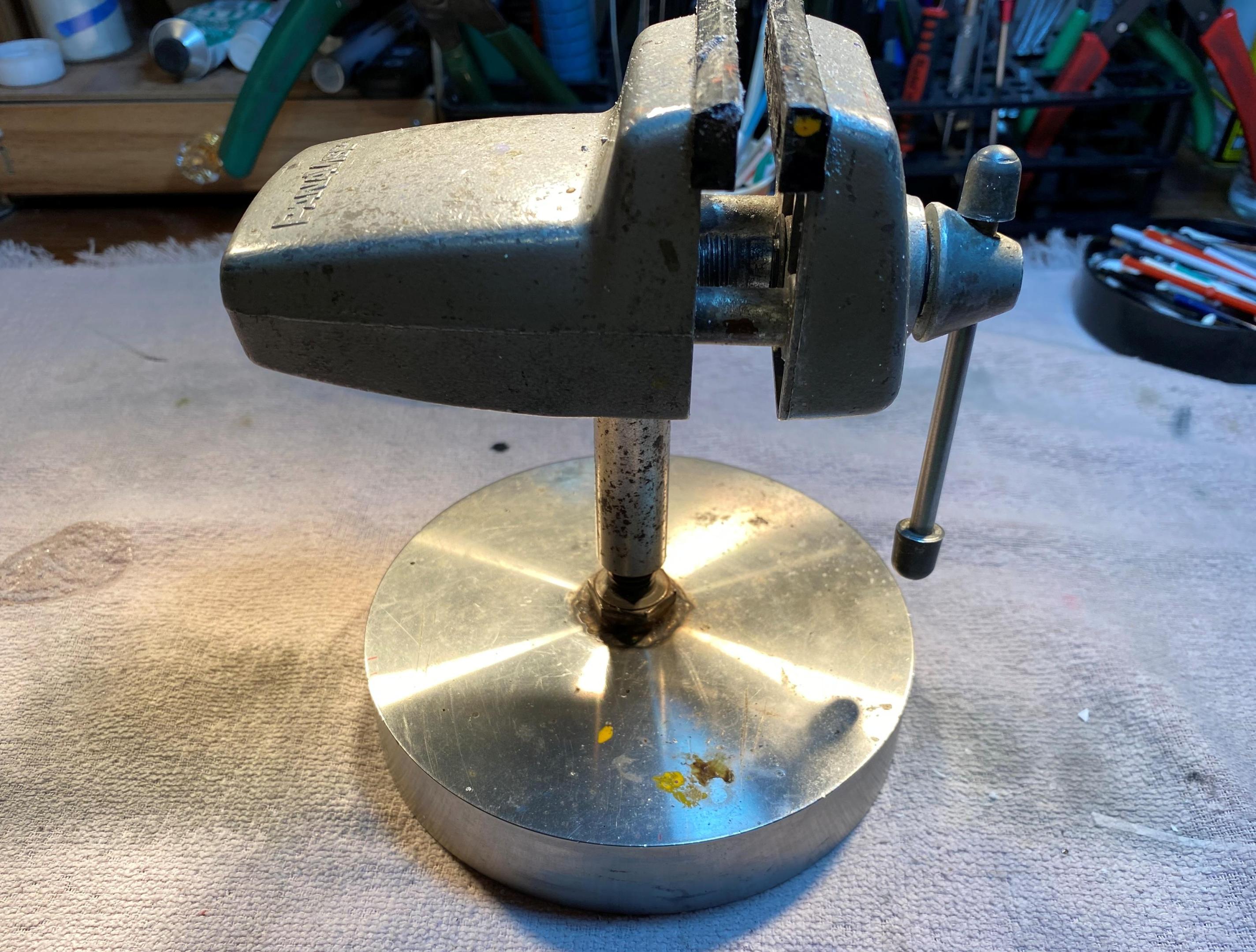

I was given a Panavise without the base. I was later given a solid disc of solid stainless steel. I TIG welded a stainless hex bolt to the center. I married the two freebies. I now have a 6-1/2 pound vise that actually HOLDS STILL when working on something. Its portability lets me position it on the bench wherever I need it to be. AND... the kitty cannot run off with whatever is clamped in it. ?

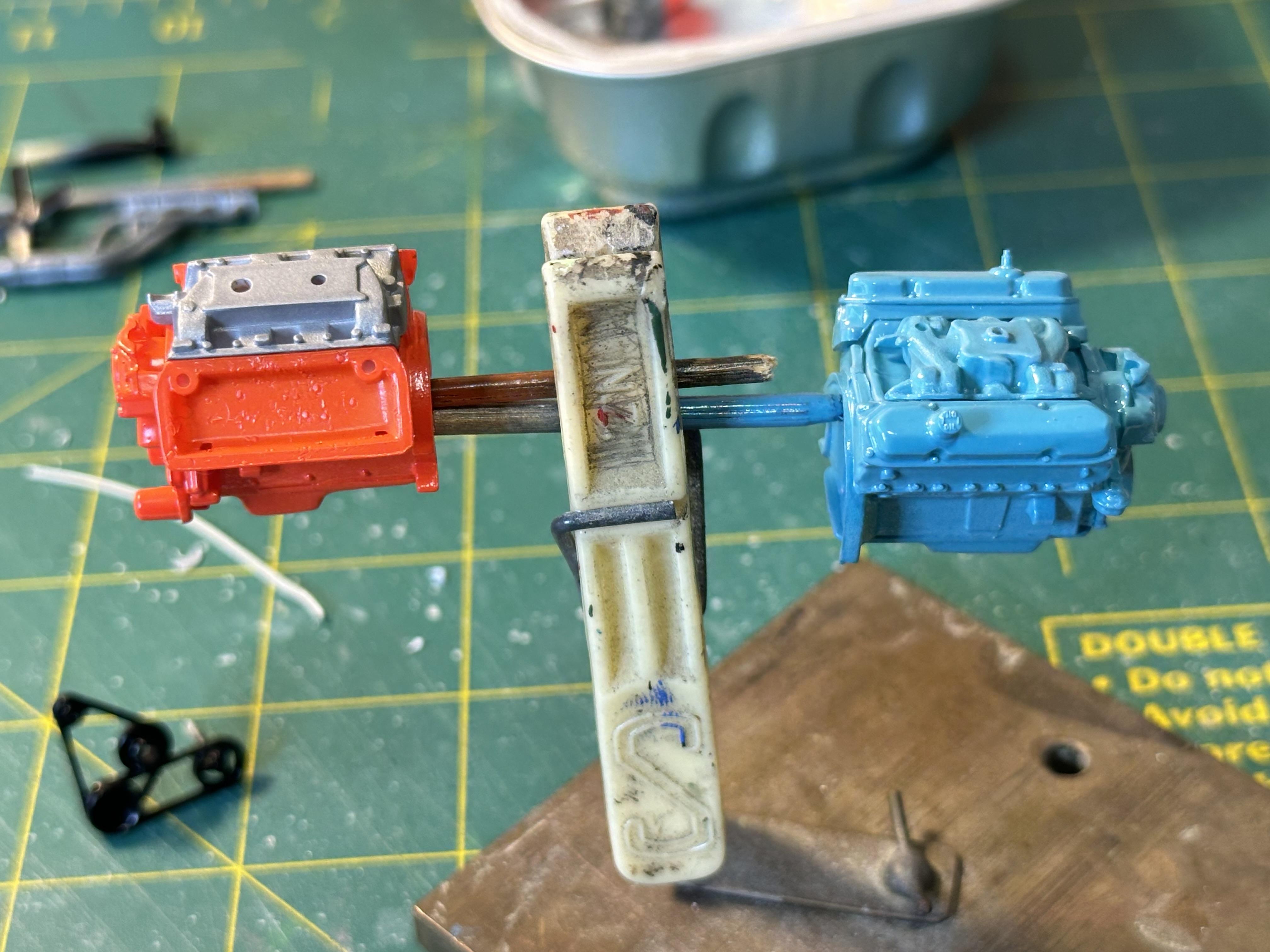

My method, a piece of foam board and a couple of needles.
IMG_7571.jpeg.04886493900dc9b1837ddd6aa59d6355.jpegSometimes I glue a plasticard tube in the oil pan so that the engine can stand on a needle as well.
