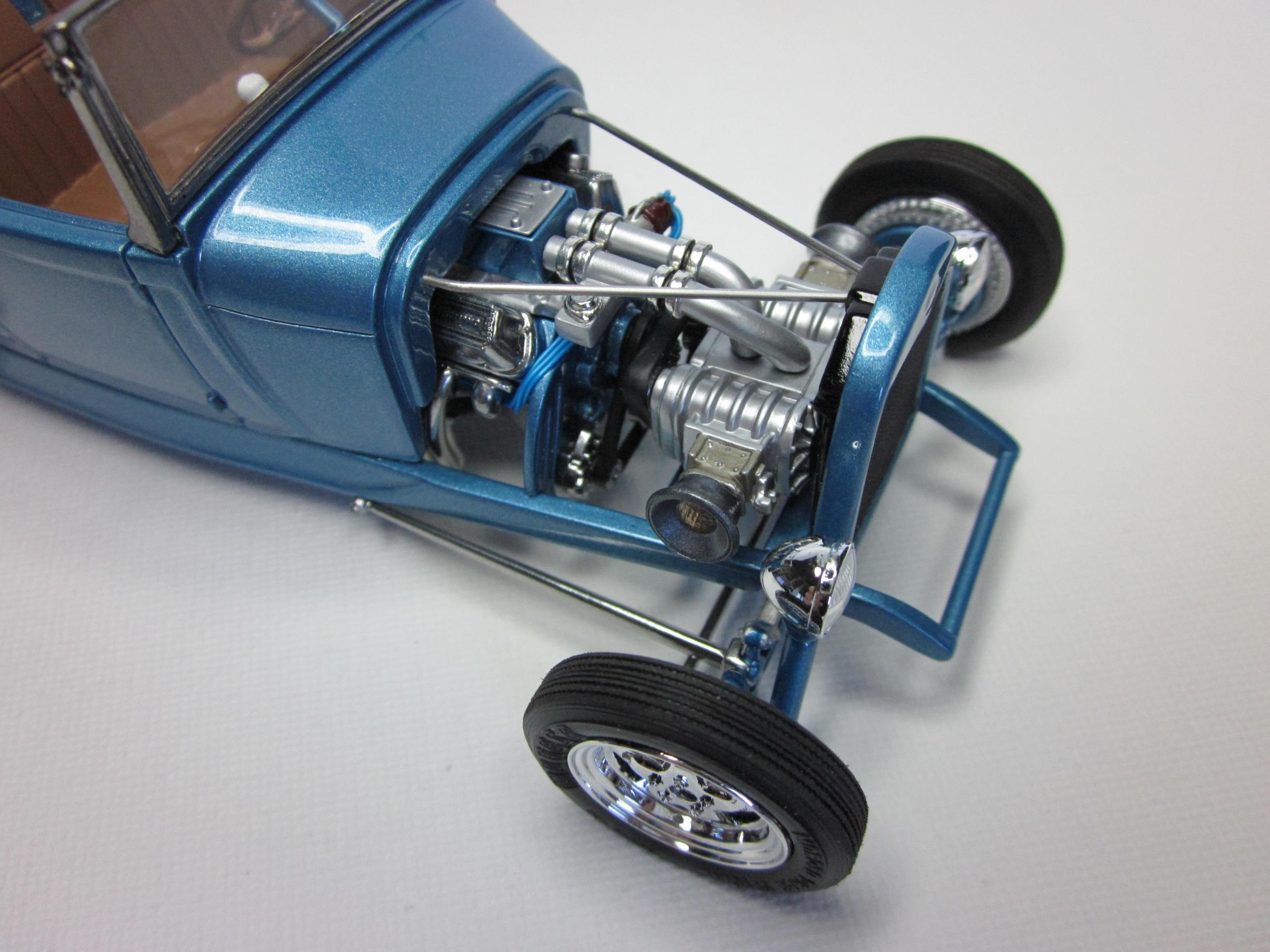

This is a 4 week build I did to have something to put on the table at the final GSL. I had planned on a different powertrain but my idea just happen to be something another builder also had in mind(Mr Mark Weller). So i had to come up with another idea. Ended up building the roadster and kit bashing the Matt Hay pro street T-bird into it. This was rather challenging, being space limited, as the engine from the t-bird is no way just a drop in. But it is a ford. The engine and blower mounts were adapted to the frame and a trans mount was built and relocated. A dog house was built for the interior since more than half the engine was now in the passenger compartment. All the parts for the superchargers were thinned including the drive system trying to get as much room as I could. This really helped getting everything to fit. The front suspension was dropped a scale 5 inches or so by building a new crossmember mount so the radiator would remain in it's stock position. The front axle was also drilled and the drag link was modified to clear. At the rear, The four bar links from the t-bird were used and required new mounting points to the frame. The rear end was narrowed to pull the rear tires inboard to keep the same track width with the front. A drive shaft was also built. Tires came frome the parts box and the wheels were taken from th Bob Glidden Pro Stock kit. Brakes are drums all around. The bottom of the floor was smoothed by removing all the ribs. Then a exhaust system was built using the mufflers from the '66 nova ss kit and round tubing. The system was then alcad chromed. Alclad chrome, polished aluminum, and aluminum were used to finish all the parts for the engine and suspension along with the MCW Nassua Blue Metalic body color. The interior was done with light earth brown and the floor finished with embosing powder. The hurst quarter stick shifter and gauges were used from the t-bird. I added a little something to the front seat to give a little character. Was surprised I even got it done and is missing a few key components. Even so, It was a fun build.

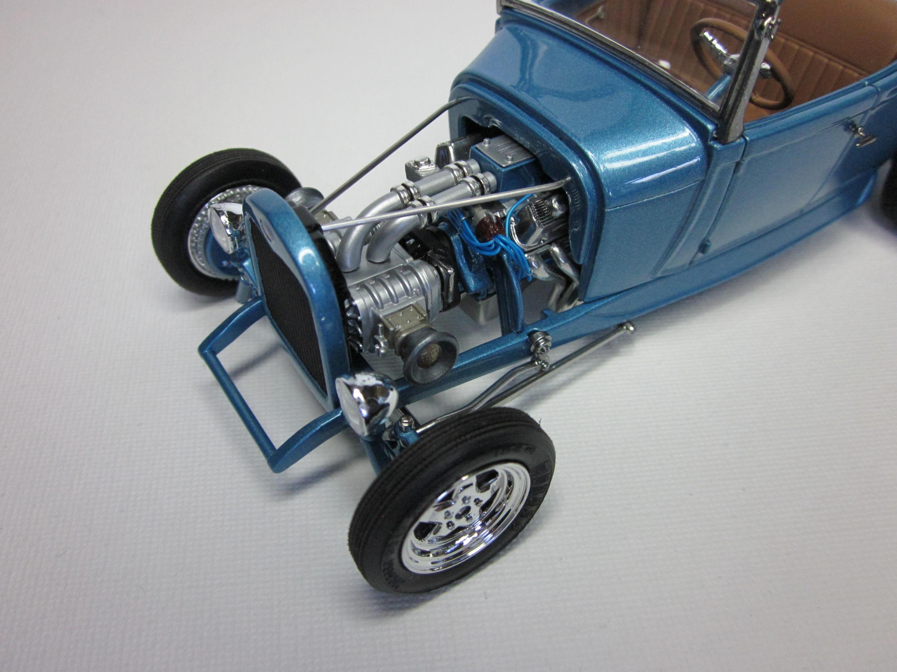

 Really cool build Paul. I’m thinking the engine would have been tricky to get fitted in there… Those wheels from the Glidden kit are, IMHO the best wheels ever kitted. Shame they haven’t found their way into another kit. Love the colour choices you made, stance is aggressive, I like it! In the second photo, it looks poised to strike the tires and do a big ‘ol burnout.

Thanks Steve,
The engine was a bit of a challenge. Getting the blower mount figured out was the hardest. Building the engine cover by far was the hardest part to build. The original plan was to stretch the body and frame to give more cabin space (leg room) but I only had 4 wks to get it done. Should have started sooner, my fault. I only have a couple sets of those glidden wheels and and am getting picky about where they are being used. This car just felt right. Still have a couple of the glidden kits in stock, But the shrink wrap is not coming off.

Thanks Harry, All the chrome parts that were going to be used on the car were stripped and redone with Alclad Chrome, Polished Aluminum and Aluminum. The wheels are the only thing I left "Kit Chrome".
