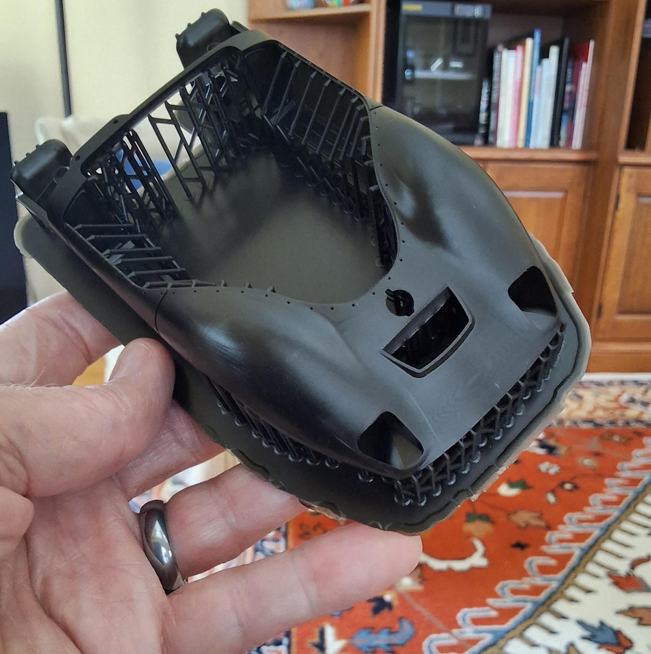

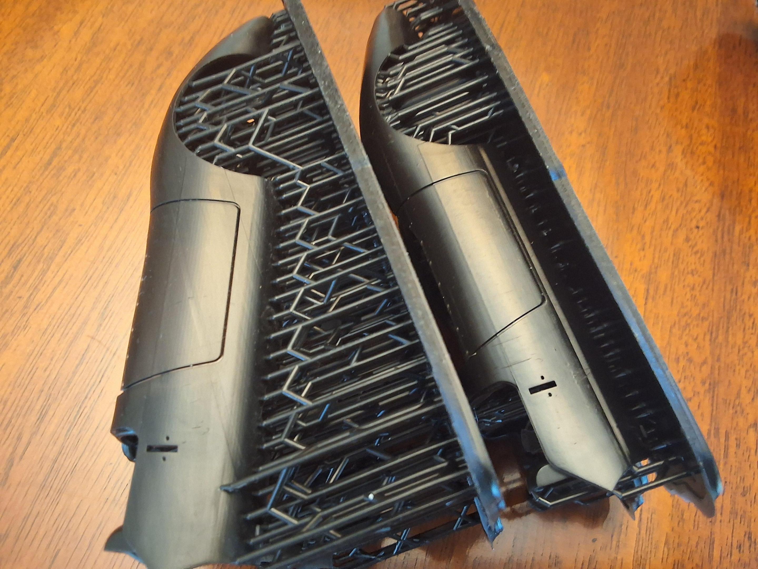

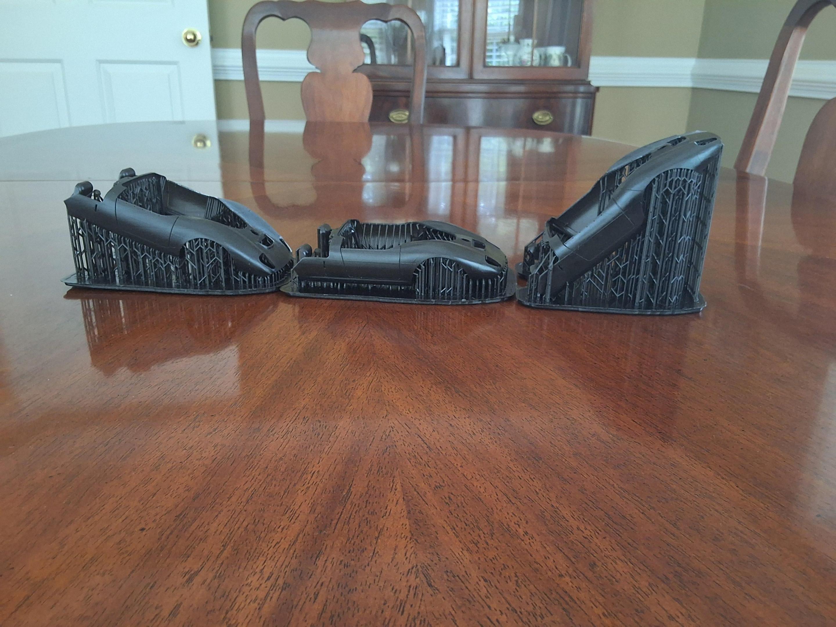

Michael jones Posted July 24, 2024 Posted July 24, 2024 (edited) On 6/7/2024 at 6:08 AM, Bilingham said: Lets talk about printing angles. It seems that everywhere you look it is recommended that best printing results come witn angled prints. I printed this body at 0°, 20°, and 44°. In my opinion the zero print is superior. Firstly, it printed in 5 hours as opposed to 10 or 15 hours. Also, there are fewer lines and flaws requiring sanding. The angled prints have obvious diagonal lines that require alot of work to fix as opposed to the horizontal line on the zero print. Certainly there are some situations where an angle makes a better print, but zero angle is my default setting.I continue to make improvements to the body. I recently intalled a firmware update on the printer and it seems to have improved the overall smoothness of the print. This is directly off the printer with no sanding. Using lots of resin, but making progress. Awesome work! From my fairly short experience, if you don't have many "flat areas" on your body, printing flat is fine. This is especially true on those older sports cars that are curvy. Going by those print lines on the angled body, that is because it wasn't supported enough and moved slightly during printing. That is hard to understand considering you have a lot of supports already, but if you did add a few on the outside of the body, it would cure this problem (or maybe more on the inside). There is some evidence of this on the flat printed body if I am not mistaken as well. I actually learnt this when printing your Maserati files. Those Maserati wire wheels are amazing btw, Thanks for that! Edited July 24, 2024 by Michael jones 1

Bilingham Posted July 25, 2024 Author Posted July 25, 2024 17 hours ago, Michael jones said: Awesome work! From my fairly short experience, if you don't have many "flat areas" on your body, printing flat is fine. This is especially true on those older sports cars that are curvy. Going by those print lines on the angled body, that is because it wasn't supported enough and moved slightly during printing. That is hard to understand considering you have a lot of supports already, but if you did add a few on the outside of the body, it would cure this problem (or maybe more on the inside). There is some evidence of this on the flat printed body if I am not mistaken as well. I actually learnt this when printing your Maserati files. Those Maserati wire wheels are amazing btw, Thanks for that! I think that the new printer introduces some unknowns into the equation. I want to explore antialising and exposure times. The M5s Pro make astonishing prints of items without very complex compound curves. Carbs and wheels and tires, etc. Even the windshield mold is spot on. More to learn.

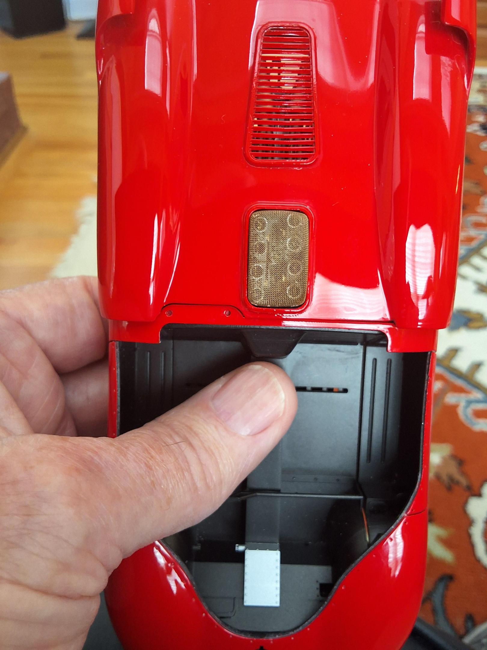

Bilingham Posted August 22, 2024 Author Posted August 22, 2024 so here a few shots to update progress. Headlights, screening over carbs, tail lights,engine details. 6

beeRS Posted August 24, 2024 Posted August 24, 2024 The picture showing the engine detail and rear suspension - it’s hard to believe that’s not 1:1 size! Excellent work ??. 1
Bilingham Posted September 13, 2024 Author Posted September 13, 2024 Headlights installed, 36 rivits around the cockpit 4
BK9300 Posted September 14, 2024 Posted September 14, 2024 Sure can appreciate all the detail work you do - all the rivets, and no glue marks of any kind, the polished finish and then there's the battery sticking out from the bottom of the interior. . . 1
absmiami Posted September 14, 2024 Posted September 14, 2024 Broke a rule never supposed to count the rivetz … 1
