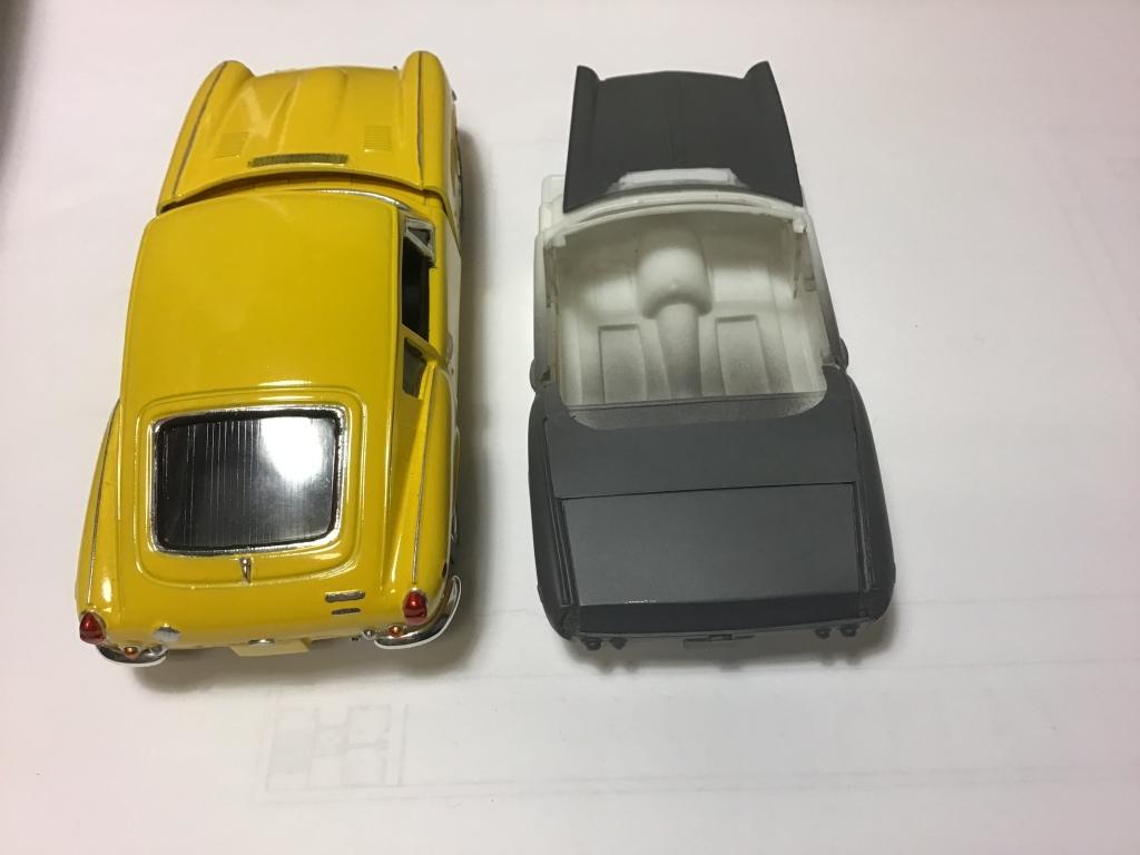

dimaxion Posted January 1, 2018 Posted January 1, 2018 Ok , I was brave and needed a challenge . I built an Original in mt first Collection . I re-created it again with an '80's (?) re-pop . Enjoy , It is doable ! The other pics are a Cautionary Tale . A warning to always Plastic bag your built models for Storage and or Moving . This way you find all of the parts .. From these only pics . My point is not so clear . Did I mention I do not like Windows 10 . It tends to lose things .. like pics Thanx ..

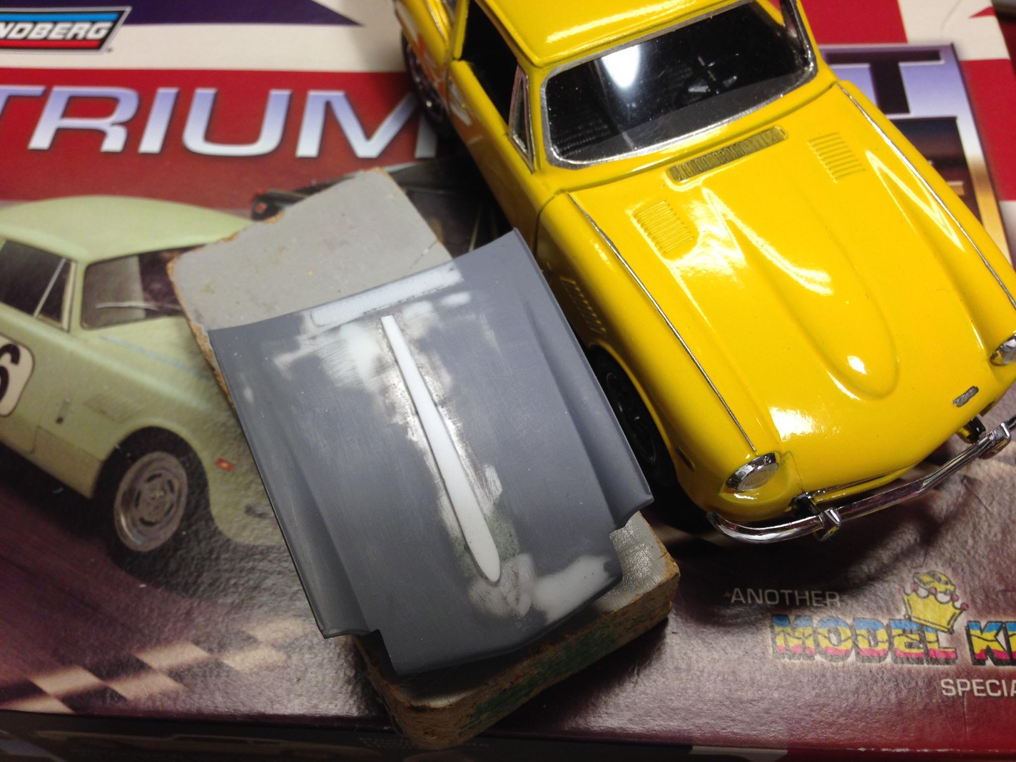

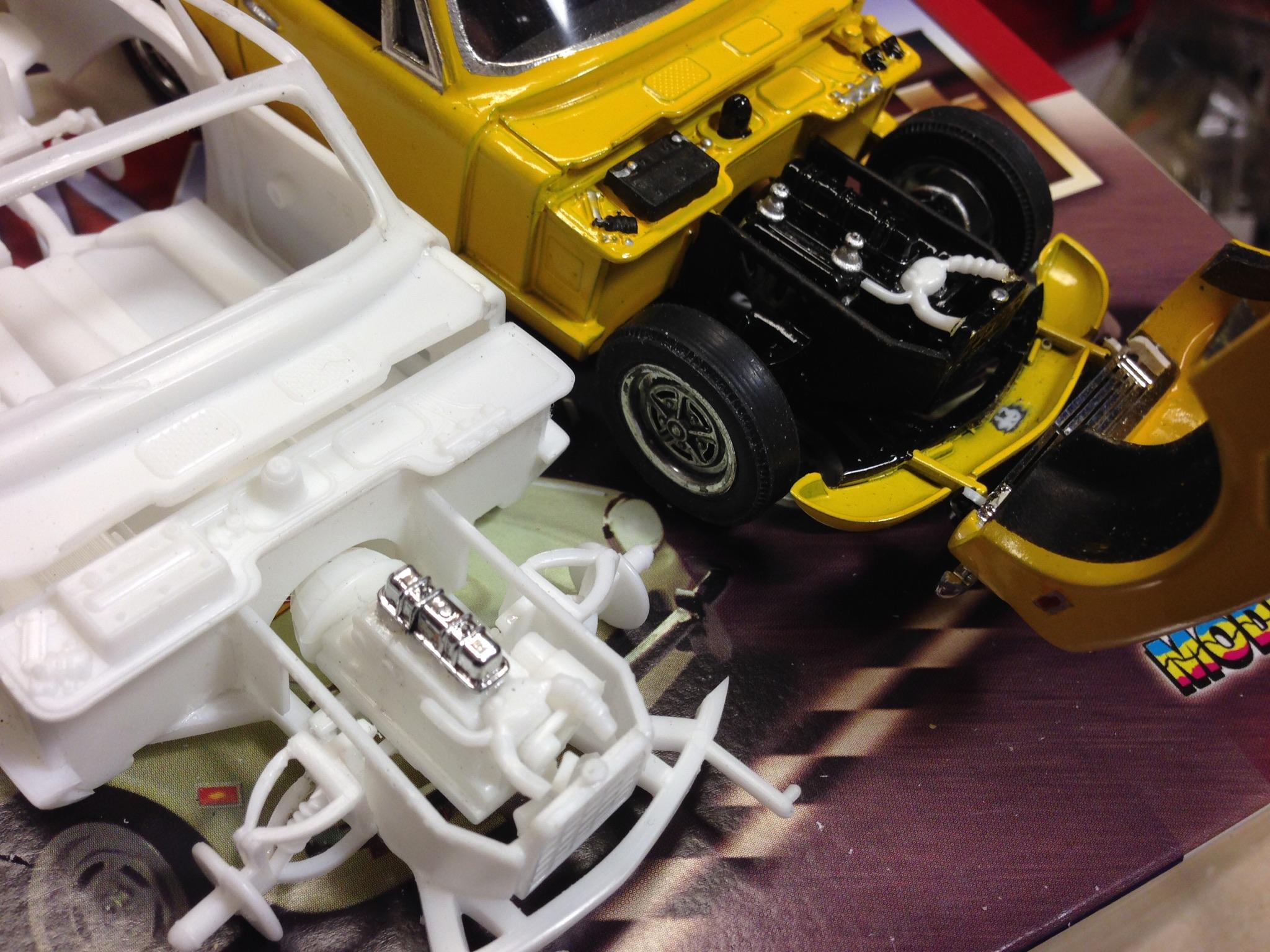

hct728(Bob) Posted October 29, 2019 Posted October 29, 2019 Presently converting my second Lindbergh GT6 kit to a Spitfire Mk 2. So far i’ve cut two cylinders out of the engine, fixed the too-small windshield, added the trim around the glass, removed the hood bump, replaced it with .040” styrene, filled the gaps then added the smaller spear found on the Spit. Currently working on the rear deck, more pics to follow - wish me luck!

hct728(Bob) Posted December 16, 2019 Posted December 16, 2019 Well, I had to redo the hood spear, as it looked a little off-center, then I attacked the rear trunk area, so here's what I have so far. I still need to re-attach the taillights and make a lip around the passenger area where the roof attaches, but you get the idea, it's coming along

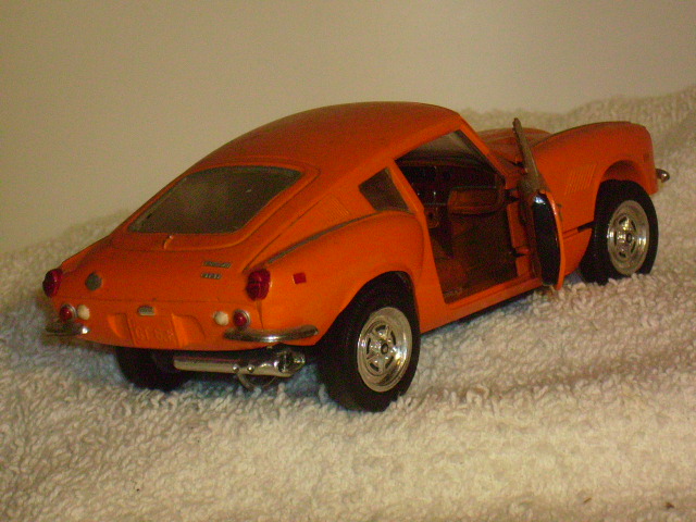

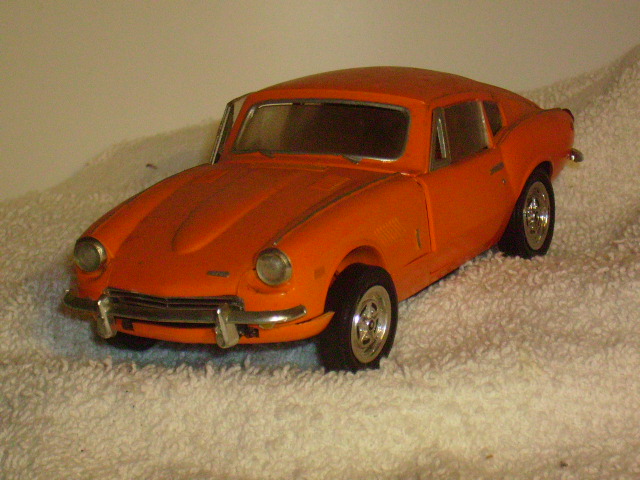

Ace-Garageguy Posted July 24, 2020 Posted July 24, 2020 Dead threads walk. I just got one of these little guys built up as a Group 44 race car. The builder did a credible job considering how bad a kit this truly is, and glued everything shut for simplicity. She's missing a few parts, and assembled I can see the glaring errors that need correcting (besides what's already been mentioned, the shape and size of the lower rear quarters is entirely wrong, almost like it's 1/32 tacked on to a 1/25 model). But it's definitely doable.

Ace-Garageguy Posted July 24, 2020 Posted July 24, 2020 1 hour ago, Matt Bacon said: ...Scaled 1/25 version of this drawing here. Thanks for posting that, sir. Most helpful. The more I look at the model, the more proportion errors I'm seeing (like the lower body may need about a scale .5" -1" sectioning job too, the height of the front fender over the wheel arch is wrong, etc.), but it's still doable.

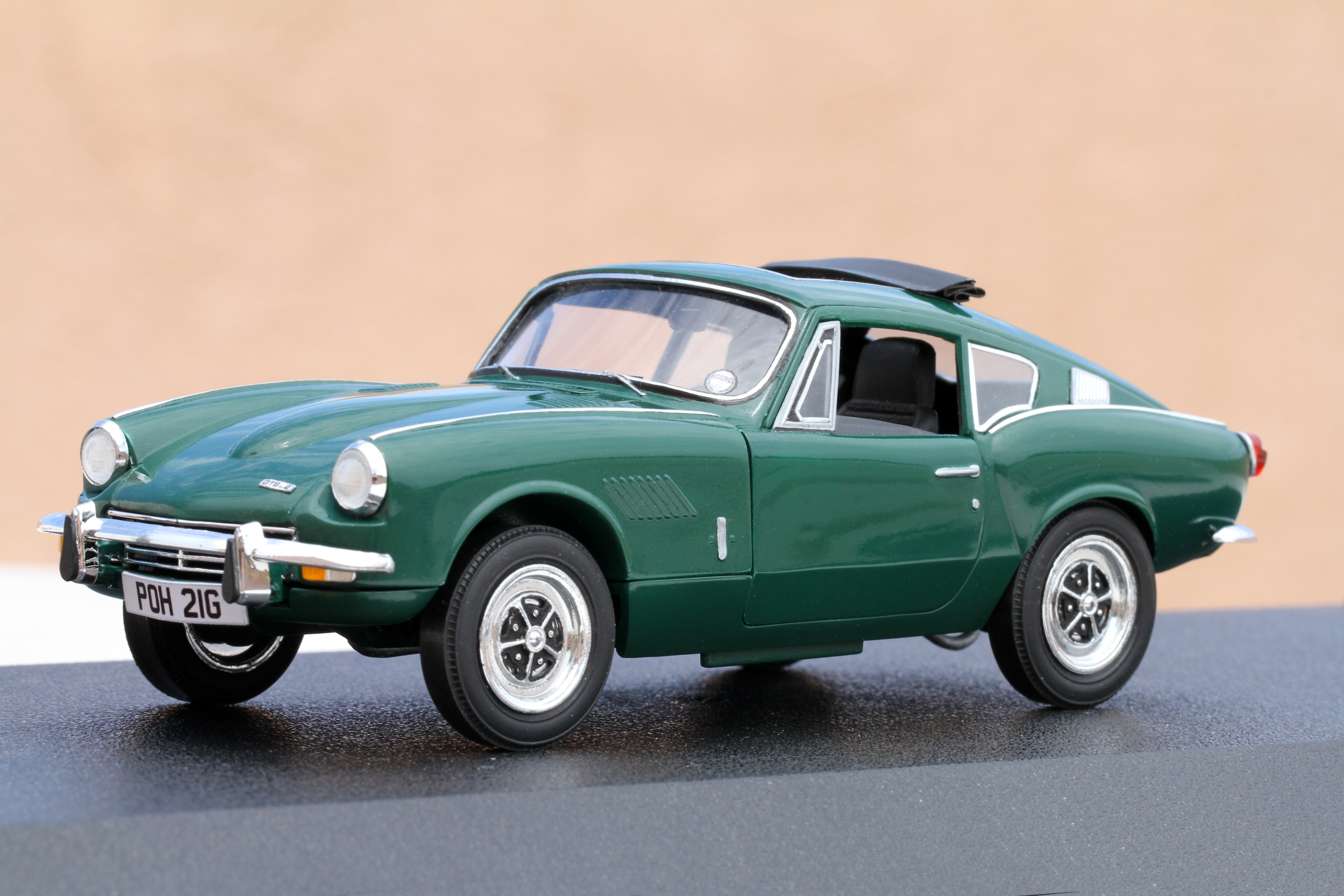

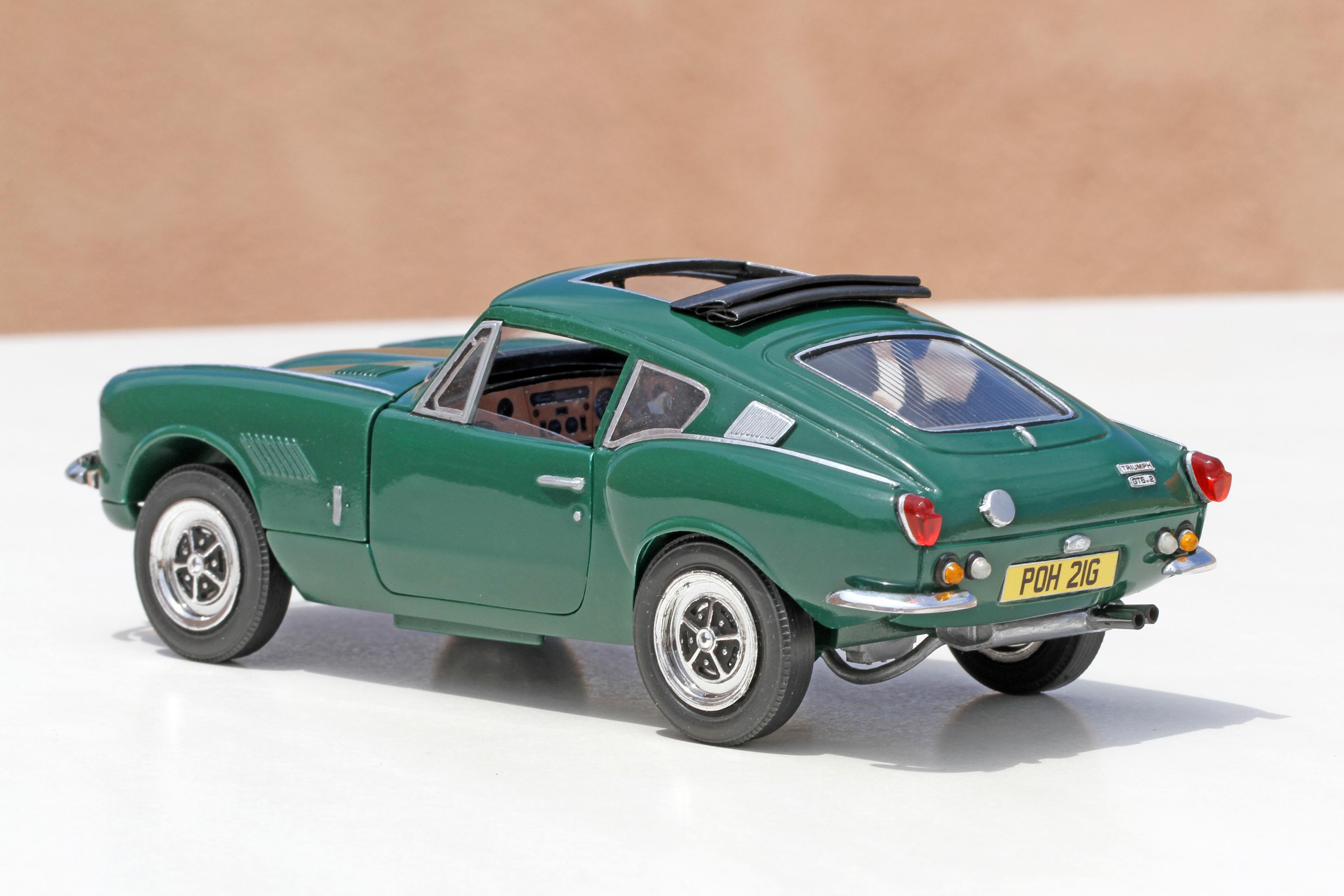

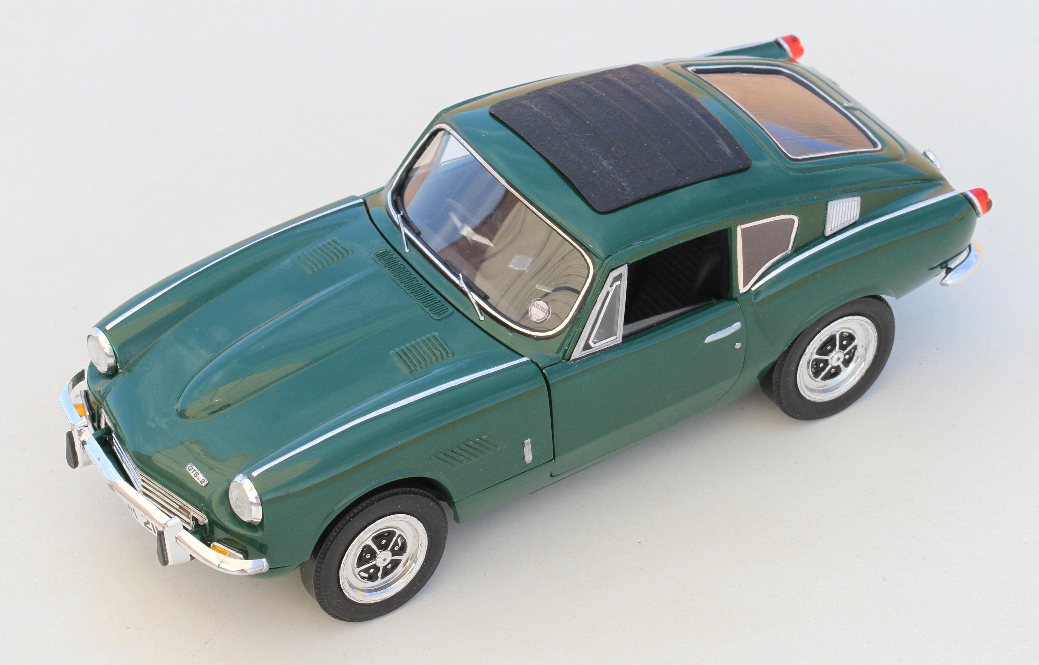

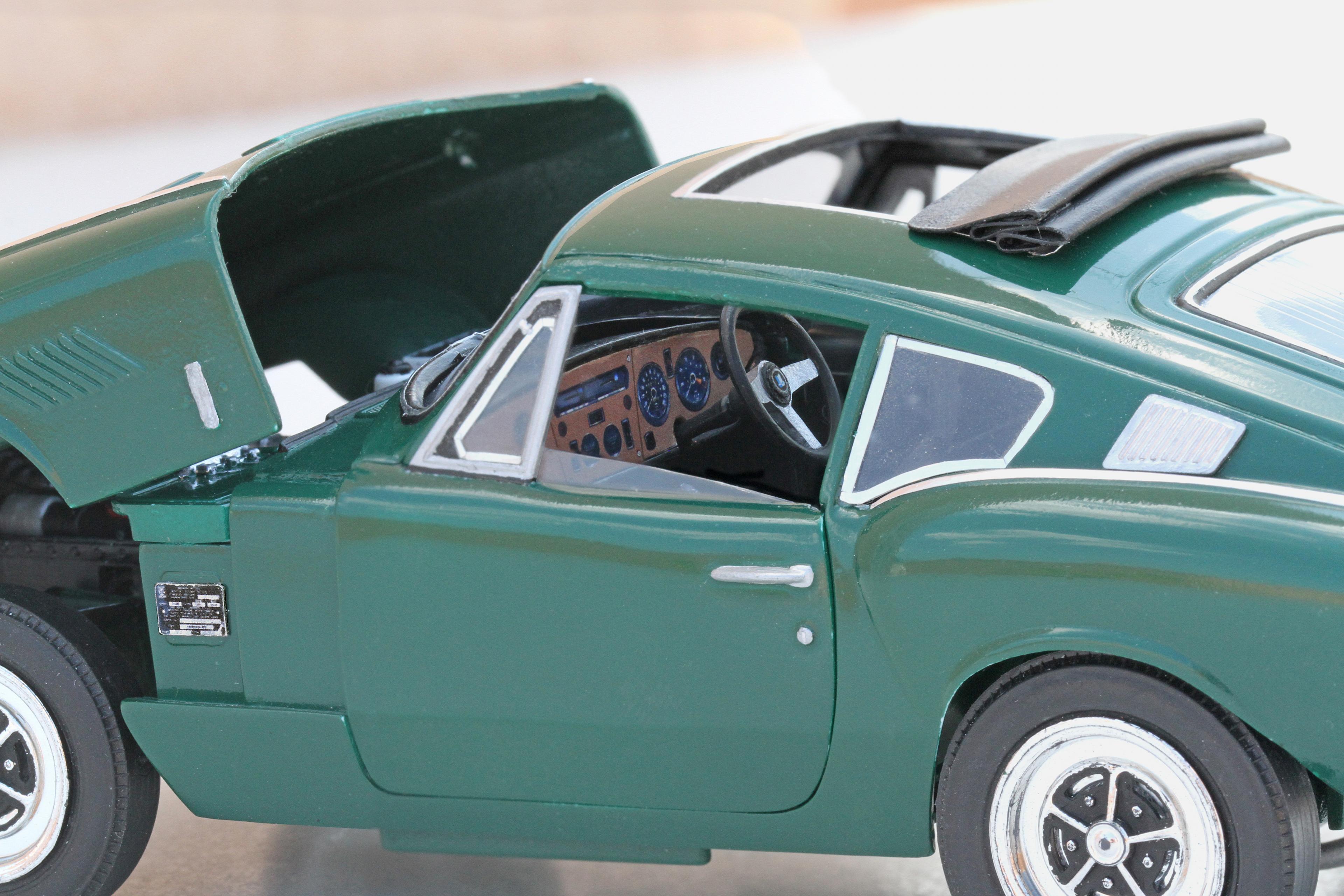

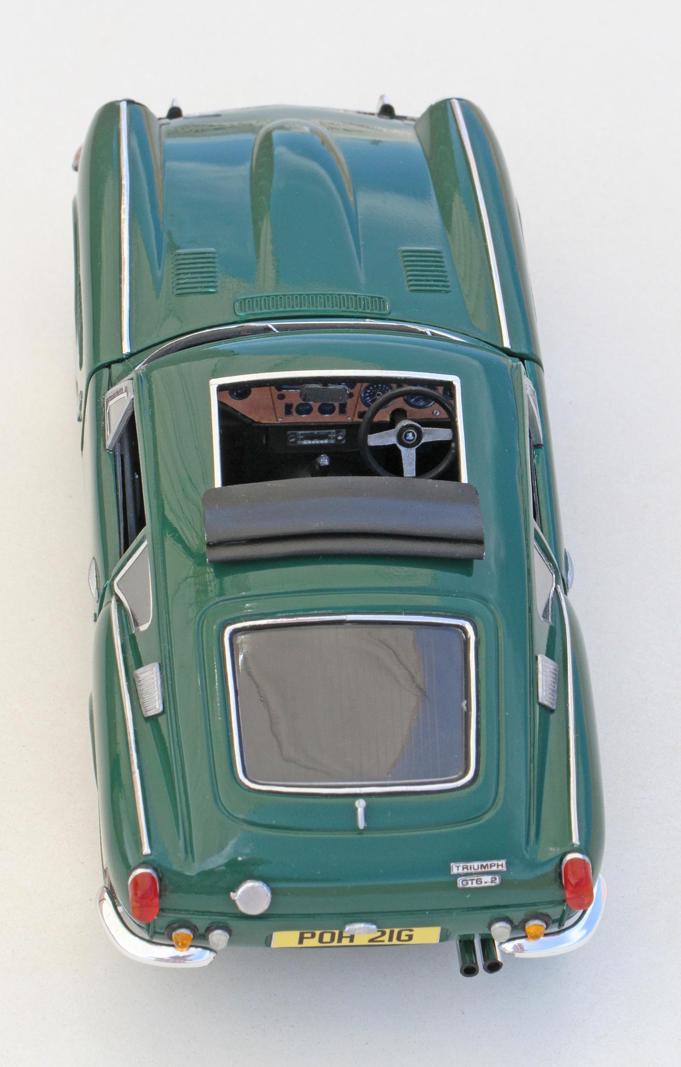

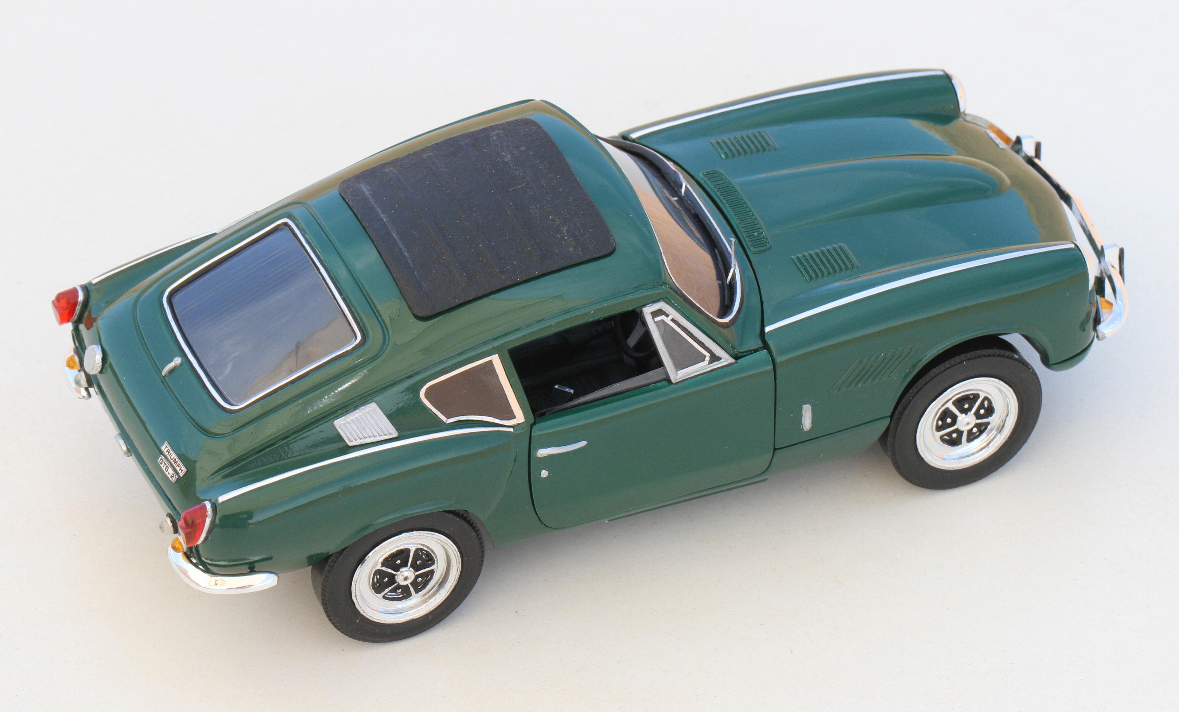

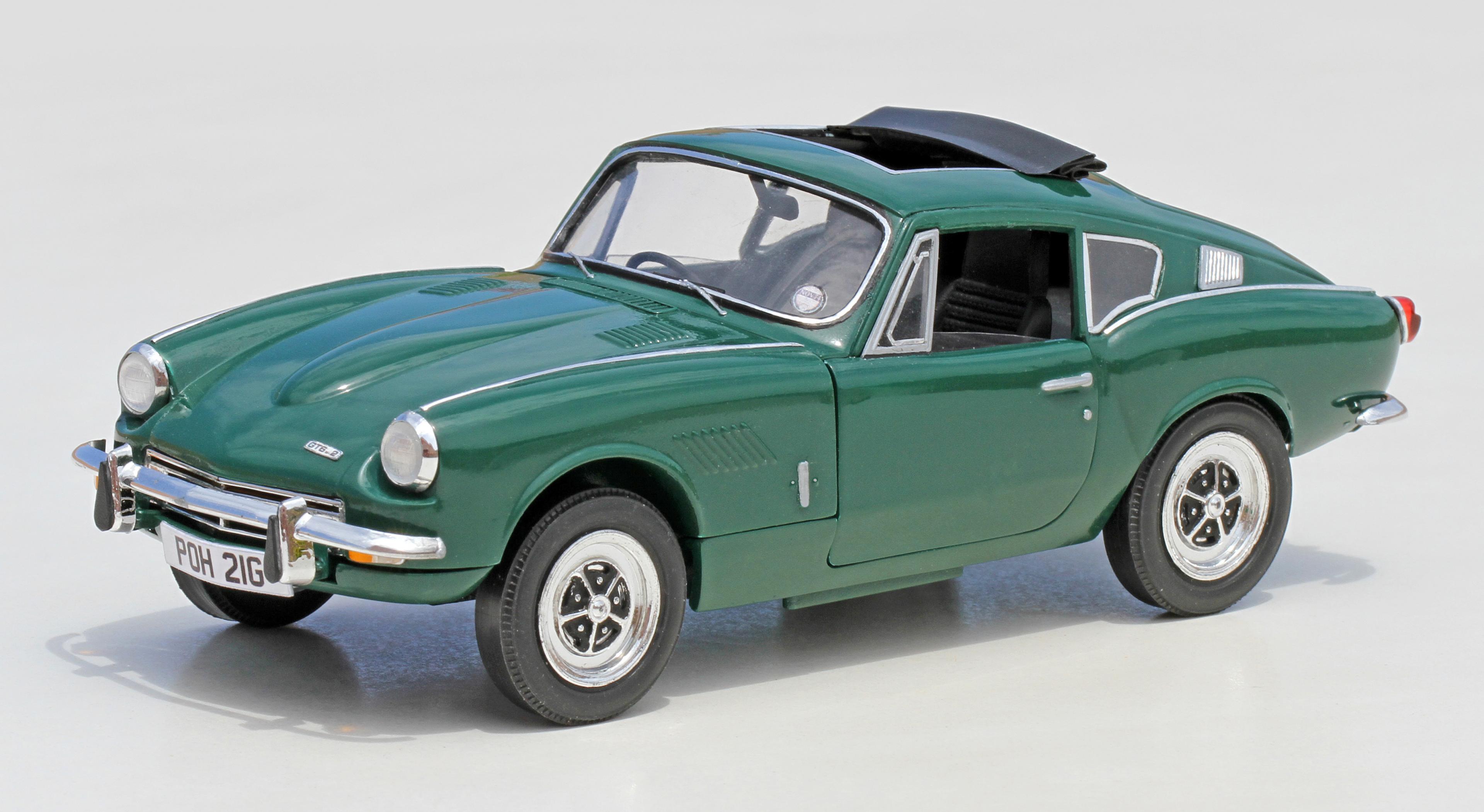

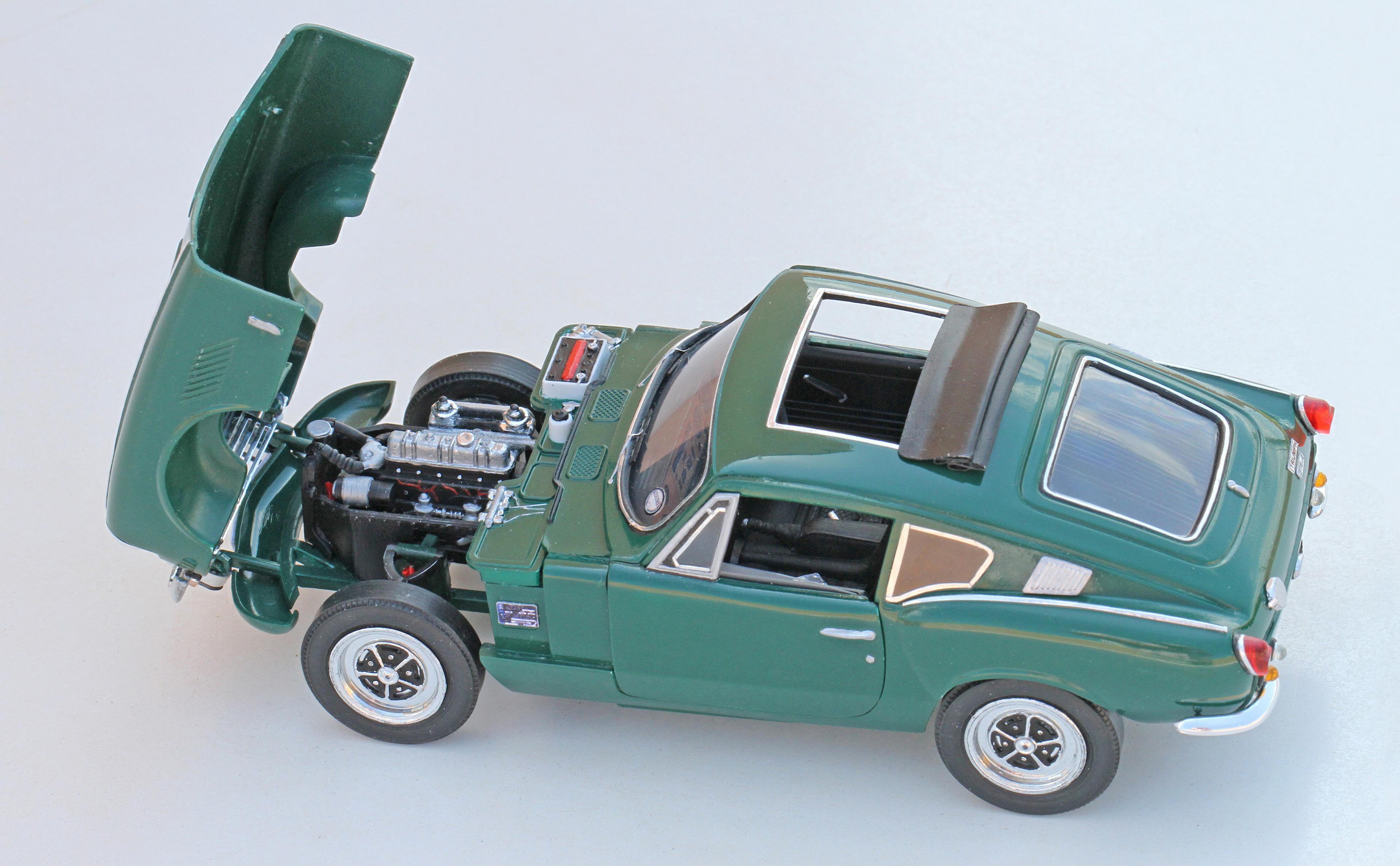

GT Clive Posted July 8, 2021 Posted July 8, 2021 I built a couple of car scale models going way back, but now as an old man in retirement I decided to have a serious attempt to build a scale model of a 1969 Triumph GT6 Mk2 which I owned in the UK from 1974-1977 finished in Triumph Conifer Green with Overdrive and a Webasto vinyl sunroof. When I bought the car, it had the original steel wheels with stainless steel trims (like those in the Lindberg kit) which I replaced later with Cosmic alloy wheels. It is a rare car, there were only 12,066 of the Mk2 built. The only model option I could find was the Lindberg kit which I had to order from the US. It was a difficult build, I had to make changes as already described in this thread, enlarged windscreen aperture, narrower door pillars and enlarged door quarter light apertures, reshape the rear quarter windows. I modified it to RH drive with authentic dashboard. I removed the side wing indicators which were not on the UK cars, and the american-style? rear number plate “box”. I also removed the rear lights and hand made all the lights from broken red, orange and clear plastic bits that I found from road accidents. I cut out the sunroof hole and scratch-built 2 versions of the vinyl roof, open and closed. Below is a 1977 photo of my original car, and my model pics. 1 2
oldrevellfan Posted July 8, 2021 Posted July 8, 2021 Nicely done ! I think it is the first time I see one finished...
Gramps46 Posted July 8, 2021 Posted July 8, 2021 Really came out well with all your authentic touches, especially the windshield and sun roof. Thank you for sharing it.
hct728(Bob) Posted July 9, 2021 Posted July 9, 2021 Wow, that's about as good as it can be! Love the sunroof, I did an open one on my 1980 Honda Accord model, but you did it both open and closed, kudos! So nice to see a difficult kit get some love!
dbostream Posted July 9, 2021 Posted July 9, 2021 19 hours ago, oldrevellfan said: Nicely done ! I think it is the first time I see one finished... Same, most people probably gave up just like I did. Most frustrating kit I have ever owned.
GT Clive Posted July 9, 2021 Posted July 9, 2021 Thank you all for your kind comments. It certainly was a difficult kit! In fact, I wasn't happy with my first attempt. I made so many modifications to try to get the parts to fit properly. Then by chance I found an original Pyro kit on eBay, unstarted with all parts still on the sprues. So this is actually my second attempt. I could use all the hand made parts from the first attempt which saved me a lot of time.
GT Clive Posted July 9, 2021 Posted July 9, 2021 On 1/1/2018 at 3:06 PM, Snake45 said: I now see that the rear side window shape is wrong, too--upper corner is a sharp angle where it should be a curve. Should be a five-minute fix with round and flat files. (Looks like it might be a little small, too, which the shape-correction filing would fix. The roof might look better with that whole window filled in completely. Would give the thing a bit of a Ferrari-ish look. In high school, a friend of mine drove a silver MGB with an aftermarket fiberglass fastback roof of some kind. I always thought that roof made the car look just a teeny little bit like James Bond's Aston-Martin DB.5. I had a Mk1 Triumph Spitfire before the GT6 and added an aftermarket fibreglass fastback roof too. It was made by a company called Ashley. They used to say the GT6 was a poor man's E-type, so my Spitfire was maybe a poor man's GT6 !
1959scudetto Posted July 10, 2021 Posted July 10, 2021 On 7/8/2021 at 10:34 PM, Gramps46 said: Really came out well with all your authentic touches, especially the windshield and sun roof. Thank you for sharing it. Well done, Clive -it must have been a lot of work to lturn this kit into a replica that nice.
GT Clive Posted July 10, 2021 Posted July 10, 2021 On 7/24/2020 at 5:51 PM, Ace-Garageguy said: Thanks for posting that, sir. Most helpful. The more I look at the model, the more proportion errors I'm seeing (like the lower body may need about a scale .5" -1" sectioning job too, the height of the front fender over the wheel arch is wrong, etc.), but it's still doable. Sir, I'm not sure I understand your comment about the front fender height, but the drawing shows the Mk1, not the Mk2 (GT6+). The height of the front fender was raised on the Mk2, and the Lindberg kit is more or less correct in that respect. The same mod was done on the Spitfires too. Another visual aspect of the Mk2 was the addition of a ventilation grille in the front wings. Mechanically, a lower wishbone was added to the rear suspension to improve the dreaded "folding rear axle" of the earlier model which greatly improved the handling.
