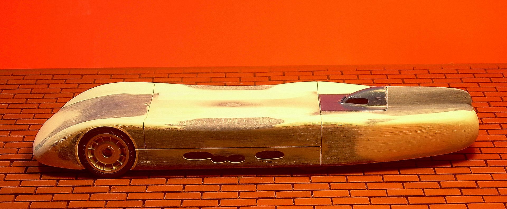

Ace-Garageguy Posted September 19, 2018 Posted September 19, 2018 6 minutes ago, Greg Myers said: What's the best / easiest way to make sure there will be no ghost lines when side trim is removed? As with most things in life, the "best" and the "easiest" tend to be mutually exclusive. Repeatedly priming and sanding is the only really effective way to do it with rattlecans, and eventually, the ghosting will stay down. It is, however, necessary to take precautions to prevent excessive film build in surrounding areas. Backtaping is strongly recommended. As usual, I speak from experience. This Olds hood was ghosting badly where the ornament had been removed. Multiple primer / sand / primer cycles cured it 100%, enough to be shot with hot Duplicolor color over soft late-model Revell plastic. If you have access to spray equipment, another sure-fire way is to shoot your work with a two-part catalyzed primer. It WILL kill any tendency for work to bleed through...but because of its extremely high-build characteristic, care must also be taken to avoid getting it on way too thick. This is a Nason urethane primer shot over extensive bodywork. Years later, zero ghosting.

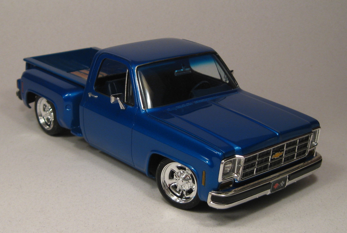

Can-Con Posted September 24, 2018 Posted September 24, 2018 Airbrushing on a solid coat of Zinzer "BIN" between a light coat of primer and color coats works for me. You can get the BIN in a spray can but it comes out very heavy. These two were painted with HOK laquer, no ghosting from removed trim or bodywork , and there was extensive body work.
