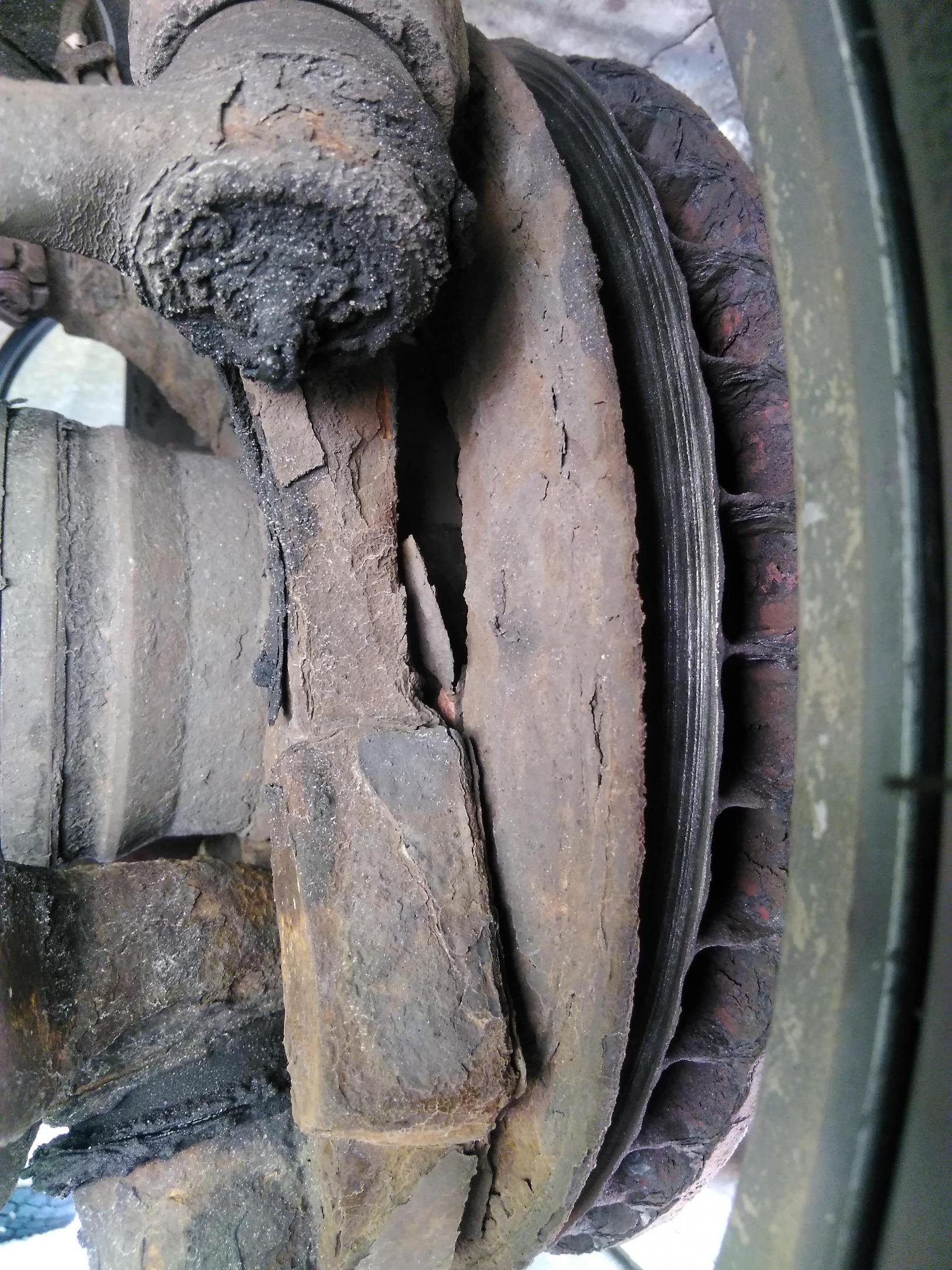

stinkybritches Posted June 27, 2020 Posted June 27, 2020 6 hours ago, PierreR89 said: Had my suburban inspected during the yearly mandatory inspection here 2-3 weeks ago and have driven less then 2000km,s (1200miles) since then and for some reason i decided to check how the brakes looked like. Mostly highwaymiles where the speedlimit is 120km/h (74mph) and i usually hold 130km/h (80mph something) Here is the brakedisk on the driverside... I am going to show it to them and ask how they could miss that since it is really easy to see but that passed, instead they failed me on 2 rusted bodymounts that are no danger at all it they just fall off. But if this had exploded and locked up the wheel it would have sent me in the either the centerbarrier or oncomming traffic and at that speeds there is only one option for how it would have ended for me and the unlucky one that suddenly got 3500kg (7700lbs) of suburban aimed at them at 60-80mph... This is the second dangerous thing they have missed on any of my vehicles.. On my Jeep ZJ they missed that the upper left controlarm/trackbarmount was damaged by rust, i found out when it broke when i hit a pothole.. My bet is that the wheel was not removed when they checked the brakes. I've seen plenty of inspectors just shine a light through the wheel to see the rotor and thickness of the brake pads. They obviously cannot see the backside when they do this. Or they only checked one side of the vehicle. How was the rotor on the other side?
Ace-Garageguy Posted June 27, 2020 Posted June 27, 2020 5 hours ago, PierreR89 said: I do. Thats why i found it Kinda hard to understand why that didn't grind to beat all hell, sounding like you were chewing rocks with a front wheel, every time you stepped on the brake pedal. It has to have been crying for help for weeks to get that bad.

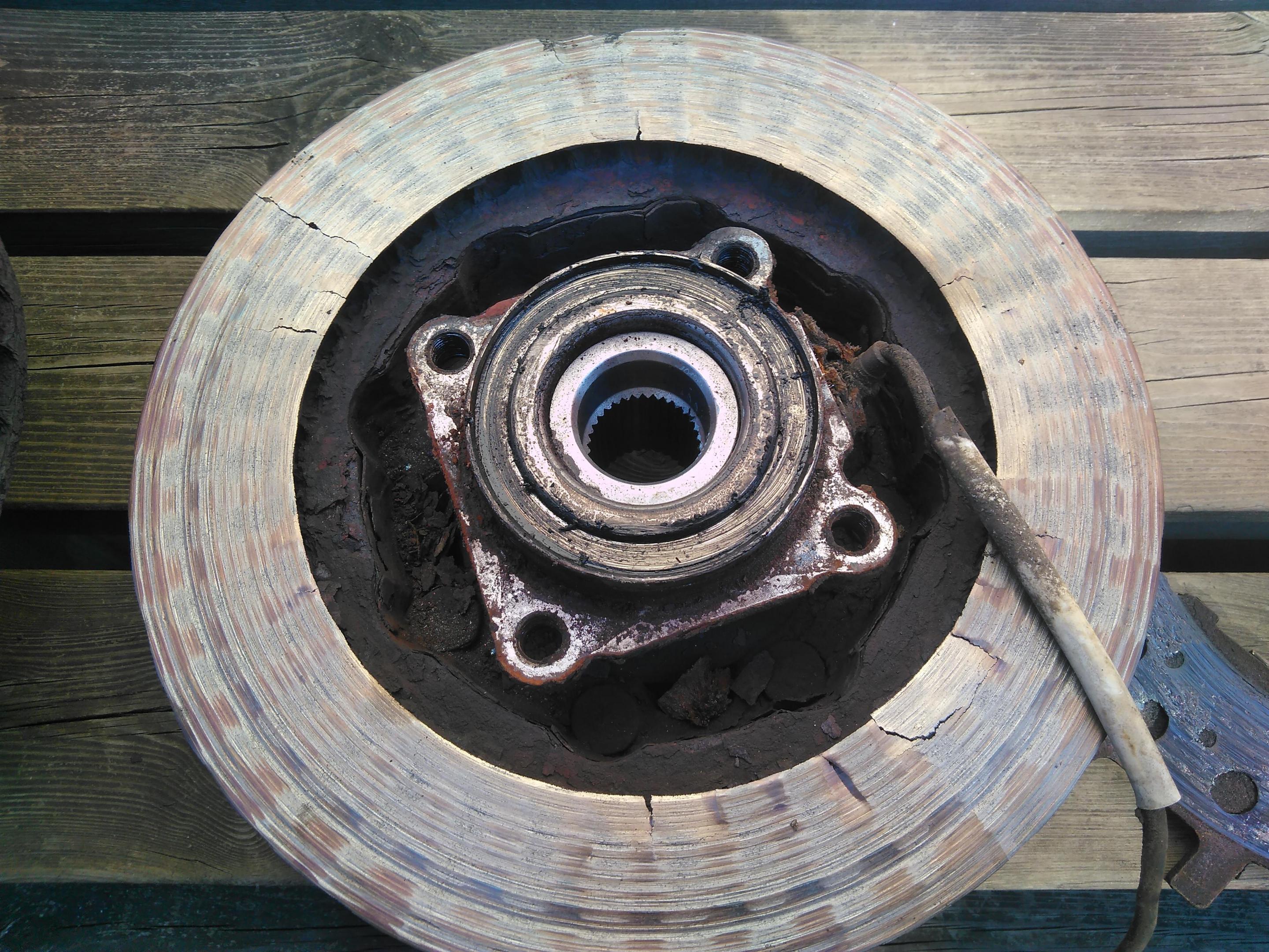

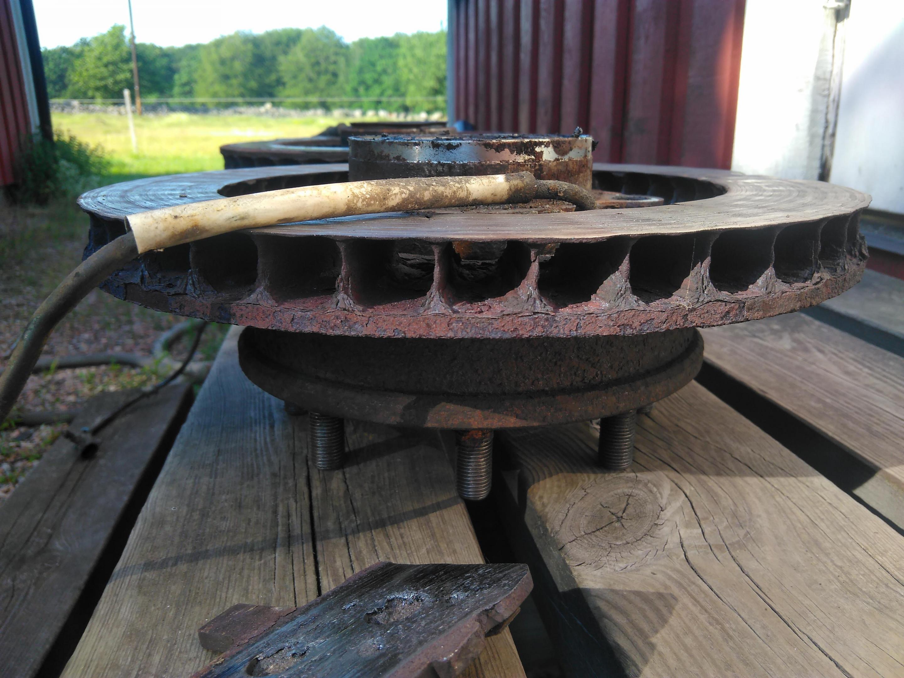

PierreR89 Posted June 27, 2020 Posted June 27, 2020 4 hours ago, espo said: The Rotor is toast and I'll bet your Caliper is as well. I notice greater wear on one side of the Rotor than the other. I'm surprised you didn't hear the Pads rubbing on the Rotor. Besides the cracks and parts of the Rotor that are about to break off, the center cooling vanes are all but rusted away. You might even consider providing information on your experience with this facility to what ever department oversees their work. Would seem obvious that they either are not qualified for the job or they just take your money and may not even do an inspection. As you pointed out any of these problem could have lead to a very bad accident and even bodily harm to anyone in the vehicle. Safety is the reason for these inspections in the first place and if you can't rely on the inspectors this defeats the inter reason for having inspections. The caliper is still good and both of them are about a year old and when i replaced them the disc was not bad or to worn down. 3 hours ago, stinkybritches said: My bet is that the wheel was not removed when they checked the brakes. I've seen plenty of inspectors just shine a light through the wheel to see the rotor and thickness of the brake pads. They obviously cannot see the backside when they do this. Or they only checked one side of the vehicle. How was the rotor on the other side? They never do here, they just check the brakes on a braketester to see if they are even and then a quick visual when they are under the vehicle and then maybee a quick glance when they are checking the wheelbearings. The rotor on the other side was good, still well within the minimum thickness. The friction material on the brakepad could have cracked and fell out so it was metal to metal after i had it inspected. 2 hours ago, Ace-Garageguy said: Kinda hard to understand why that didn't grind to beat all hell, sounding like you were chewing rocks with a front wheel, every time you stepped on the brake pedal. It has to have been crying for help for weeks to get that bad. I would probalby have noticed the sound if it had not been having squealing noices ever since i replaced the calipers and pads. Only thing i did noticed what that the brakepedal behaved like they do when the disc is warped. Even now with new discs, pads and bearings it still have squeling noises when i step on the brakes.

peteski Posted June 28, 2020 Posted June 28, 2020 On 6/27/2020 at 7:51 AM, PierreR89 said: I do. Thats why i found it But this worn brake rotor (and pads) should have been caught and replaced probably 3 inspections ago (either by you or the official inspector). I doubt that rotor got this thin in one year. I have never seen one so badly worn and rusted on an actively driven car. It is also worin unevenly so it likely means that the caliper is not "floating"properly and the inner pad is constantly dragging on the rotor (also decreasing your gas mileage).

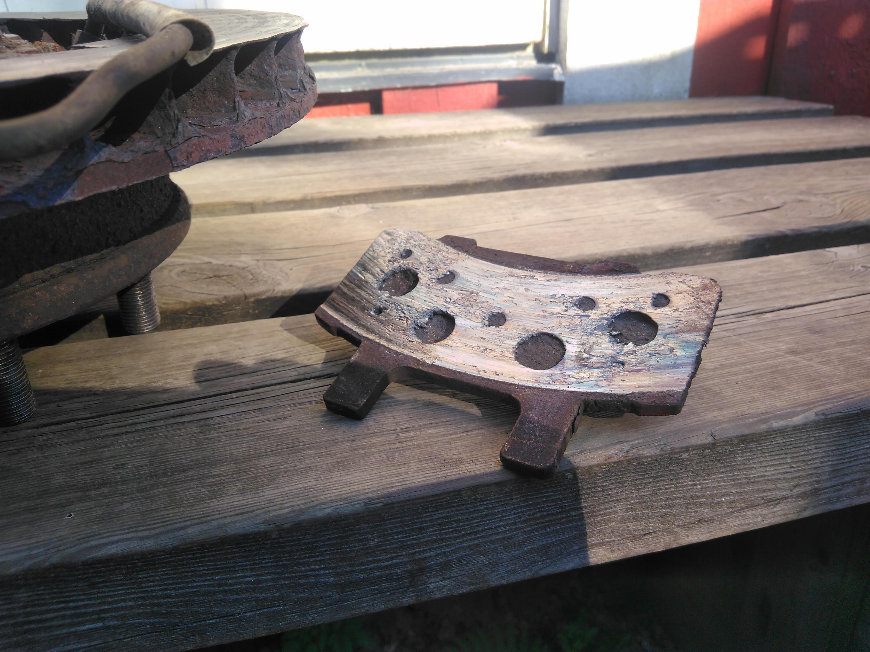

espo Posted June 28, 2020 Posted June 28, 2020 21 hours ago, PierreR89 said: The caliper is still good and both of them are about a year old and when i replaced them the disc was not bad or to worn down. They never do here, they just check the brakes on a braketester to see if they are even and then a quick visual when they are under the vehicle and then maybee a quick glance when they are checking the wheelbearings. The rotor on the other side was good, still well within the minimum thickness. The friction material on the brakepad could have cracked and fell out so it was metal to metal after i had it inspected. I would probalby have noticed the sound if it had not been having squealing noices ever since i replaced the calipers and pads. Only thing i did noticed what that the brakepedal behaved like they do when the disc is warped. Even now with new discs, pads and bearings it still have squeling noises when i step on the brakes. The reason that I thought the Calipers are bad is based on the way that the Rotor is worn so much more on one side. This is normally a sign that the pads on one side are not being applied as much as the other. I noticed the amount of rust damage to the different areas on the suspension and other parts. The channels that the Calipers move on can become contaminated and not allow both sides to clamp the Rotor with the same force. This can cause the one side of the Rotor to be worn much faster.
