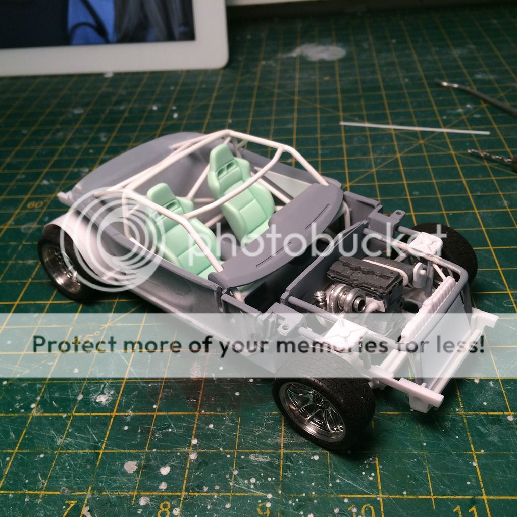

Impalow Posted February 19, 2016 Author Share Posted February 19, 2016 Thank you all for the kind words! Kind of a boring update here.. Rad mounts/intake work and my clearly scale seats arrived, they are awesome and very crisp and clean... lots of body clean up work in my future tonight. Quote Link to comment Share on other sites More sharing options...

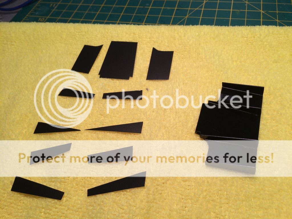

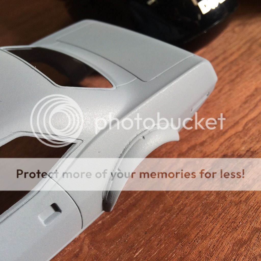

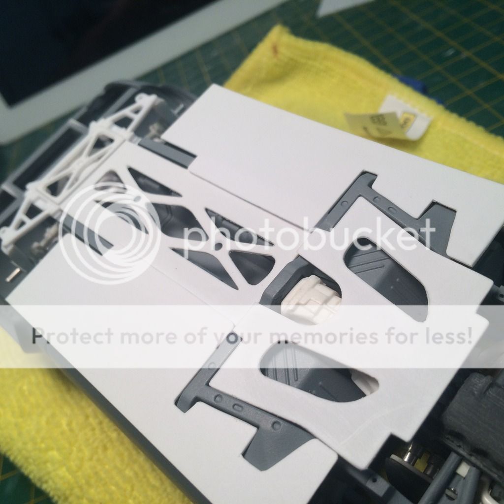

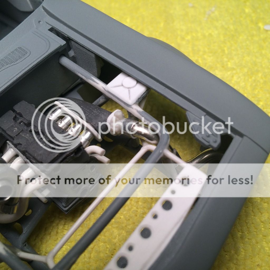

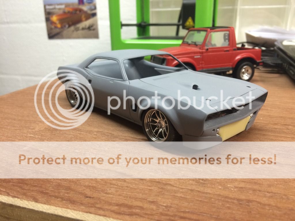

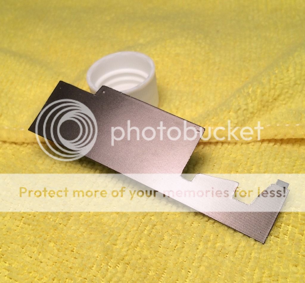

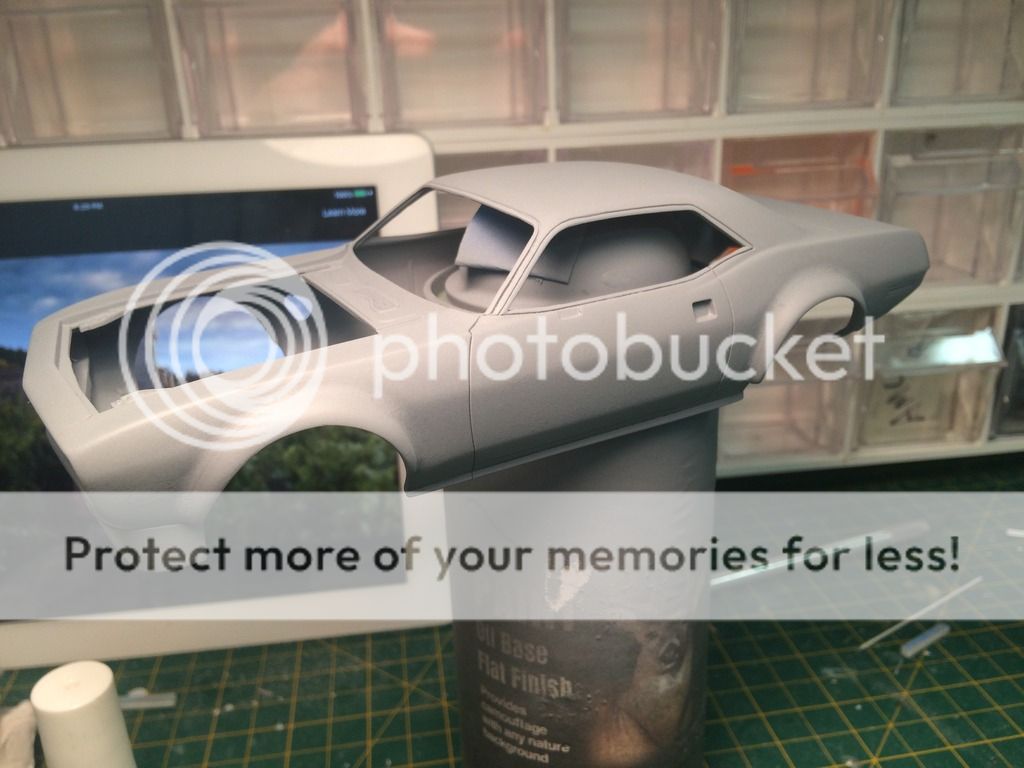

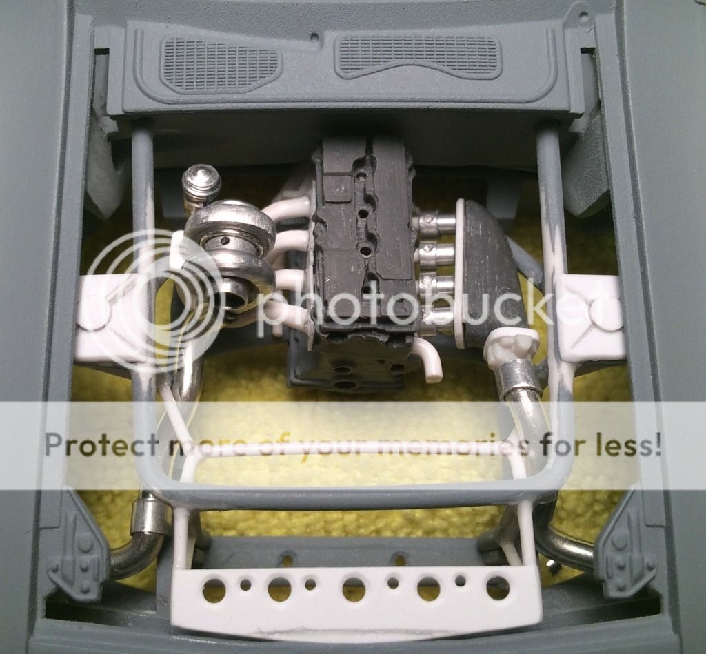

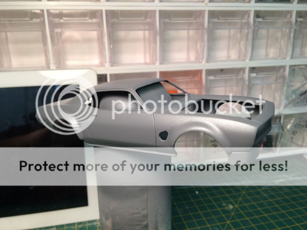

Impalow Posted February 26, 2016 Author Share Posted February 26, 2016 Thanks Mike! I'm still finishing up all the loose ends of fabrication on this bad boy.. Hoping to start slinging paint here pretty soon, the engine is about ready. Got some primer on the body and realized those flares didnt hug the body as nice as I expected: So after numerous attempts to fix them in different ways. I just decided to mold them in. This wasn't my first choice, but now that I see it, I like it better : In the downtime of the bodywork, I worked out the Radiator shrouding and mounting. Sourced a starter and throttlebody from an AMT Viper parts kit: The same Viper kit sacrificed its half shafts (just test fit, they will sit properly): . I picked up a Crazy Modeler Ferrari FXX detail set, basically just for the seat belts, tow hook and thinking I could use the other pieces somewhere eventually. The quality of the etching is very very very nice (arguably the nicest I have seen) . I couldn't not use those woven mesh panels so I used my cutter to recreate some of the belly panels. The front one will have the mesh inserts to let some engine compartment heat out, and not let gravel in during off track excursions: Quote Link to comment Share on other sites More sharing options...

Lowlife ! ! Posted February 26, 2016 Share Posted February 26, 2016 (edited) Still doing a great job Eric, its amazing how good the parts look that your making ! And I'm glad you molded in the arches, so much better than the bolt on ones !! Keep it up mate im looking forward to seeing it in colour ! Edited February 26, 2016 by Lowlife ! ! Quote Link to comment Share on other sites More sharing options...

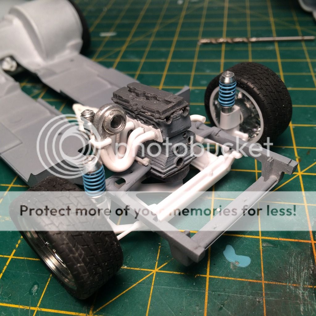

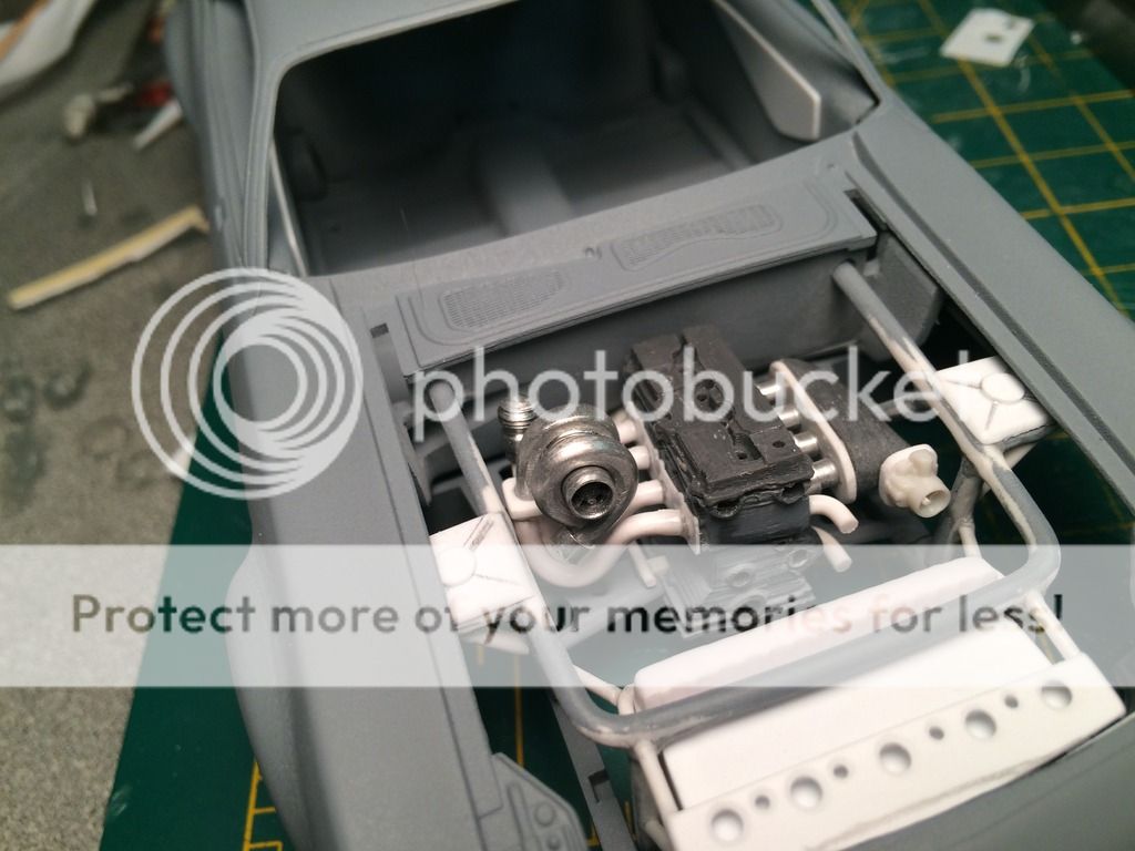

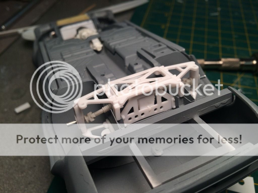

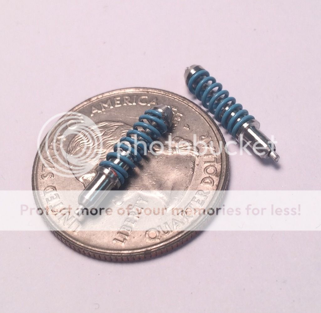

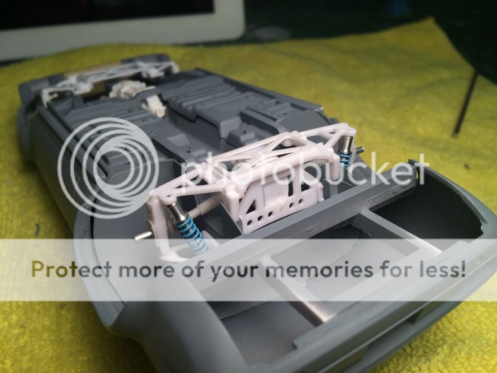

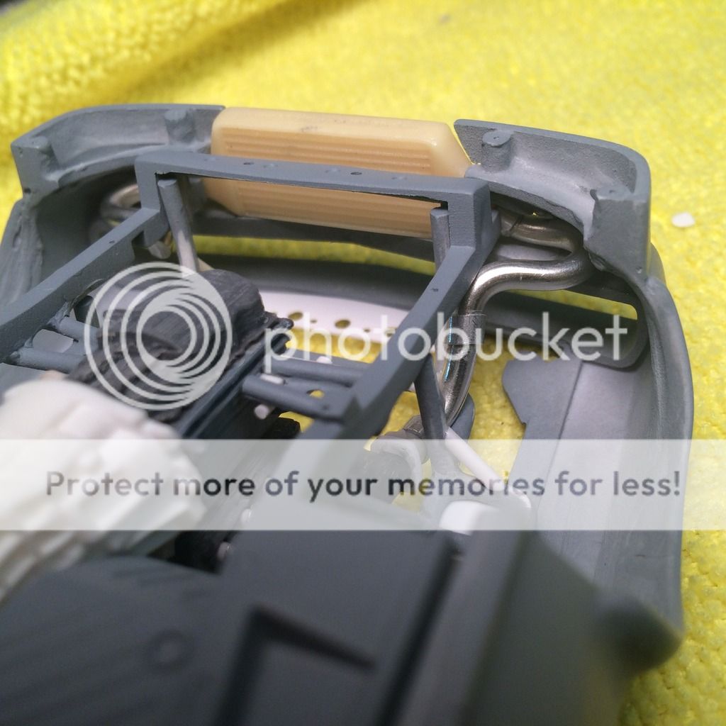

Impalow Posted February 29, 2016 Author Share Posted February 29, 2016 Thank you guys!... A little weekend update, I think I am 2 sway-bars and a chassis filler panel away from pulling this thing all apart and starting final cleanup and painting! Woohoo! I tackled the intercooler piping which was intense... but turned out pretty good. Then more fun lathe time making the rear coilovers and the front struts: Quote Link to comment Share on other sites More sharing options...

Kustom Rodder Posted March 1, 2016 Share Posted March 1, 2016 Coil overs turned out really nice getting closer to spraying some color. Quote Link to comment Share on other sites More sharing options...
crazyrichard Posted March 1, 2016 Share Posted March 1, 2016 (edited) man this is stunning !!!! the coilovers are nom nom nomoh and i like the weel arches way more now that they are molded onto the body , really nice ... before it kind of got that import feel with the flares with bolts .. now it really looks way more musscle racecar Edited March 1, 2016 by crazyrichard Quote Link to comment Share on other sites More sharing options...
geemoney Posted March 1, 2016 Share Posted March 1, 2016 beautiful!is the spring wire plastic coated? again...beautiful Quote Link to comment Share on other sites More sharing options...

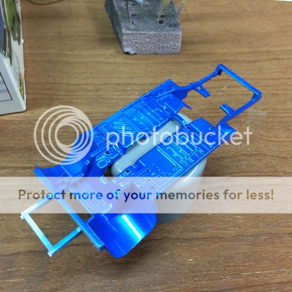

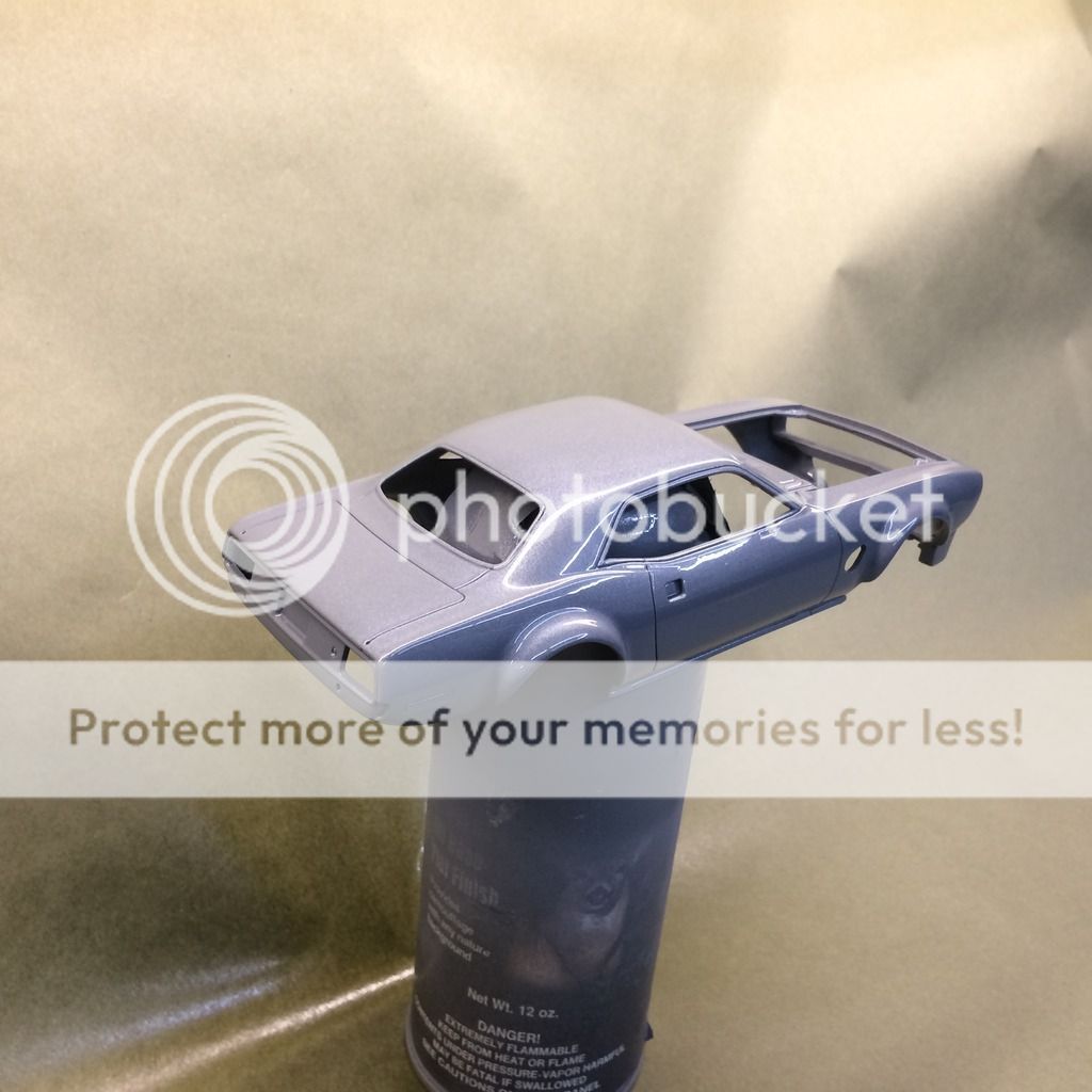

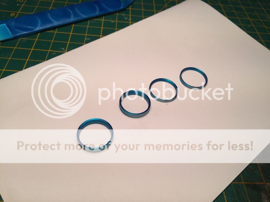

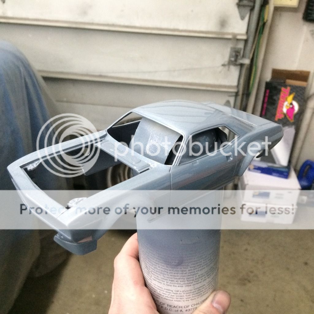

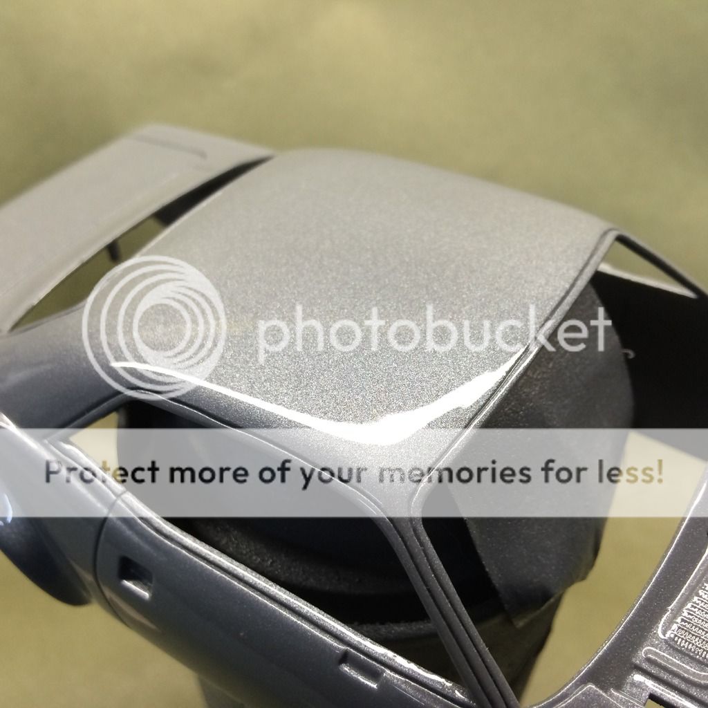

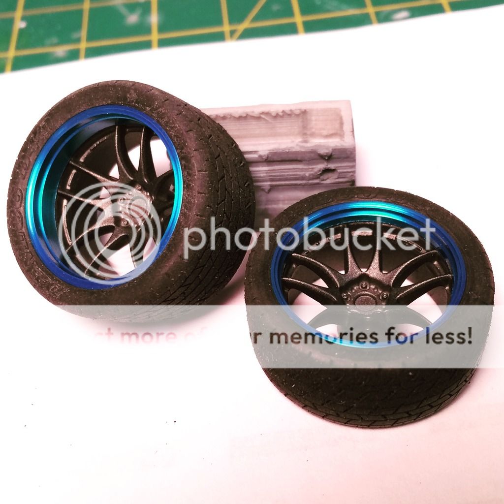

Impalow Posted March 10, 2016 Author Share Posted March 10, 2016 Finally a big update with some color... I was on vacation the beginning of this week, and actually managed to get a lot done, although i didnt take as many photos as usual. But you will get the idea. First up was the wheels, stripped the chrome centers, painted the rims with tamiya transparent blue over the raw aluminum: Then got some basecoat on the body, Tamiya neutral gray with a custom white pearl dullcoat: and then some urethane clear!: Chassis got hit with some bright blue nailpolish and upol rattle can clear (bright i know, but its mostly covered): Paint-a-palooza 2016: Quote Link to comment Share on other sites More sharing options...

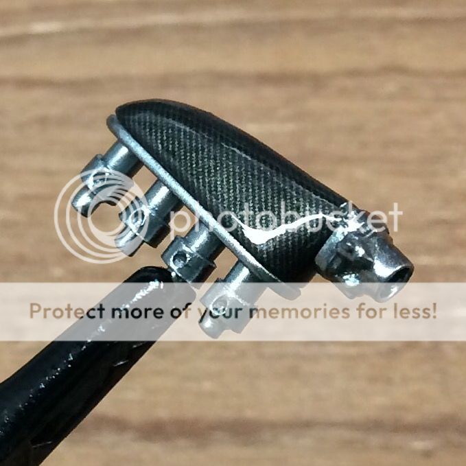

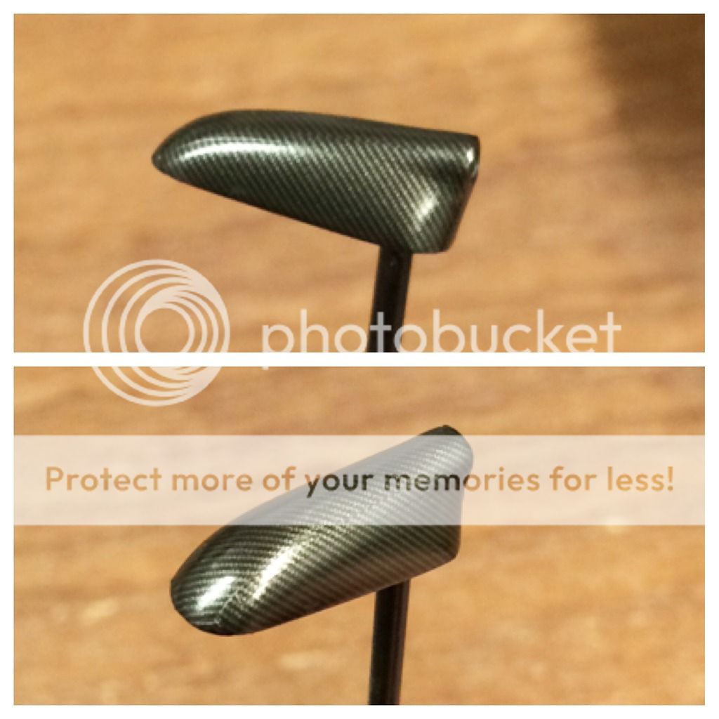

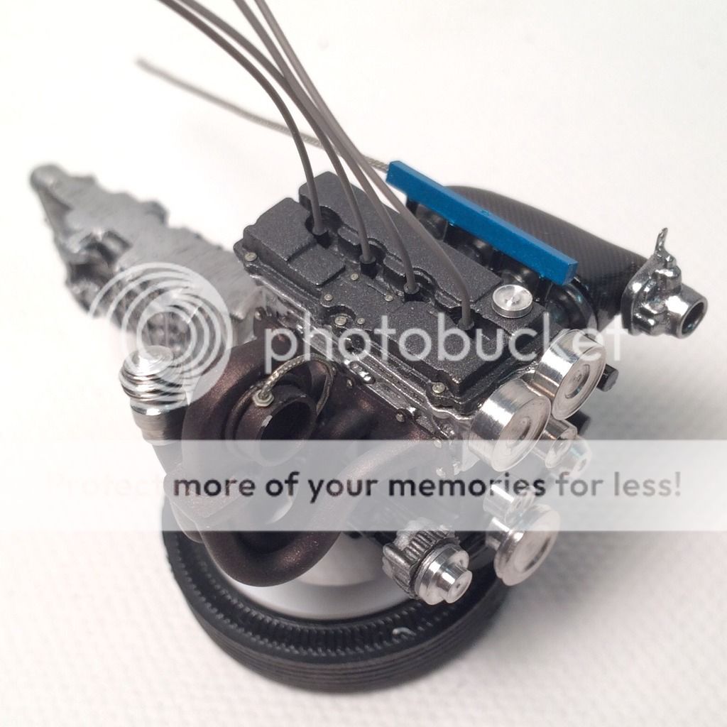

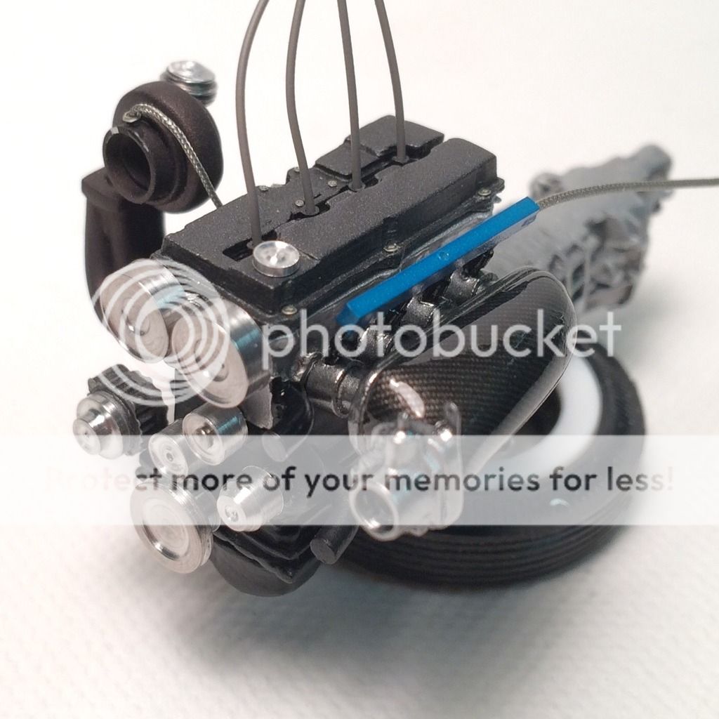

Impalow Posted March 10, 2016 Author Share Posted March 10, 2016 (edited) Now bring on the carbon fiber! the scale motorsports 1/24 scale twill weave on pewter to be exact, I usually hate decals, but i enjoyed working with these for the most part. Used almost an entire sheet on this car: Chassis Pan Intake Plenum Diffuser Then onto some engine assembly: Intake: and the whole thing.. minus belts and throttle linkage (the only kit parts here are the throttlebody, alternator, starter and transmission) Edited March 10, 2016 by Impalow Quote Link to comment Share on other sites More sharing options...

Kustom Rodder Posted March 10, 2016 Share Posted March 10, 2016 Lookin really good everything looks really good like the carbon fiber on the intake layed down really nice. Quote Link to comment Share on other sites More sharing options...

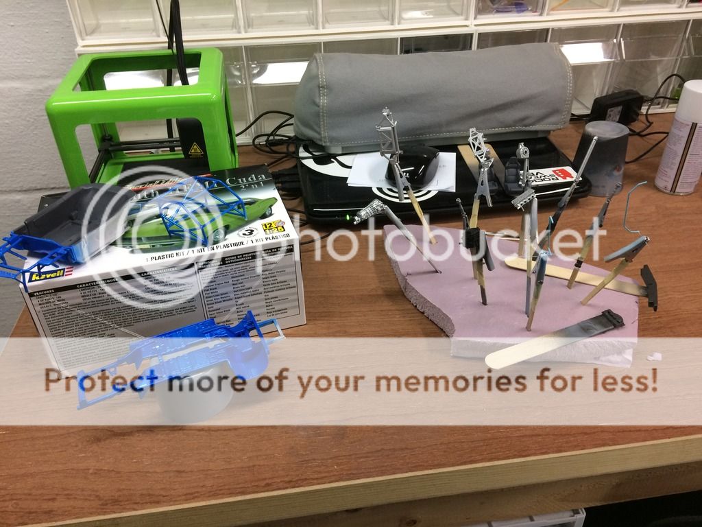

Belugawrx Posted March 10, 2016 Share Posted March 10, 2016 (edited) Loving this Eric! I didn't realize how small the lathe (no I think thats the silhouette cutter ?) and printer were,...fits really well on a bench top Edited March 10, 2016 by Belugawrx Quote Link to comment Share on other sites More sharing options...
