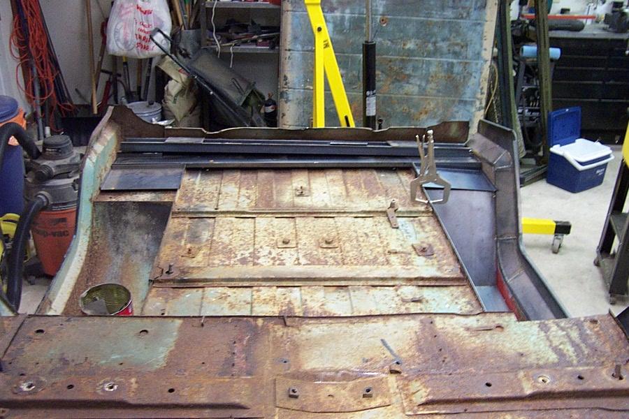

NOBLNG Posted June 15, 2020 Posted June 15, 2020 On 6/13/2020 at 8:53 PM, Tom Geiger said: Never leave we’ll enough alone! For the Jeepster pickup, the bed is flat with no detail but the real vehicle has ribs like this one. Then discovered the bed was too short, the way the kit was done. Take two was creating the bed liner the proper length from Evergreen ribbed sheet. I had done the beds in my Trabant and Dodge Caravan vans with this. Then I just wasn’t feeling it.. So I separated the bed from the cab and decided to add the length and do the proper ribs. The kit bed just doesn’t look right and has gaps so I’m pretty much building a box insert. So much for a quick easy project! Here is a pic of the original floor in my ‘71. It's of the underside, but you can see that there are six raised ribs, and the outer two are slightly wider than the rest.
Tom Geiger Posted June 15, 2020 Posted June 15, 2020 15 minutes ago, NOBLNG said: Here is a pic of the original floor in my ‘71. It's of the underside, but you can see that there are six raised ribs, and the outer two are slightly wider than the rest. Thanks!

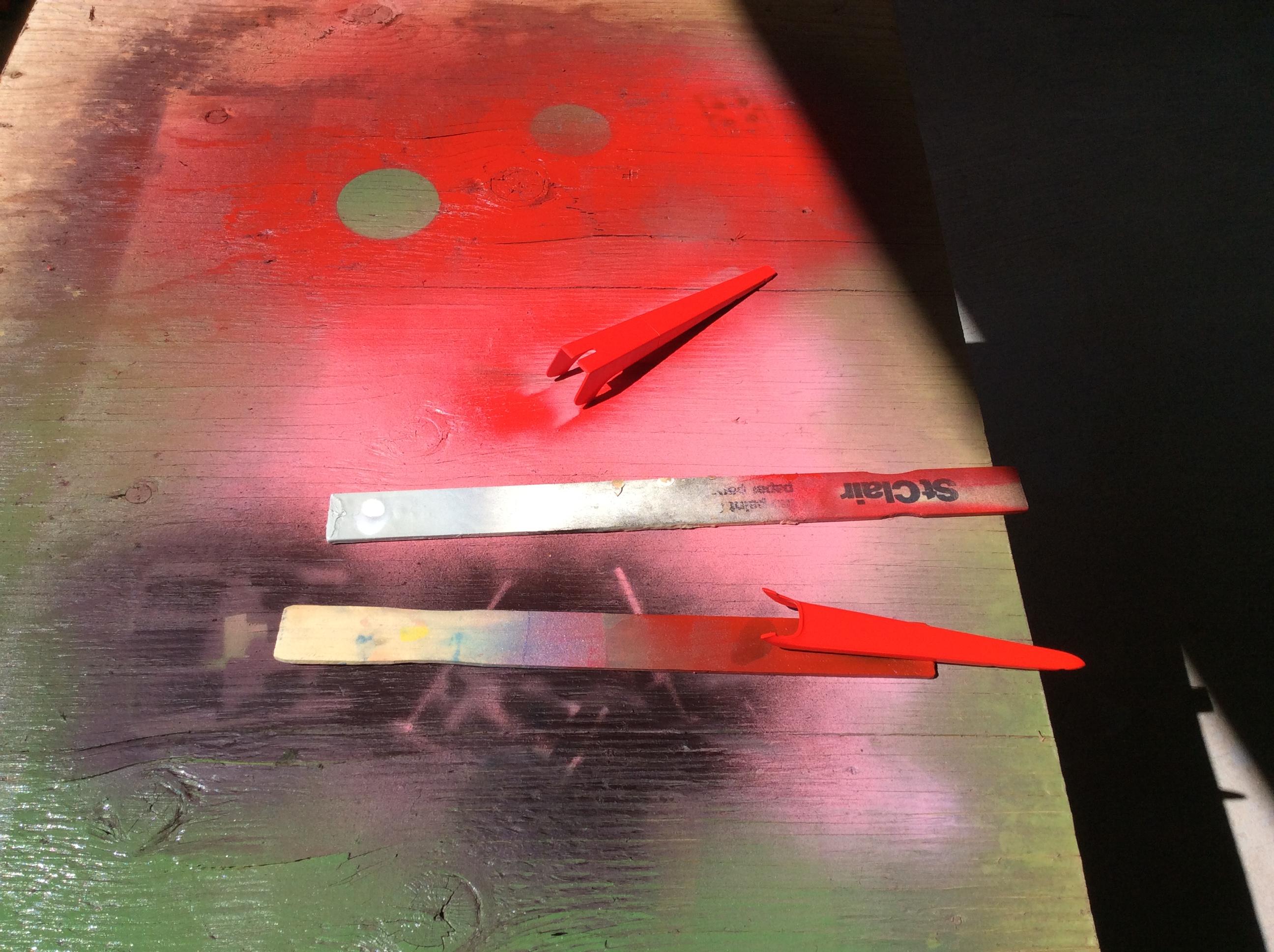

cobraman Posted June 15, 2020 Posted June 15, 2020 I managed to get BMF on the side trim on the resin 62 Ford I am working on. ( BMF is NOT one of my favorite things to do ) !
Modlbldr Posted June 15, 2020 Posted June 15, 2020 (edited) 4 hours ago, cobraman said: I managed to get BMF on the side trim on the resin 62 Ford I am working on. ( BMF is NOT one of my favorite things to do ) ! That was my chore for today too. Got the BMF done. I'll do the side window trim with Molotow. Later- Edited June 15, 2020 by Modlbldr

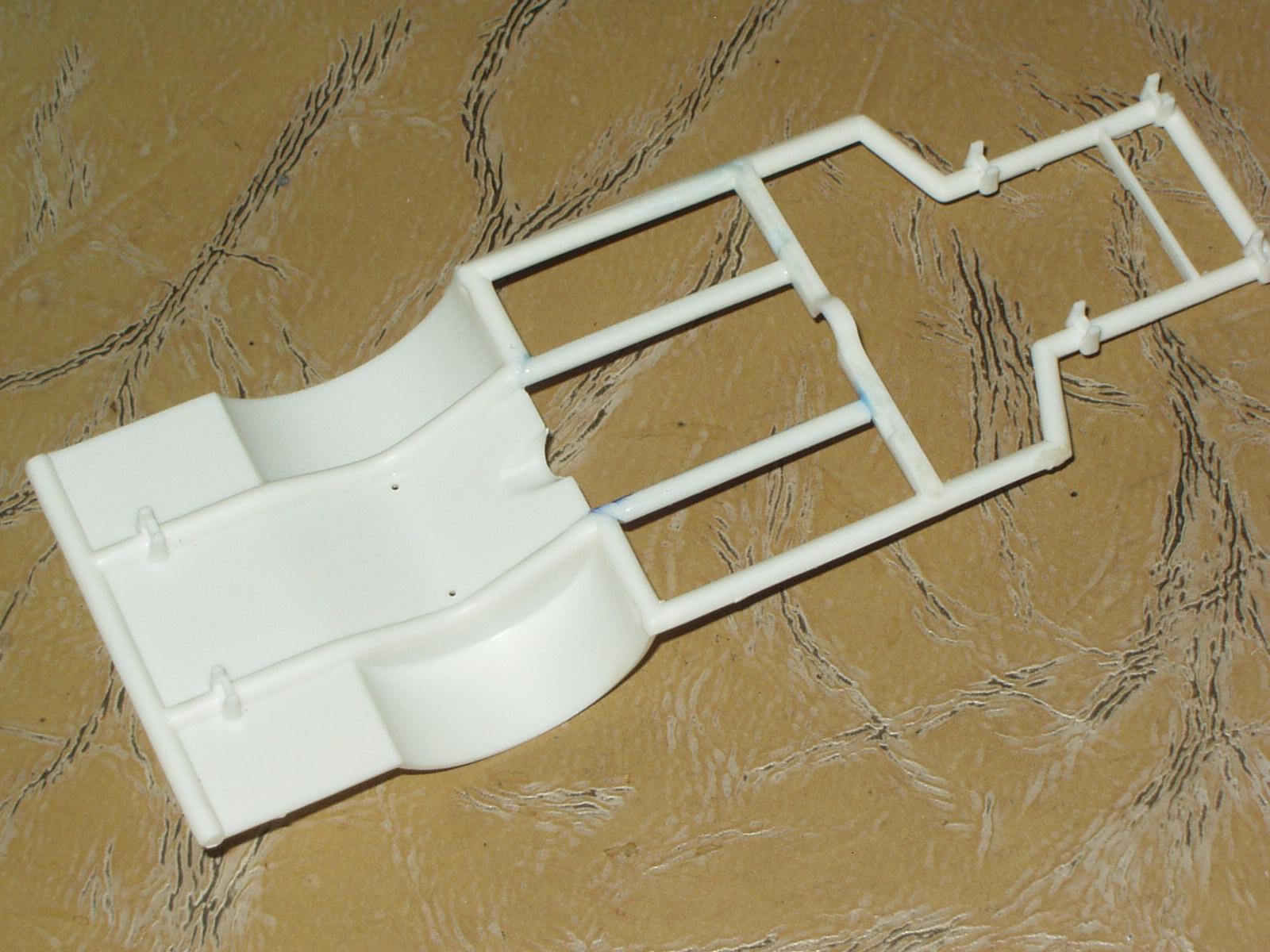

Snake45 Posted June 17, 2020 Author Posted June 17, 2020 Started on the frame for my '66 Mustang street freak. I'm using the frame from the AWB Comet, but the interior tub from the Mustang. This is a problem because the forward rear axle spring mounts are on the underside of the Comet's interior--there's nowhere to mount the springs on the frame itself. So I had to find some suitably sized sprue, trim it, fit it, and glue it into the frame. They're the two pieces that run to the mid-frame crossmember. Another job I've been dreading/putting off for a few weeks now, so with that done, the rest of the frame assembly should proceed smoothly. SHOULD.

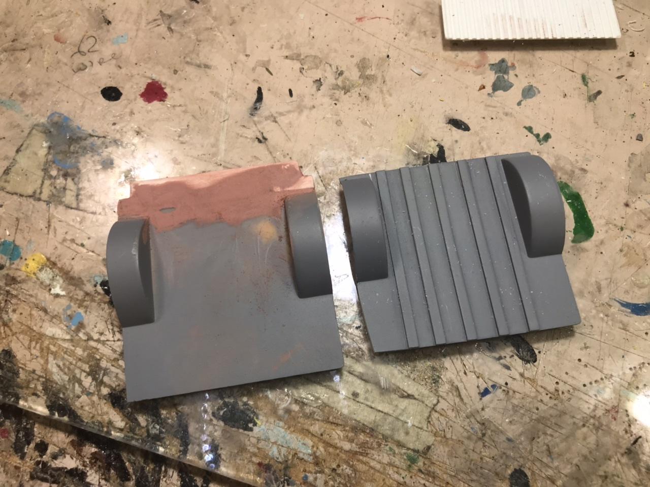

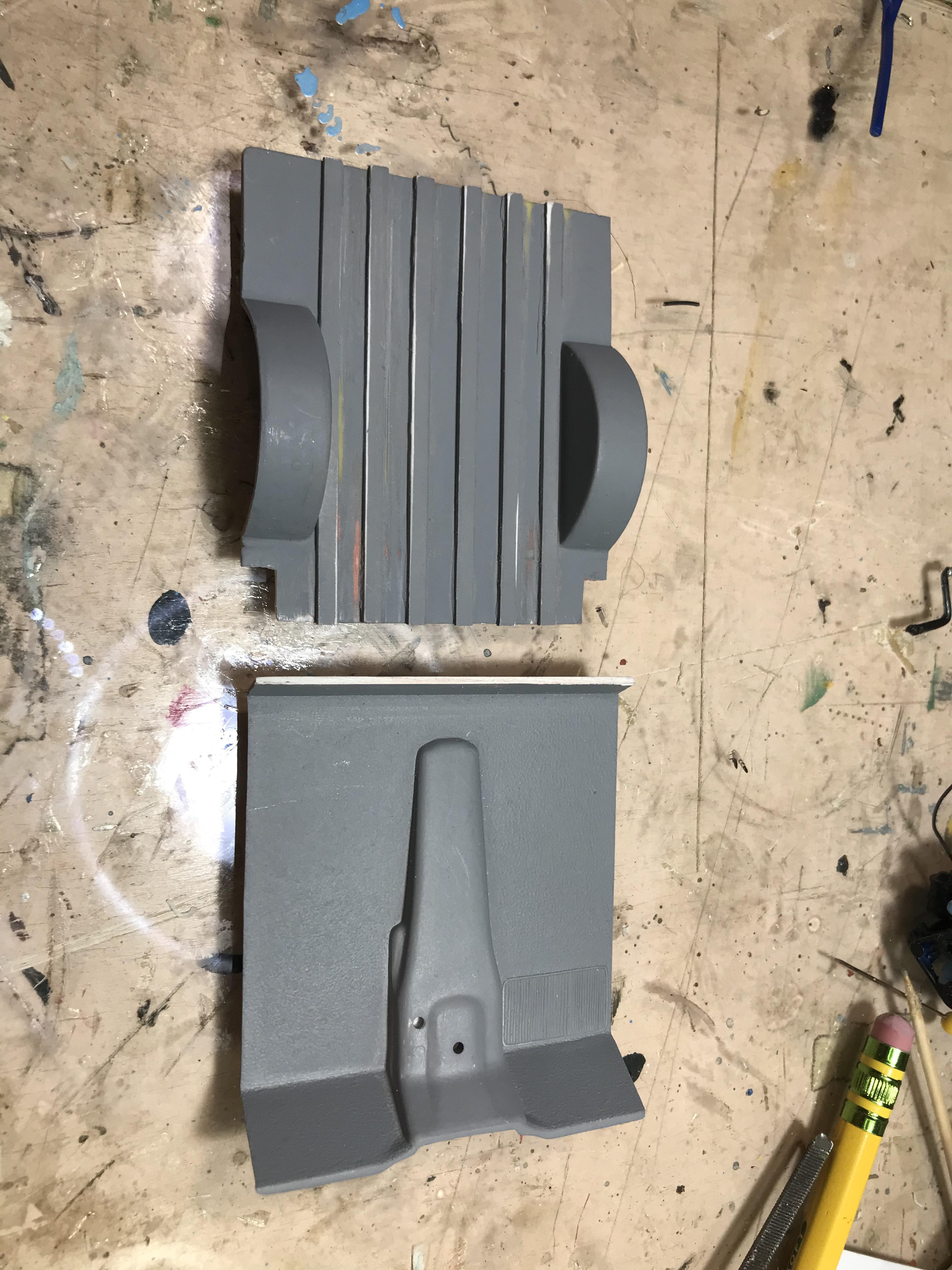

Tom Geiger Posted June 18, 2020 Posted June 18, 2020 With Noblng’s assistance regarding the number of ribs in the Jeepster bed, I added them today. Thanks again! One issue with this kit is a thin single side wall and poorly defined and poorly fitting bed. I have separated the bed from the interior floor so I can mold the bed into the body. That will allow me to seal all the gaps and then paint the body / bed as a unit, like a lot of pickup kits. Photo is mock up one of many..

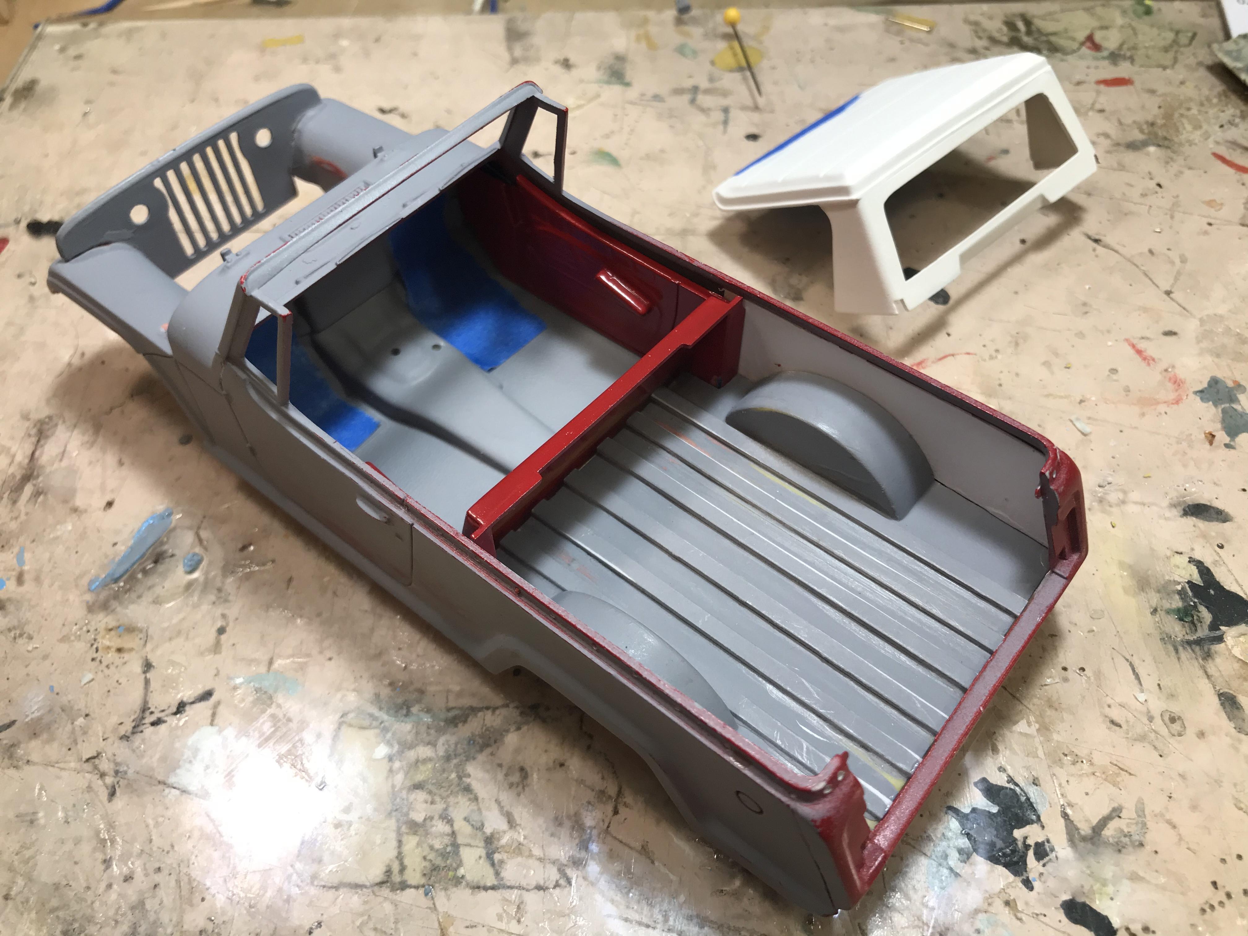

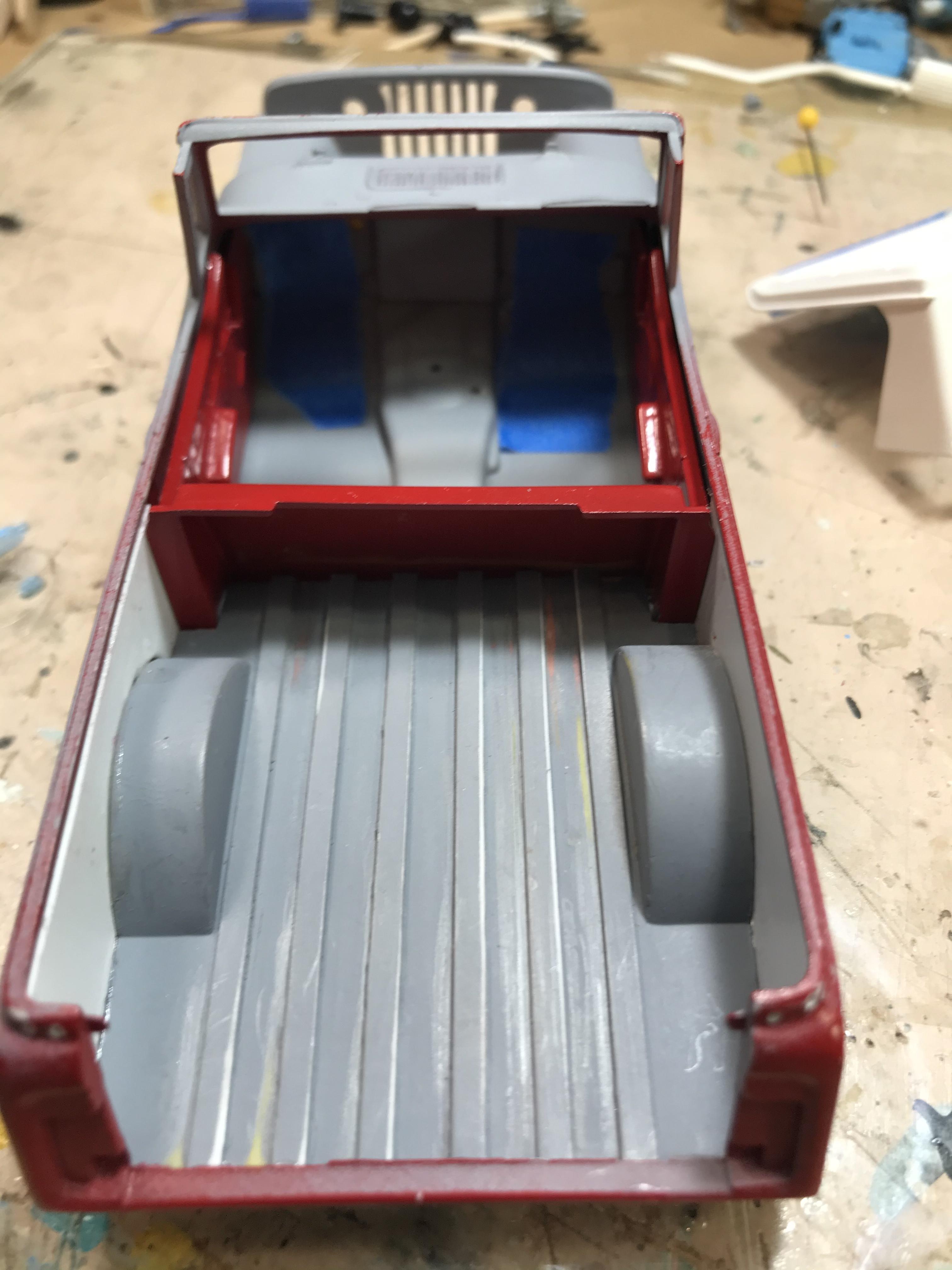

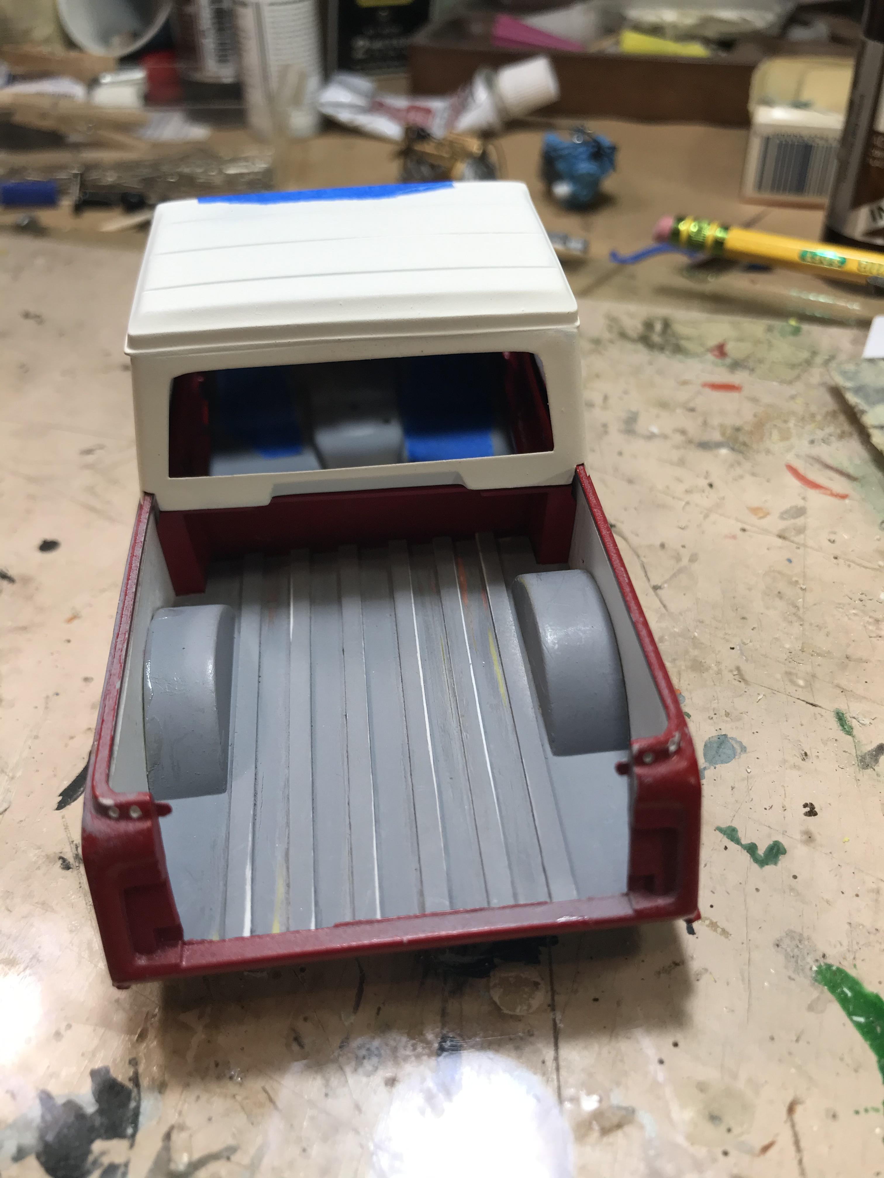

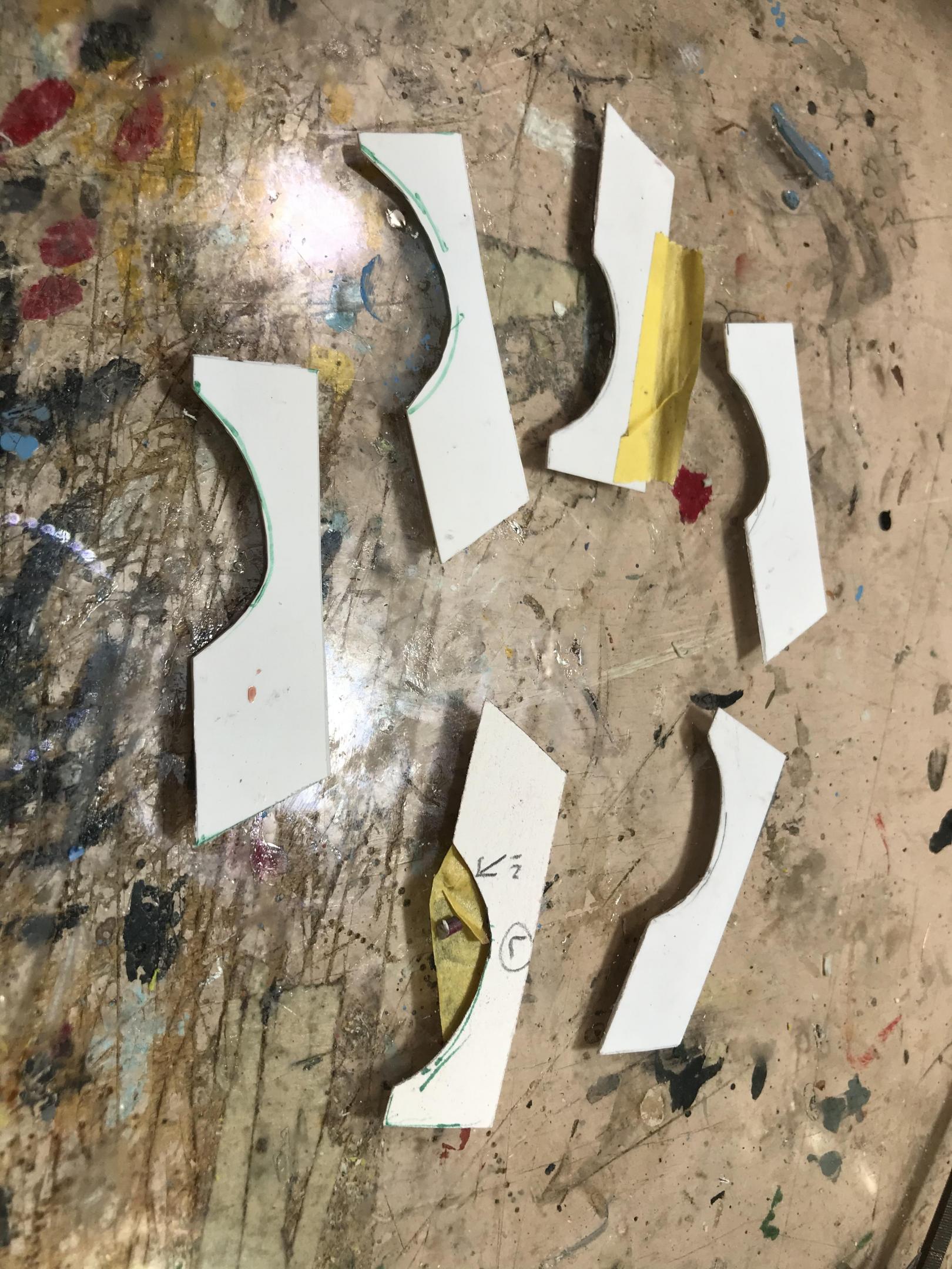

Tom Geiger Posted June 19, 2020 Posted June 19, 2020 (edited) Hey! The past two days have been fitting the bed into the Jeepster. I’ve done several takes on the bed sides, the beauty of sheet plastic, you aren’t ruining your one set of kit parts. The above photo are the losers, the final well fitting pieces are now glued to the body. As mentioned, I cut the bed and interior apart. The bed is now part of the body. The bed sides and bed itself, with the added ribs, are now glued into the body. Since this photo I have puttied in the edges and today will sand. Note that the interior is just mocked up with tape, including the bed front wall. It keys into the bed well. Another important fit is the cab roof to the cab back wall / bed front wall. I’m fiddling with that fit now. The bed was the thing that shelved this model some dozen years ago so I’m happy to have figured it out! And I realize in the time it’s taken me to fit this bed, there are folks who have built entire models! Edited June 19, 2020 by Tom Geiger

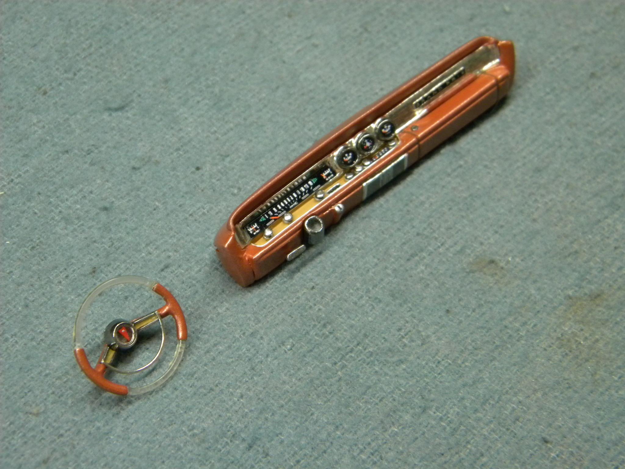

StevenGuthmiller Posted June 25, 2020 Posted June 25, 2020 Proudly, I've finished the dashboard and steering wheel for my '64 Pontiac Grand Prix project. Steve
mchook Posted June 25, 2020 Posted June 25, 2020 19 hours ago, StevenGuthmiller said: Proudly, I've finished the dashboard and steering wheel for my '64 Pontiac Grand Prix project. Steve WOW, that looks great!

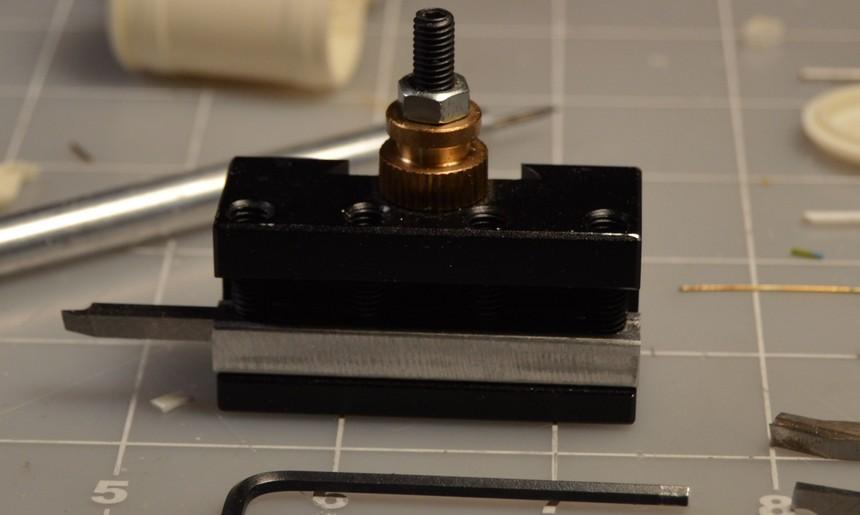

Straightliner59 Posted July 3, 2020 Posted July 3, 2020 I milled this holder for all these cool 1/8" lathe bits. I can tighten the last set screw to keep the holder in place, and serve as a stop for the bits. I used aluminum, because I didn't have any 1/4" steel, on hand. The aluminum should be fine, since you don't want to put too much pressure on a 1/8" bit, anyhoo...
