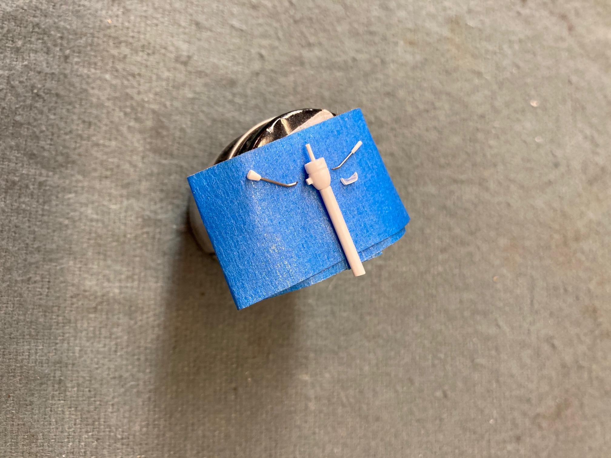

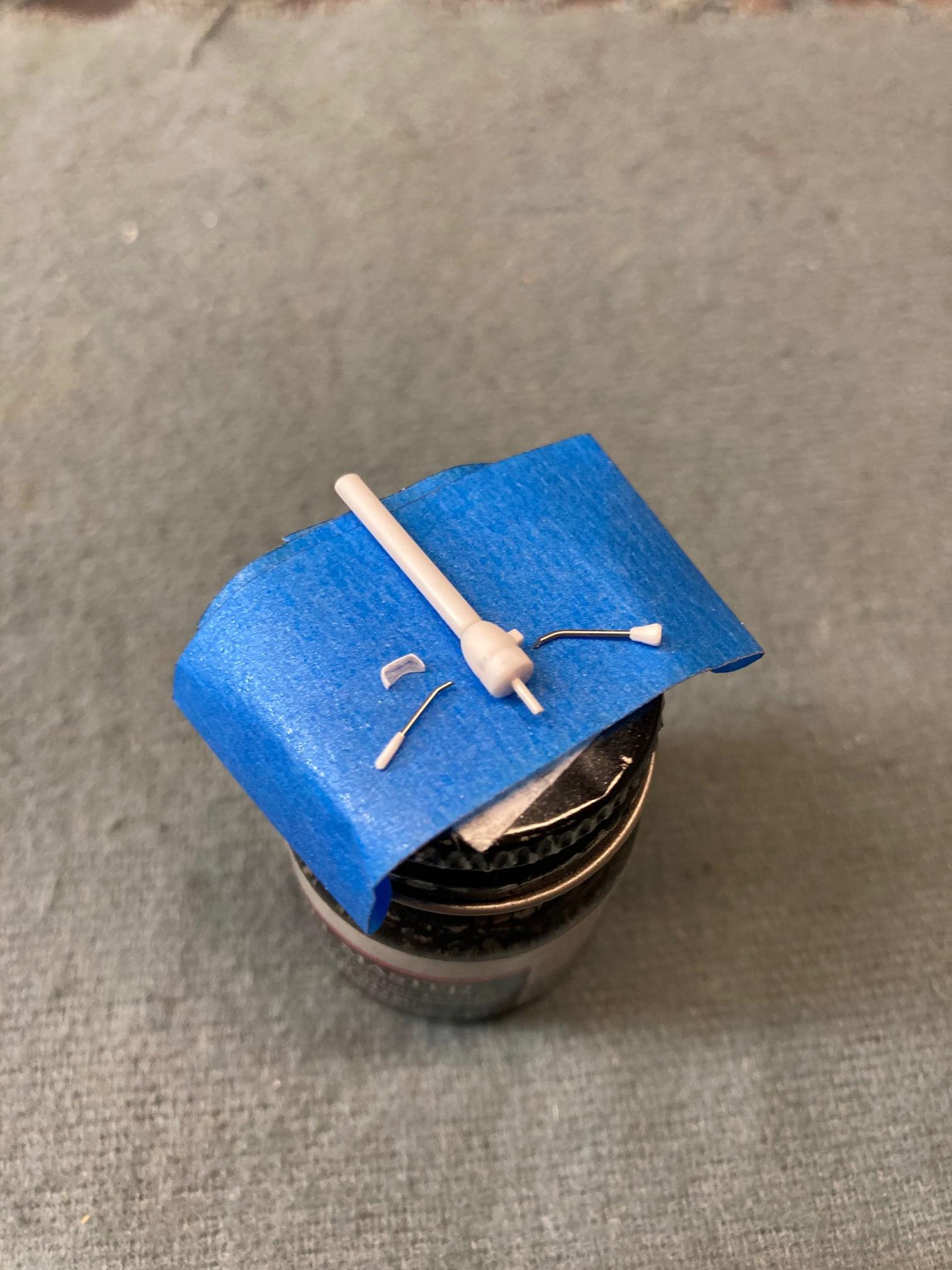

Dodge Driver Posted November 6, 2021 Share Posted November 6, 2021 On 7/8/2021 at 4:47 PM, StevenGuthmiller said: Steve Steve, I'm unaware how you created the levers, and more specifically the handles. Would you show us your method? I'm hoping to add levers to some columns going forward. Link to comment Share on other sites More sharing options...

StevenGuthmiller Posted November 6, 2021 Author Share Posted November 6, 2021 (edited) 7 hours ago, Dodge Driver said: Steve, I'm unaware how you created the levers, and more specifically the handles. Would you show us your method? I'm hoping to add levers to some columns going forward. Hi Frank. Of course, the levers themselves are nothing more than pieces of silver wire bent to shape. The thin knob on the blinker switch is just a piece of thin plastic rod, drilled on one end to accept the wire, and sanded round on the other. The knob on the gear selector is a little more involved, but still not difficult.......that is as long as you have good dexterity, and either great eyes or plenty of magnification. I started with a piece of rod in the correct diameter. Then I sanded the end of the rod to a point, or cone shape. Next, I took a small round file, and lightly filed around the upper portion of that cone to create a little bit of a concave cone shape, if you know what I mean. All of this is of course done while it's still attached to the rod. Next, I drilled out the thin end of the cone for for the wire. Finally, I sliced the knob from the rod right at the point where the cone meets the rod. Here's a little trick to use when continuing to work with extremely small parts such as this knob after it has been removed from the rod. Be sure that the small end is drilled before separating it from the rod, and then once cut off, slip the part back onto the drill bit with the bit still in the pin vice. This allows you to use the pin vice as a handle for finishing work on a very small part instead of trying to handle it with your fingers. Once the knob is separated, sand the end smooth, or a little convex, or as I did in this case, sand a small strip around the wide end of the knob flat for a little added detail. Sometimes it's a little difficult to give instructions for something like this with the written word Frank, but I hope I made it understood. Steve Edited November 6, 2021 by StevenGuthmiller Link to comment Share on other sites More sharing options...
Dodge Driver Posted November 6, 2021 Share Posted November 6, 2021 1 hour ago, StevenGuthmiller said: Sometimes it's a little difficult to give instructions for something like this with the written word Frank, but I hope I made it understood. Steve Crystal clear Steve. Thank you for the in depth explanation. It is greatly appreciated. 🙂 Link to comment Share on other sites More sharing options...
