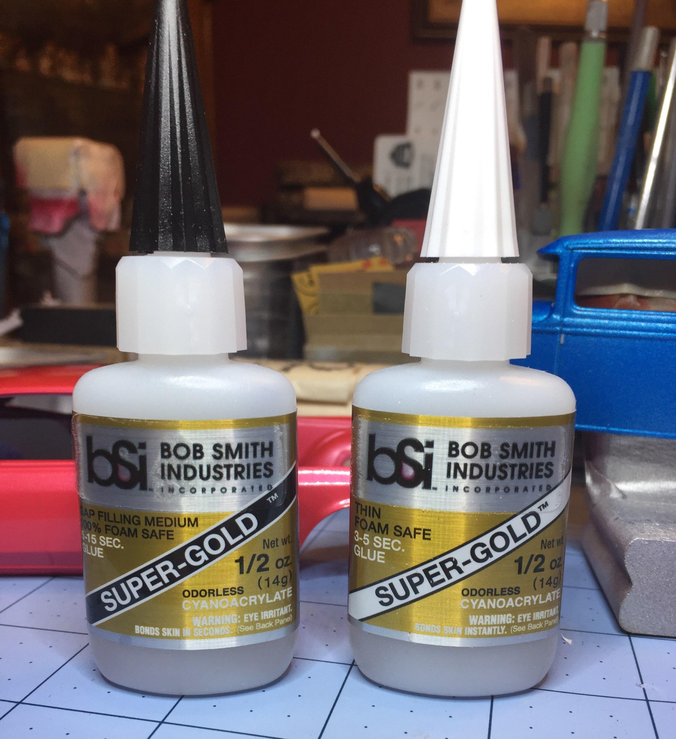

peteski Posted May 27 Share Posted May 27 (edited) 46 minutes ago, Leica007 said: I used to try super glue, but the fogging stopped that quick. One thing I did learn was a q-tip lightly soaked in alcohol would clean most or all the fog off the glass without harming it, then I used another q=tip to apply Novus clean & shine. Looked pretty good. Now I use plati-weld to tack in place and then canopy glue. BSI SUPER-GOLD+ (odorless) CA glue does not cause fogging. (yes, it is slightly more expensive than standard CA). Using BSI accelerator to quickly set any CA also prevents fogging (since the glue has no time to start evaporating). If the clear window is first dipped in Future (or whatever the current name is for that stuff) and will minimize plain CA fogging. I use both myself. Edited May 27 by peteski Quote Link to comment Share on other sites More sharing options...
