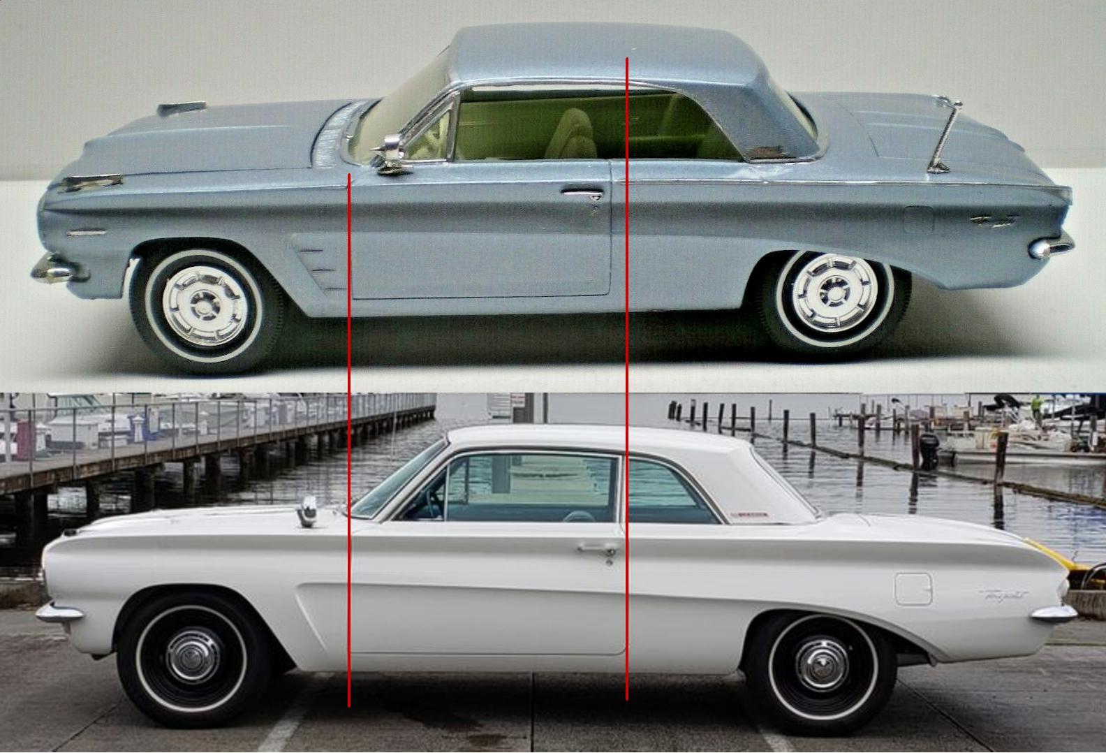

It's the original Tempest LeMans coupe body and chrome with the wheelbase altered and rear wheel wells modified, paired with a newer chassis and gutted interior. IIRC this version was first issued in 1967? -
