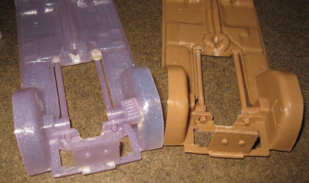

  11. Went down to Reynolds Advanced Materials in Broadview and picked up some clear casting rubber Monday afternoon; then started gathering up mostly obscure taillight lenses to copy in clear red. Top row - Hubley '61 Ford, Premier English Ford. Bottom: Jo-Han '62 Chrysler, Lindberg Ford Granada, Aurora Alfa Romeo. I'll add Hubley Renault Dauphine taillights to those. Below that, I got some assembly done on the Newport engines, made a quick cast of a Jo-Han firewall to get the correct details on the heater box and power brake setup, and ground off the incorrect details from the Revell firewalls (after adding a brace behind each). Then the other big job. This is how the tan car came, with warped/twisted torsion bars: So I cut off the ends of the stub axles and got the wheels off, then sawed through the glue on the torsion bar pockets and got the bars out. Cut the middle out of them and very very carefully drilled and reamed holes in the ends to fit a couple cut-down steel axles to get them down to the proper thickness, more or less. The file is just there to check alignment, and the lower crossmember was repaired and braced after engine removal broke it.
