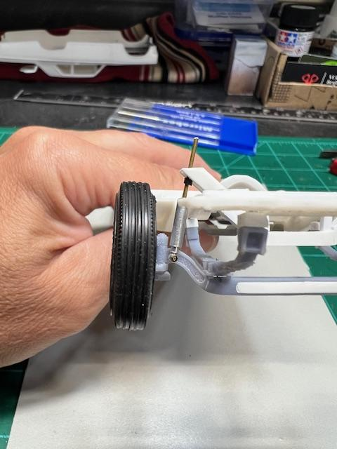

  12. Thanks, Roger! I started playing around with the "bent" injector stacks. I think it's going to look really cool!
  13. Appreciate that, Tony! Thanks!
  14. I appreciate that, Ian! I'm surprised I got it in one try!?
  15. I didn't realize it had been so long, since I updated this. I haven't done a whole lot. A lot of it has been adding stuff I never had any intention of adding, when I started this. I've somewhat limited myself, based on my initial intent to keep it a "quick and easy" project, without chassis detail, beyond what could be seen below the chassis, however...that starter/battery cable had to go somewhere!? I zip-tied the battery cable and the switch wire together, for a very short distance. Where I really got carried away doing something that will only matter, to me--I didn't want the master cylinder on the firewall, so I scratchbuilt one, and mounted it under the floor. To my way of thinking, explaining why there isn't a master cylinder on the firewall, isn't enough. I figured I had best have one, if I say I have one. Also did a bit of work on the driveline tunnel. I've also been working out the headers and the angled stacks (think Larson's Chevelle). No significant progress, yet, so no photos...yet. I think it's important to build and install the headers, now. Comments, critiques and questions are always welcomed. Thanks for looking!
