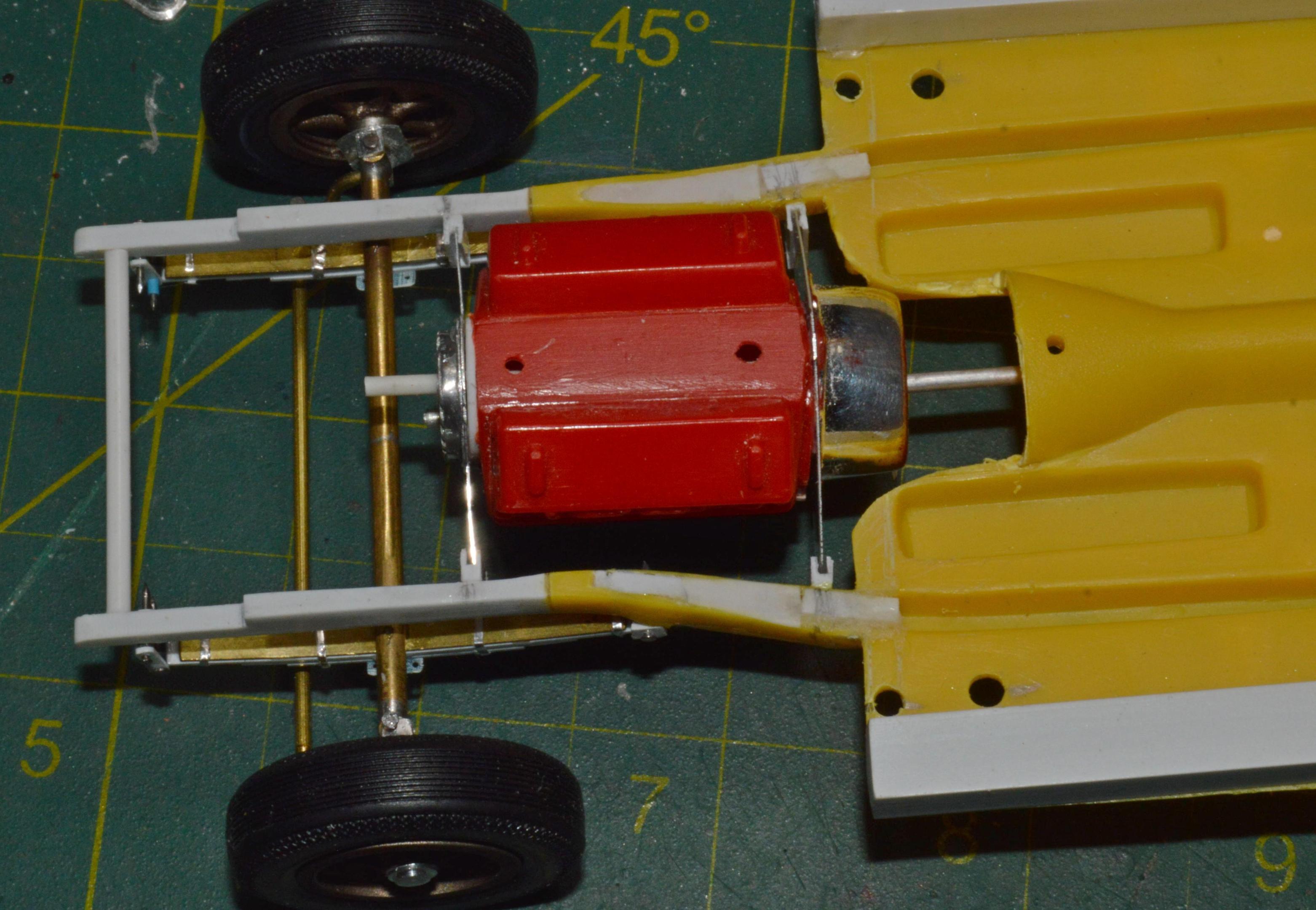

Finally got the motor mounts sorted out. Tacky-glued everything back together. Everything seems to be playing very nicely, together! Front shocks and mounts, next. Then after a couple of final items, I can take it apart one last time, and clean it all up and paint it. I think.? Comments and questions are always welcomed. Thanks for looking!
