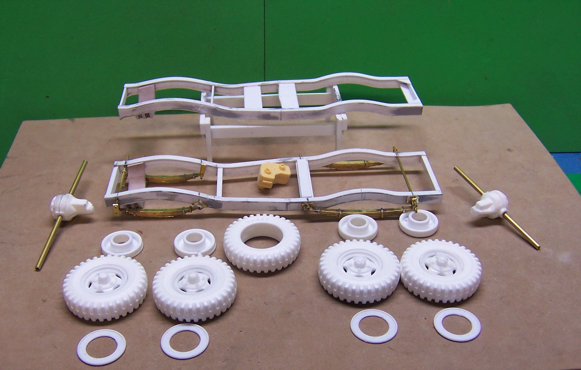

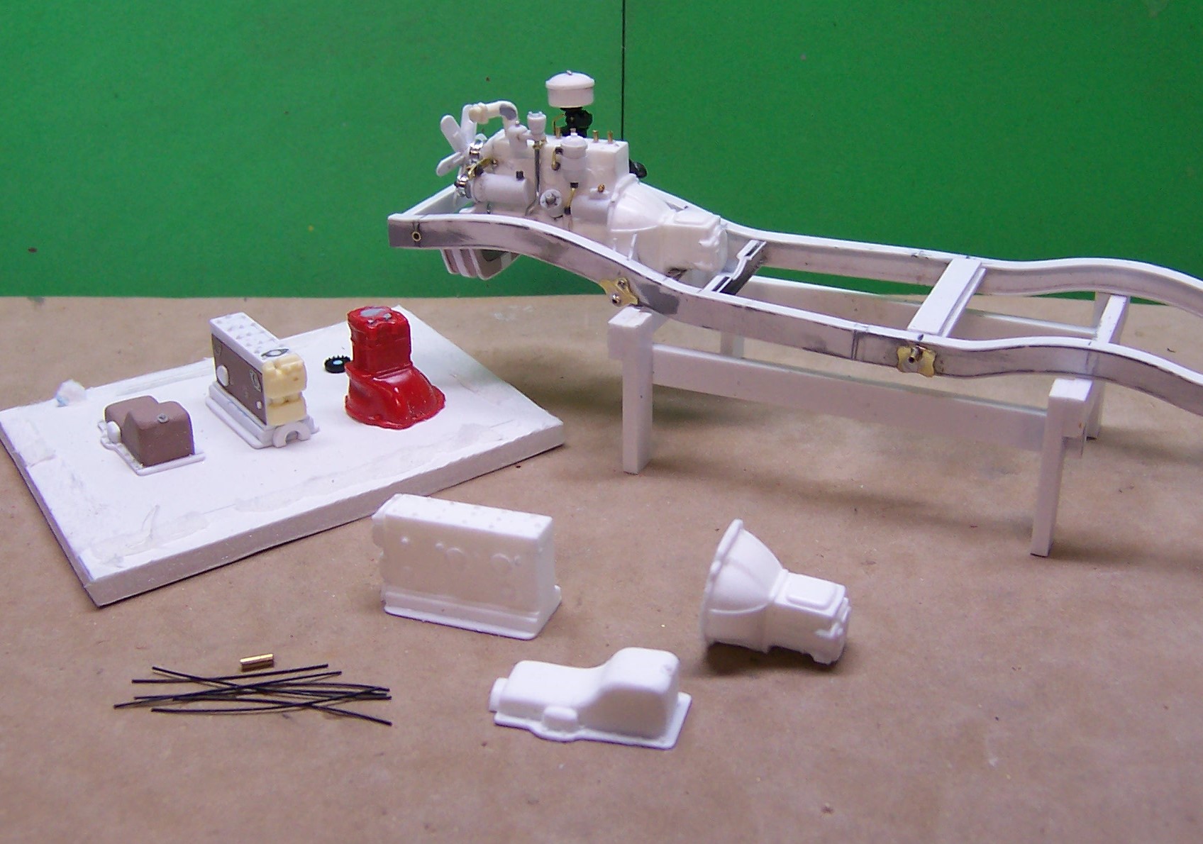

  16. More pix of the work in progress with quite a bit done on the engine. A gas tank and fuel line and fuel pump were added to the chassis. The sediment bowl is a piece of aluminum tube, plastic tube and an amber clearance light from an Ertl truck kit. Fan belt is a strip of electrical tape.
  17. Those beads are great, Bob. They are ceramic so they can't be squeezed or they shatter. But I have used them for a lot of different projects. Can't say as I can go along with a red paint job, though! It would be a real big target out in the field for German 88's!
  18. A few more pix of the work completed to date. The chassis is nearly done. A few more things to do including the gas tank for installation. Then it's on to the details of the engine and connection to the transfer case.

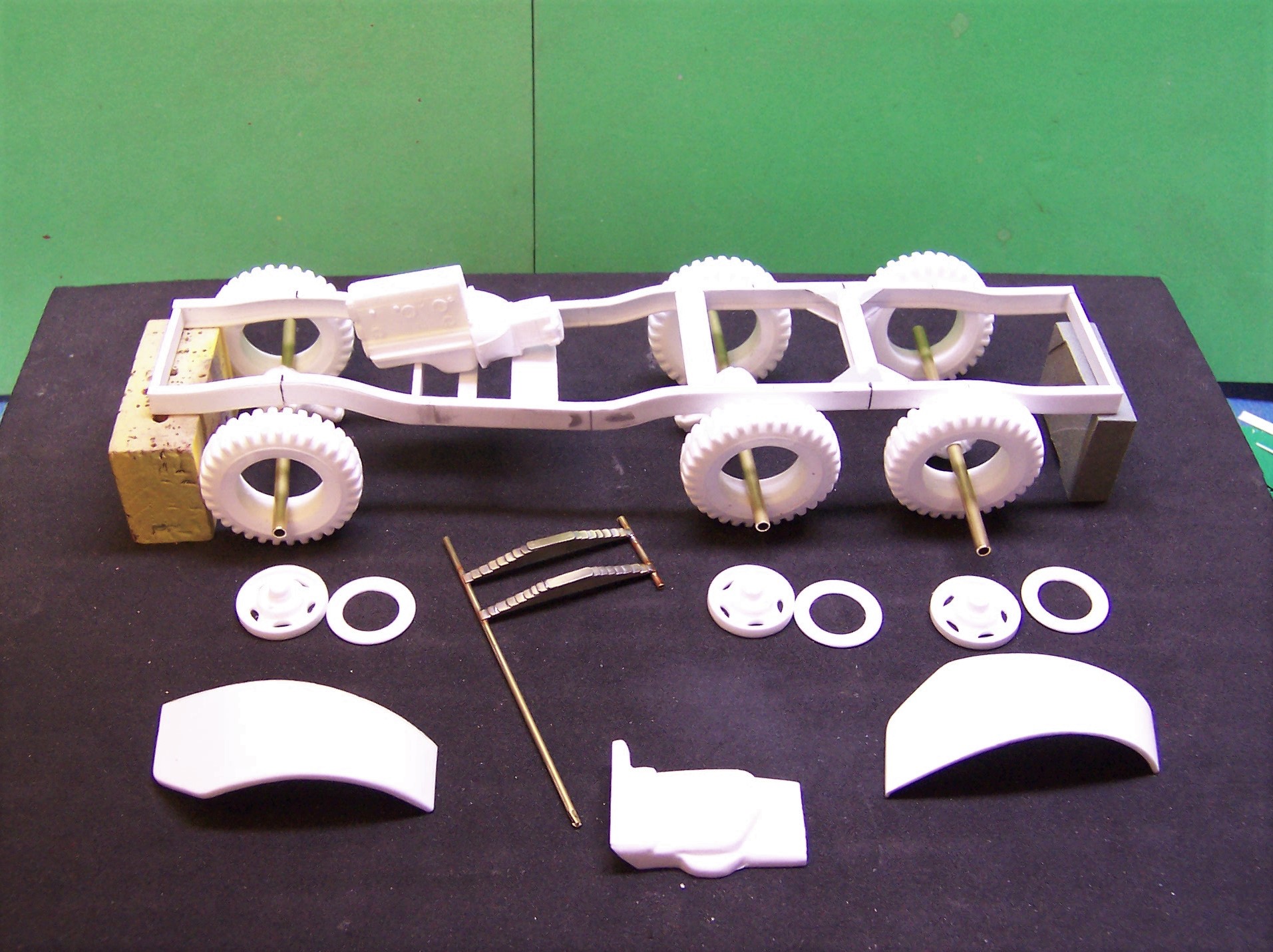

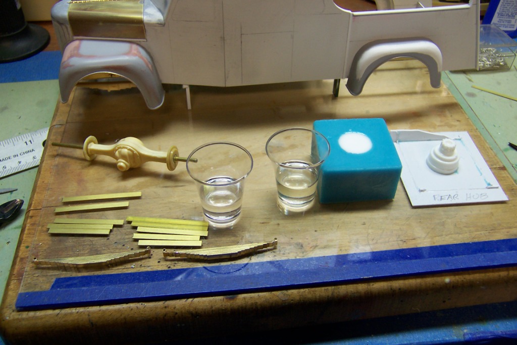

  21. Now back to the WC-63. The tandem axles in the rear of this rig have a lot of action tied to them. Torsion bars, axles, springs, trunnions etc. These have all been made of brass stock. Not only does it provide for some strength but the axles can move up and down as well. There is a special fitting on the top of the front axle of the tandems where the drive shaft for the rear differential fits in. This allows the the differentials to rotate a bit while maintaining continuous drive power to the axles. The photos don't show this feature yet but future ones will as I added the connector tonite. The rear wheels are shown in position with the front hubs. The hubs will hide the screw and washer that will hold the inner wheel portion and the tire onto the axles. Below are the inner wheel bushings that slip onto the axles. The odd shaped piece in the middle is the connection from one side of the trunnion to the one on the other side. The loop allows for the driveshaft to get to the rear differential without interference. A look at the springs and trunnion that allows each axle to pivot. The torque rods keep the axles from rotating. The two rods in the middle will be cut off eventually. For now they just help to hold everything in position. Most difficult part was making the torque rods the same length so that the axles stay parallel. The springs only float inside the square open boxes on top of each axle. They are done that way so they can move while the axles go up and down. Thank goodness for the Tankograd publication that shows a closeup of all of this work. Without it I would be lost!
