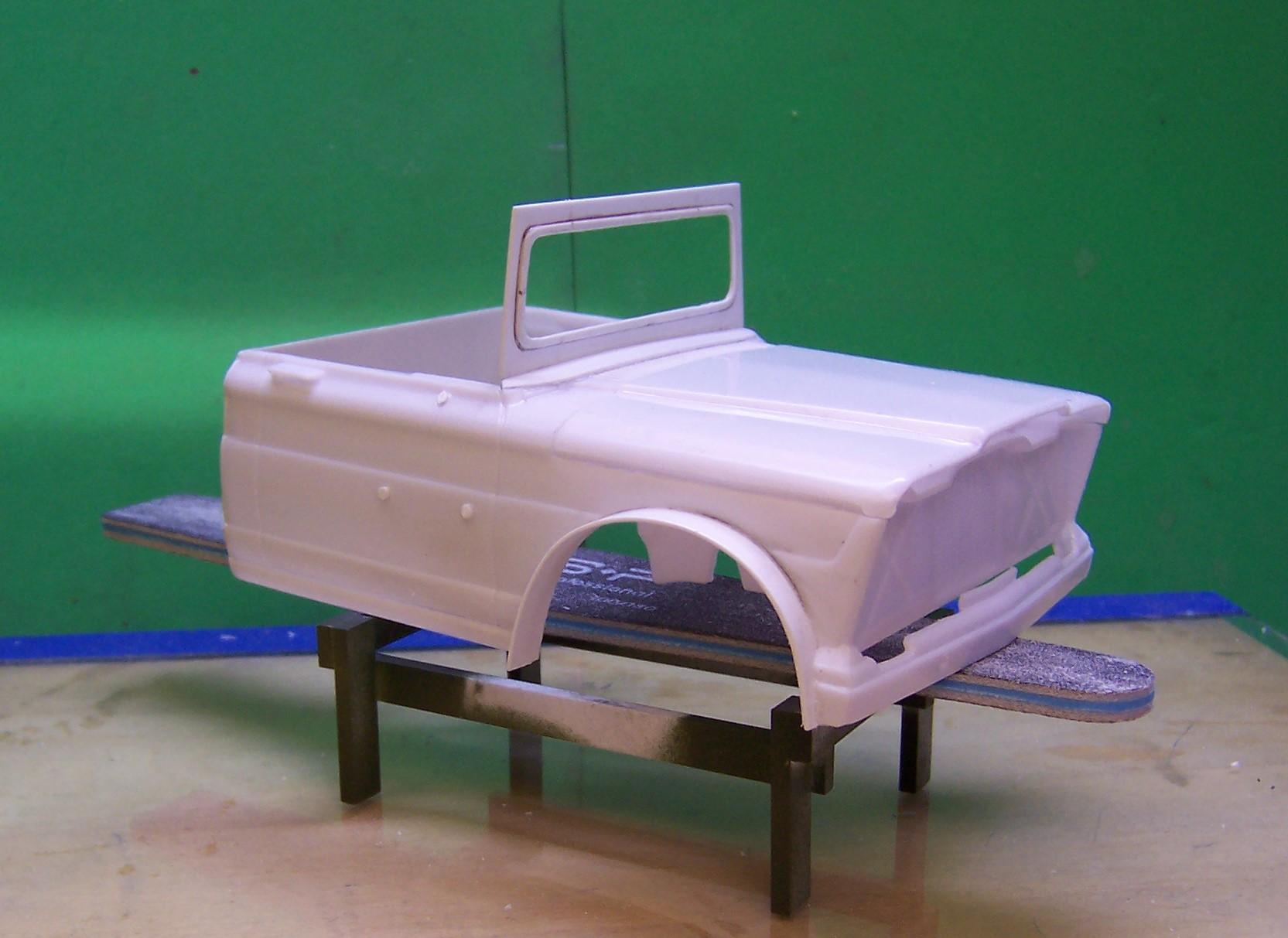

A fun project to update a 1950 Chevy pickup into something a little more modern. I took the front end from a 1999 Chevy and blended it into the front of the '50 taking out some of the horizontal grill bars. Kept the hood clean in front, extended the cab and added a custom box and dualie rear tires. The suburban on the right is based on a 1949 Chevy that my father had and which he used for his land surveying business. He had special graphics painted on the doors. At the time the photo was taken I was still working on the gooseneck trailer. The pickup has a small 5th wheel in the bed.
