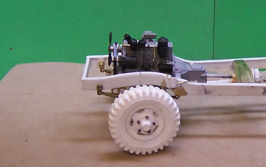

Getting ready to make up the top. The framework is done except for some cleanup of the joints. The engine is also done. Things are coming right along now. The gnomes have been busy but will take a well-deserved day off for now! That first photo is lousy, I know! Have to brush up on holding the camera steady! -

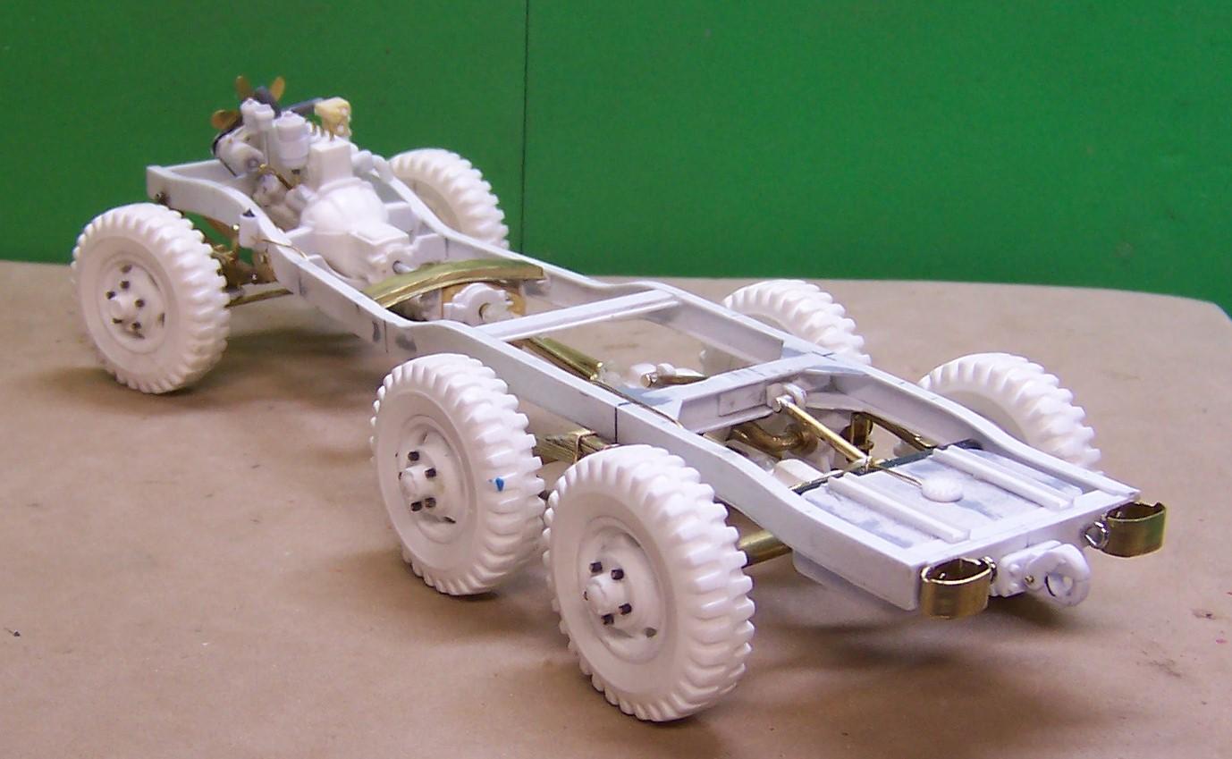

Adjustments have been made in the wheels. I used some Tamiya "German gray" for the tire color. Tires are not jet black, especially the sidewalls. The part that is in contact with the pavement is darker because it is constantly being worn away just a little but not the sidewalls. The wheels were modified to a 6 lug design rather than the original 5 lugs that were on the Power Wagon that I originally took the wheels from. The 5 lugs were cut off and the surface sanded smooth. Then I traced around a hexagon pattern that is on a circle template. A hole was drilled at each angle point and a piece of brass wire was glued in. Then #15 fusion beads were dropped over the wire and superglued. Then the wire was cut close to resemble the studs. The front wheels are done. The back ones needed to be done at the time of the photo. -

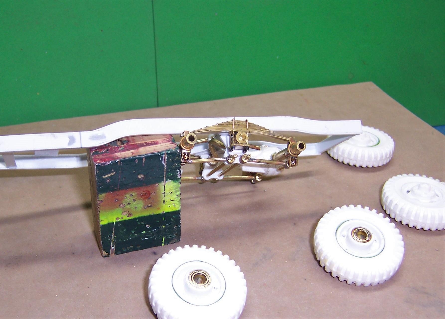

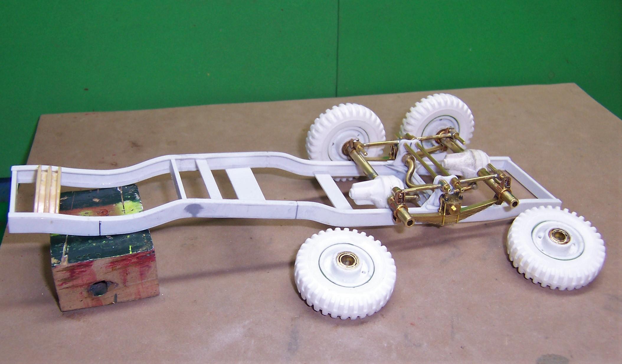

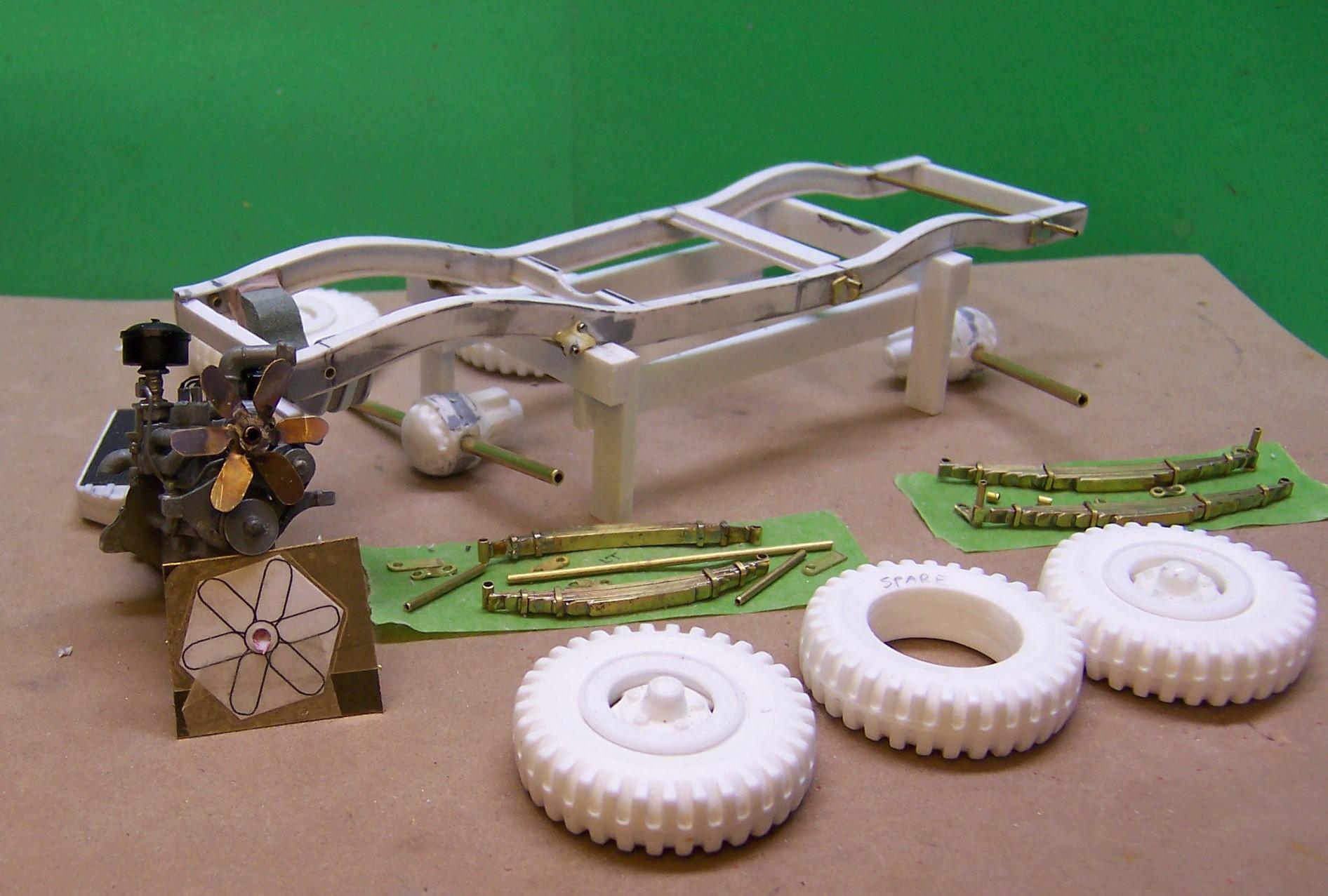

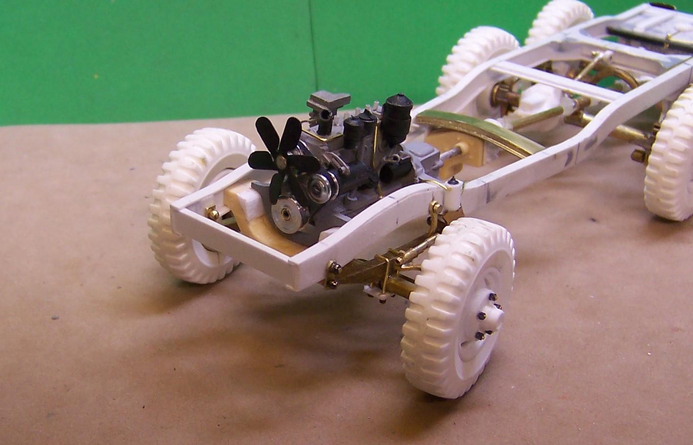

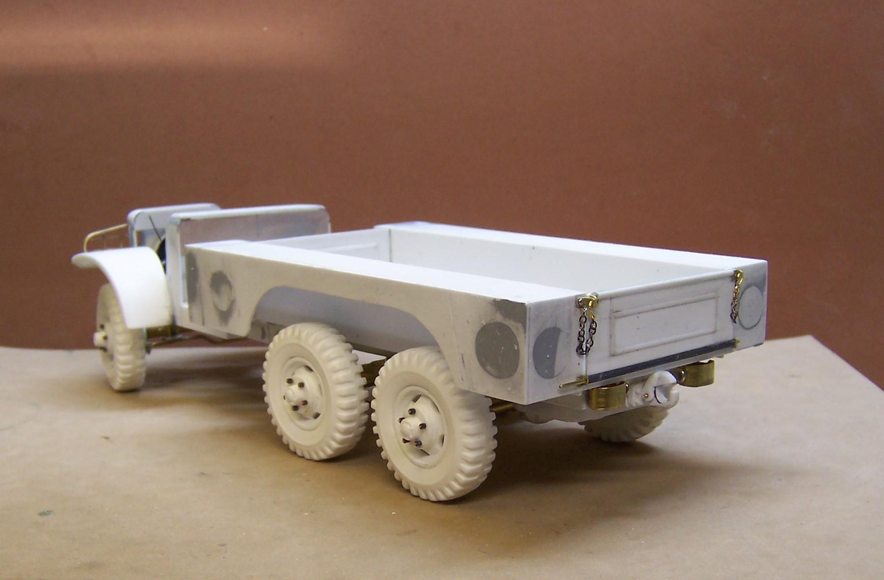

Got some casting done today. Tires and wheels are the same as on the WC projects I worked on. So 4 more mud/snow non-directional tires were cast along with the wheels. I need to change the lugs from 5 to 6 but that is no problem using some wire and some ceramic hex nuts. With those done the rear axles were set up for the inner wheel pieces. The Honcho kit wheels snap on a very flimsy plastic axle stub which I never liked. So a piece of 1/8" diameter brass tubing was slipped over the outer portion of the axle and the center was drilled out for a small screw and washer. The inner wheels were opened up for a bushing that slips over the brass axle. The screw and washer act as a retainer for the wheel so that it will not slide off the axle. The outer wheel will be glued on after all painting is competed. -

Thanks, Alan. The M-715 had the Jeep Tornado OHC 6 cylinder engine. Was not much on power or speed. Our local FD had an M-715 built into a brush unit and the changed out the Tornado for a Chevy V-8 and kept the four speed transmission. Here's what the tailgate now looks like with some hardware added. -

Here are more pix. I did up the tailgate with the "JEEP" stamp in the middle. The kit tailgate had it so it got incorporated here. One small compartment box is done also on one side but it may change some. Not convinced that I like it at this point. -

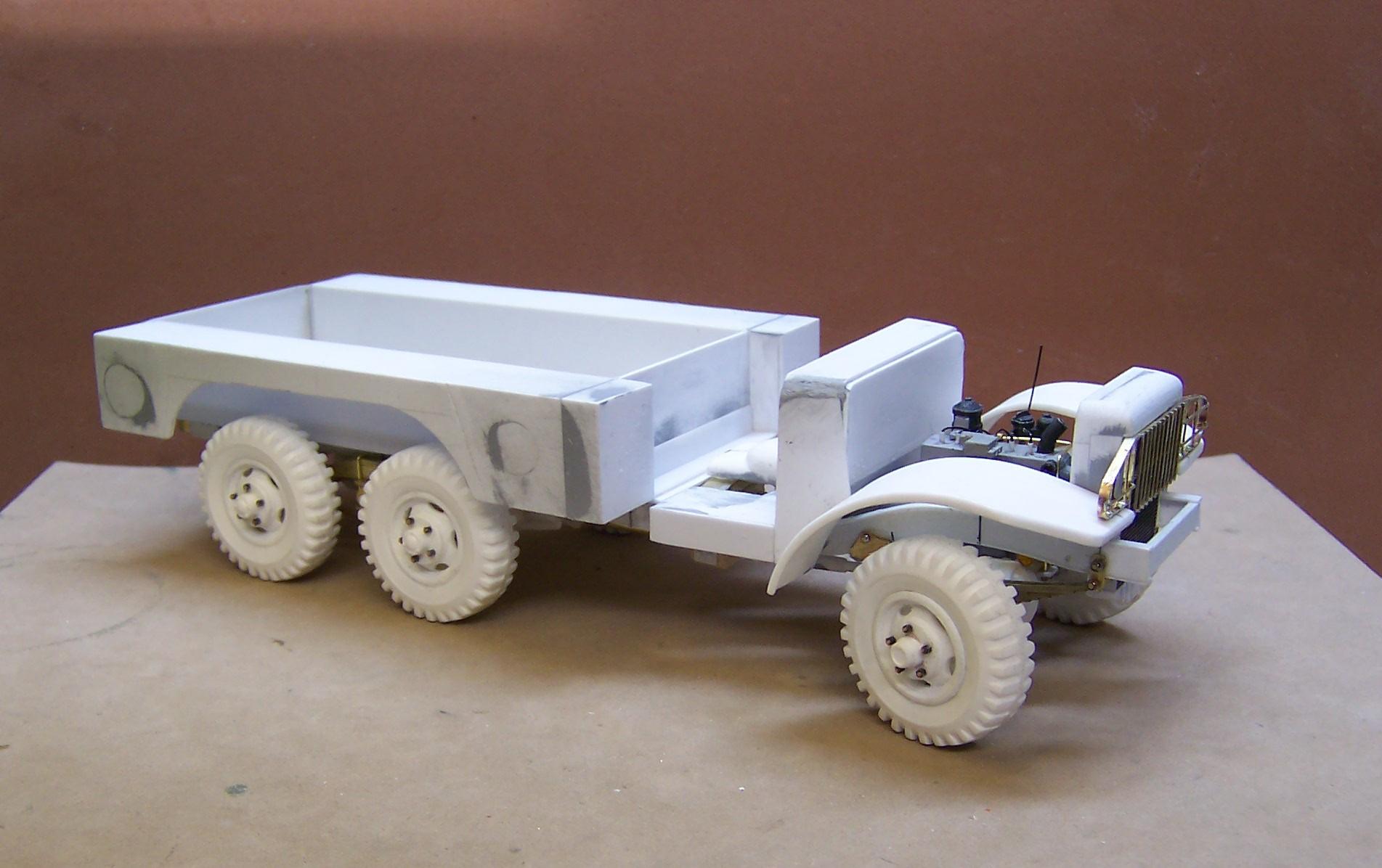

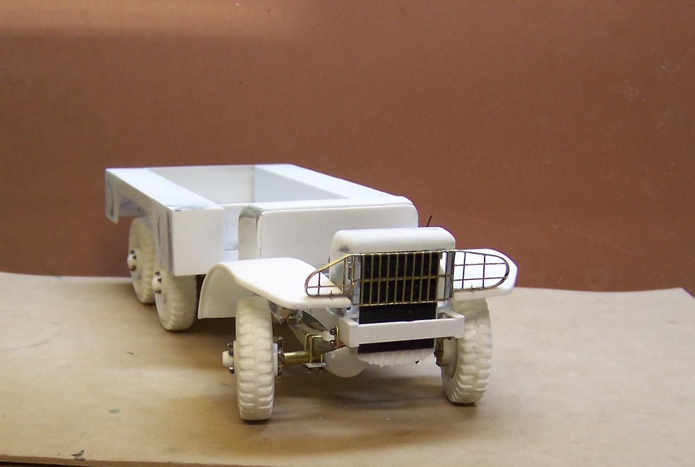

Unfortunately, Greg I don't have a full workup on the specs so you are probably right. It won't affect the wheel base, though so I will stick with what I have. Here is the latest. The body is on the lengthened frame. and a couple of details added to the windshield. -

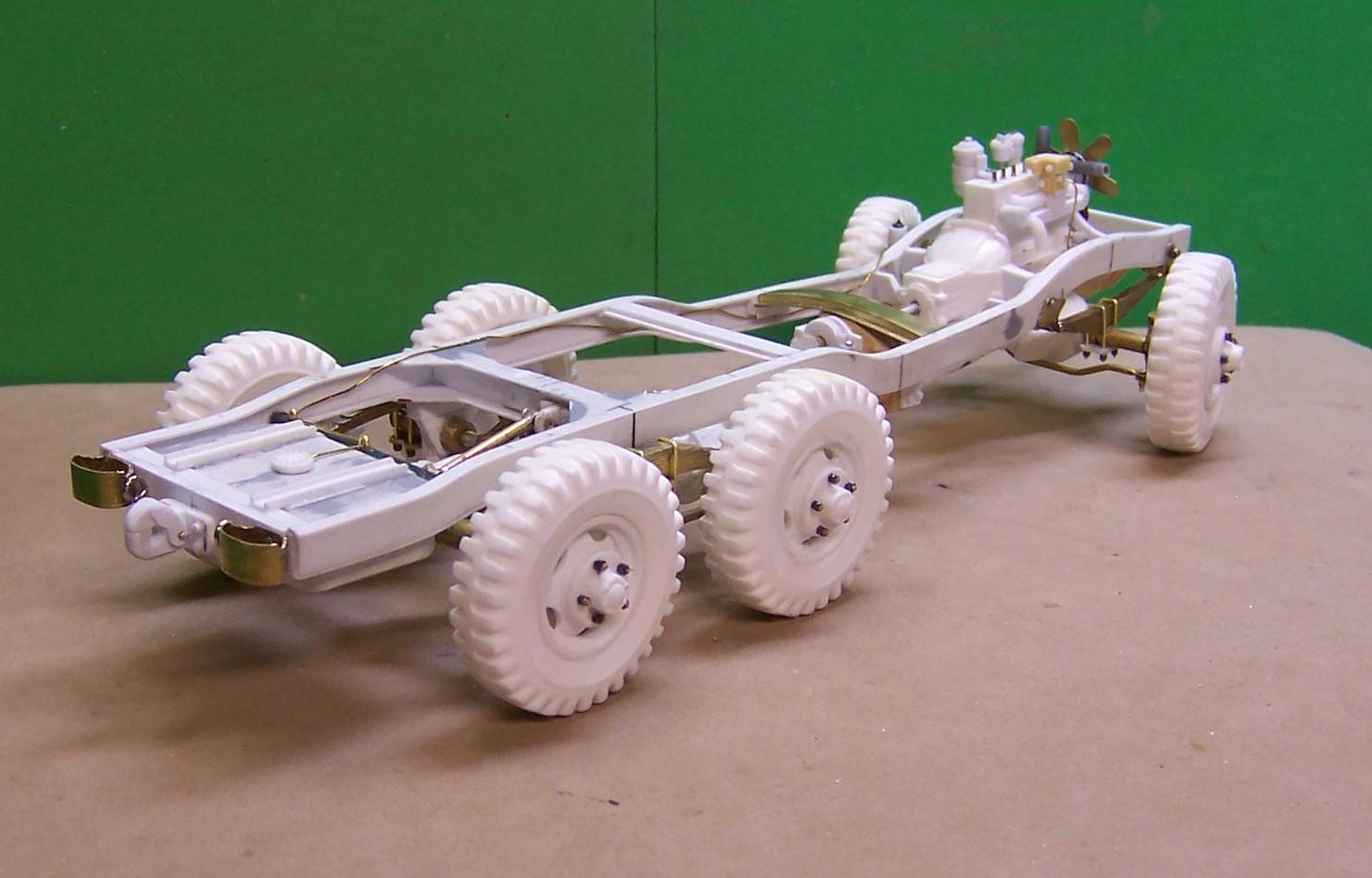

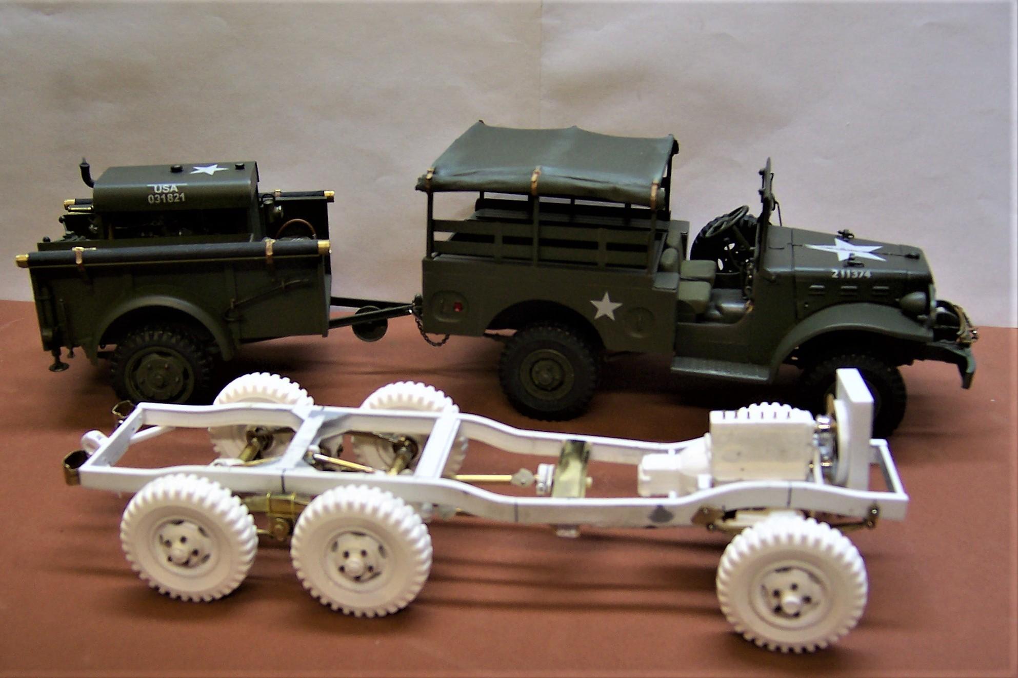

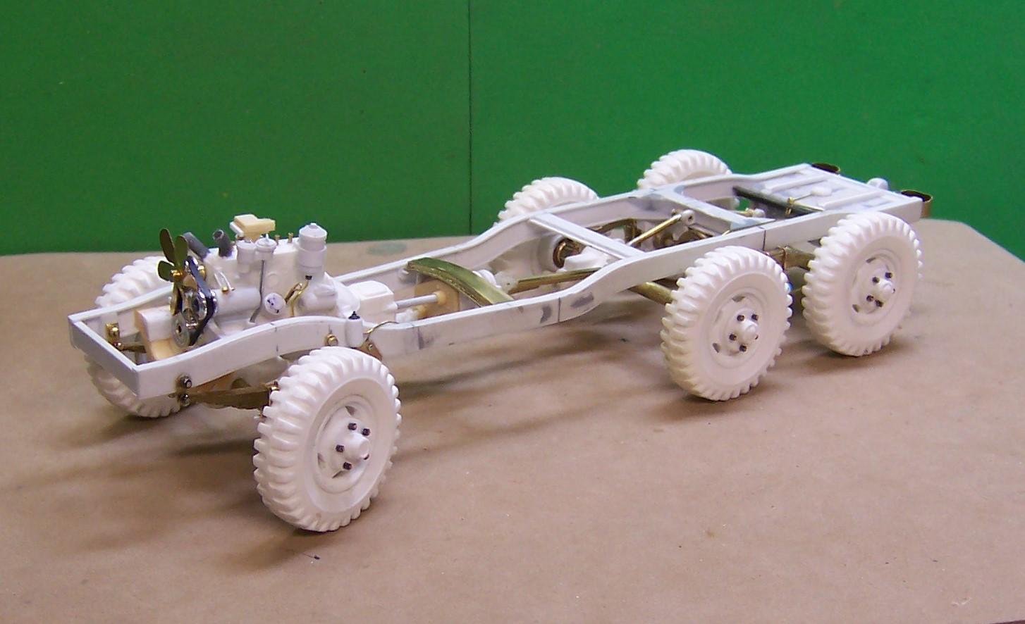

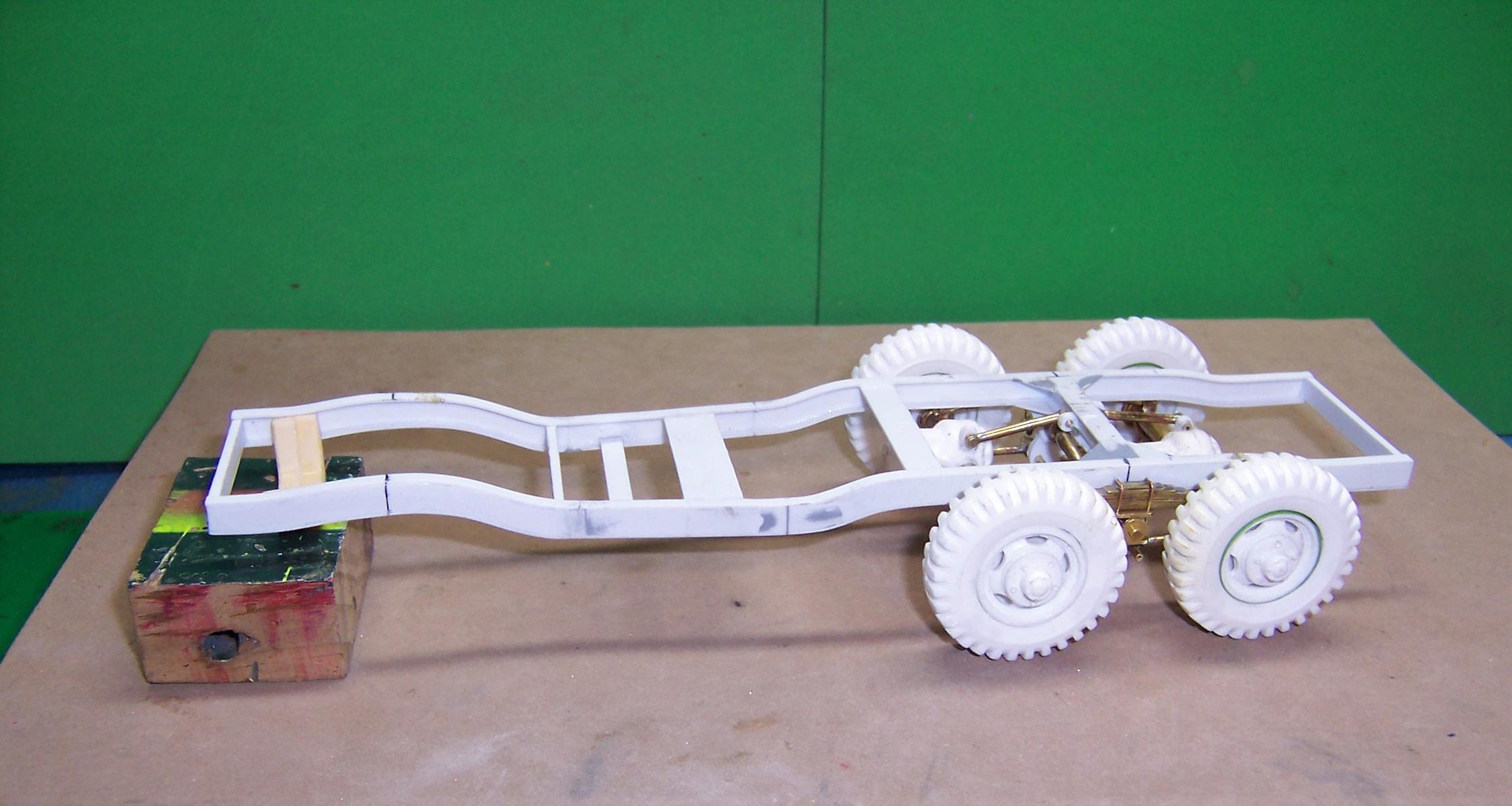

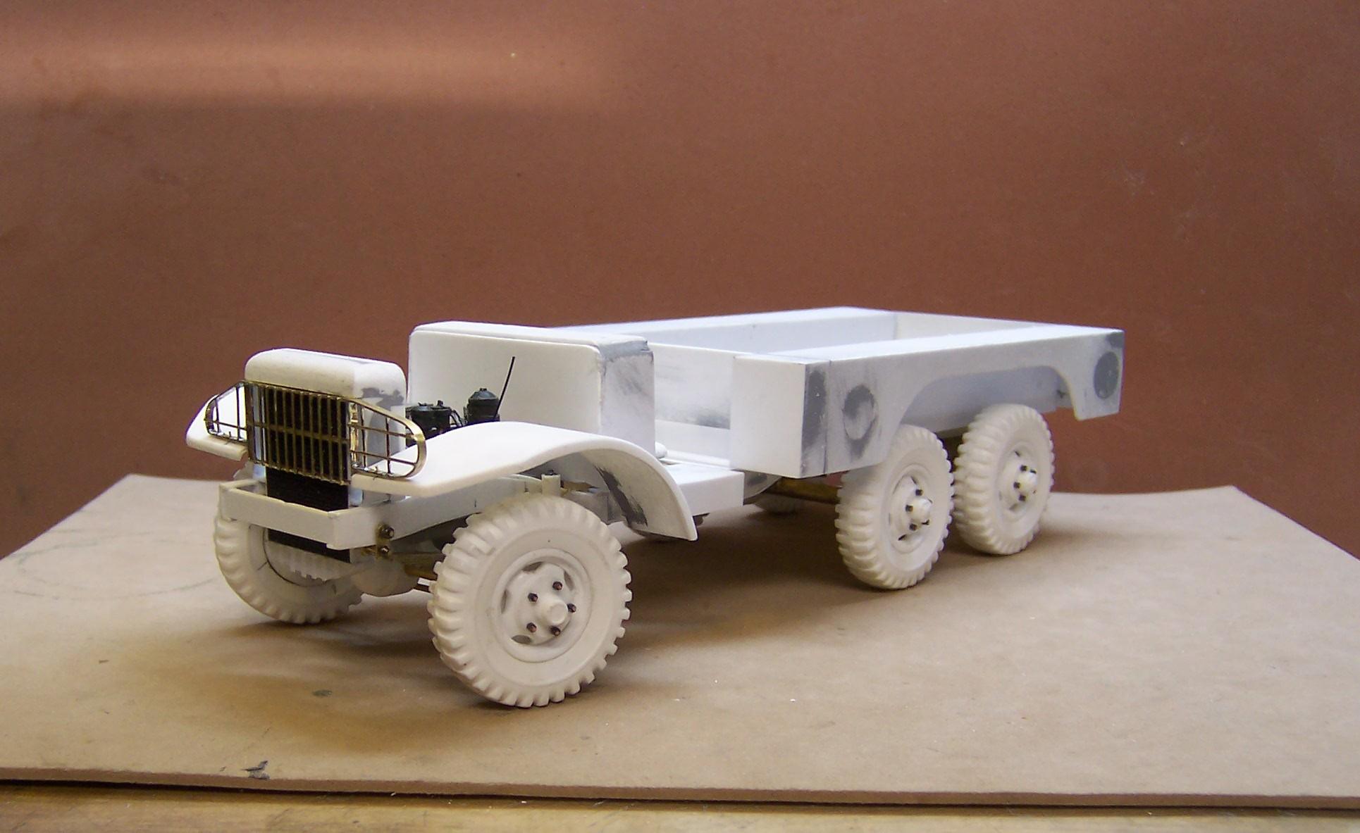

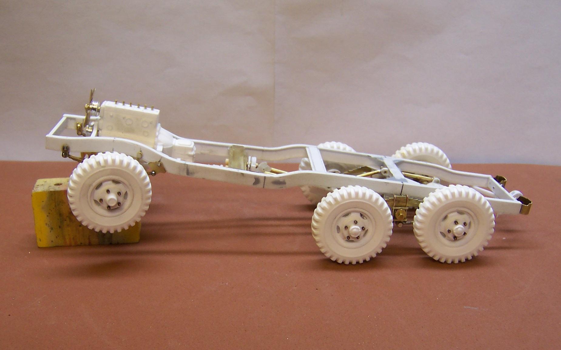

I've compared the military spec for the M-715 wheelbase and found that the Honcho kit wheelbase is 10" too short. I had to cut the frame and lengthen it with a splice on each side. Glue is drying now. When it's done pics will be posted. That's the military box on back. Even at this angle you can see that the rear axle is not under the center of the opening. -
Now that the WC projects are done I've started a new project to build an M-715 pickup from the '60's. The Jeep Honcho kit is the donor for the frame and front end. It turns out that the frame is 10" too short so it will have to be lengthened. The body is military style and the fender openings are just sheet metal. No fancy grill either on front. Just the typical military grill guard. Here's where we are so far. Cab top has been cut loose and a piece of sheet stock is glued to the back. The Honcho body was one with the cab so the cab had no back panel. Now it does. The cowl has been modified and the new windshield has been cut to shape. The part in the middle will be cut away leaving a very thin edge for the windshield glass to fit against. Not a good picture but you get the idea of the windshield rubber gasket. Made of 0.020 sheet stock rounded at the outside edges. When the middle is cut away the inner edge will be rounded as well. After painting, a black marker will be run around the gasket. Better than paint as the line can be made very smooth with the marker. Windshield is cut open and mounted. The old rear view mirror mounting holes have been plugged. The mirrors for the build are on a single mount. The fenders are strips of 0.020 stock glued in place. I'll cut away those awful door latches as well and substitute some resin castings that are open.
couple of pics I forgot to include. The interior of the hood area is detailed as well. I made interior fender pieces from brass and enclosed the openness of the space. A pioneer set was also made up to go on the right side of the body. Shovel, axe and pick are mounted inside a rack that is secured to the front edge.
This model is now ready for the show case, fulfilling its role as the mule for a Class 1000 trailer pump. The WC-52 and Wc-63, both built by Dodge pulled these trailers as part of the Corps of Engineers Fire Fighting Platoons of WW II. They were placed in secondary roles behind the Class 325 pumpers that were built on 1.5 ton Chevy chassis and that used front mount pumps.
