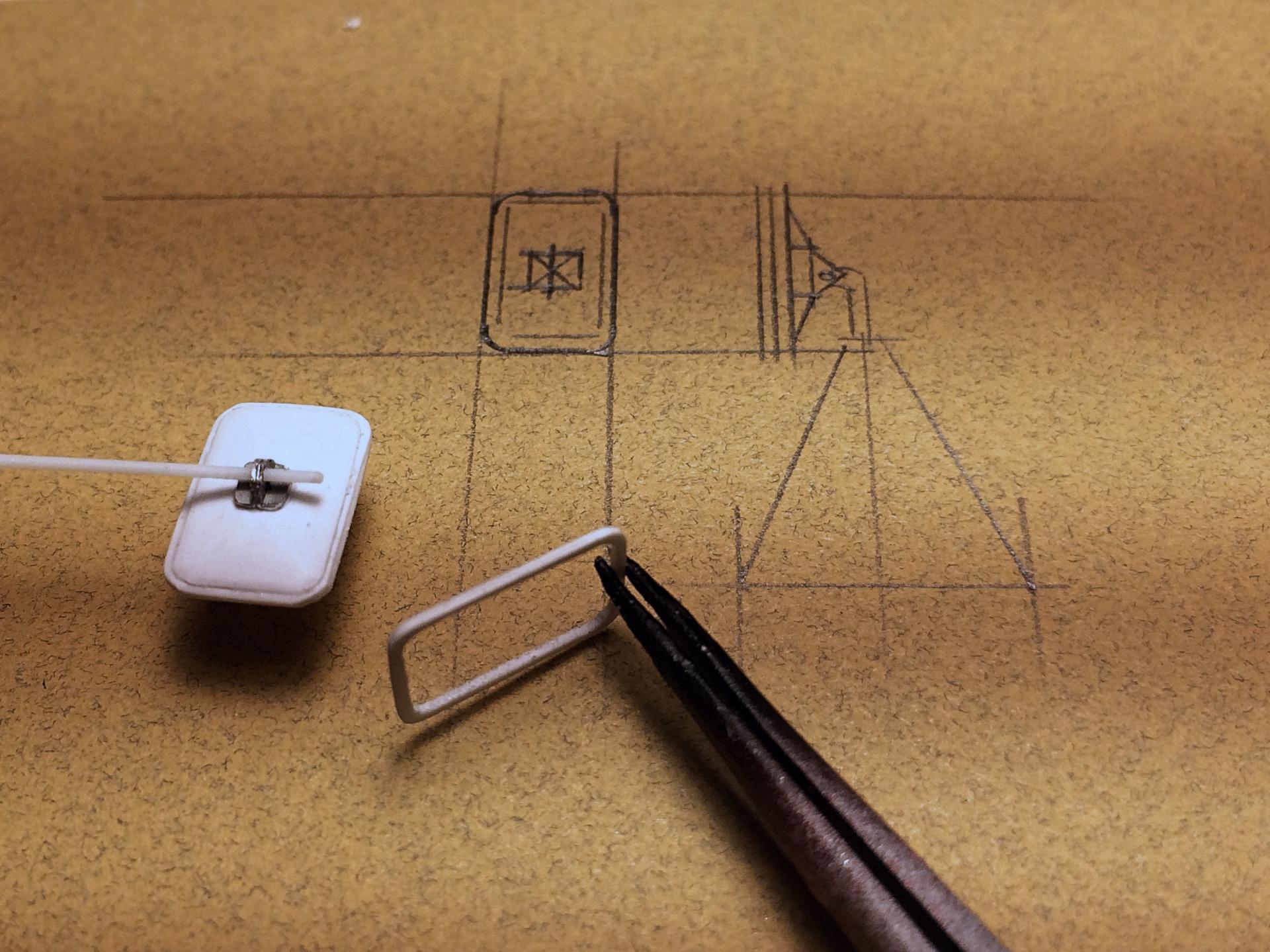

  10. Thank you. You did a really nice job on your pickup, considering what you had to work with. OMG that grill is really bad, just another reason why AMT shouldn't waste everyone's time, as you said the perimeter isn't correct, and the center bar with the turn signals is just wrong. But at least the headlights look more realistic. I separated the '72 grill from the bumper and filled in the turn signals, then made a copy, and got that chromed. When looking how the colors are separated, I discovered another lack of panel line, A-pillar to cowl, so scribed that. Squirted Testors gloss white. I should have done the mirrors first, DUH! While that paint cured, made the RV mirrors, using steel wire for the A brace and L to the mirror. Bending a 90° for the short part kept breaking, so decided to use solder wire, which is packaged by Inside Jobs cottage industry aftermarket who was at a model show. I made a resin copy of the mirror, not really thrilled with my work, the original looks much better. Use an bench vise for an anvil, punch and hammer to smash the wire flat. It's going to be super vulnerable to breakage, have to expect numerous repairs. Used another kit for the mockup, can see what I modified so far. I'm disappointed in Splash paint, they have excellent service, color match is perfect, but it's solvent is too temperamental. I sprayed quick coats, it splatters out but dries sort of flat, but I found it telegraphed the sanded off details. The Tamiya primer did not do this. Will have to wet-sand and try another session, spraying even faster and stopping much longer to allow it to dry.
