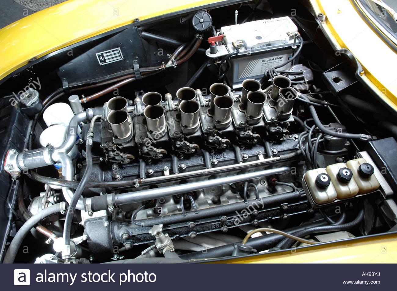

No, 12V, batteries just looked kinda like 6V. Battery fine either way. Like the fire system. On option lists and window stickers they call it 'handly fire extinguisher'. 5 Rib cap is correct as far as every one I've seen/had. Same as gas cap. Steering was worm and roller, but great feedback. Diagrams scarce but I'm looking. Shared externals with 2 cam, I found these.
Brand new headers are FB. Cap in front of batt is oil fill. Dry sump tank is in behind battery in fender. huge but Invisible. Just fill tube. Not a wet sump like 2cams. Battery with Magnetti decal is correct, looks almost like 6V. Don't worry about lower hose, but you will. Included dry sump and cooler detail. Simple loop cooler, things always ran cool anyway, even in traffic. It's just me, but I'd swap to 6 cap battery. The series stuff is only for nutballs that show this stuff. Fiamm or Magnetti decals ok, both OEM. Tailpipes look awesome. tiniest bit of dark brown/tan wash just past lip adds the nice lean mixture from running snot out of it rather than idling in traffic rich. LOL.

Looks like Ferrari dohc V8, carbed. Transverse mounting so likely a 308. Maybe Revell Magnum PI 308 GTS? Never had it, but most carbed 308 kits are engineless. Pre-'80, after that were injected. OK, looked up instructions. Carb stacks look like MPC's out of late 80's Vettes, see step 4B in lower instructions/ Stock Magnum kit had airbox. Wires and fuel rail might be a Testors/Gunze, but I've not had it either. -
LOL. That's an Automobile Club of Italy membership sticker, expires in Dec. 65, so too early for 4 cam. Fun detail though, like an AAA sticker. The carb photos are a 3 carb 2 cam, so great for a Cal or non-Comp SWB build. Sorry I'm posting this stuff so much. Just spent a lot of time with these things over the years.
Found it for ya The dry sump filler is knurled cap near battery. Correct battery in pic below. The top pic shows the vac booster, color is dead on. Washer bag is black, this car is a NART alloy coupe, so not series.

All the wires go out the side. Not that I like these motors. This pic may help, car is wrong in a few areas, your photos are correct. But you can see distributors better, and tapering plug tube that probably is imperceptible in scale, which means you'll dupe it Carb detail sorely lacking, but airbox obviates that. If need be, Norm's 250TR carbs are fairly close, but stacks won't fit with airbox. Hose clamps were usually those wonky paperclip things that failed. Original oil filters were Baldwins And because doors, here's shot of jamb on door. Dear god please don't make warning light work

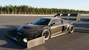

Cool. Hopefully has motor better than PRV 6. For all the haters, time attack cars are stupid fast, get snot pounded out of them. The "entertainment center" adds downforce for cornering. No real rules about that so people go nuts. Ugly but effective. More useful than a red pro-street Camaro that can't go straight for 1/8mi. Oldest time attack race is Pike's Peak. So much older than you. The Audi in first pic is from '87. Factory built. Owned record at PP for ages. Hate away, free to do so. LOL. Go to a Mustang/Porsche/Vette board and do same, or friends living room. For the rest of us open-minded that like this stuff, here ya go. -
You can fudge the wires to the plugs with a short lead. The tube the wires are in tapers a bit towards the front. Maybe cut down strip wiring out of dead computer for brief run to lead tube? I hate wiring, so I never do it. Another minor thing, the hydraulic fluid reservoirs are semi opaque. Maybe a fluid level in them? You guys knew that I'd guess, but it always looked funny with empty fluid reservoirs. Even fresh they still have a little color. God. I'm SG. Sorry. At least it's not a post GM crpwagon. Still in awe of you guys. Quality and quantity. So much win.
Looks great. That is a footrest btw. Scale trunk latch would be pita, as they were incredibly tiny to start with. Crackle cam covers correct. Unsure if flocking fine enough to put on, then semi black over that. Master cylinder booster looks perfect.
