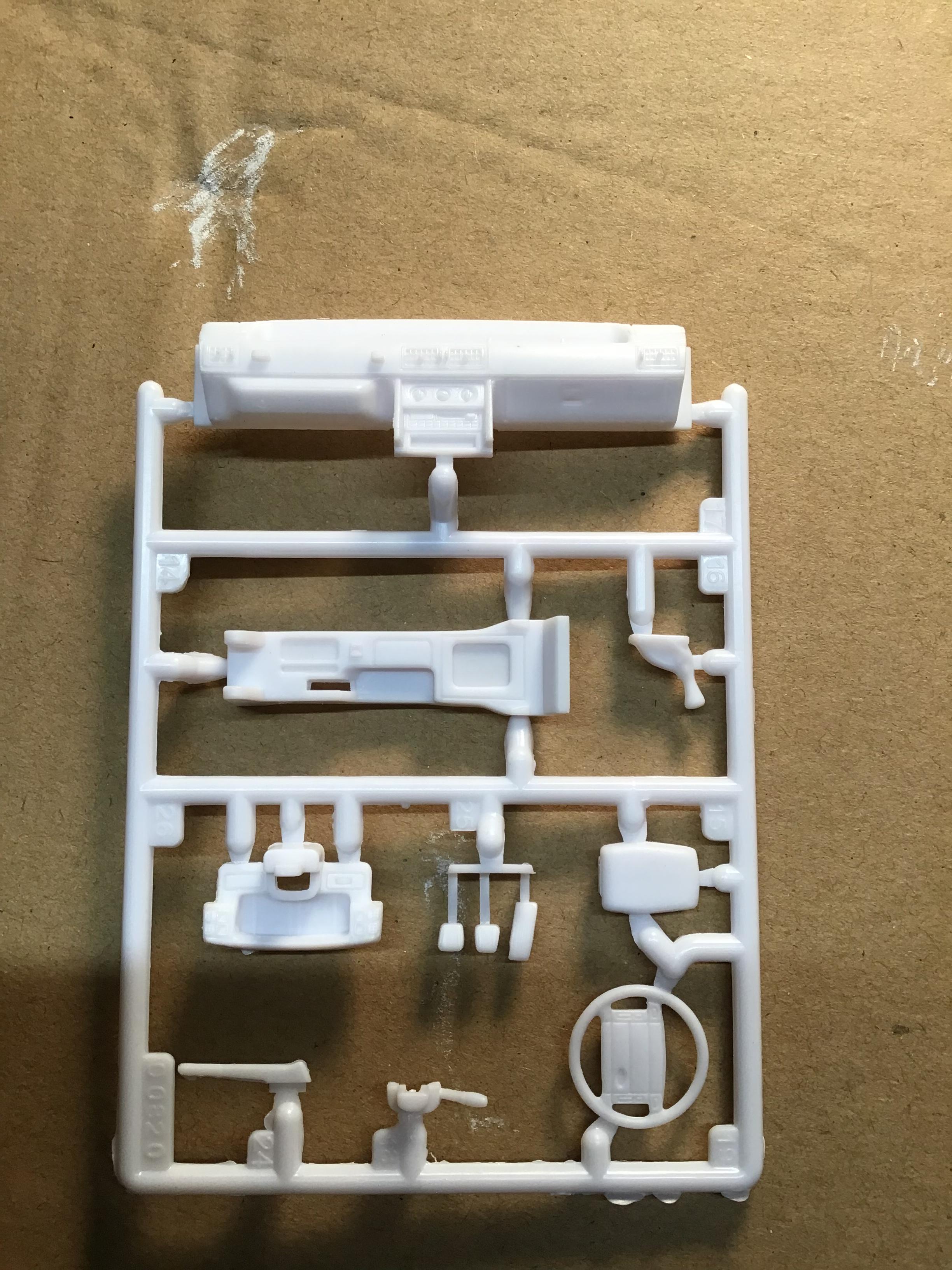

This 4 part rtv mold was formed over a RenShape master without pressure or vacuum. The resin casings (second photo and ready for primer) are cast upside down and sprued to the inside top where pressurized mixing guns shoot the airless plastic down into the bottom of the mold and push the air up and out through risers along the perimeter of the part. This resin kicks within 20 seconds after filled. The same technique can be done on a small scale by poring vacuumed resin into a syringe and pushed into a two part mold.
