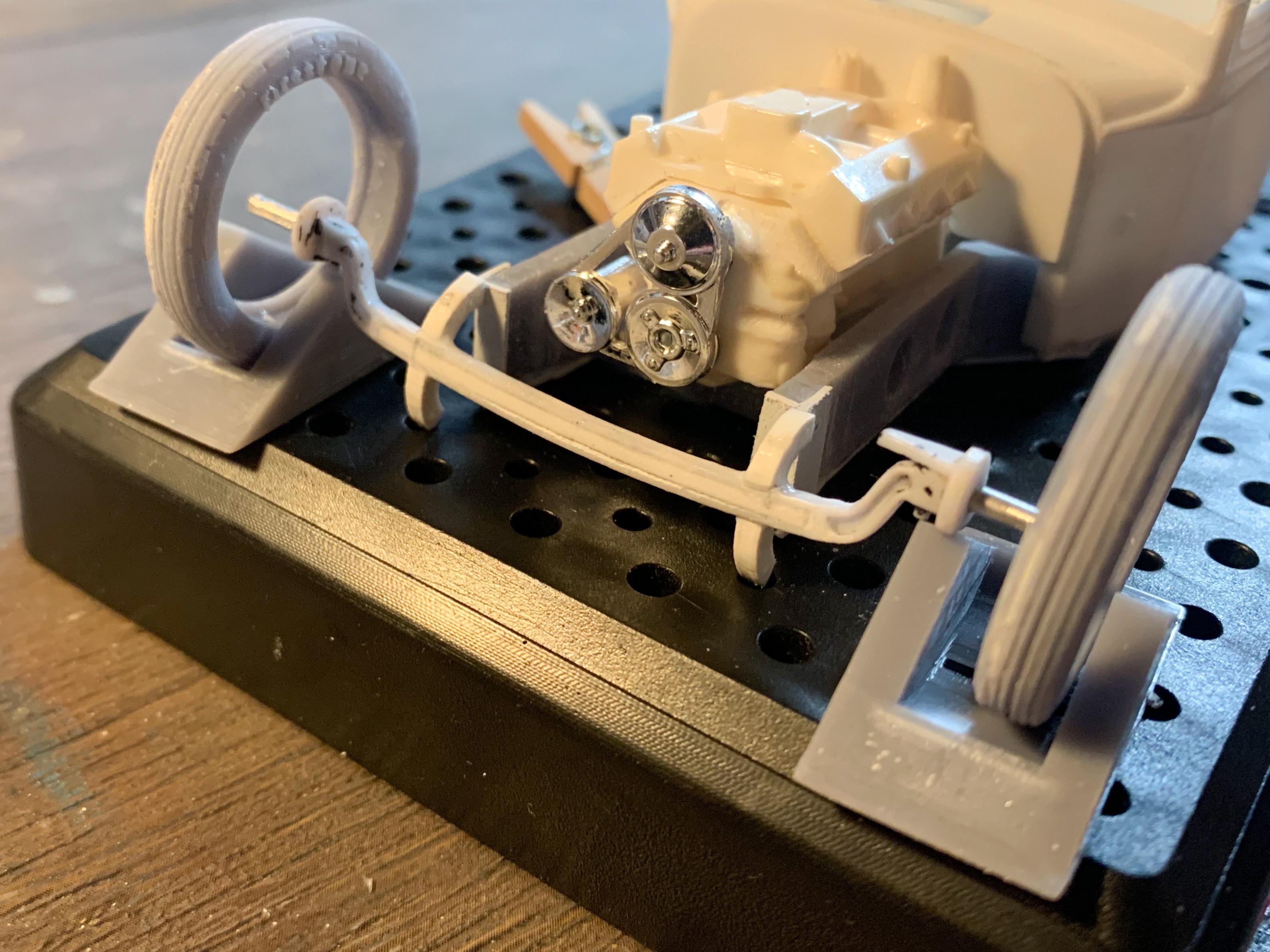

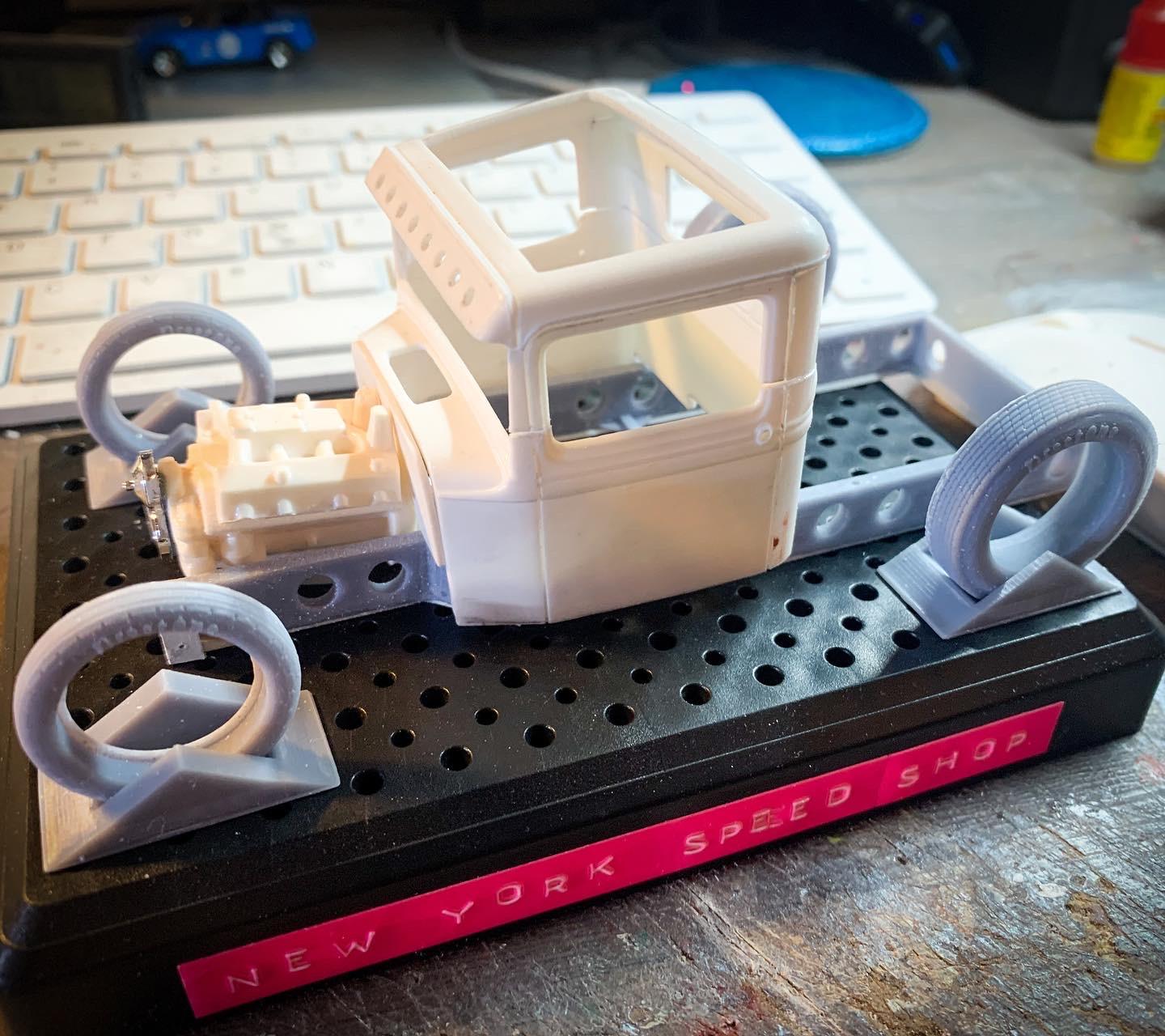

  1. That video was great - thank you! Getting something to print well is one thing…getting it so the supports don’t ruin the detail is QUITE another @iamsuperdan - does the forum support the upload of .stl files? Would be cool to be able to share designs somehow; we have some super-talented designers on the site here! At the other end of the spectrum of 3D design skills, here’s a little something I came up with today - wheel holders so your wheels and tires don’t keep rolling away when you’re doing mock-ups: Super easy to design in CAD and took maybe 20 minutes to print - these things are gonna be a game changer at my bench!

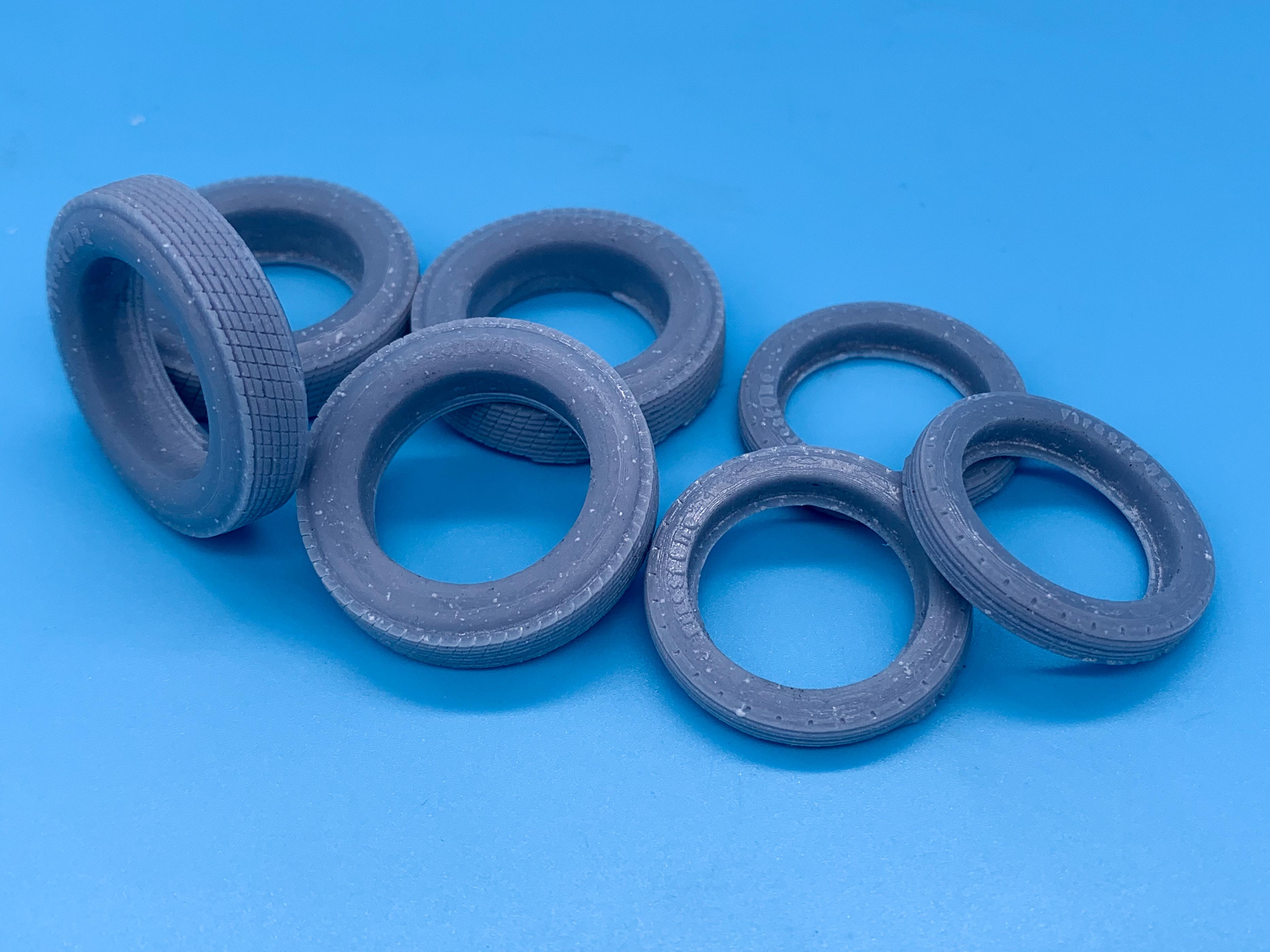

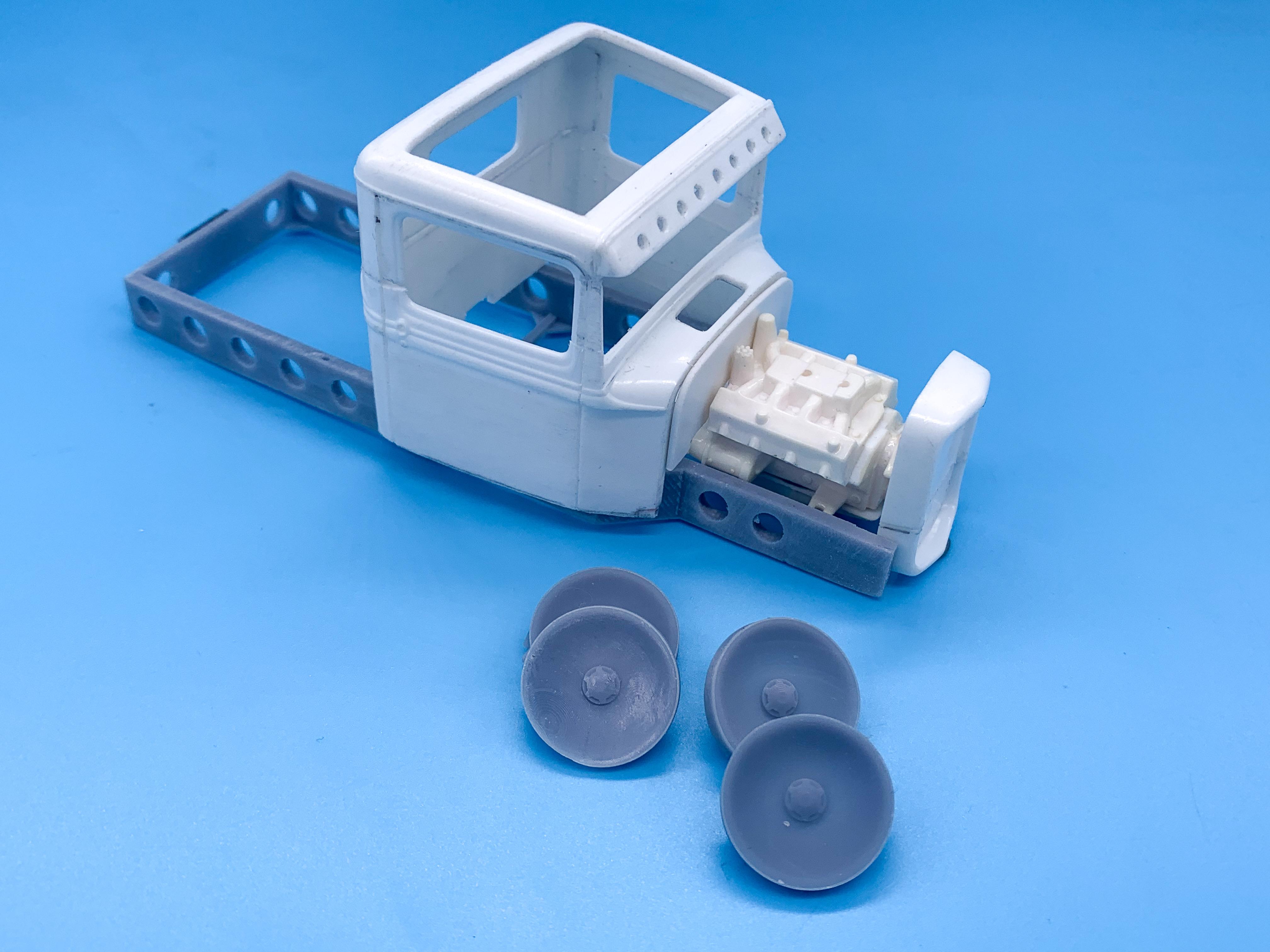

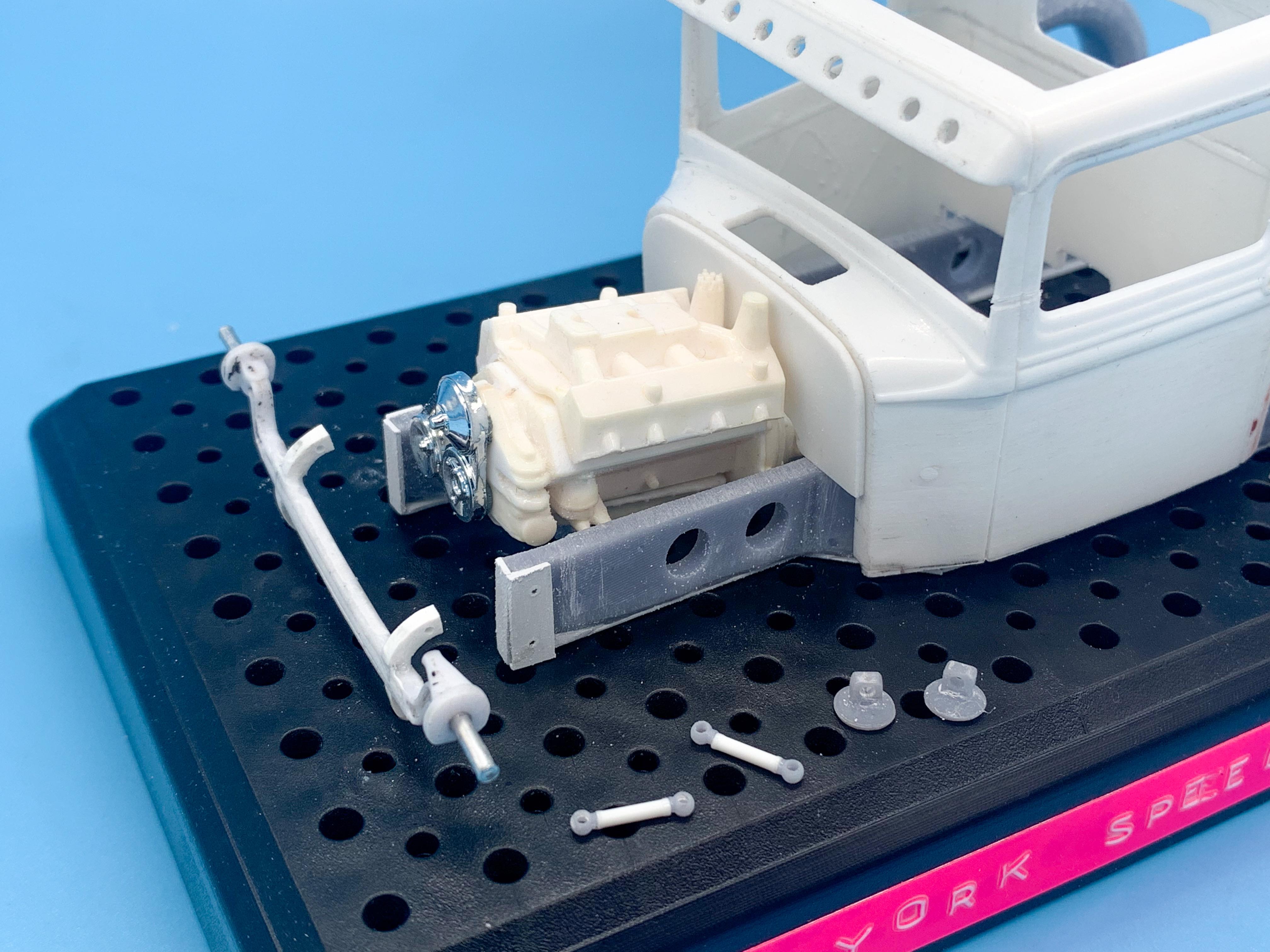

  2. I dunno…a lot of people seem to muddle through just fine with WAY less skills than you think one would need to survive the game of life ? Yessir! Rarely have a bad day’s model-building! A little more progress today - got a good set of those nice tires printed and cleaned up…printed some extras whilst I (mostly) had them printing how I wanted: Started work on the front end - modified a Revell 29 kit axle for the suspension setup I have planned: Made some linkages and some pieces to scratchbuild some shocks this coming week: And, after battling wheels rolling off the bench all weekend, I finally got smart and make some chocks to hold them in place for mock-ups (not totally relevant to this project but I’m pleased with the idea ?) Not a bunch of progress for an entire afternoon in the shop, but small steps…more soon!

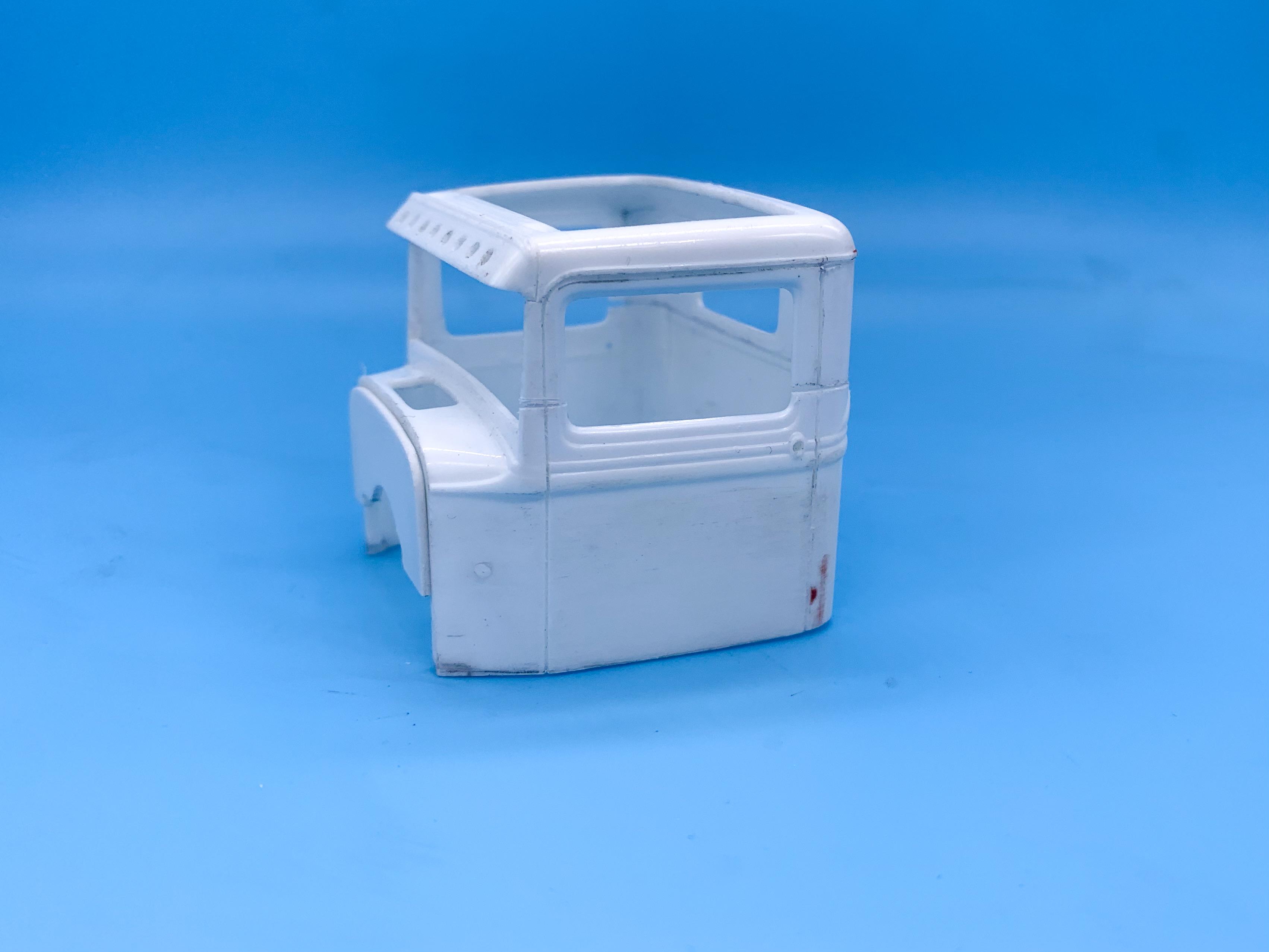

  6. I’m saving the hood to make a boat-tail hot rod of some sort ?

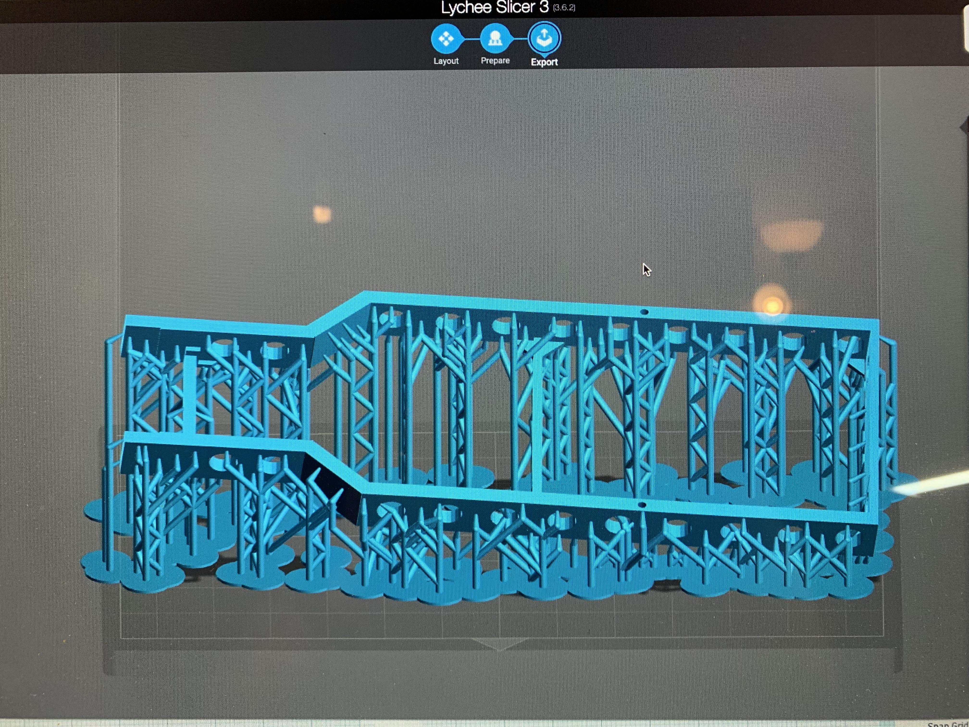

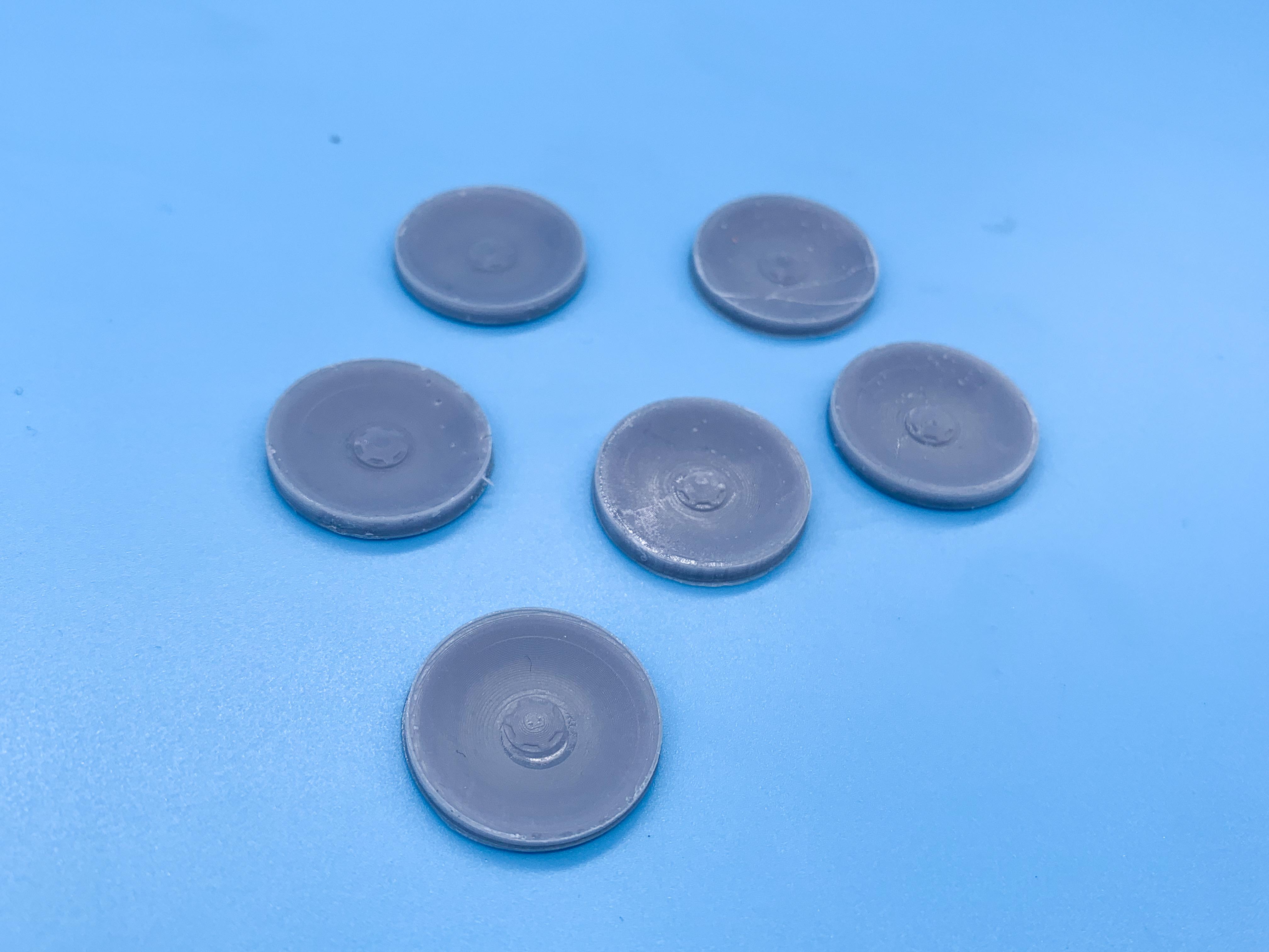

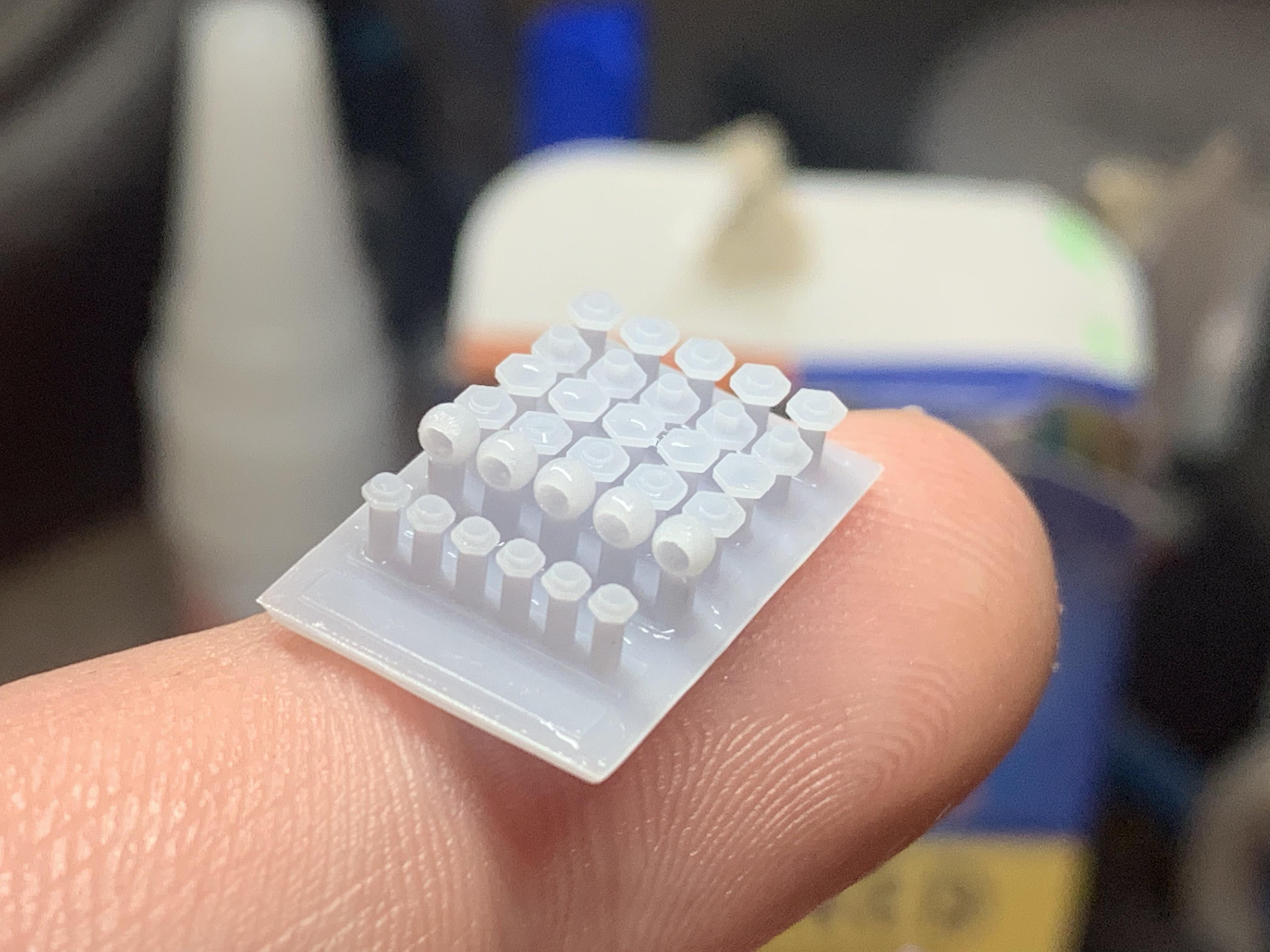

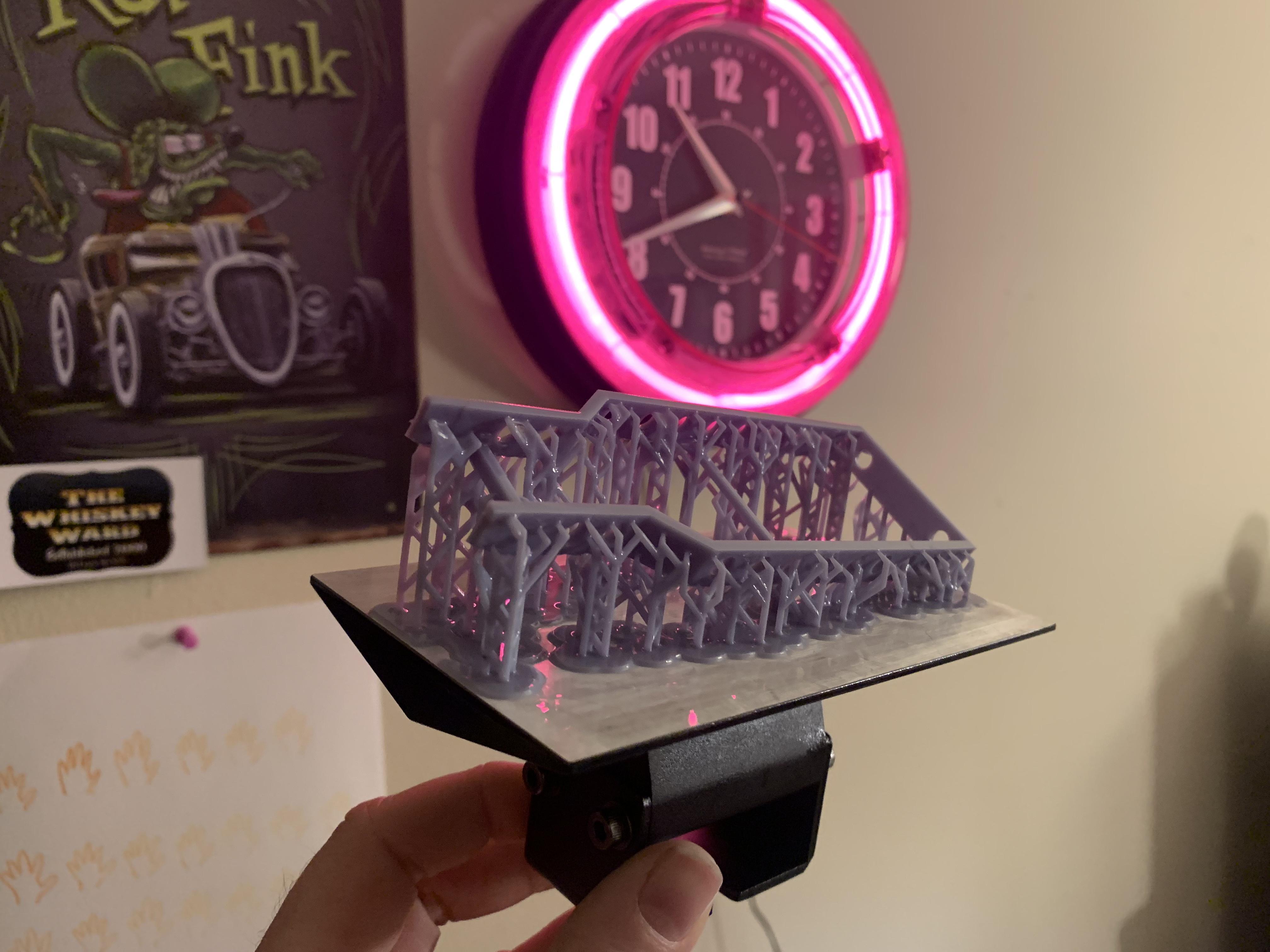

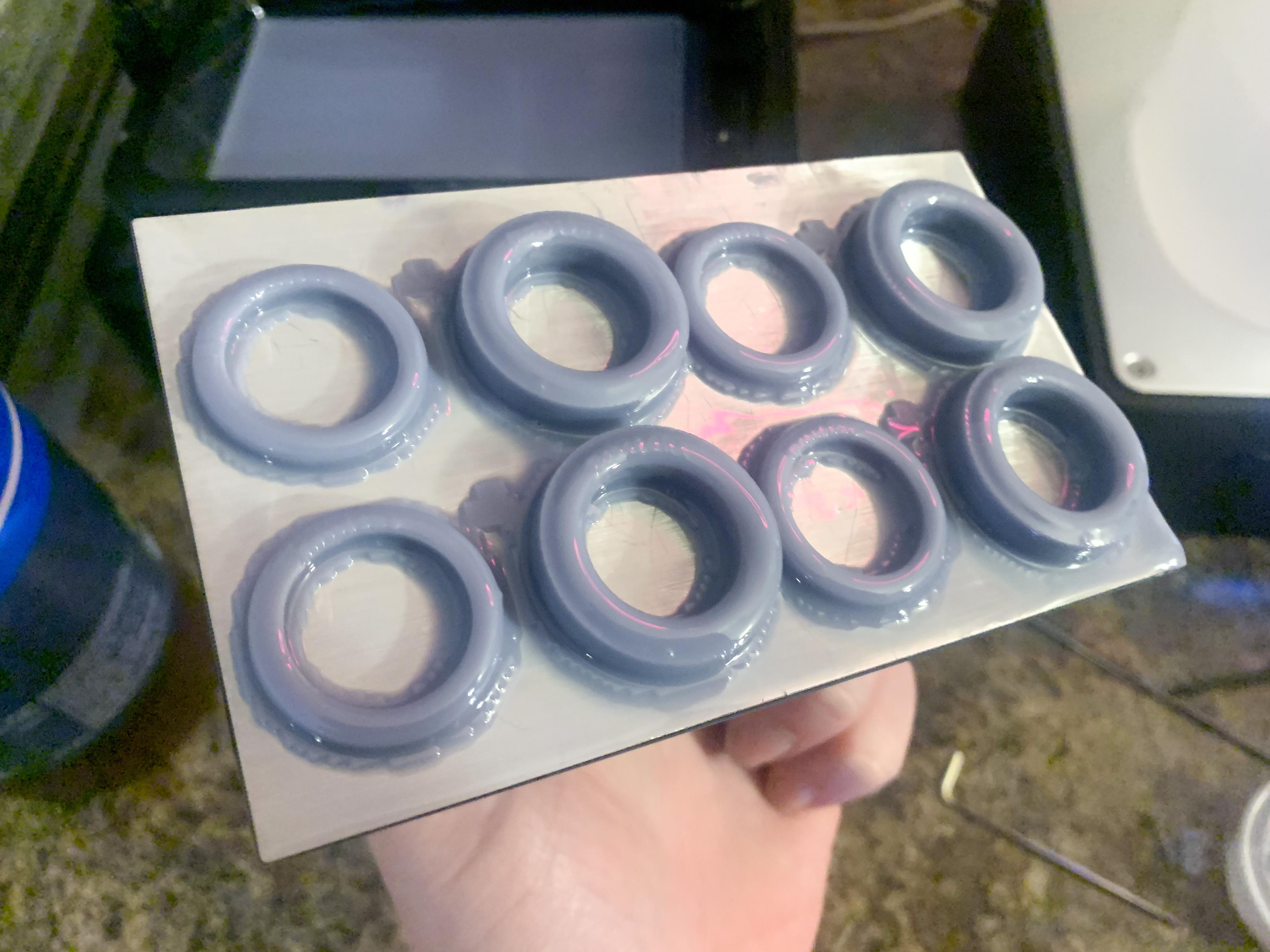

  7. Thanks Dan! I’d be interested to see that! Did three runs at getting some tires and wheels printed today and definitely got CLOSER anyway… First completely successful print WAS with them laying down, like you mentioned - ditto the wheels. Print quality was best with them angled up slightly though, virtually no lines or imperfections aside from the issue with figuring out where to put the supports. I had enough of printing wheels for one day so I’m trying a random mix of various other parts I’ve been wanting to try this evening…I’m hoping I can get some good nut and bolt heads printed…I’m getting low on Tichy Train ones that I normally like and it would be cool to be able to just print a bunch of sizes instead. Plus, had some seats and a grill and some other little geegaws I wanted to see printed:
  8. Honestly, it’s pretty easy - just scribe the hood off carefully (especially if you want to use it, which I didn’t) and then put some strips of styrene in behind the fenders when you reattach them to the body so you have some good gluing surfaces! Nothin’ much to it! ????
  9. Good tips - thanks Bill! Trying again this morning with more angle and just a single set (two tires, two wheels) Also trying adding my own supports so that they don’t ruin the tread pattern as much as the automatically generated supports did. Guess we’ll see in a couple of hours if it worked or not! I’ve been enjoying Cults3D for hunting down cool stuff to print (and there’s no shortage of stuff on there) - like this! https://cults3d.com/en/3d-model/various/hotrod-ford-flathead-3-versions-frenzel-supercharged-4x2-carb-1x2-carb Or this: https://cults3d.com/en/3d-model/game/peel-p50-printable-car Or even a lawn tractor ? https://cults3d.com/en/3d-model/various/gt5-1-25-garden-tractor-model

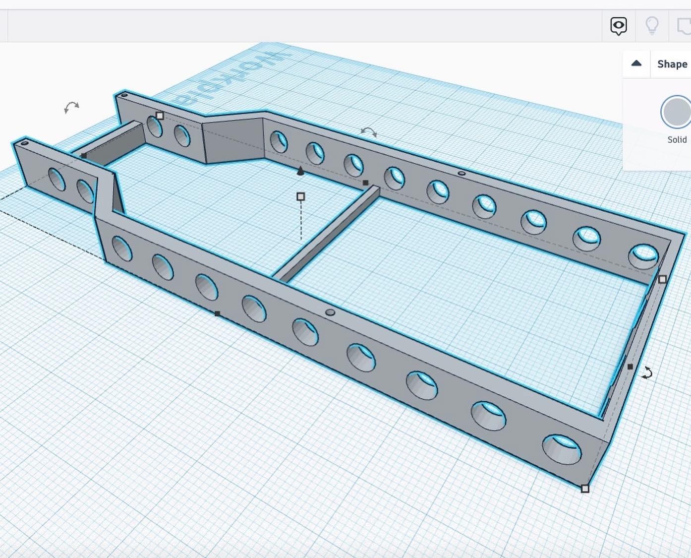

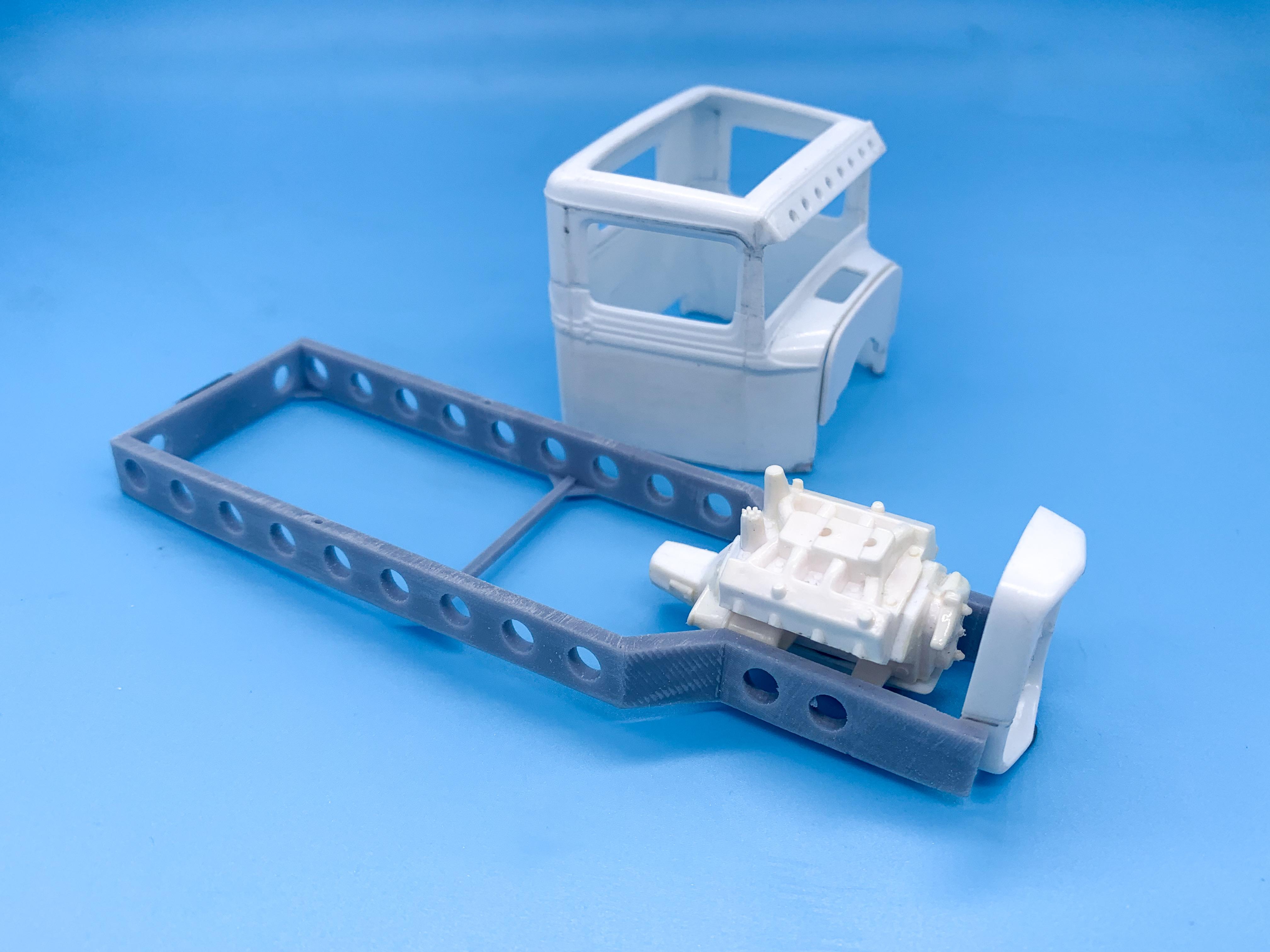

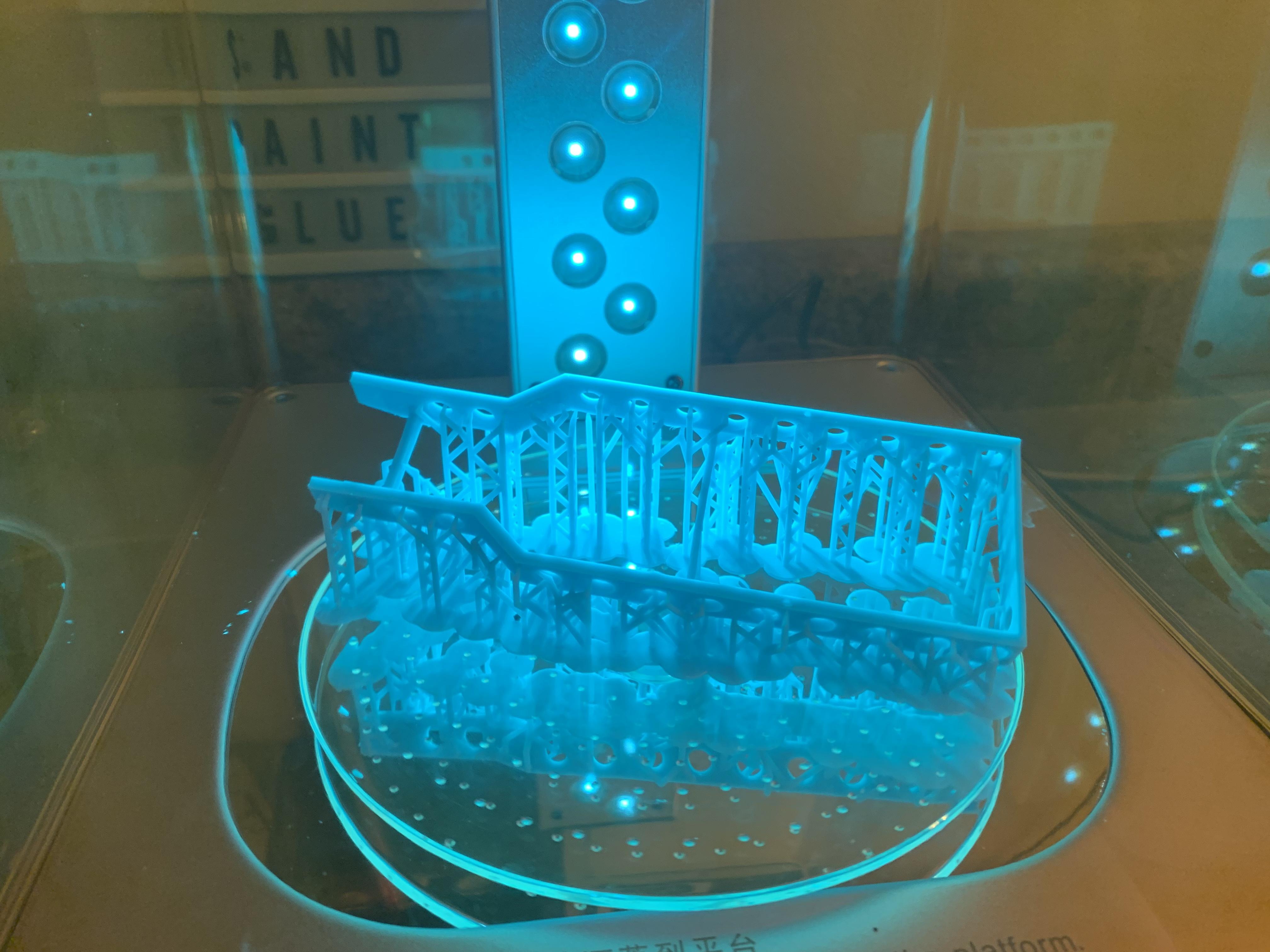

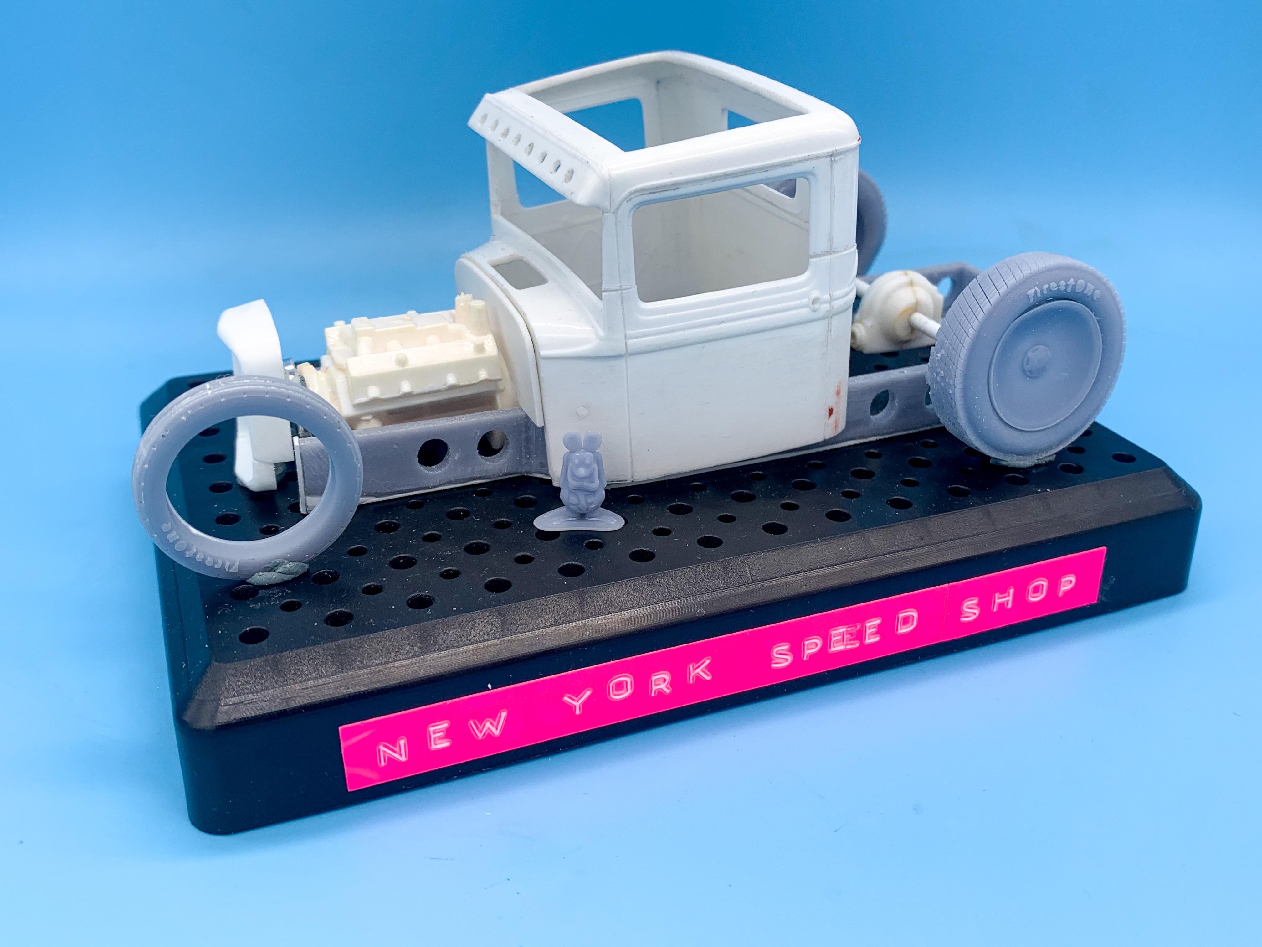

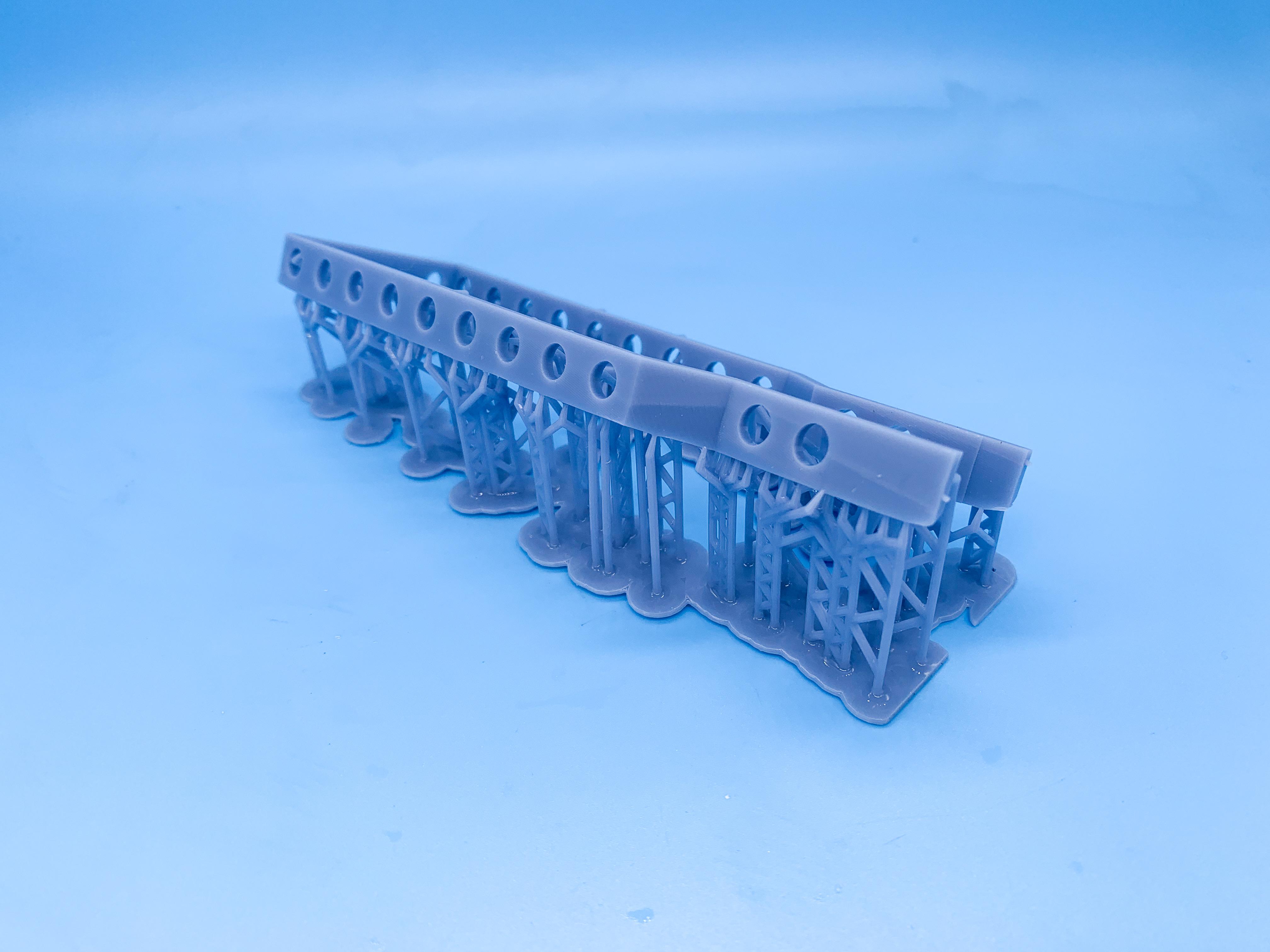

  13. I’ve had this idea in my head for AGES now, and actually kinda started it last year, got distracted, had a better idea and just now got to working on it again. I really love the unusual (if impractical, because it broke) frame on Ed Roth’s Mysterion: And, I don’t know why, but I kept wondering what that would look like if applied to a more traditional hot-rod body style. In fact, probably the most different body to the sleek futuristic design of the Mysterion - a 34 truck. I recently got a 3D printer and took a course to get a start on learning to actually design stuff for it…I’m REALLY green at this stuff still, but enough to do some basic work anyway. So, first things first, designed a frame: Actually, first step before that was pencil and paper, but my printer won’t print from those ? I did a quick test-print of the frame to see how it was going to work out, made a couple of little tweaks and then printed the ‘real’ one. All the supports that the software adds look crazy - and I’m not sure if it’s even necessary to use quite so many, but they stop the resin from sagging or the part not printing correctly so I let it add all that it thought it needed: Four hours printing later: Cleaned the parts in 99% alcohol and then cured with UV light: Now I gotta snip all this extra stuff off: Then, after some cleanup…a frame! As you can see from that body, whilst the printer was running I started hacking that apart and getting the proportions a little closer to what I’d imagined - took a couple of scale inches out of the bottom of the doors and a little out of the roof too. Before: And after! The body is just tacked together right now so I can check all the measurements and make the joints nice before gluing it back together, but it looks like I imagined in my head now… Going with a 390 FE motor as a hat-tip to the Mysterion (but only ONE of them in this case): And a shot with the body on the frame: I’m excited already! Tomorrow’s project is wheels and tires…I started playing with some vintage dirt-track style smoothies this evening but didn’t get a good run at making the tires yet: Still learning all this stuff, but I’m having a blast playing with some techniques that I haven’t tried before…more soon!
  14. Good advice! Believe me, if I'd known how bad the roads get here in winter I NEVER would've got this little sedan. I knew they got a lot of snow, but I figured they wouldn't let 12" of it build up on a (normally busy) highway ? I do have all the stuff you listed in the trunk, figured I probably WOULD get stuck at some point...luckily in this case I was close to work and we've got a small fleet of Silverados and Rams and stuff useful for pulling dummies like me out of the snow...was only stuck for 5 or 10 minutes. That highway had police barriers up this morning and was closed - but I could see at least 5 or 6 cars stuck behind the barriers, and a small army of farmers with tractors dragging people out ?

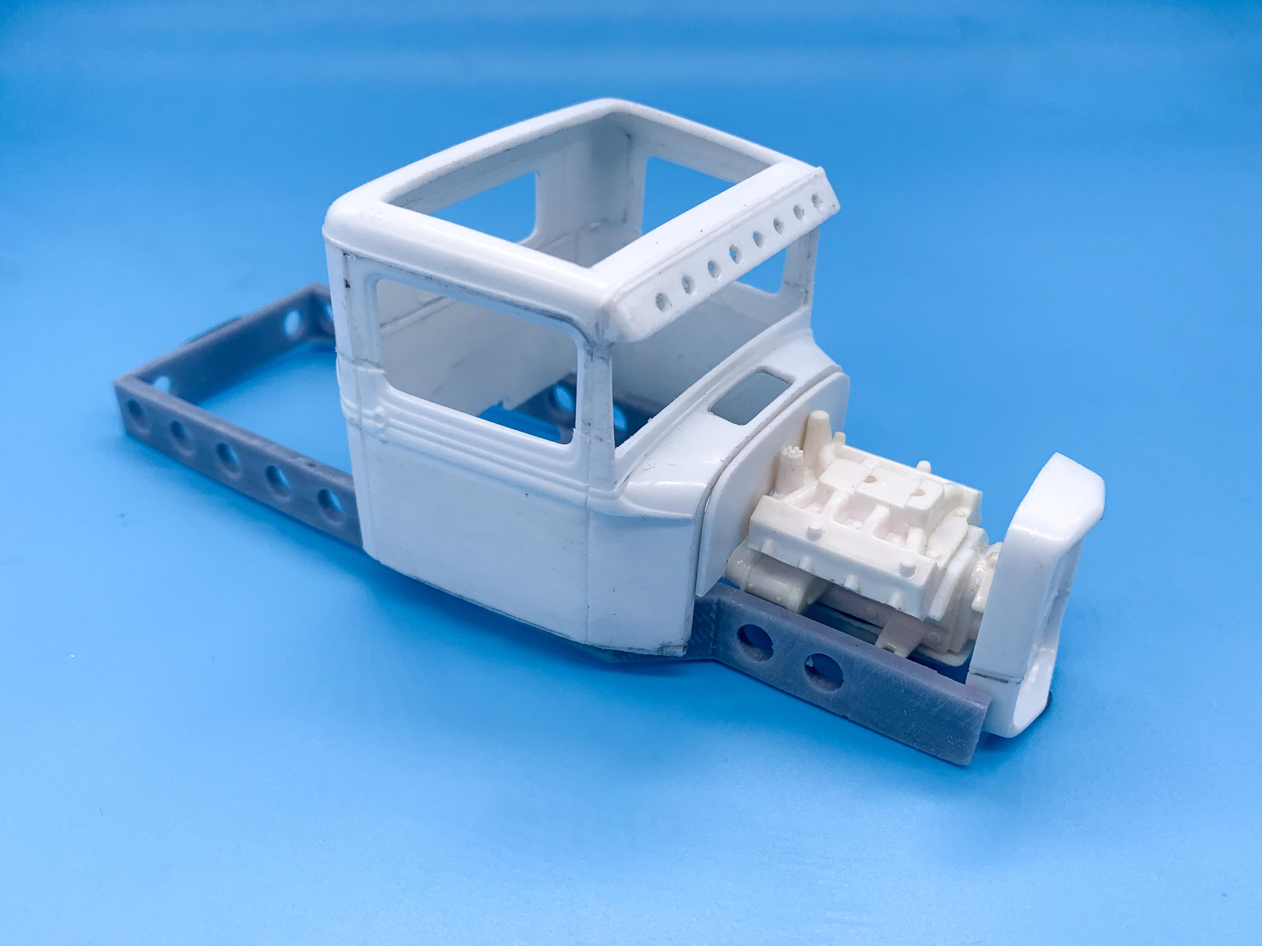

  17. Printed my first frame! Haven’t nailed the settings yet (or the technique, or even actually the final design) but I’m having a blast playing with this stuff: No build thread yet, because I’m still learning a bunch of stuff before I really dig into it, but it’ll be a 34 Truck with a Roth Mysterion-inspired frame underneath. I actually started a version of this last year but I wasn’t happy with it… Oh, and my wife likes that Doctor Who show so I printed a tiny Tardis for her, seeing as she’s being pretty cool about me spending 8-10 hours playing with my new toy the last couple of days…

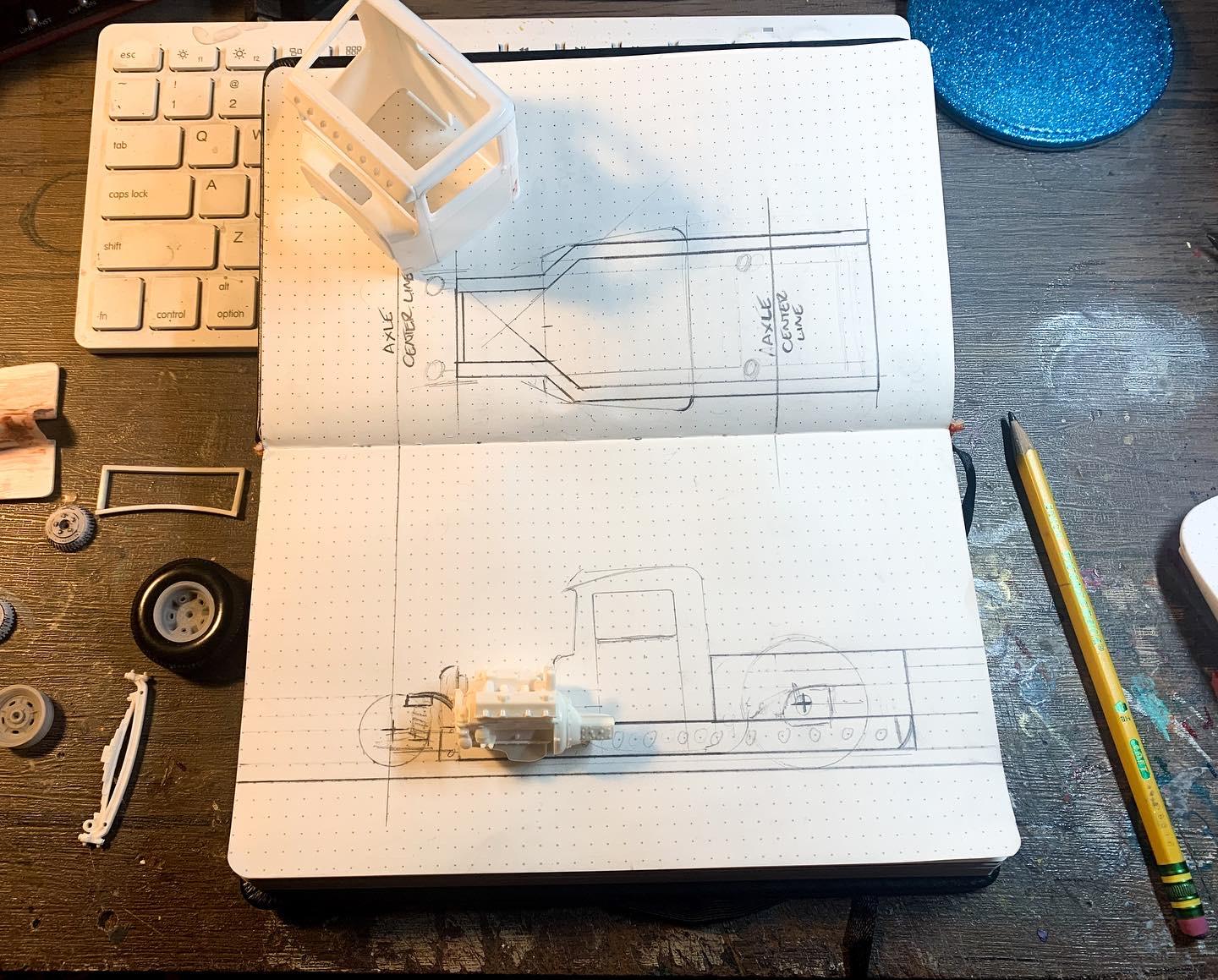

  20. I’ve had an idea for a frame for a 34 Ford truck in my head for a while…sketched it out this evening before dinner to see how it would translate. I’m doing technical drawings and renderings all day long, so it’s nice to work in pencil and paper now and then. And then, after dinner, I drew it on the computer ?
