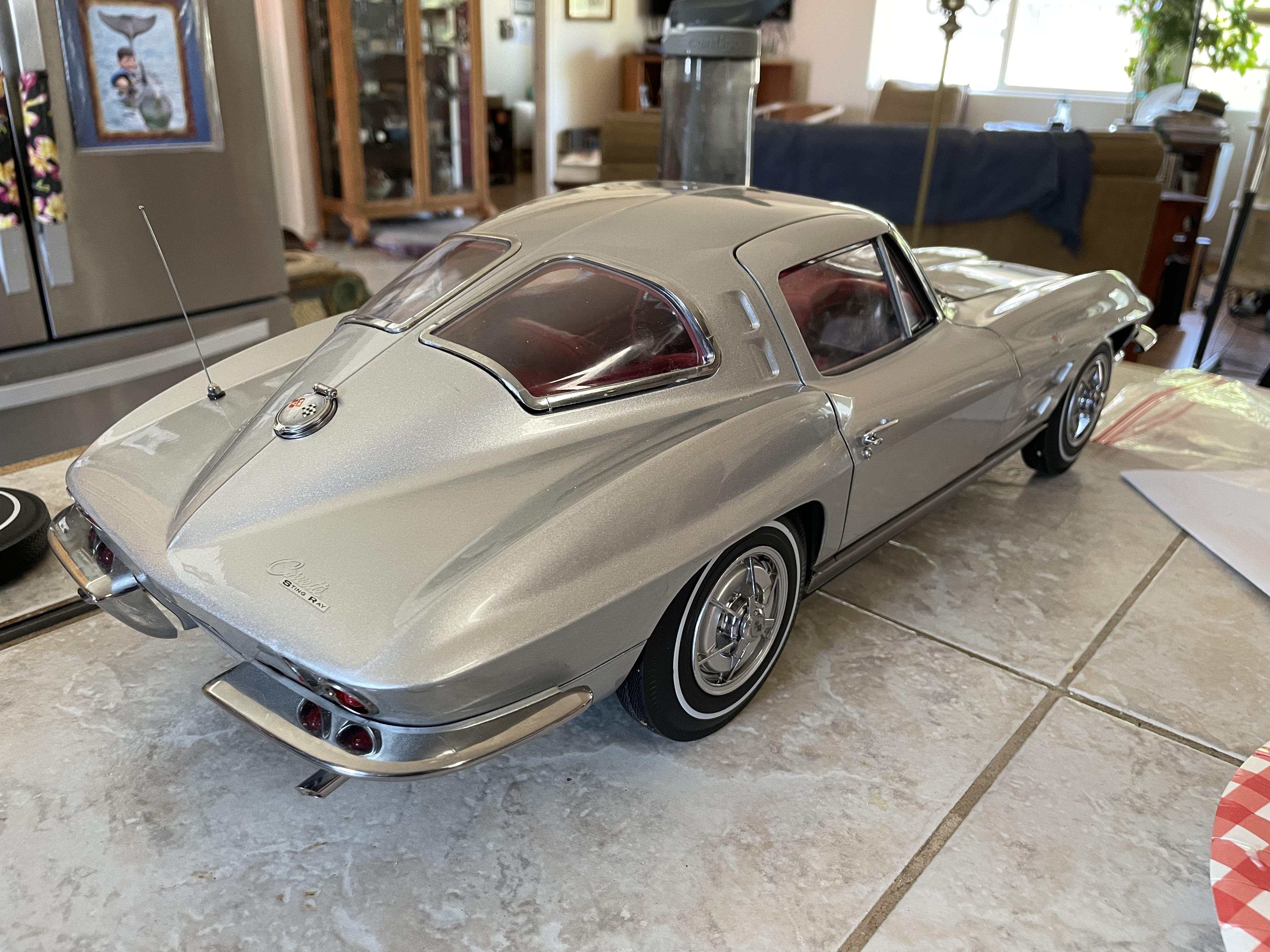

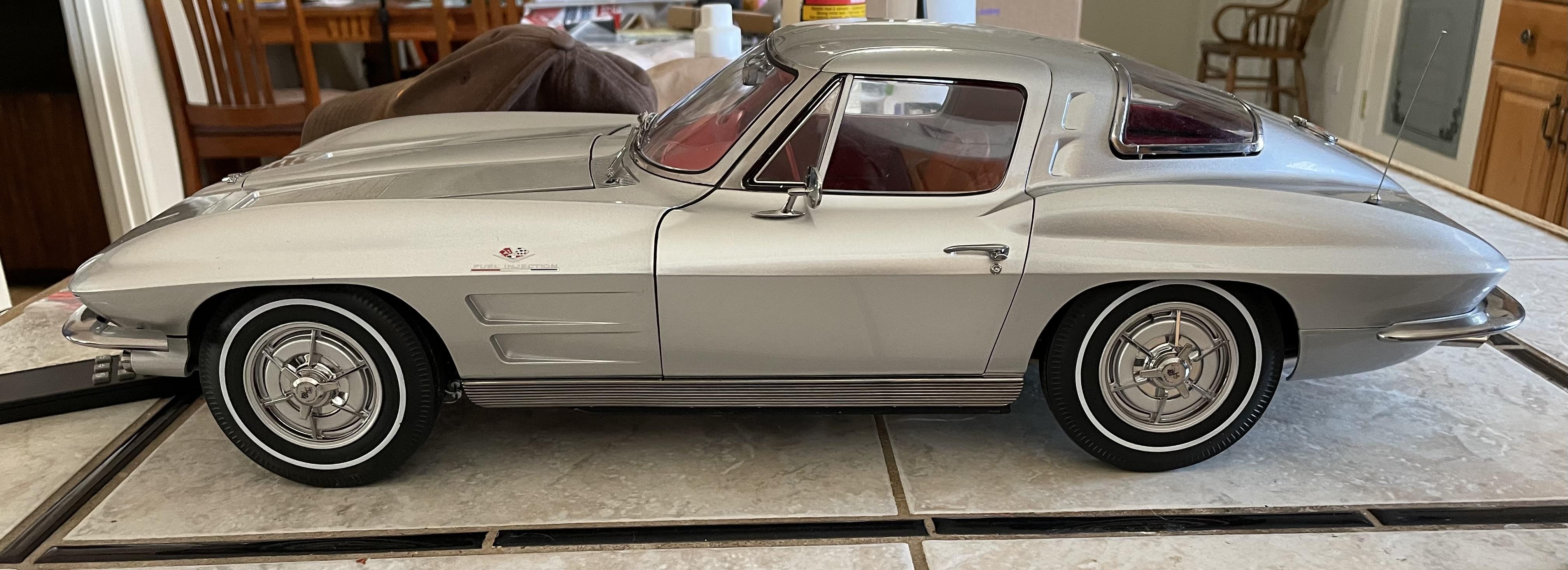

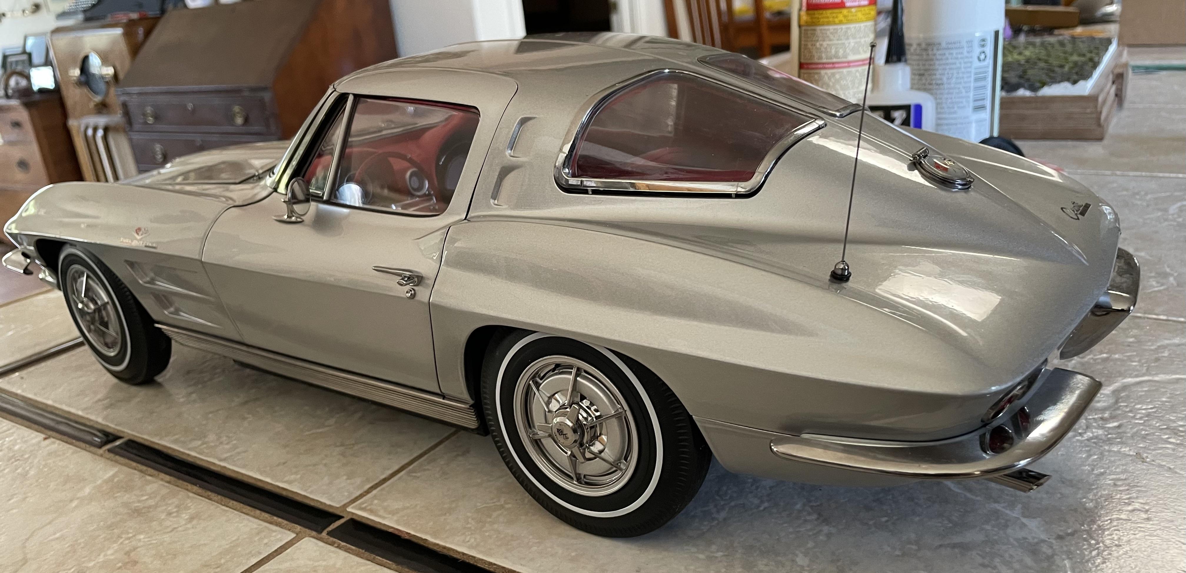

This would make a great 1:1. If I can pull it off , would you let me copy this as a 1:1? This is what I do for a living . These are my friend Kevin’s cars. But I also have several under construction.
WOW! This is a great build. Love the look, stance, color. Has all of the right stuff. I have judged a lot of shows and this one is a winner in my book.
