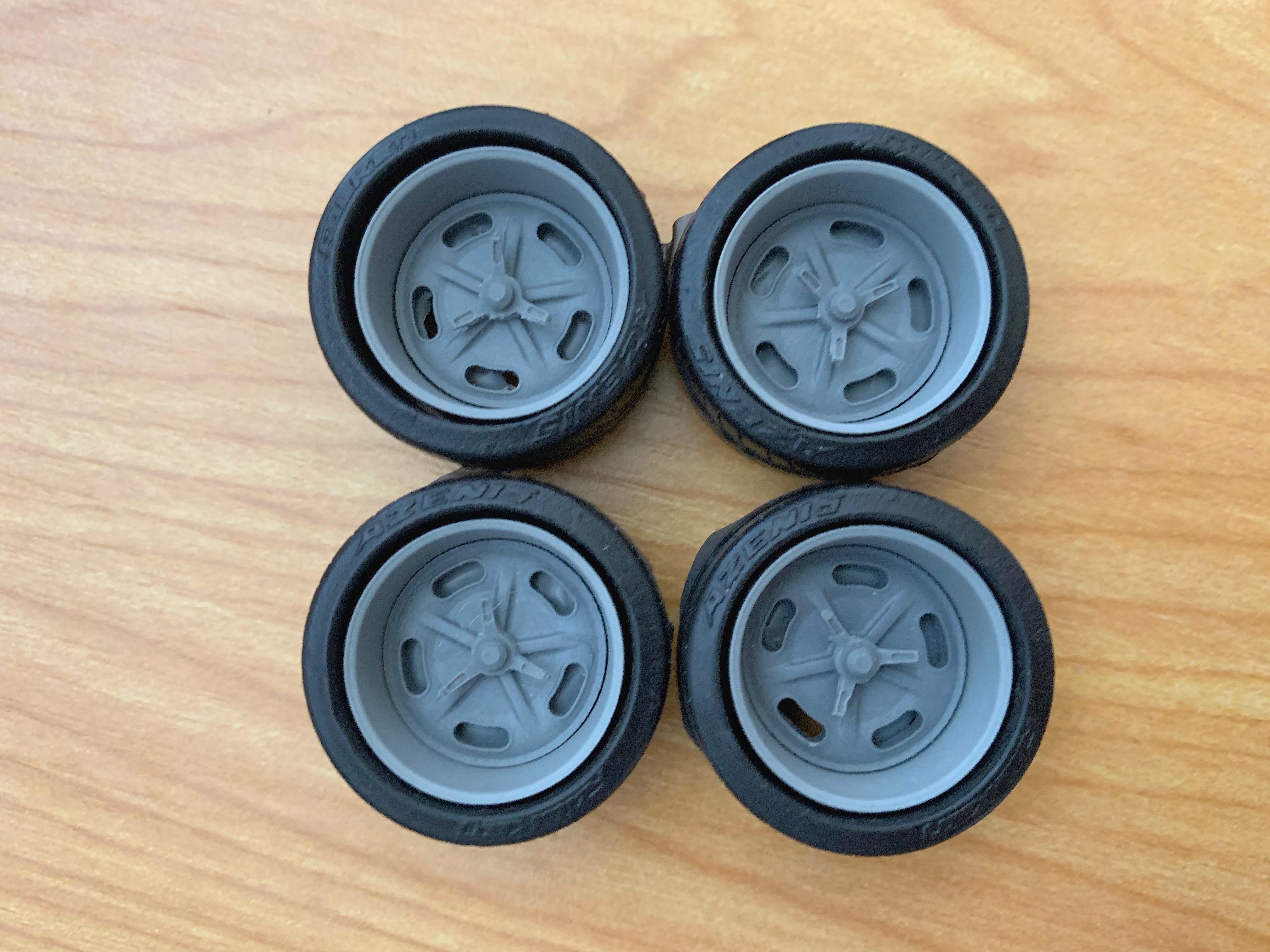

Getting back to resin issues I have several sets of C1 Models resin wheel  & Tire sets I purchased a few years ago which are no longer fitting together.
